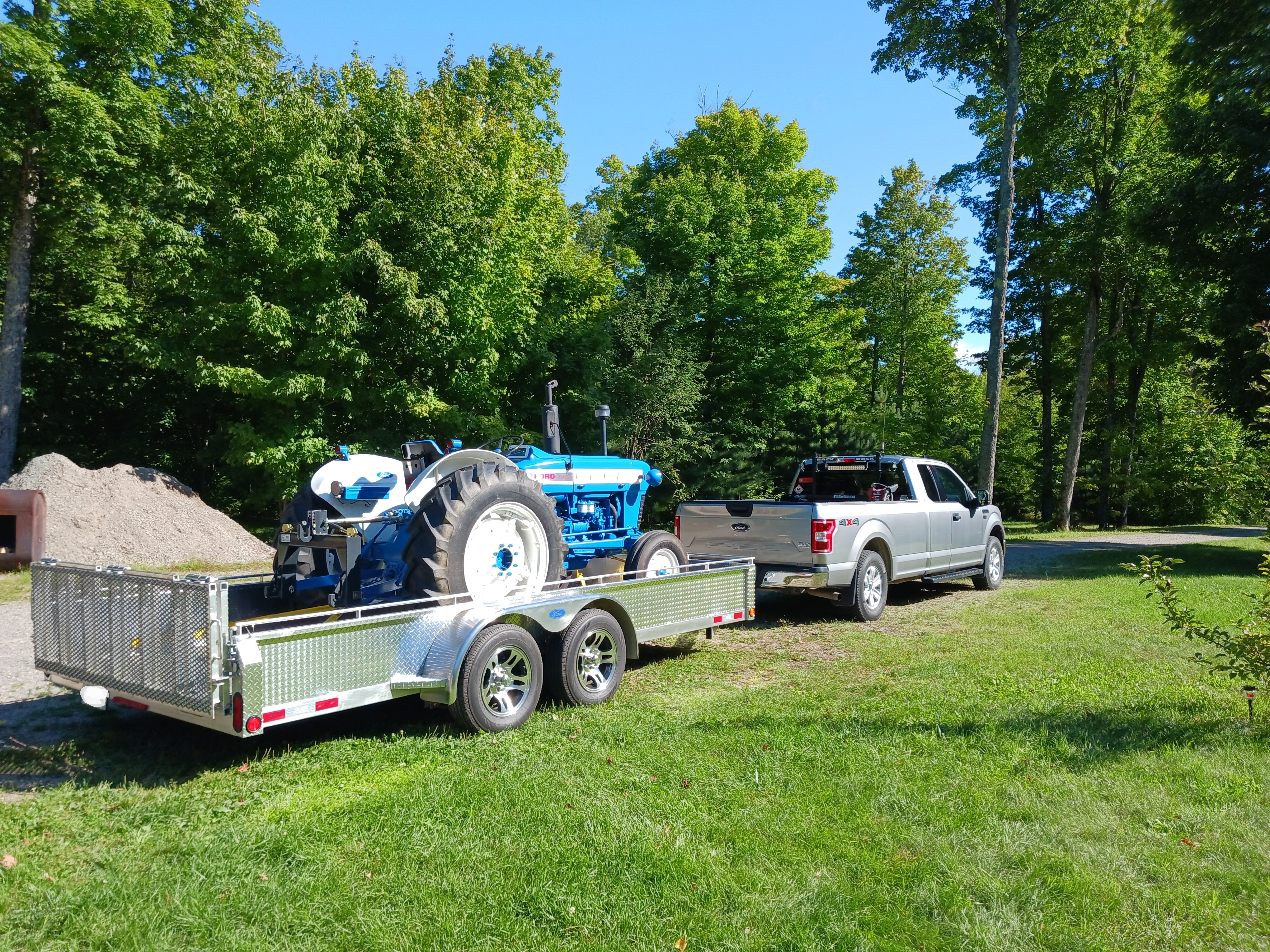

What brand aluminum trailer? Hope it's built with thicker gauge aluminum than mine. Mine is rated for 5700 pound PAYLOAD, but my Ford 3000 diesel sagged the crossmember the rear wheels were sitting on and lifted the floor.
But Bearco was real good about it with their warranty. They paid to add extra 2 inch crossmembers welded in sandwiching the original members.
And now I see the new trailers they have built since are reinforced with more crossmembers.
Reason I tell you this, is aluminum trailers have a lot of flex, so be careful when you are loading as close to the limit as you are.

Where my trailer failed is.....I wanted to load my tractors so that the tires are ON a crossmember. And only way to do that front and rear is my rear tractor tires are on a crossmember where my floor planks join. On my trailer instead of using 16 foot lumber they use two lengths of 8 and the joint is at that crossmember. So I lost that much more strength there.
But now I have tripe crossmembers at the locations where my front the rear tires sit.
Just something for you to watch for.
And surprisingly my mesh rear ramp has held up to all my tractors. My Ford tractor weighs in at 5,026.5 pounds as weighed on the local MTO scales.
