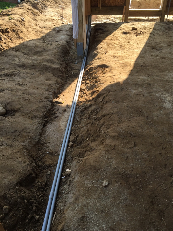

Please excuse my ignorance..... What is the bottom row of bricks sitting on?? Thanks!!!!! Is gonna be awesome!!!!
I've been wondering that too. Usually it's a concrete footer that goes down below the frost line and is part of the slab. I'm real curious how they did this so the bricks wont move during winter and crack.
/ 32x56x12 The Barn #167
Yeah, that was why I asked. I didn't see a poured brick footing that's normally visible.
Maybe they drilled into the floor slab and pinned a brick footing?
No bashing here at all. Just very curious. :)

Sorry for not responding, iOS 10 does not let me text responses so I'm using talk to text. As for the brick, it is sitting on a 42 inch plus putting by 16 inches wide

yes there's footings there I promise. Send did wash on top of them with several rains. They did clear the sand before putting the brick on the footing

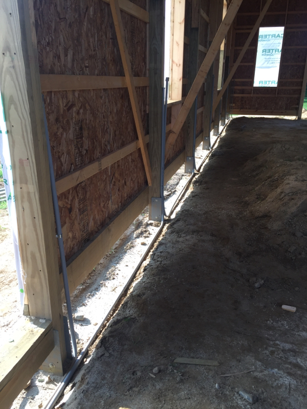

The first few pages shows the footings being dug and poured
Yes, in going back over the pics again I can see it. Was sure something had to have been used. This type of construction is new to me. Thank you very much for patience. :)
