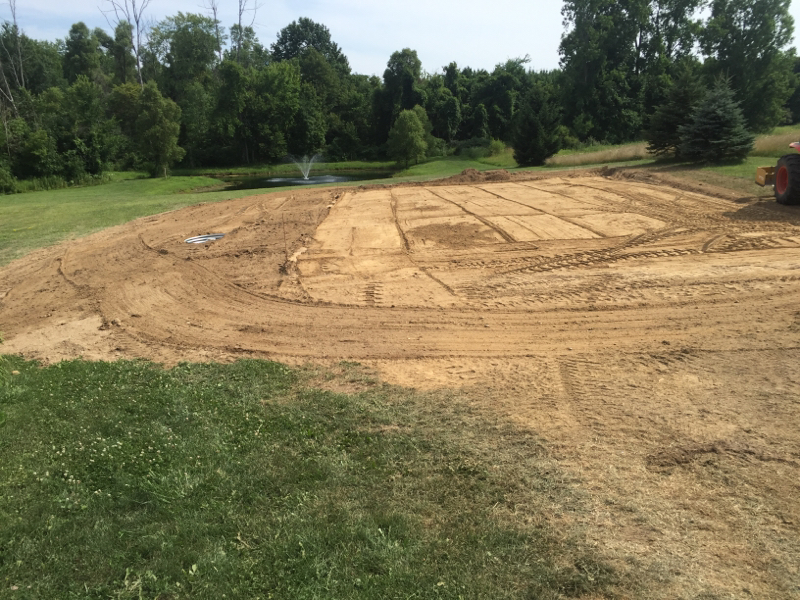

Today is technically the day the ground has been broke for the new shop. There are tons of builds out there but I figured I'd add mine just to help others. First, I broke my arm last week so I am unable to do as much as anticipated. Seeing how hard the ground was, I can't thank my friend TSO for all his magical work and his skid steer (CTL). Having friends that know what they're doing as well as do a great job is priceless!
I can only post one photo per post so I apologize ahead of time.
First off was cutting the grass down as low as possible

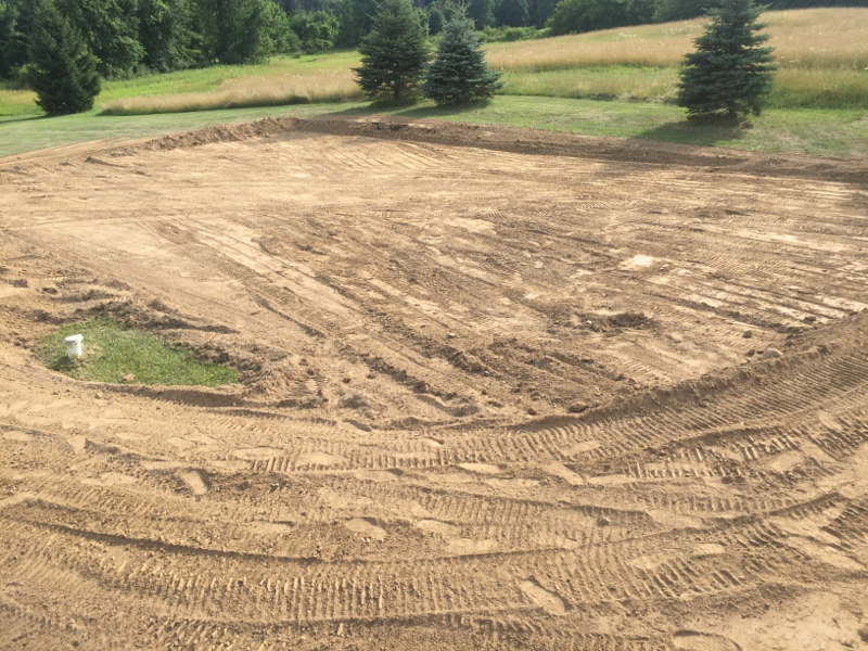

Scraping away the surface.
/ 32x56x12 The Barn
Scraped and ready for fill sand.

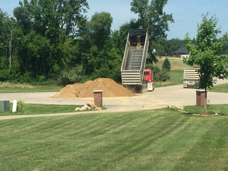

This is whats left of the 120yards delivered. (About 50 yards left).

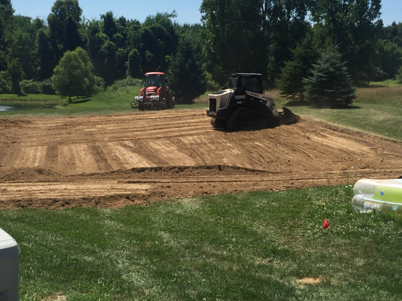

After leveling thanks to TSO, more sand was needed.

30 more yards delivered

No to watch TSO perform magic

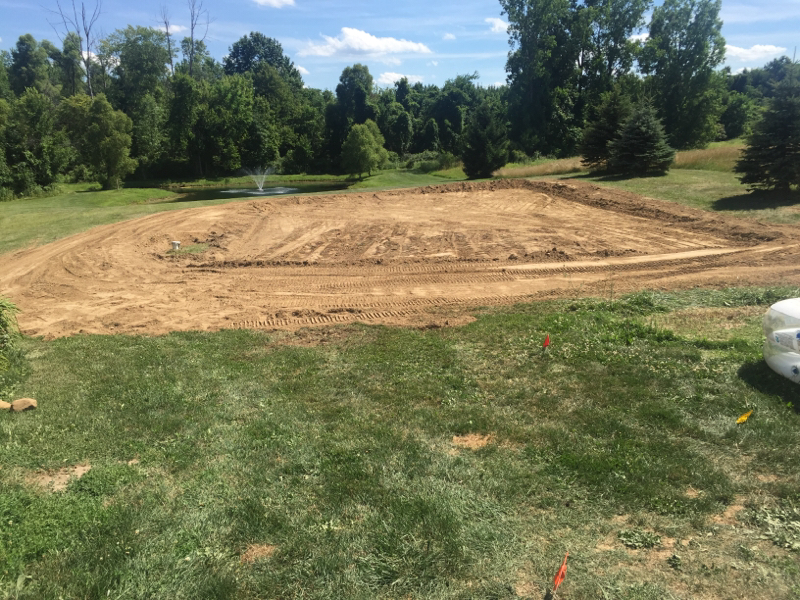

All graded and leveled. Now staking for footings
