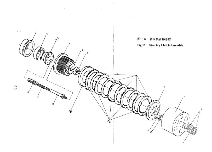

Metal against metal without lubrication is wrong. Here is the Yuchai steering clutch. The early steering clutches had riveted friction media, the later have the bonded sintered bronze composite which are considerably thinner, hence seven instead of five. #15 is just a spacer/washer. You have to remember that many parts sales people have never even seen the parts they are selling.

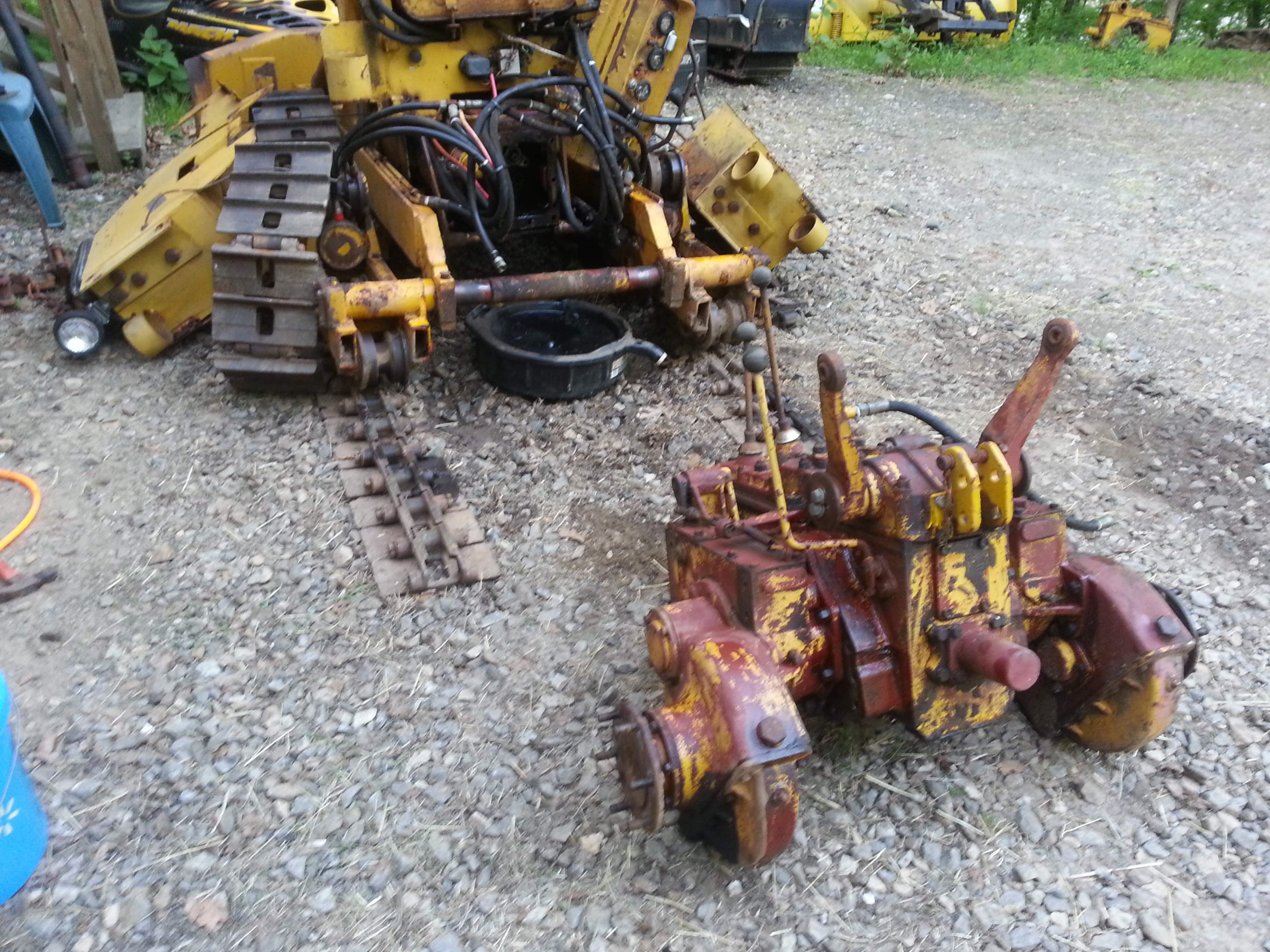

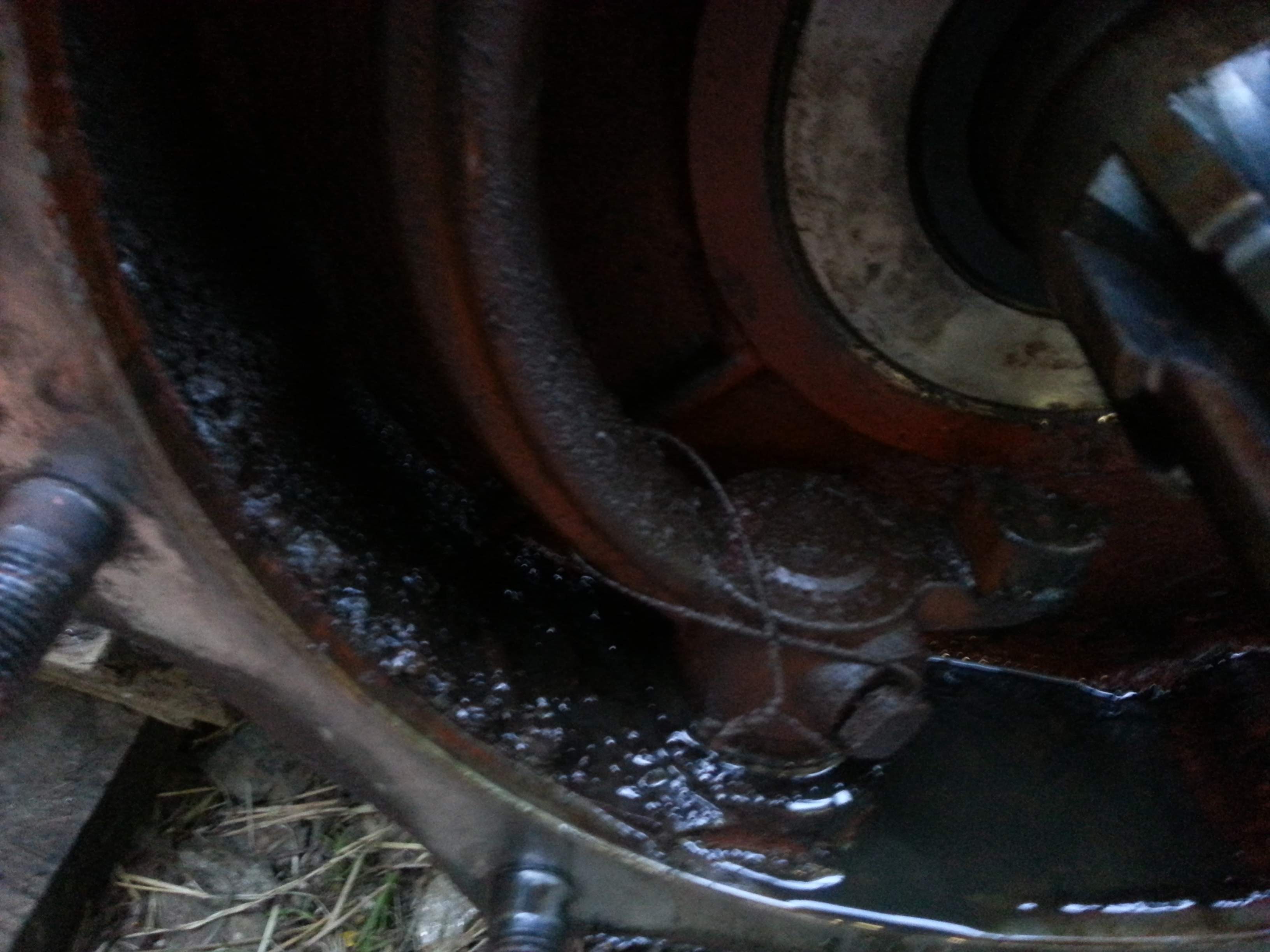

Hi All,
Rather than start a new thread i thought that it was better to continue this one as it is the closest i have found that is the same as what i have been going through.
I am located in Australia and working on an East Wind YCT-306 3 Ton Bulldozer also known by many other names.
The dozer has had a steering problem sometimes it would have no drive on one side, and when you did get it to engage it would feel as if it had a bearing failure (notchy)
So far i have lifted the ROPS and removed the gearbox from the clutch housing out the back of the unit. I have also removed the final drive units.
Hoping that some more people have done this and interested in there input.
Pictures so far,

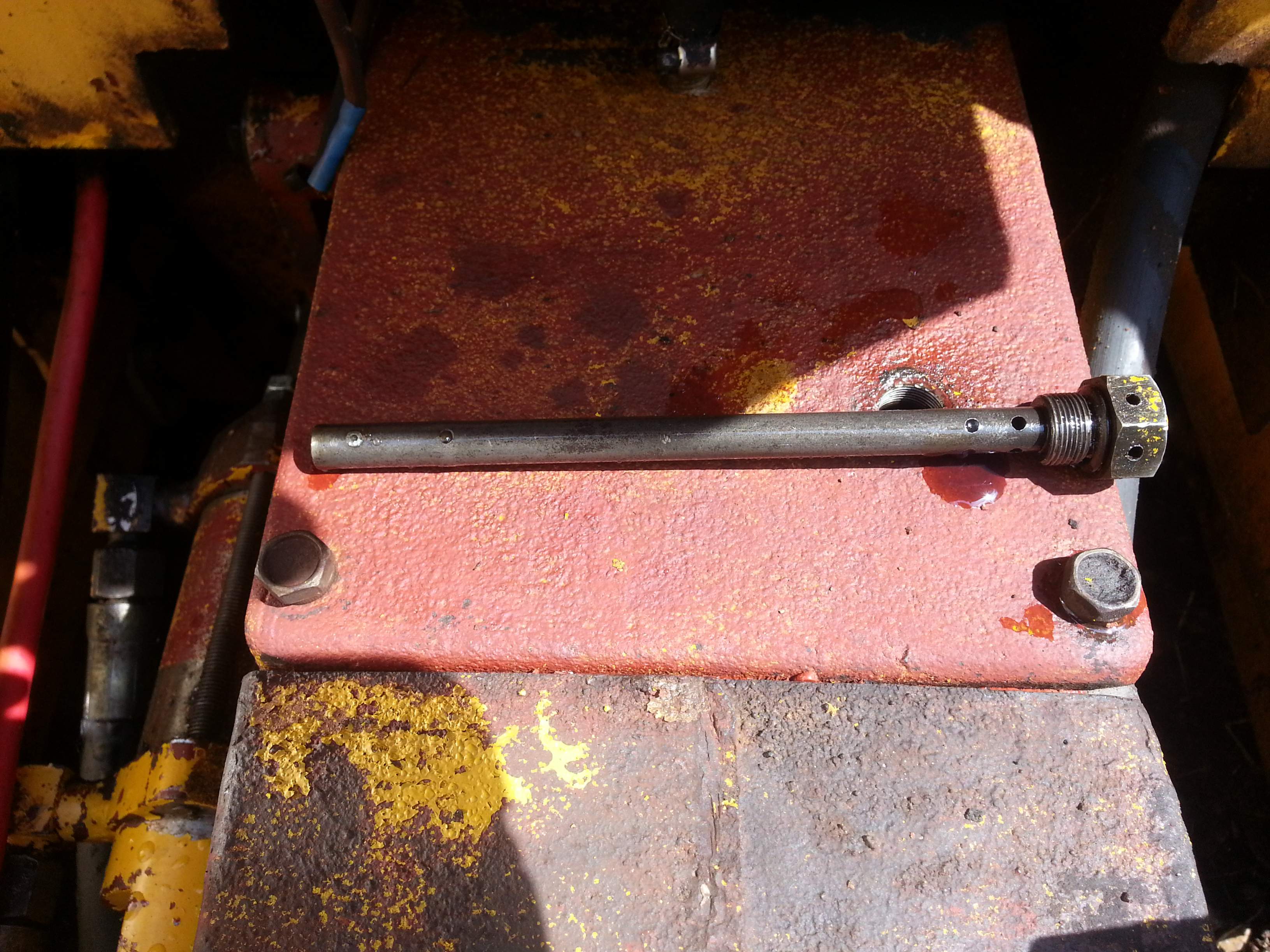

Check the short drive shaft on the side that slips. They can sometimes break if you are steering with a load in front of you. It may be stuck in the final drive and just slipping by. It is a fairly short shaft. I dont believe that the main gear box is the problem, but pop the cover off and check for metal shavings or chunks in there as well. The one picture with the large nut has a crack around the nut. Is this the side with the issue?

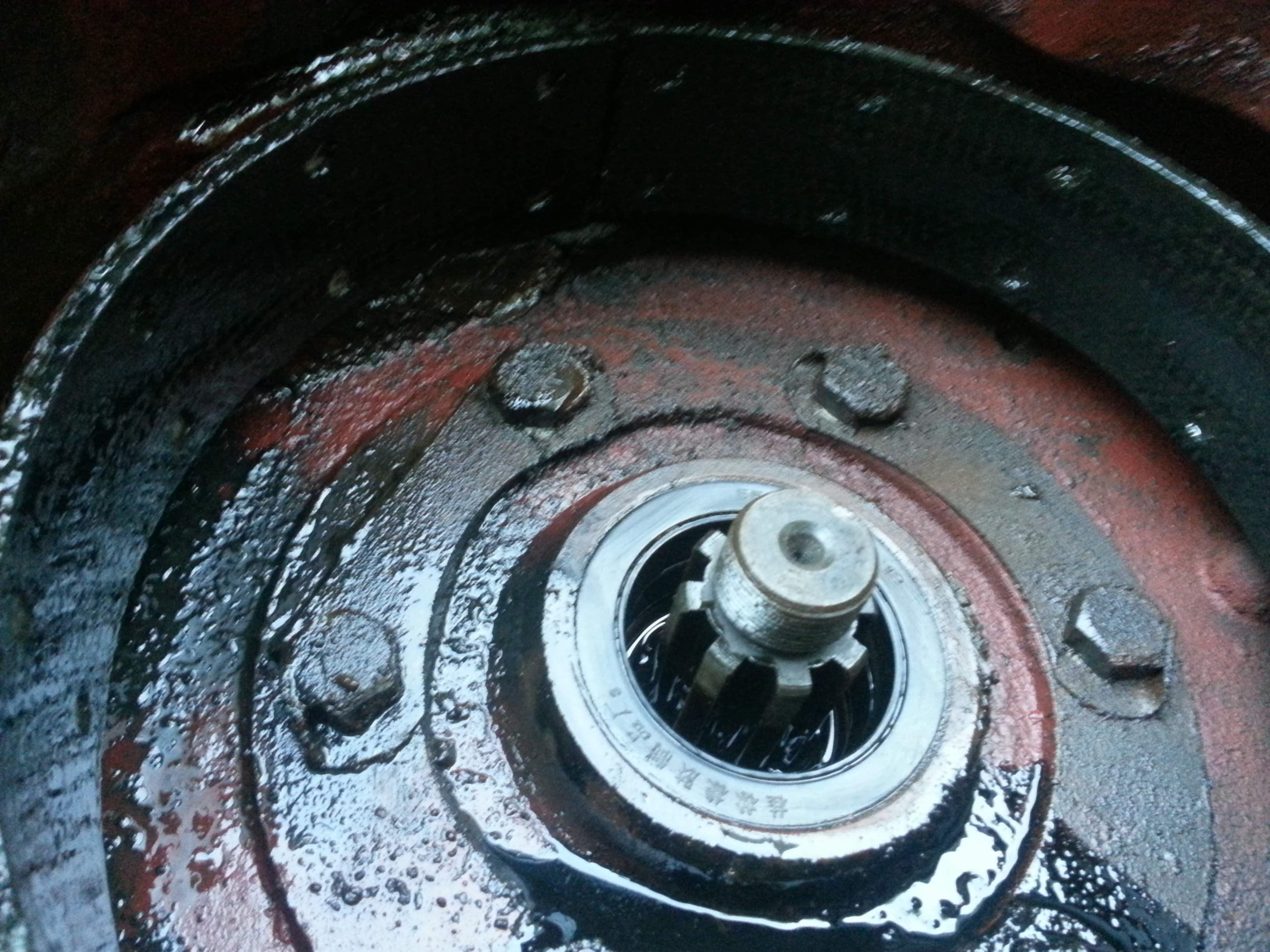

The nut that looks like it has turned has silicon on it. Still trying to remove the nut, pushing the punched bit back out is proving harder than normal for this sort of thing. Is the short drive shaft you are referring to the one i am trying to remove the nut from ?
The groves warn in the brake drum are not what i was expecting, the worn part should be in the slots not on the top of them meaning the inner clutch plate is rubbing on the brake drum maybe ?
   / 30hp Chinese Bulldozer Parts #89
MurBah, you obviously have a oil seal that has failed. The steering clutch/brake compartment should be completely dry. The worn areas on the splines of the brake drum are normal for a dozer that does a lot of turning while pushing.
The shaft that Giggity is referring to is the shaft in the final drive. See pics.
The other concern is the possibility of a crack in the brake drum. See in red circle.

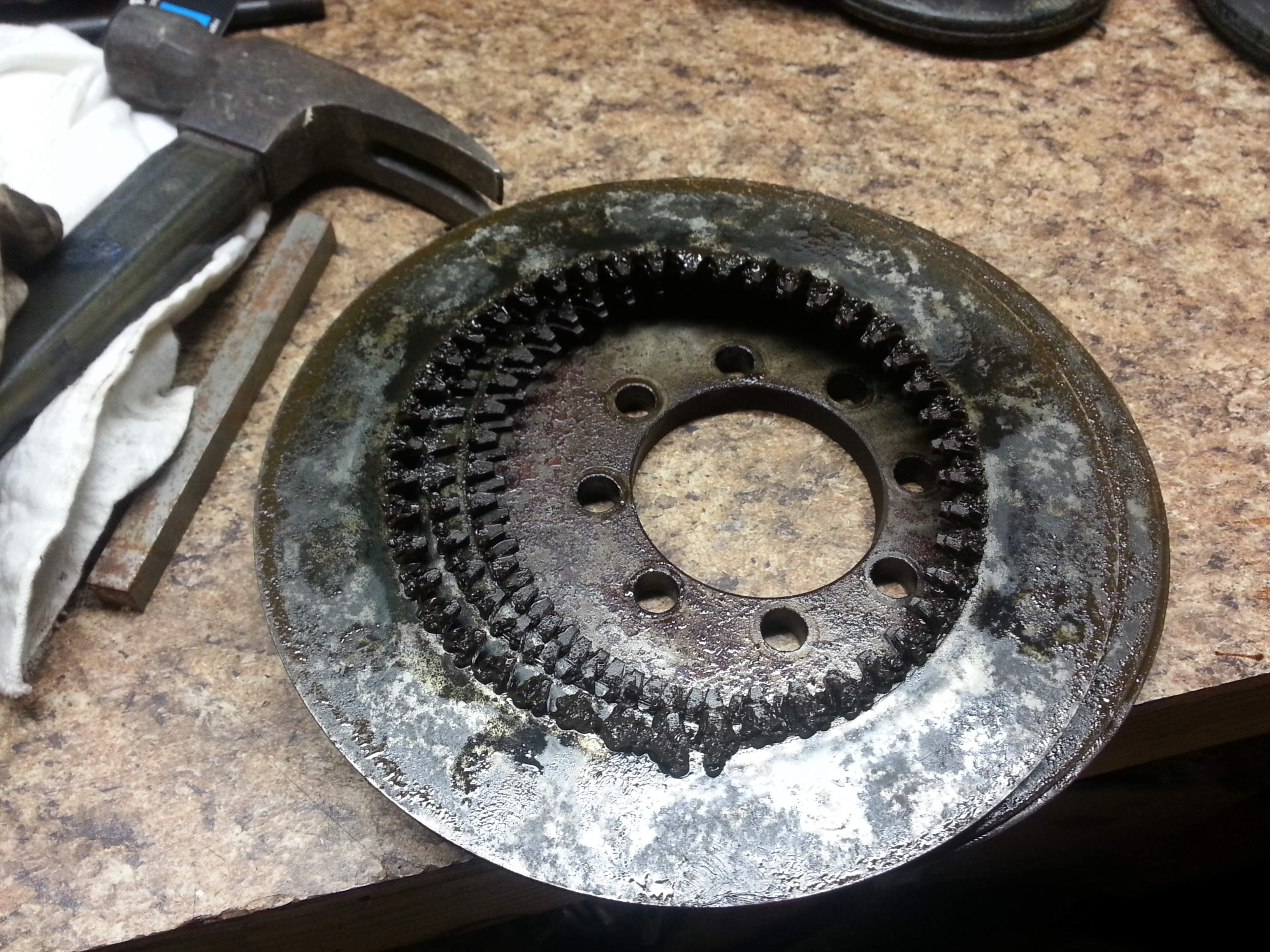

Ok so i have pulled it down a little more, I should have said something about the oil everywhere, thank you for pointing it out for some who may not realize it is meant to be dry. I was wondering how the steering while pushing can cause the warn groves in the clutch/brake drum. I thought that the cause would more likely be a bearing failure tho i have not found any bearing faults yet, they seem OK. I can see how it would cause things like the axle twist off that looks nasty. So far all i have found is about 3/4 inch of an o-ring in the washer on the clutch to final drive shaft missing (would explain all the oil where it is not meant to be) i suspect the people at Midway damaged it when they put new brake bands in it under warranty.

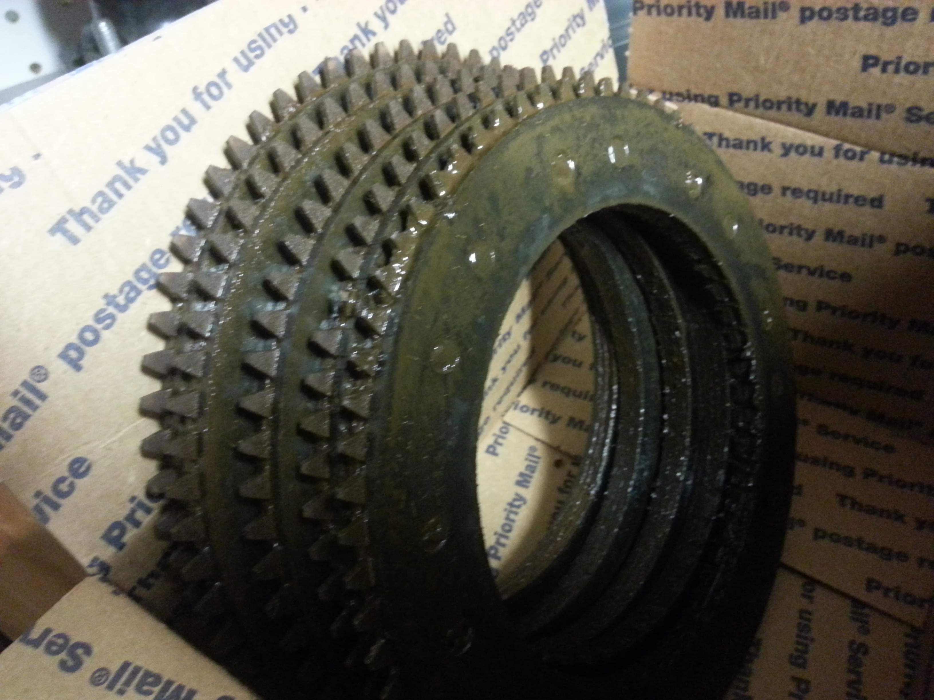

Wow! You didn't have to take it down that far just for steering clutches and brake bands. Yes, all the friction material has become saturated for sure. Not worth the time to try and clean it, because you can't. The new clutch discs you get will probably be a bonded sintered bronze composite which can be cleaned. Also check the clutch plates for wear and warpage, these can be reused if they qualify. Circle-G Tractors, Keno Tractor, and Northern Tool are just a few of the dealers that stock parts.
