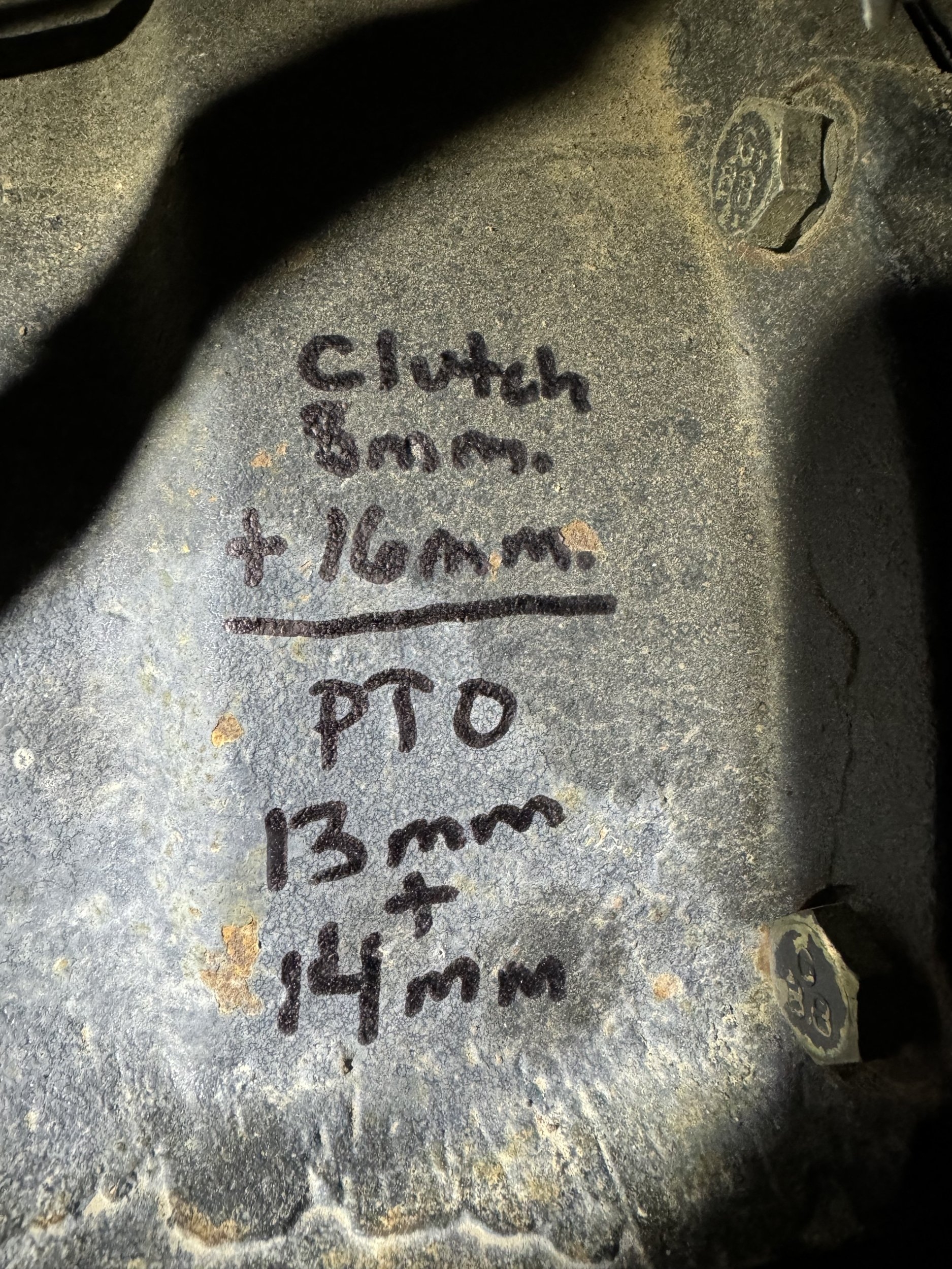

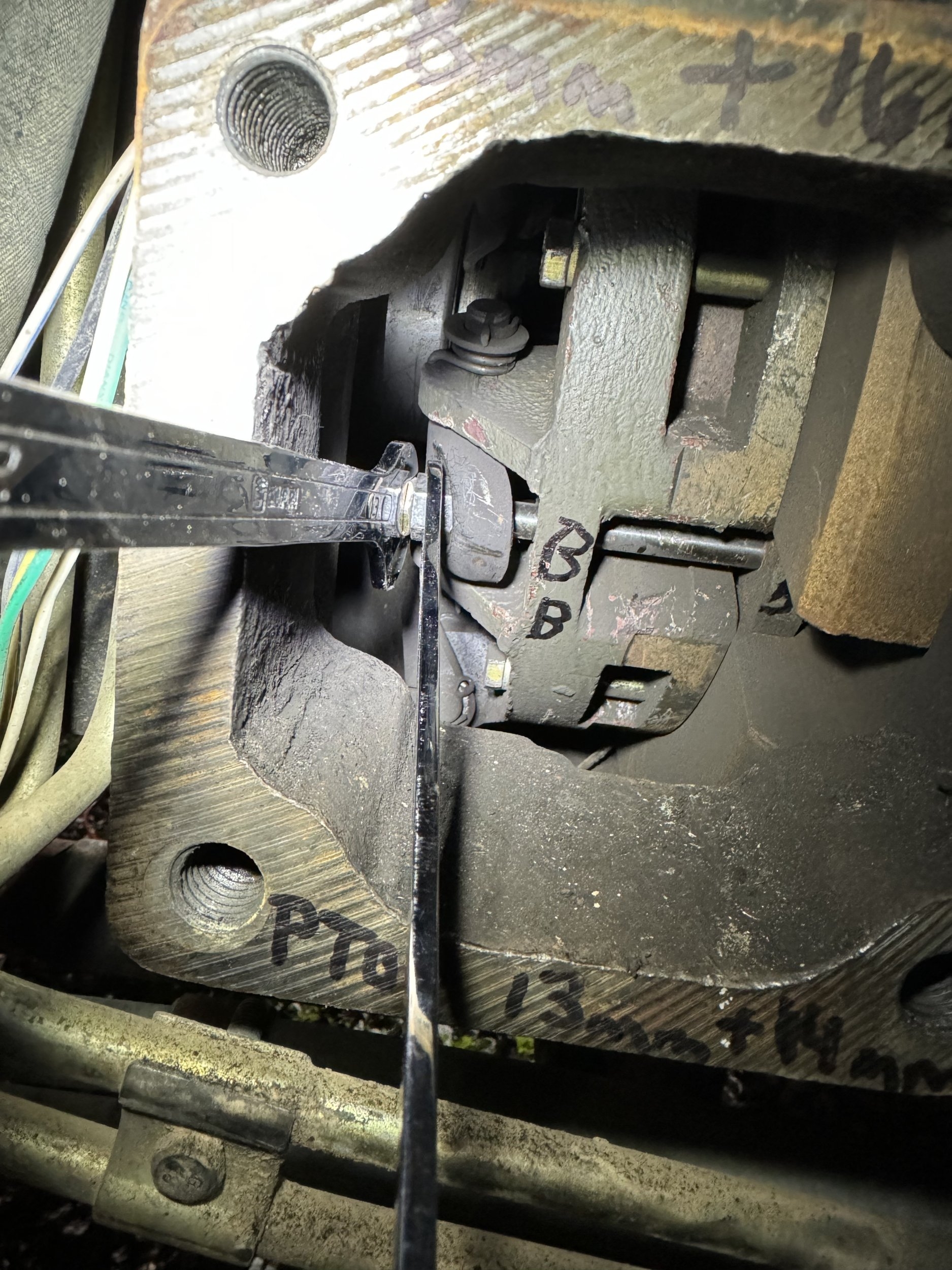

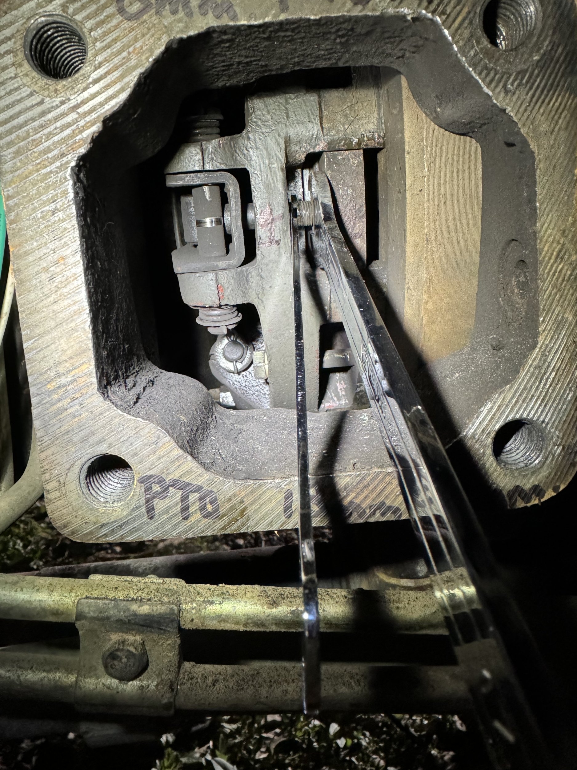

I ended up having have a Two stage adjustable clutch and not a single stage.
I took the loader off and the mounting R&L towers that bolt up to the side of the transmission.
The left side didn't give any clutch access as its sealed off. It was all done through the access hole on the right after removing the 4 side bolts and 1 underneath.
Used thin metric wrenches to reach in and unlock the nut on right and then turn the square stud to make the adjustment. Counted how many turns, bumped starter and used a ply bar to rotate to the next 2 studs. Mark each as you do it and write it down. If I recall correct, I used numbers 1-3 for the clutch and letters A-C for the PTO adjustment as I indexed it. Had to use a bright head lamp to see the clutch finger gaps as they get closer to the throw-out bearing face. I just used a visual guesstimate to replicate the gap for all three fingers for the clutch then again for the gap to the throw out bearing. I over adjusted the clutch at first and had to back it off because it wouldn't disengage at the end of the clutch pedal stroke. There are a couple helpful U tube videos on adjusting this but not many.
I had someone push the clutch in and out for me so I could see the throw out bearing move back and forth. For clarification it was the pto clutch adjustment that I over adjusted at first causing the pto to stay on even when the clutch was fully depressed. I backed off the adjustments I made and the pto would stop spinning with full depression of the clutch. Im sure a tech would set the clutch and pto way better than I did and know how to get a feeler gauge between the throw out bearing and the clutch fingers, but it is now usable. Before I was thinking it needed a full case split and clutch replacement because it would barley move in 1st gear.
The info I have read states that this tractor will need periodic clutch adjustments to stay working.
So, I assume I will only be able to do this a few times before it does require a case split.
Anyone have feedback on that or any part of this please chime in?
The thin wrenches I used for the clutch were 8mm and 16mm, the ones for the PTO adjustment were 13mm and 14mm.
On both, you loosen the lock nut, make your adjustments then retighten the lock nut before you finish up. You don't have to tighten the lock nut each time you advance to the next one but just don't forget to check and recheck them all before you're done. It's easier said than done at times in a very tight space. Get comfy because everything is done in many very short turns and indexing of the clutch housing.
