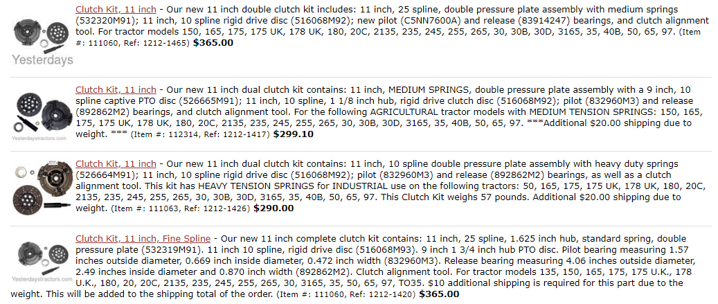

Unfortunately, I'm not sure which clutch kit to order. There are several variations listed for the MF3165.
Clutch hub diameter: 1-1/8 or 1-5/8
Clutch splines: regular or fine
Spring type: heavy or medium
Is there a standard clutch assembly for the MF3165? The service manual states there are different types.
Is there a way to determine the clutch type by looking through the inspection plate underneath the clutch? Or will it require splitting the tractor and removing the clutch to see what type it is?
