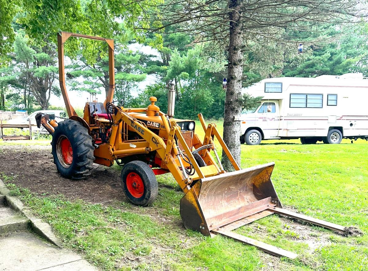

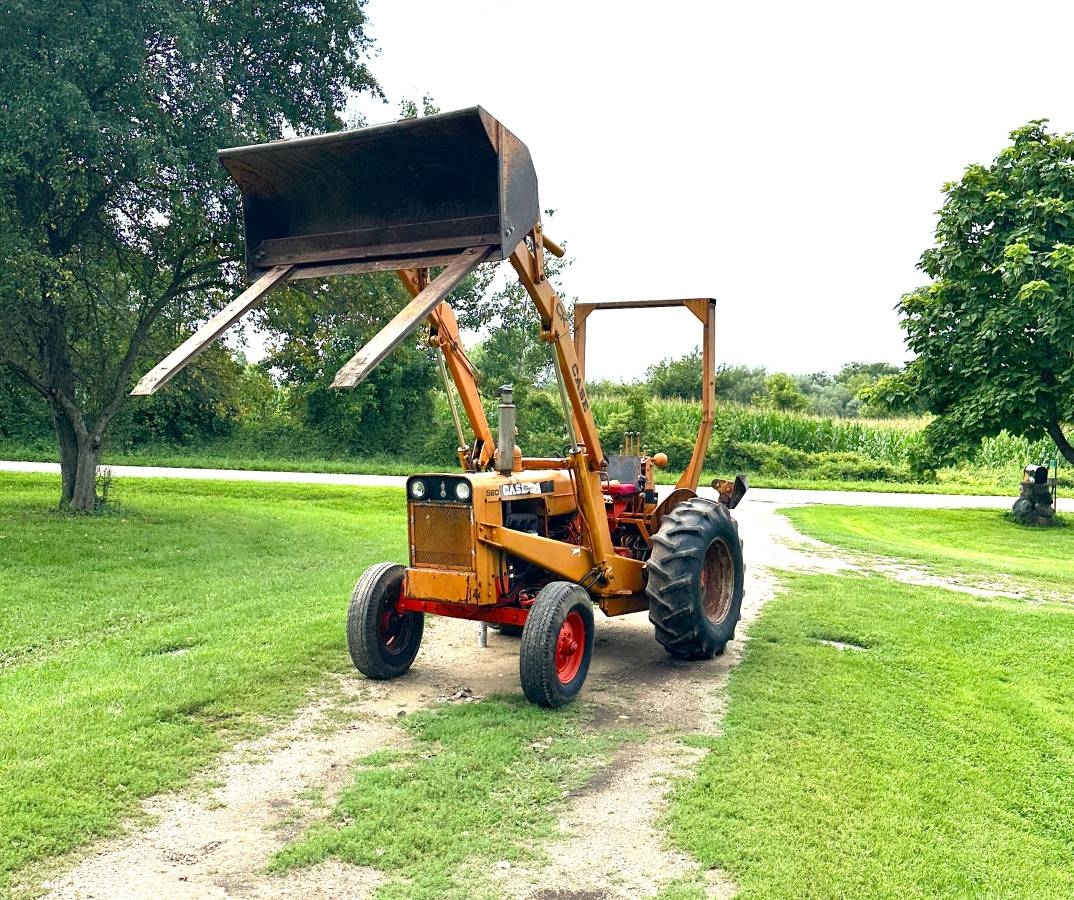

Been looking for a hoe for a while. General hobby farm use. Found an old Case 580 nearby on CL.
Rebuilt motor, runs good, some cylinders leak. Hoe needs work. Affordable.
Capable of doing the work, but not super thrilled about buying a project.
Don’t have any experience with 580’s or much vintage equipment beyond Farmall Cub and John Deere B.
I know 580s are kind of THE standard but hesitant about parts availability
Currently own a 20hp JD2210, and 30hp JD4400
Questions:
1. Will this still be “easy” to source parts?
2. Will they pull a drawbar similar to a JD 2020/3020? Or is that a poor use?
3. At around $5k asking, what is a good price?
Here is the full add text:
Any input appreciated.
Case 580CK Backhoe Loader w/ Forks
Runs, drives, and starts great.
The 52 horsepower diesel engine in this tractor was recently rebuilt. The tractor is an easy cold start and the power definitely shows through when running the tractor.
She's a great workhorse with a lot of value I just don’t use it enough to justify keeping it.
Ask me about delivery to your location!
The Good:
- New radiator
- All new hydraulic fluid and filters
- Oil and filter changed
- New fuel filter
- Engine was recently rebuilt
- New Battery
- New front Tires
- Includes Parts Manual
- Includes Service Manual
- Extra Service Consumables Included
- Heavy Duty Bolt-on Forks
Length: 50"
Thickness: 1-1/2”
Material: 4140 Steel
The Bad:
- One of the outrigger hydraulic cylinders needs to be replaced
- Needs new cylinder seals for backhoe attachment. Attachment is mechanically sound but the seals leak. I’ve already purchased the seal kits needed but they need to be replaced. I have a contact that can replace these.
- Tilt front end loader cylinder seals leak a little
Thanks

I would pass simply on the 2 wheel drive aspect. Seals are relatively easy to source, a hydraulic pump may not be.
1. Call the local Case dealer and ask about parts
2. No drawbar, to drop the hoe and use for that, may not be worth the effort
3. 5K is probably in current reasonable range
   / 1967 Case CK 580. Worth owning? #3
That is a really old tractor. Parts are available to some degree, but this is not the "580C" which is what made a name for Case and was the backhoe. This is the earliest 580. The tractor looks clean and tight. I assume the transmission is a manual shuttle with a clutch? That would be okay for your use. If it has a power shuttle, then I would steer clear. I agree with @D&D, worth about $5000.

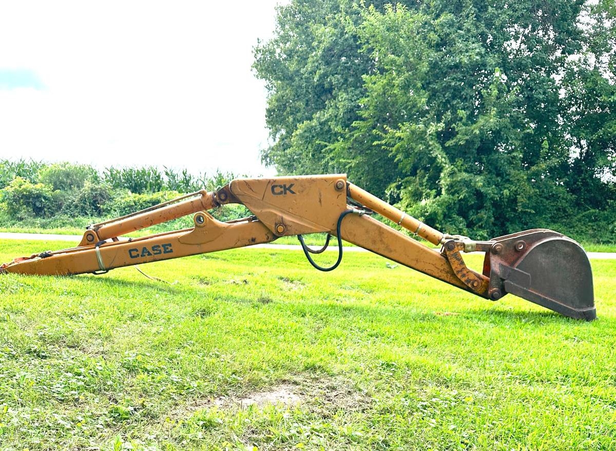

Am I looking too hard or is the backhoe not attached to the tractor?
   / 1967 Case CK 580. Worth owning? #5
They were removeable using a 4 point mounting system. There was a 3 point "MOD kit" that mounted on the same points so you could use grader boxes, etc. with your Construction King machines

Looks like a great machine for the price. Original paint in that condition tells me it's been stored indoors and has low hours, and it was taken care of. You could buy a tractor 30 years newer that is a much bigger project and much more difficult to work on. These old models were really simple to work on. All old tractors are projects. No way around that. Every tractor that is over 20 years old is going to need hydraulic seals and hoses replaced from time to time. These are simple tasks anyone with a few tools and basic mechanic skills can perform. All the hydraulic seals and parts are available from multiple vendors. There is nothing proprietary about hydraulic seals. All of the hydraulic seal distributors have them. They are just generic seals. Engine parts and rebuild kits are easily sourced and are relatively inexpensive.
My biggest concern would be, if it has a shuttle shift, does it work properly? Eventually these seals will fail which requires splitting the tractor. Many consider that a project to large, though in reality it's pretty easy on these older models.
Either you live in an area where tractor prices are very low or there is something untold in the seller's description about the condition. Where I live, this is would be the best old tractor deal you will come across.
To your drawbar question: "Will they pull a drawbar similar to a JD 2020/3020?" I would say similar to the 2020 if you are on flat ground and can raise the loader all the way up to move the weight toward the rear wheels. I often unpin the bucket when I don't want that weight on the front of the tractor for rear ground engaging tasks. So, I would say similar to a 2020 but a 3020 has 40% more hp so... All of this is of course considering the backhoe is detached.

I believe backhoe was removed for repair.
