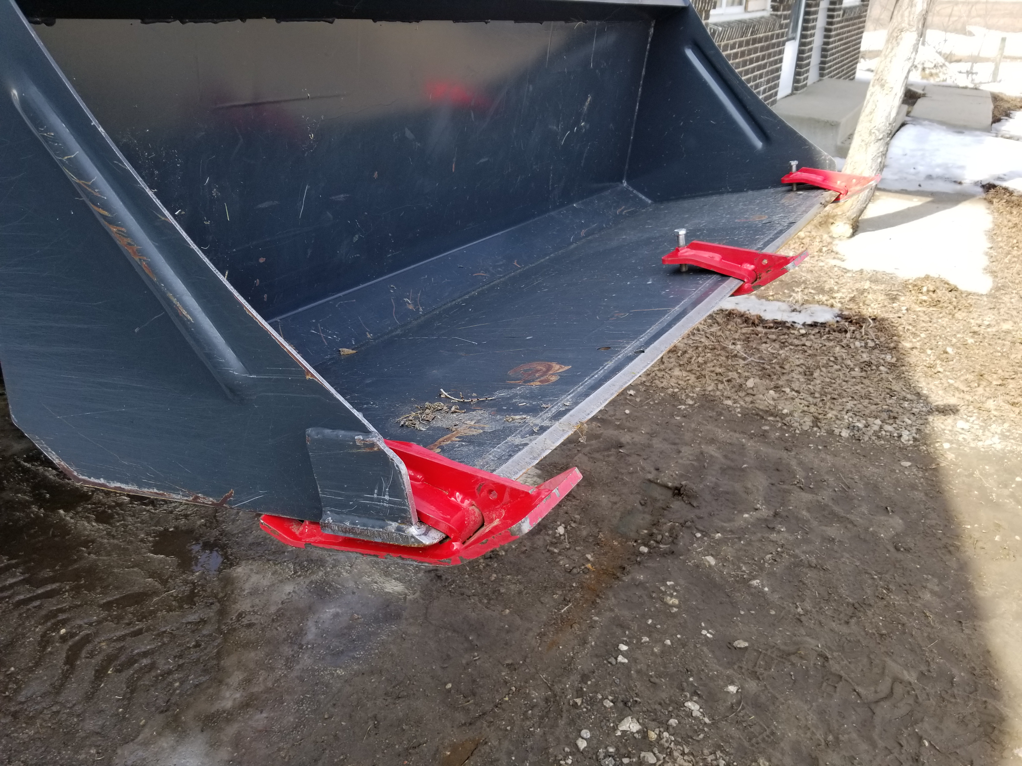

Thanks @RickB for the tips. And @ cdaigle430, what are the bucket edge tamers? I have the rest but am debating the chains. I have turfs so I壇 like to see how well they do.
These are Edge Tamers.
Here is the website to the manufacturer:
R2 Manufacturing - Home Of The Edge Tamer
The Edge Tamers allow you to run your bucket over ground that is still soft, or grass without digging in and tearing up the ground. I use them until winter freeze up freezes the ground hard here. Once our ground freezes up, it's hard as granite for the rest of the winter, and I take the Edge Tamers back off again, as they're no longer needed.

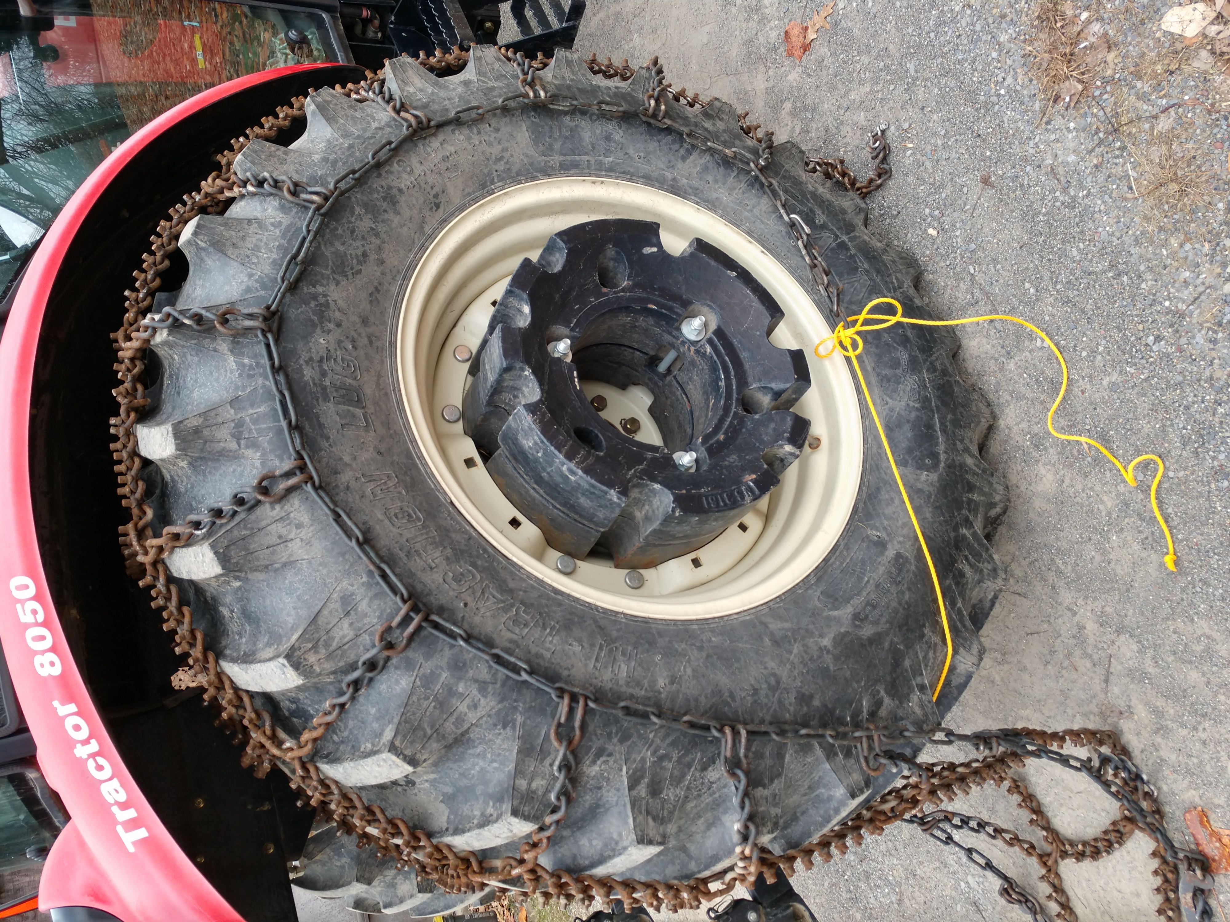

Any other opinions on tire chains? Will they tear apart a paved driveway? Chain fronts only, backs, both?
/ 3 point snowblower question.. #24
I can't see chains tearing up pavement that's not already hosed. You may get some scratches or marks on the surface only, but most of us aren't running 20 ton bulldozers here. I'm running filled rear tires and R4's on very flat ground here. I don't need chains where I'm at here, but if I had hills and slopes to clear snow on, I would want chains. Rear chains alone should be enough, but I also have steering brakes which helps a lot, even without chains.

Former New Yorker used chains every year for 40+ years. Put them on before you need them, leave them on till spring.

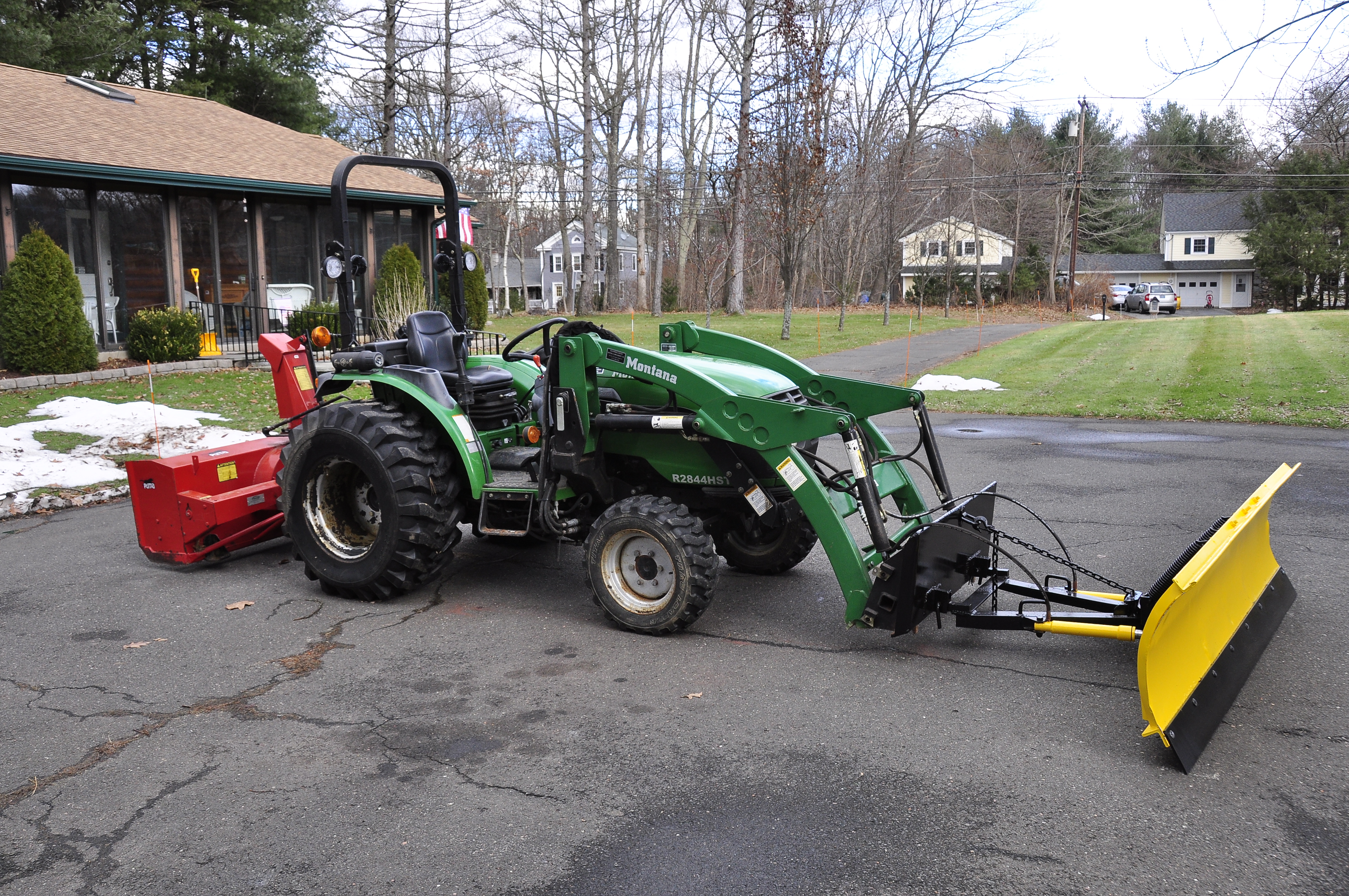

I have a plow on front and a blower on the back. R4 loaded tires. No chains needed for my flat 600’ driveway. Tractor weighs 2400, loader 400, plow 500, blower 400, weighted tires 300. All told 4000+ lbs. Never had a traction issue while plowing or blowing. Live in NW CT.

Last winter was horrible! Layers of ice, if I didnt buy my chains my tractor would be useless.....have you every tried to walk on ice with a layer of snow? You will only need rear chains-if you want to protect your driveway the 2 link ladder style is a good one.

My plow is on the loader so I never have to remove it. It has a SSQA plate so swapping between bucket, forks and plow is easy.

I have not had any issues or problems with the loader mounted plow. I can plow piles up to 8' high. I can swap out the bucket for the plow in about 2 minutes. You can't do that with a sub-frame plow!

There are a couple threads here on tucking the plow frame under the SSQA plate. I went with that method mainly because I didn't want the plow to act like a rudder when angled. The other benefit is making the overall length of the equipment shorter.
This is an 8' Fisher blade with a bottom trip edge. The frame connects to the blade higher than some because of that design. It helps avoid dragging the SSQA plate or part of the mounting on the pavement. Paul Short had that problem and added an extra pair of skid shoes to his frame to get around it.

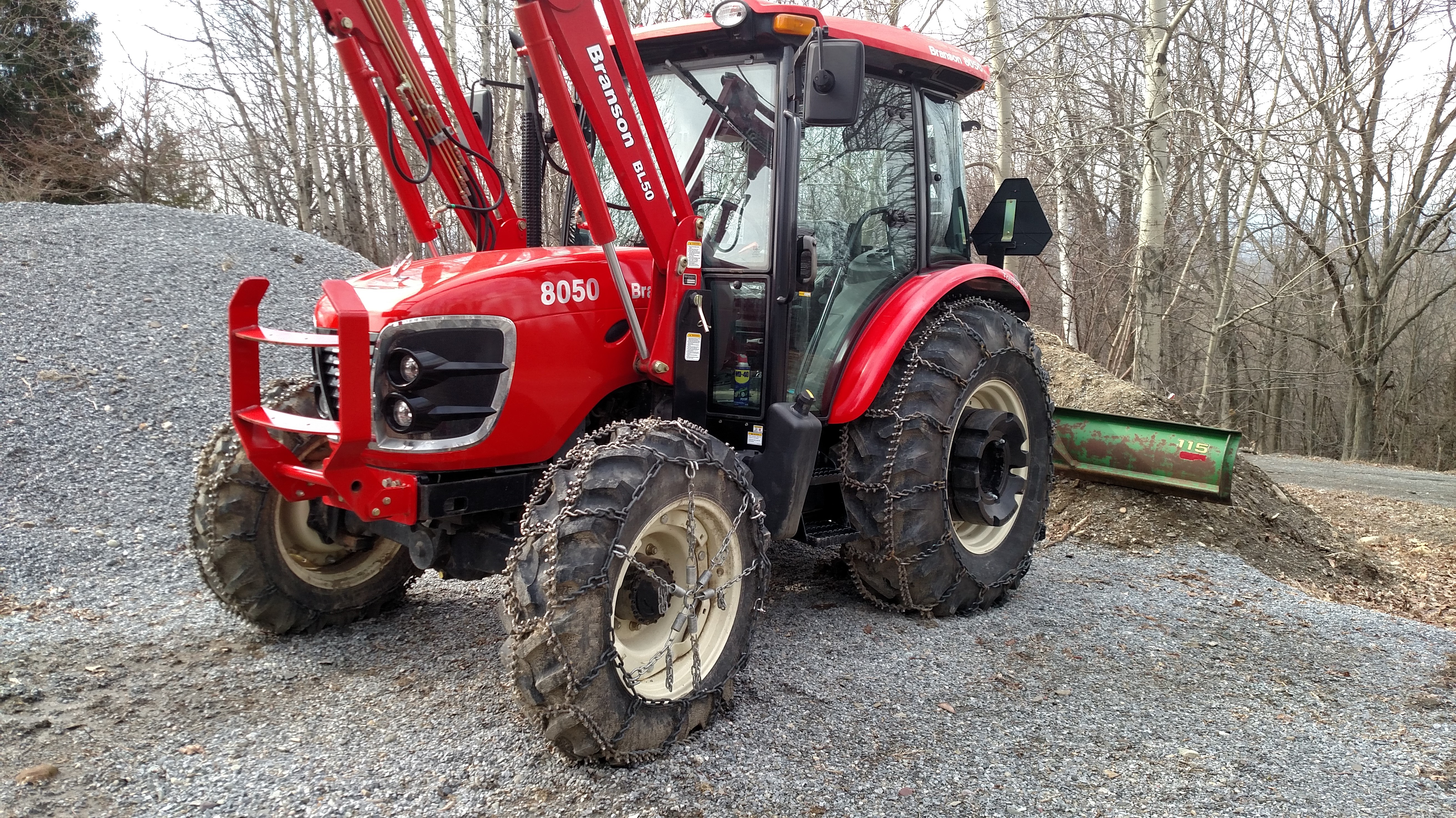

There are numerous threads here on tire chains;
Mnay people will tell you that chains will damage your driveway,
if you are spinning your tires with chains yes you can damage a driveway.
That said with really good chain you will not spin so you will not damage it.
The best chains for a tractor are the Euro style;
such as the Aquiline Talon, the OFA, the TRYGG.
This style of chain will provide the most traction, the smoothest ride and actually do the least damage as any.
Any chain with cross "bar" types of links will ride rough and bouncy, the duo-grip style even more so.
Some of the smaller tractor tires may need to go with ATV sized chains in the diamond pattern.
