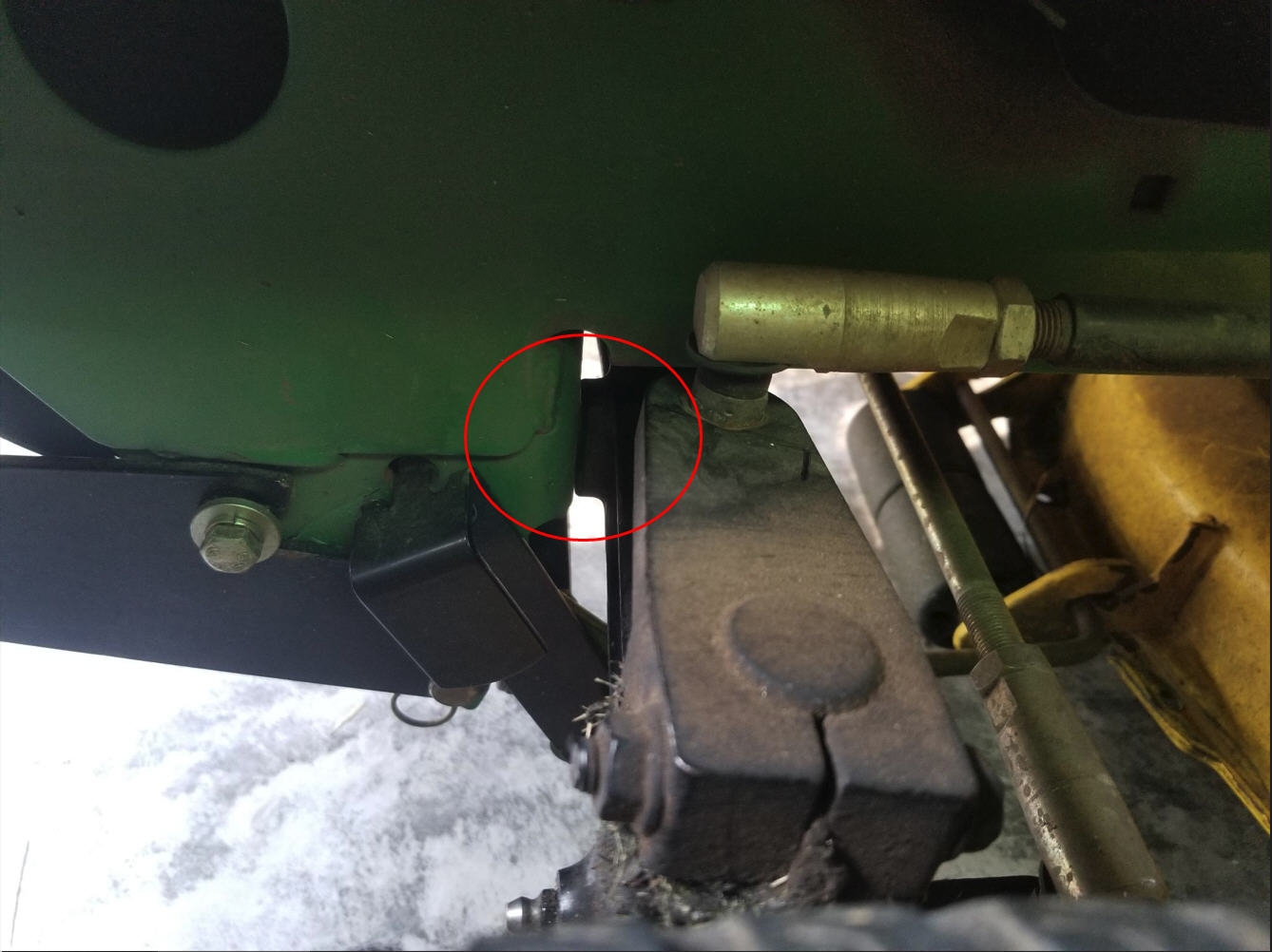

It occurred to me... maybe a pic would help?
There should be no gap between the axle pads and the frame saddle... both sides.

Hi smp22,
Your GX uses an Achermann style steering system. LH/RH spindle coordination is controlled by a straight tie rod. The system is turned by a frame mounted cylinder pushing the steering arm forward/rearward (#23).
So just normal steering imparts the same fwd/rev force into the axle pivot. The axle has outrigger pads on the front side that rub against the frame saddle supporting this action. From your description, the axle pivot has become worn/sloppy allowing front/back twisting movement. As the axle 'floats' it is not responsive to your steering inputs. Result: you can't keep it steering straight!
Test: with the tractor running and park brake ON. Have someone turn the steering wheel left then right. Observe the front axle on the left side of the machine. Do you see the axle move forward/backward much before seeing the front wheels turn? If so, this is the problem.
As mentioned above, the steering is pretty robust and this usually doesn't happen on low hour machines like yours. There is one circumstance that causes it though: a bent axle. It can happen when the steering is at full lock (when it is most vulnerable) and the front wheel strikes something hard. The axle is nodular iron; it can be bent! If this happens, the support pad (on either side of the machine) is bent away from the frame saddle... it now has no outrigger support and wear is accelerated. Inspect both axle support pads and see if it is contacting the frame saddle. If there is a gap, the axle is bent back. Report back and we can offer direction to get you going. Lots to digest here... sorry.

I apologize if I should not be butting in on this thread, but I am experiencing the same steering problem with a newly acquired 335. Mine is doing exactly as you describe, I can turn the wheel at least 1/4 turn and the only movement is the axle moving front and back. What is the corrective action, bushings [item #7] or shaft [item#9]? Once again I am sorry if this is inappropriate.
   / 2005 GX255 - Mower Height and other Qs (54C deck) #18
Same topic... perfectly acceptable!
As asked to the OP: is there a gap between the axle pads and the frame saddle?
If so, the axle is probably bent back. The axle can be straightened and the pivot bushings replaced.
   / 2005 GX255 - Mower Height and other Qs (54C deck) #19
I will check that tomorrow. Mine is just a 335 not a GX335, are they the same setup?
   / 2005 GX255 - Mower Height and other Qs (54C deck) #20
From memory, GX has diff-lock is all. Steering should be the same. Does yours look like the exploded view I posted?
