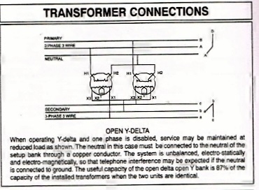

This is a wiring diagram excerpt from the "Electrical Pal" an electrician's pocket reference. This is how the utilities get 3 phase from a single phase primary. Same thing if they do in an emergency when one phase is out. That is why the capacity is cut 57% and it is a grossly unbalanced system; but, it works until someone tries to screw with it or a glitch pops up. Back in the 50s we replaced a lot of AC compressor motors at the utilities expense when we proved their system was at fault. They had a lot of problems keeping the power factor balanced. We carried a PF meter in the truck just for that purpose. Rest my case.
Ron
That's not an open DELTA. It's an open WYE DELTA. And it is certainly not what the OP has. It is not a viable 3 phase in my book for the reasons that you mention. That configuration would destroy equipment, is dangerous, and causes serious line disturbances. Allot has changed since the 50's. Here is an open delta. Three phase in...three phase out, using 2 single phase transformers. It's also important to note that your diagram is still fed from a three phase wye system with one dead phase. It's still a 3 phase system, and the neutral is being used. It would not work for a single phase distribution, that would have only 2 wires.
