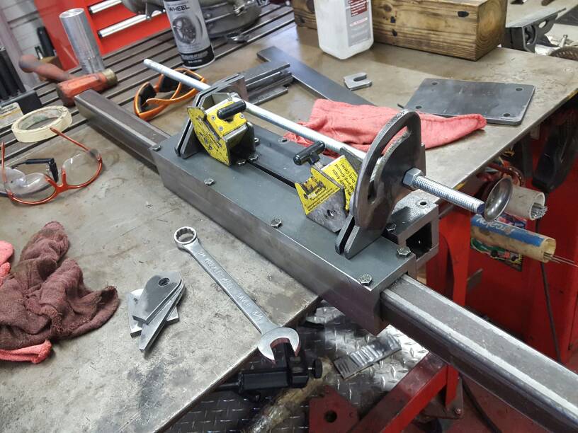

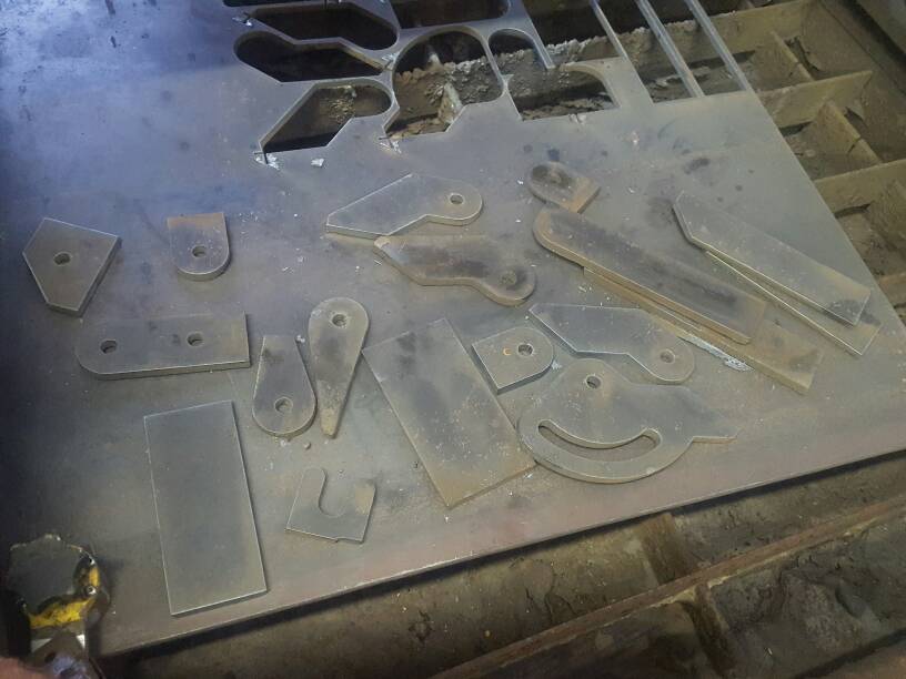

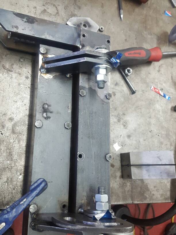

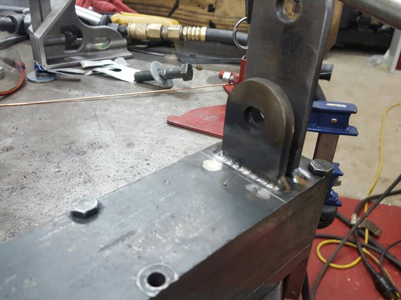

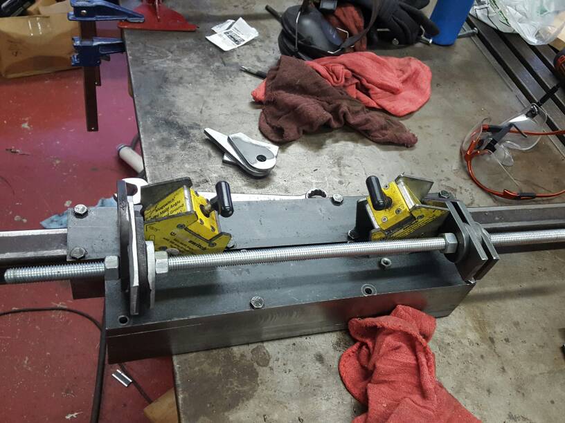

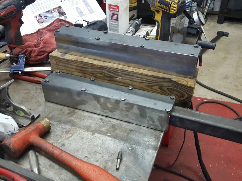

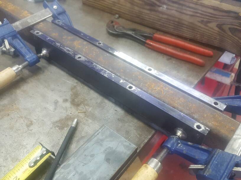

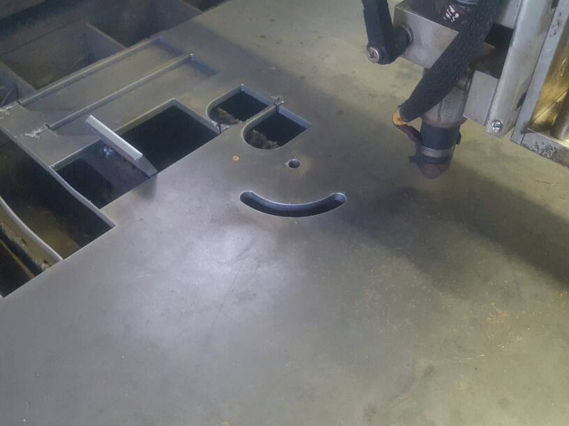

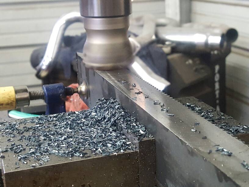

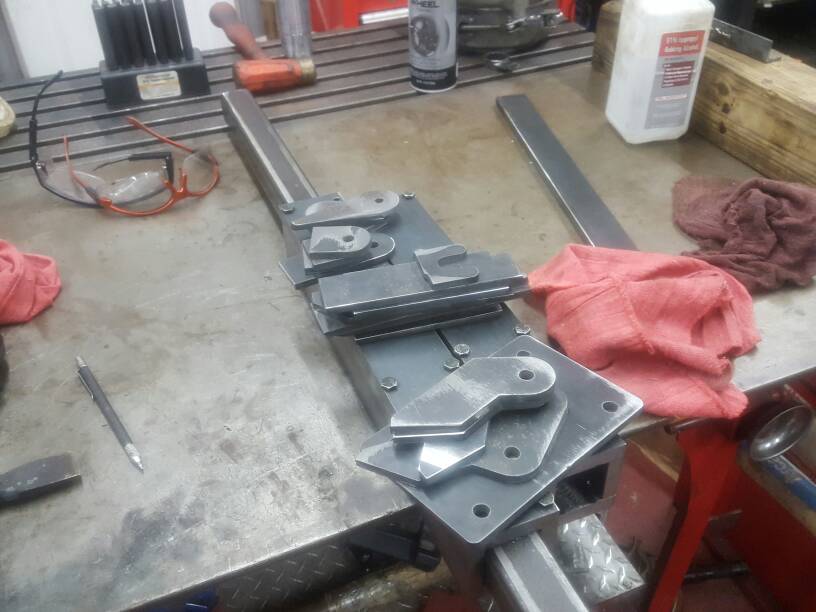

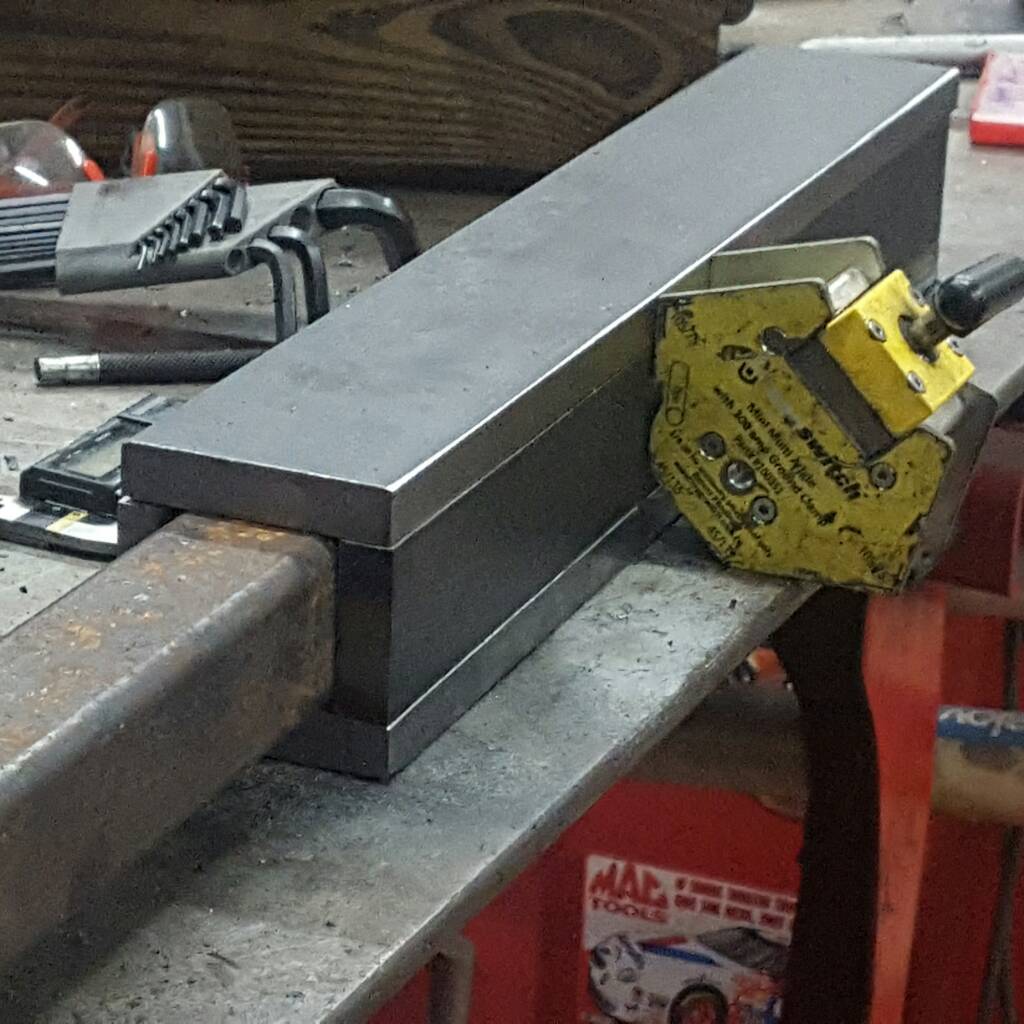

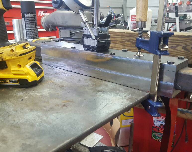

We came across jeremy Schmidt's belt grinder build on YouTube and loved it so we are attempting to build our own. This is what we have so far. Started by machining .500 flat bar to fit properly then drill and tap to bolt it together instead of welding. Then we went to work drawing and cutting all the bracket and tabs, next is to fit it all up and tack it together 20171219_163606.jpgIMG_20171220_180056_001.jpgIMG_20171224_204510_570.jpg20171225_141542.jpg20171225_170515.jpg20171227_144228.jpg20171227_171235.jpg20171227_172151.jpg20171227_172643.jpg20171227_180611.jpg

I like your idea of machining the bar stock to fit and using bolts instead of welding.
/ 2x72 belt grinder build #12
Man that thing looks BURLY!!! Is there a reason you are going with such heavy duty materials?

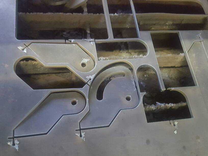

Today's progress on the 2x72 grinder, we re-cut the motor mount plate to make it one piece and cut star wheels for the bolts and tracking adjustment.
I received an email from jeremy authorizing me to reproduce the pieces if you need them for your project, the only stipulation is you have to buy the plans from him 20180107_145019.jpg20180107_154703.jpg20180107_160048.jpg

Yep I will get that put that together, I cut mine from .250 steel and Jeremy's plans call for .375, do you have a preference, it will effect the cost
/ 2x72 belt grinder build #20
Seems like 3/8” is overkill? I’ll have to watch his video again and look over the plans but if you decided to go with 1/4” it’s probably fine. Will 3/8” add about a third to the price, or is it not that simple?
