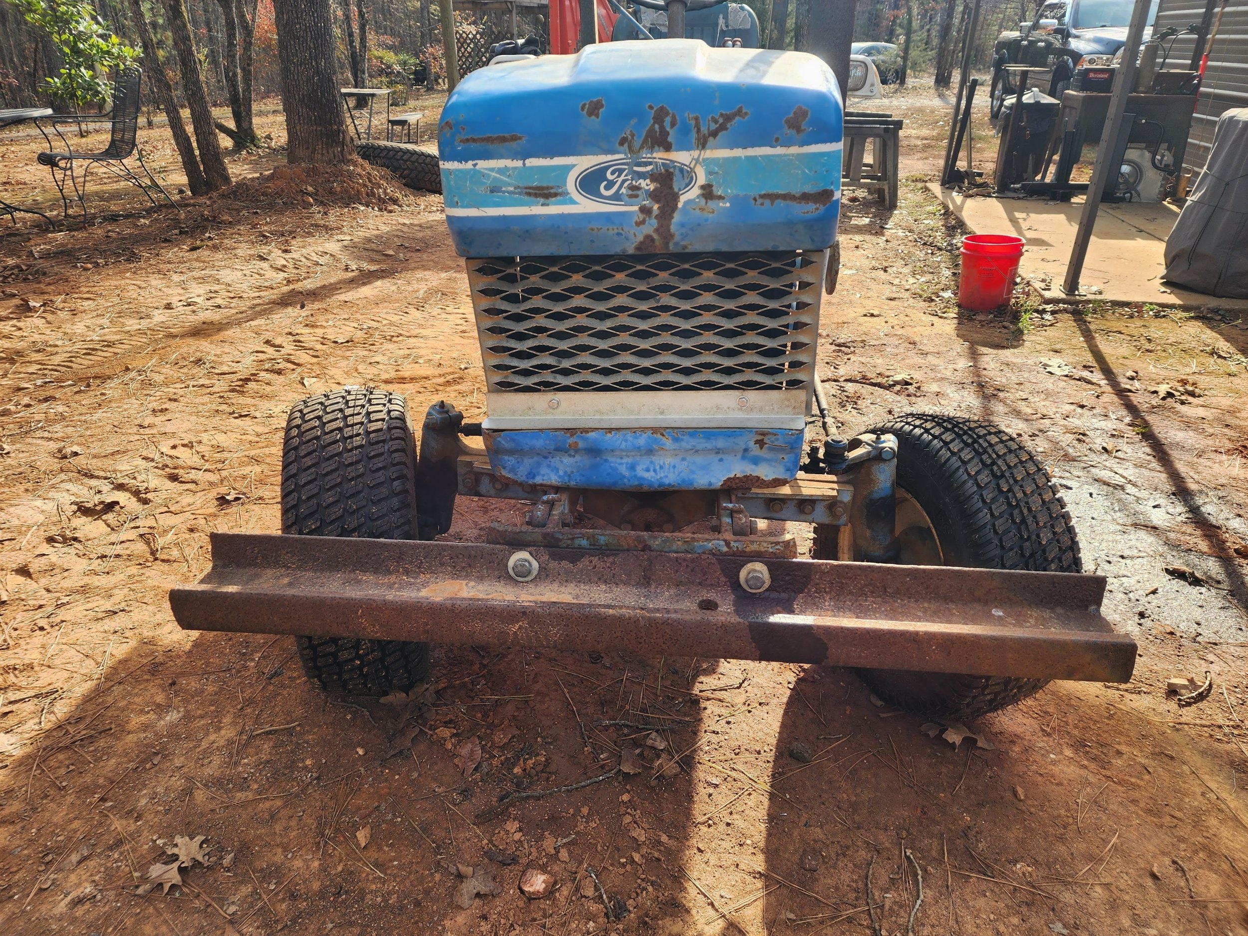

I have the rear tires at the tire shop so I am waiting on them and when I get them on I'll be putting it on the lift and changing all the fluids. It will be ready for him to ride if he can get on it he is 84 years young and not as good as he once was.
Been Done: Radiator flush and fill, new front tires, home made grill that helped line the hood back up, new fuel filter, air filter

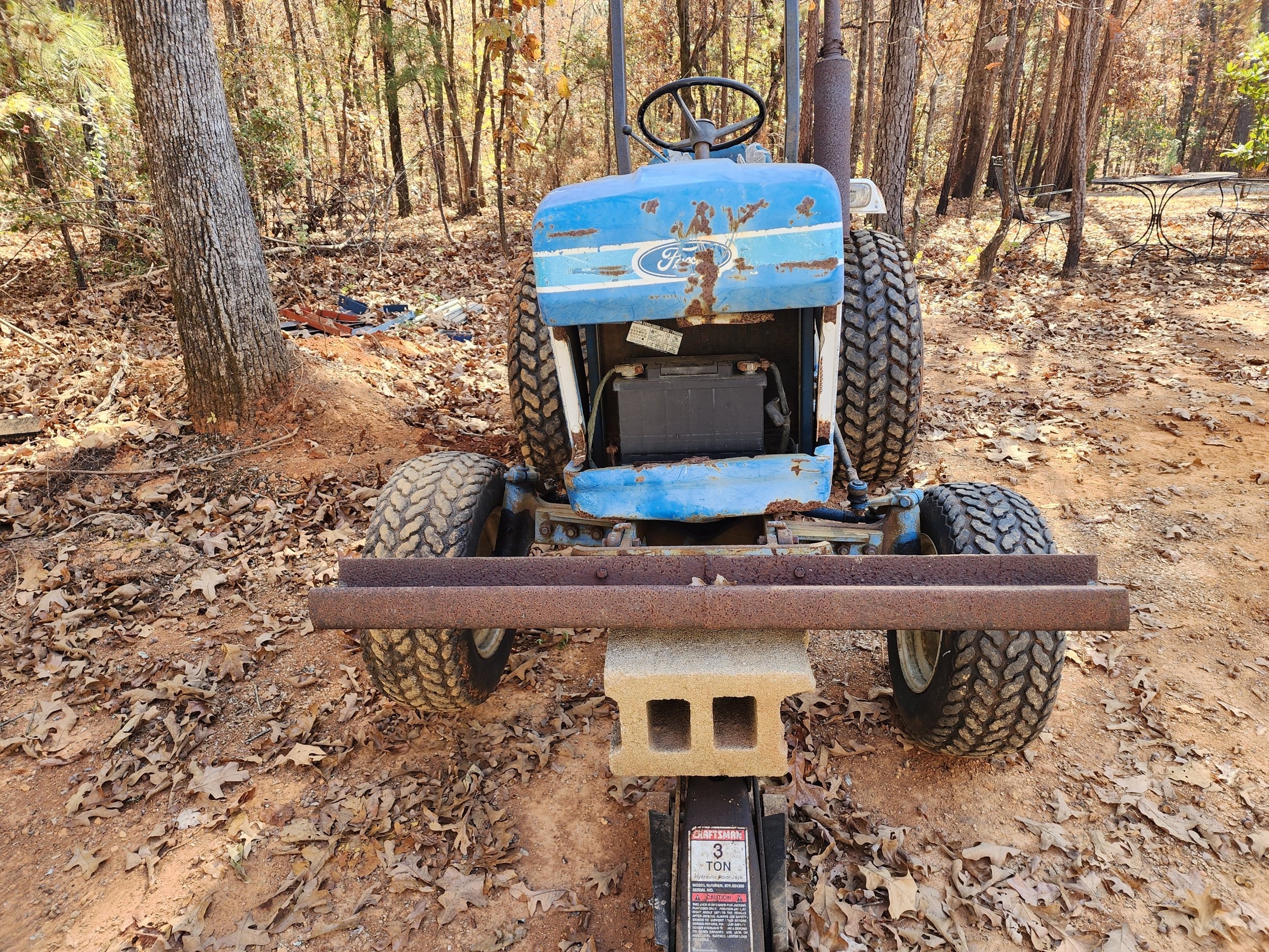

Got the rear tires on and in the shop for the fluid change.
/ 1986 Ford 1510 #29
This is closing the barn door after the horse is out, but you should have painted the wheels before the new tires went on. Project is coming along nicely though.
That’s looking good. Getting some new treads and straightening the hood made a big difference. Did the rims straighten out enough to not need the tubes?
You are correct and I thought about it but didn't do it, I didn't take off but one tire had to let the tire shop do the other and I had to leave it with them so I could have painted them but didn't just being lazy I guess.
