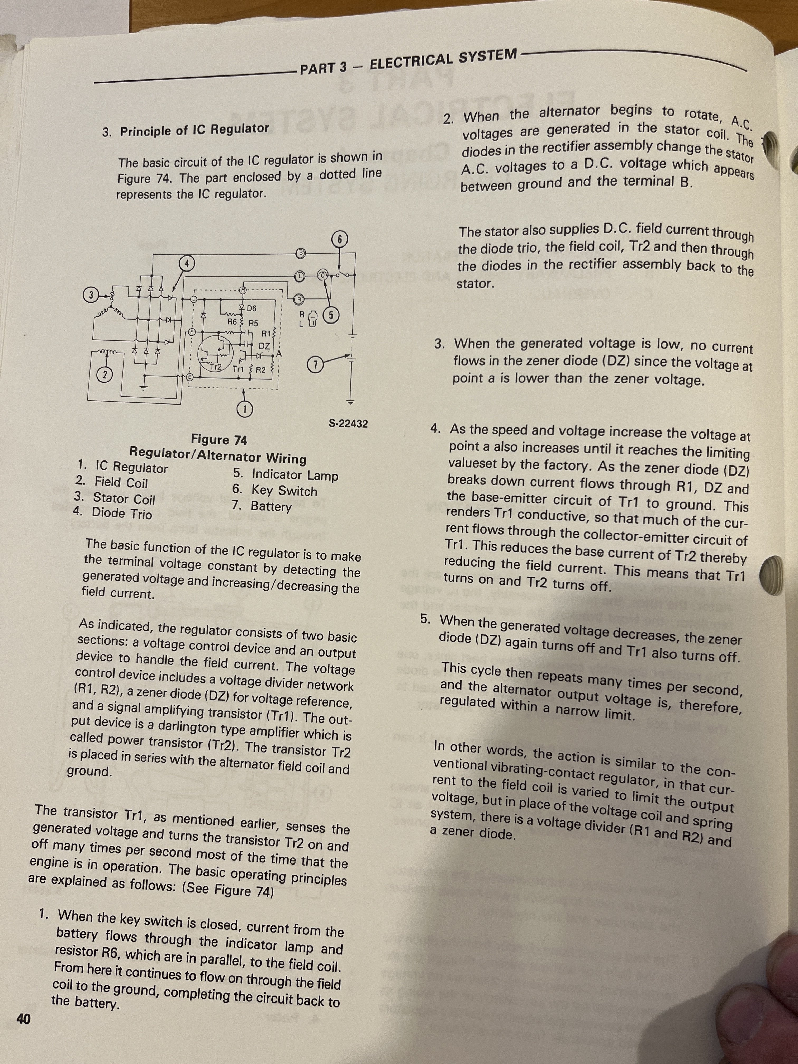

It's not the tach. The tach is mechanical, i.e. cable operated. The wire going to the dash is for the battery charge indicator light. Attached are a couple pages from a 1520 service manual showing some alternator electrical detail. I believe a TC 30 is the same so should work with your TC 30 general wiring diagram.
Thanks. I'll see what I can do with these. Also, I knew the tach was mechanical as I have disconnected it to get the panel off, had a brain timeout on that one. The other small wire ends up in the seat safety switch timer.

Update for what's its worth. Hooked the alternator up the usuall way-not the way it was wired when I took it off. Started right up and ran 14+v at the battery when running. Best we (my aircraft mechanic son & I) can guess is the previous owner had either fried the alternator or it quit working and they just disconnected almost all of the devices drawing current to keep the battery from discharging too fast since the engine didn't require a spark. No lights, instrument panel, safety switches etc. Problem now is lights and fuel gauge still don't work. Several harnesses were disconnected and trashed so guessing the circuit for the gauge and lights is broken by one of the missing harnesses. Will try to track that down but any advice on where to start on that is appreciated.
