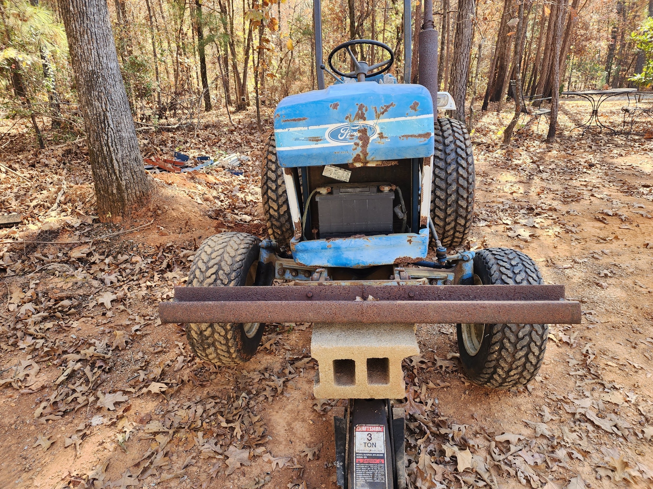

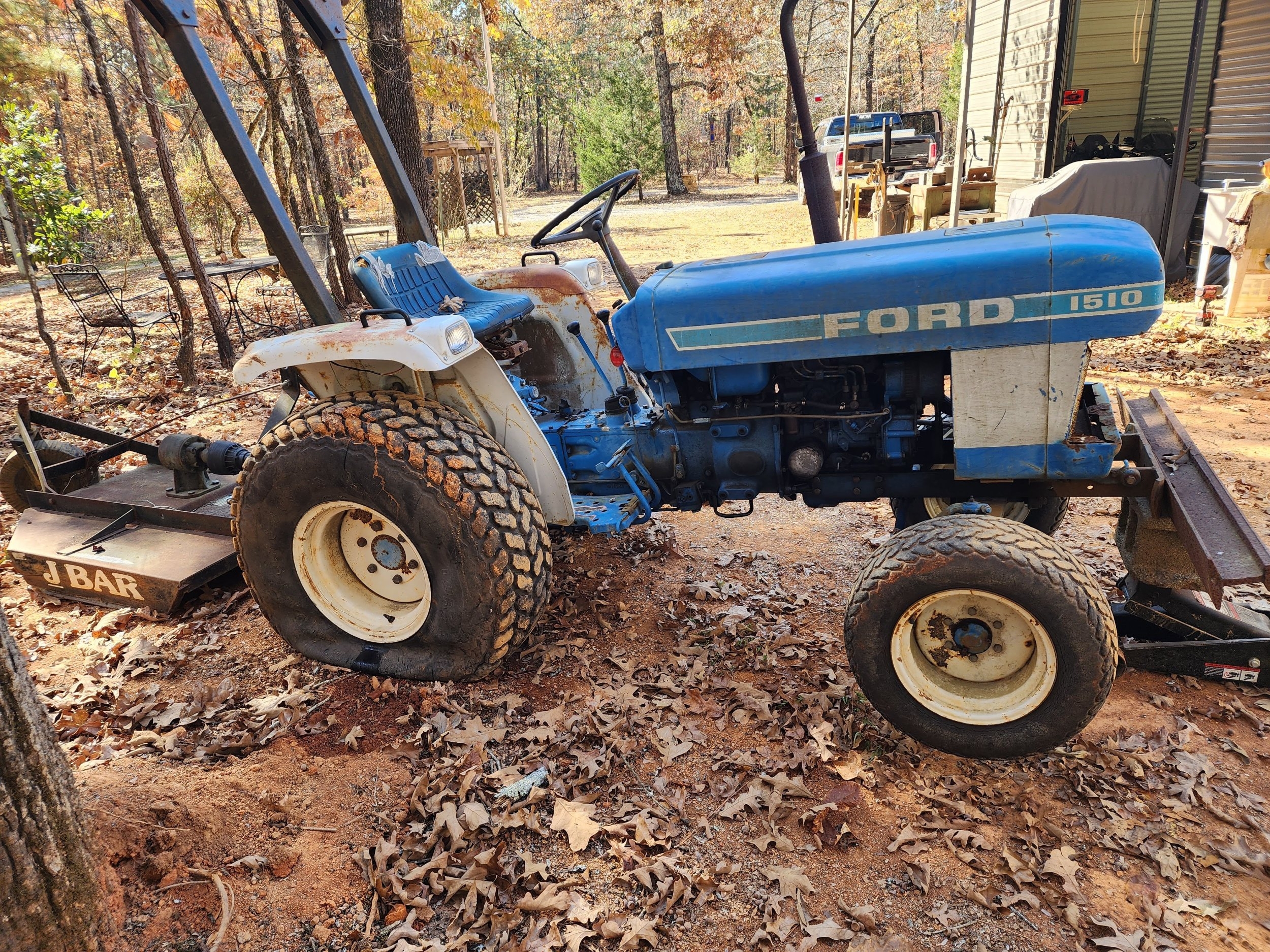

My Dad has decided to down size and basically get rid of everything he didn't have to have, and I got because no one else wanted it a 1986 Ford 1510 in pretty sad shape. I may not restore it to it's former glory but I will restore it to working condition. 20231107_103135.jpg20231107_103118.jpg20231107_103150.jpg

first things to do is new tires, that is why I have it raised up so I can get the front tires off. Then I can get it in the shop for a complete oil and hydraulic oil with filter change.

Yes sir I looked at Tractor Supply and they are out of the manual that covers the 1510, so I'm looking for a PDF I can download or I may check a different TSC later. I put new front tires on yesterday and found something to build the grill out of, but since I have been real busy helping my in-laws on some house repairs it's going to have to wait a little longer.

Well I done it now I was trying to break down the rear tire and bent the rim with the bar I was using after bending it in a couple of places I got a little to rambunctious and when I was done I think I need a new one. :mad:

I have not found a replacement wheel yet, I have two new tires so I'll have to stay with the size wheel/rim that I have. Today may be Hammer Time and see if I can make that wheel resemble it's former self. :)

Got the wheel beat back in shape but it will have to have a tube from now on. The numbers on the Wheel/Rim are W11x16 0587 Japan. I believe it is referred to as an AG wheel
