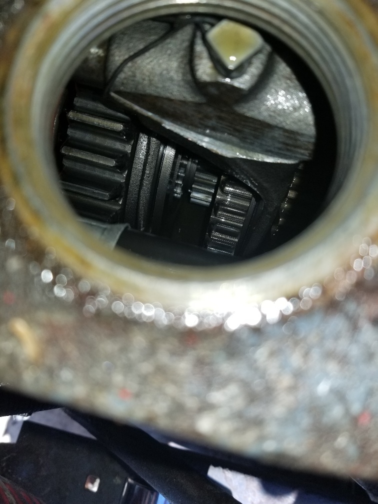

Ok i have a 135 Diesel that just barely started then stopped abruptly. I pulled the starter and i can turn it over about 1/8th of a turn then it stops and i can go back the other way 1/8. I pulled the valve cover first and saw nothing awry. I then pulled the head. Still nothing. I pulled the sump and still nothing. No metal in the bottom either. Any ideas where to go next? I appreciate any advice I can get. Oh the alternator / fan turn freely as well.

Is anything attached to the PTO? Can you turn the PTO?

Was the clutch done ? Lockingplates reinstalled ?
Ok no clutch work done and nothing hooked to the pto and it turns freely with my hand. I had my wife push the clutch down and with it down i can turn the engine over.

Mf 135.....dualclutch....did she push it down all the way or only the disengage the gearbox ?
Mybe the gearbox gears is lockeg in 2 gears ?
Can you turn the engine with the clutch down? You haven't the classic MF fun of getting it in to two gears at once?

Ok ! When opening the gearboxfillerhole there should be a squer lockbolt right in the middle of that hole . If not .....lever it just a little to get it in the middle. If it is in the middle....look down into the hole...you will see a big gear on the clutchside to the front...shift that gear to the middle of it's travel to get neutral.

Ok Which one is the gearbox filler hole? I just tried again and as soon as you feel some resistance in the clutch i can turn the engine over. In the top 1/3rd of travel i'd say. That and the fact that i was able to roll the tractor with my trucks help tells me its not stuck in a gear. I think?

I think you locked it in gear AND sheer the sheersleeve that connect the box to the diff ?

I wouldn't be able to roll it if it was locked in gear though right? I took this pic through the hole. It appears to move between gears ok. This pic is neutral.

Hey ya still :( Check this out. I found these marks / cracks with a Borescope. This is looking forward from the fill hole. This has to do with the Multipower I think?
