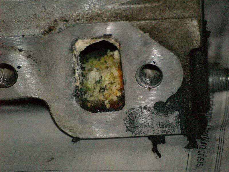

I am not a member and can not access pic. My deposits when dry look like wall joint compound and gritty, caukly

That's weird. I can see them without a membership. In the posts the deposits almost look like spray foam.

I just had another radiator flushed & refilled with the 'long-life green' stuff which IS compatible with the other, older green glycol/silicate coolant. (IMO, using orange or purple just begs confusion by anyone topping up a system.)
The crud in the linked pics reminds me of what happens when fatigued (but not 'silicate'?) coolants lose additive strength and aluminum reacts galvanically to grow it on itself or migrate elsewhere. (Hey remember when the guy who pumped your gas and checked your oil trickled your coolant onto a refractometer to check its PH? How did that simple thing this ever get away from us??) Anyway, the non-green coolants are presumed to need less additive endurance to be aluminum-safe (galvanic corrosion) over their 'long life'.

HOAT mixed with OAT damage.
Glycol and OAT
I see them too and I think you got it. I hope I'm wrong.

Ok, so "assuming" that the A/F used here was ethylene glycol based then the participate must be from a foreign material being introduced into the cooling system. A blown head gasket would be my guess or someone introduced something. The lab analysis would tell what was going on.
Fleet charge probably doesn't make their own A/F and buys it from a formulator/bottler (hopefully not from China) who either uses fleet's formula or their own with a customer spec'd dye. In reality, there could be a few formulators for any given brand for the same year.
/ $1000 Coolant Change #52
It's also possible that there was a labeling error, although that happening is very unlikely. The one thing that makes me think there's an engine problem is that the OP used the same brand as before, PLUS he flushed the system until clear water was present.
If you mixed the two antifreeze types half and half, I'd say you'd have a serious problem. In this case, there would have been very little if any of the original coolant left in the system. You might see a few traces of odd looking coolant, not the crud he's described.

There is another possibility, the OP mixed coolants by accident. I've done silly stuff before also.

I think I seen a program once, where they showed Kubota plants pouring a "stop leak"
solution in the rads at the assembly plants as a safety precaution.
This one may have gotten a little too much.
I think the OP did everything normal, something else is at play here.

Except that this wasn't the OEM coolant, this was at least the 2nd coolant change (per the OP).
