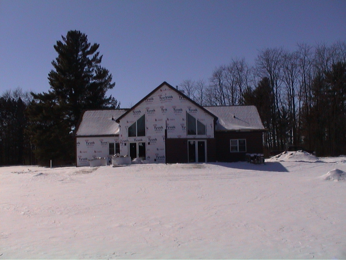

I think $100 a sq.ft is pretty good estimate. I just did this in Wisconsin 2 years ago, so my numbers are fairly recent. We built 2650 sq.ft lodge home and we spent roughly $100/ sq. ft. by time we blew through fixture allowances, made as built changes, and hauled in dirt and stone for final grade and driveway. PM me if you want any info

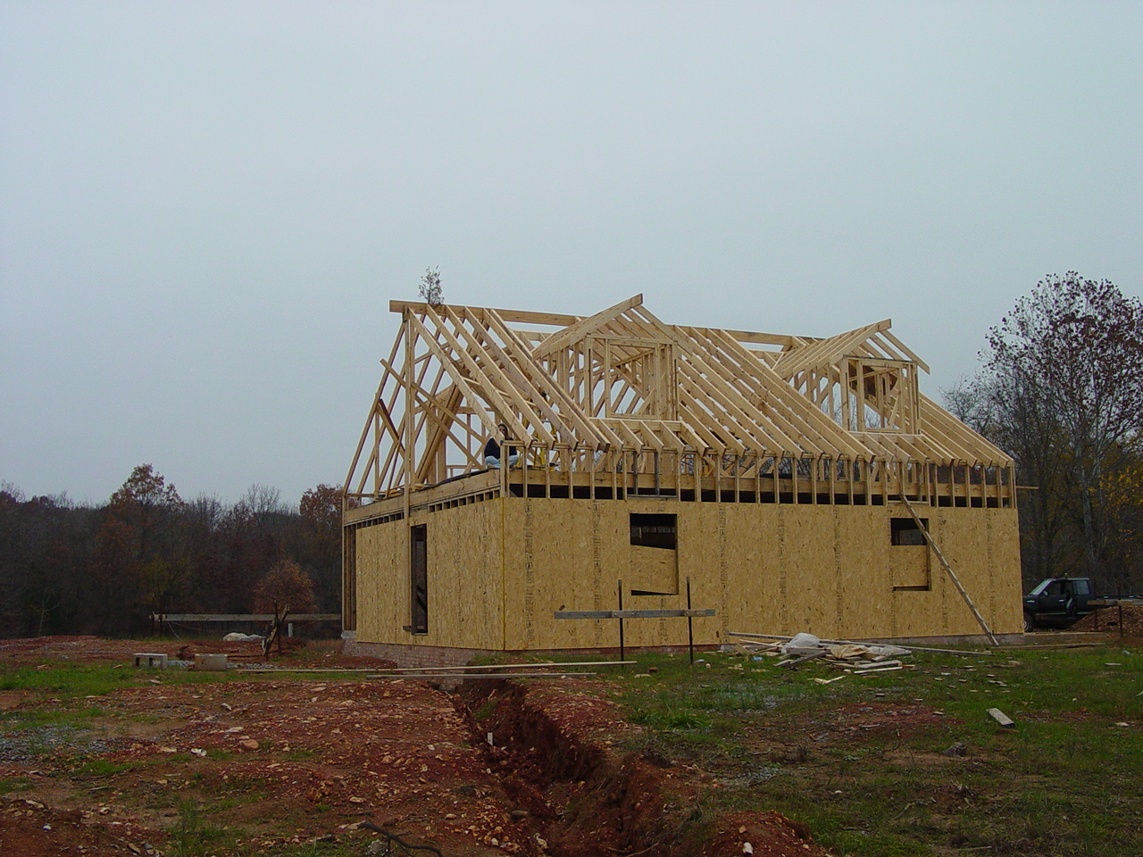

5202 is when we were framing

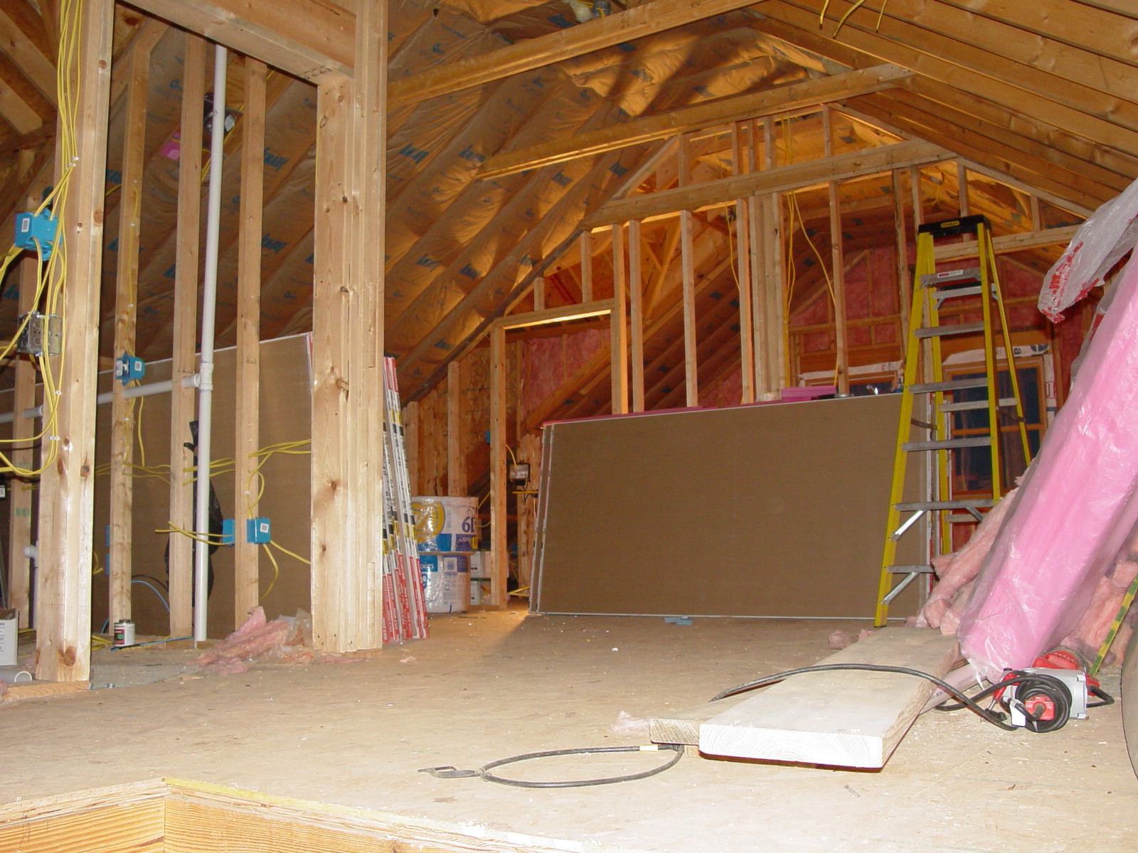

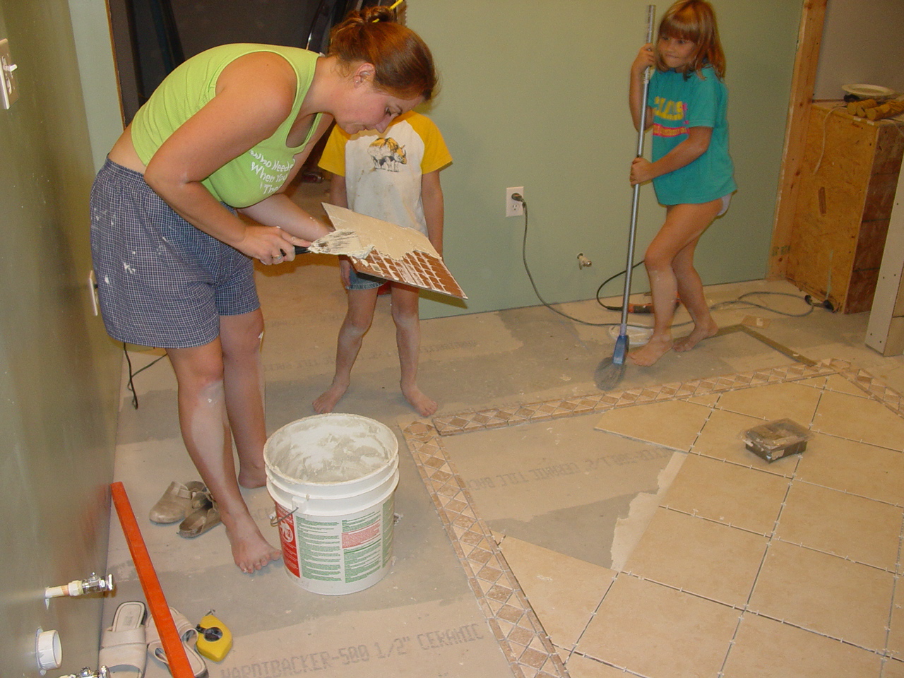

6291 is tiling above the shower (with two shower heads, no less)
6045 is plumbing/framing/electrical downstairs
6046 is plumbing/framing/electrical upstairs

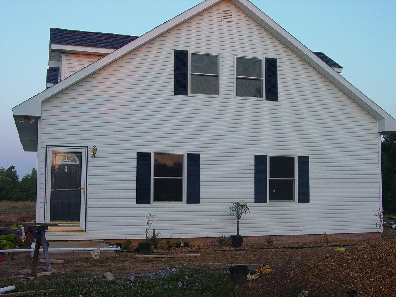

6411 is the front view
6414 is the side view

Building the cabinetry is far and away the most gratifying/fun part of this whole process. We had planned on purchasing cabinets, but we looked at the box store cabinets (expensive junk), local discount outlet assemble yourself cabinets (cheap junk), and even allegedly Amish built custom cabinets from a local shop (that still used particle board shelves, plastic corner braces, $1.89 drawer glides, etc). I was disgusted I decided to build them myself. We purchased rough red oak and maple from a saw mill, stickered it and let it dry, and I got to buy table saw/planer/jointer/drill press/compound miter/molder/lathe/bandsaw/sander/etc. for less than the price of the cabinets from any of the sources. I even learned how to make dovetails for my solid maple drawers and raised panel doors, etc. I still have so much more to do and so much more to learn, though.
Also, a bit of an explanation - this house began life planned as being a garage for a larger house to be built several years from now. That may help to explain it's boxy shape and concrete floor. Years into this process, we have realized that while we may indeed (probably will) build the larger house, we will never convert this house into a garage (way too much emotional ties from building it from the ground up). In retrospect, I would have done many, many things differently that would improve the look of the otherwise boxy house, but I am overall still very happy.
The run up to building this house was that when we first married, we purchased and renovated a 1971 12x56 mobile home and set it on the farm for about $3,000. We have saved our pennies since then, and the house, as it stands now on land that we own, is free and clear (i.e. no mortgage). It is not perfect, but it is ours!

The backerboard is there for tile work that will be installed after we (build and) hang the upper cabinets. I don't know if we had to, but we (my wife and I) have recently completed a tiling job at a nursing home shower room that just had green drywall beneath the tiles (except in the shower stalls themselves - thank goodness it had backerboard). The tile was falling off the walls where it was just on drywall (in fairness, this tile is probably 12-15 years old, so maybe that is to be expected). Just for the slight increase in material cost (and aggravation of installation), I'd rather go with the backerboard.

In wet areas, like bathrooms and especially showers, cement based backer boards are the only way to go. Green board is for the surronding areas in high moisture locations like the ceilings in bathrooms due to steam and condensation.
Kitchen walls don't have these issues and backsplashes are considered decorative, not wet areas. What you have is great, it's much, much better then you needed. I just wanted to point out that it's not required and you could have saved some money with regular sheetrock.

I did notice in post #30, picture #6046 you're ready to put up sheetrock but you don't have any protective plates on the studs where the pipes run thru to prevent driving sheetrock screws through the pipes. Then I thought I hope he doesn't end up with any leaks. BTDT

****, I attached the wrong photo. DUH!
http://img.photobucket.com/albums/v309/IllMarty/frontright.jpg
http://img.photobucket.com/albums/v309/IllMarty/DSC00076.jpg
http://img.photobucket.com/albums/v309/IllMarty/IMG_0311.jpg

For the most part, I didn't have to use any protective plates because the wires/piping in the walls were in the center of the studs. I used 1/2 drywall and 1 1/4" screws, so as long as the pipes/wires were more than about 7/8" from the edge of the stud, I didn't have anything to worry about. I punched the hole in the drain line boring through the studs with a hole hawg when I was running the electrical lines. It was just a little bitty pinhole in the side of the 4" soil stack (but it still leaked a lot!). I did put protective plates over several spots in the kitchen and lower bath where I couldn't get them in the wall far enough to suit me.
