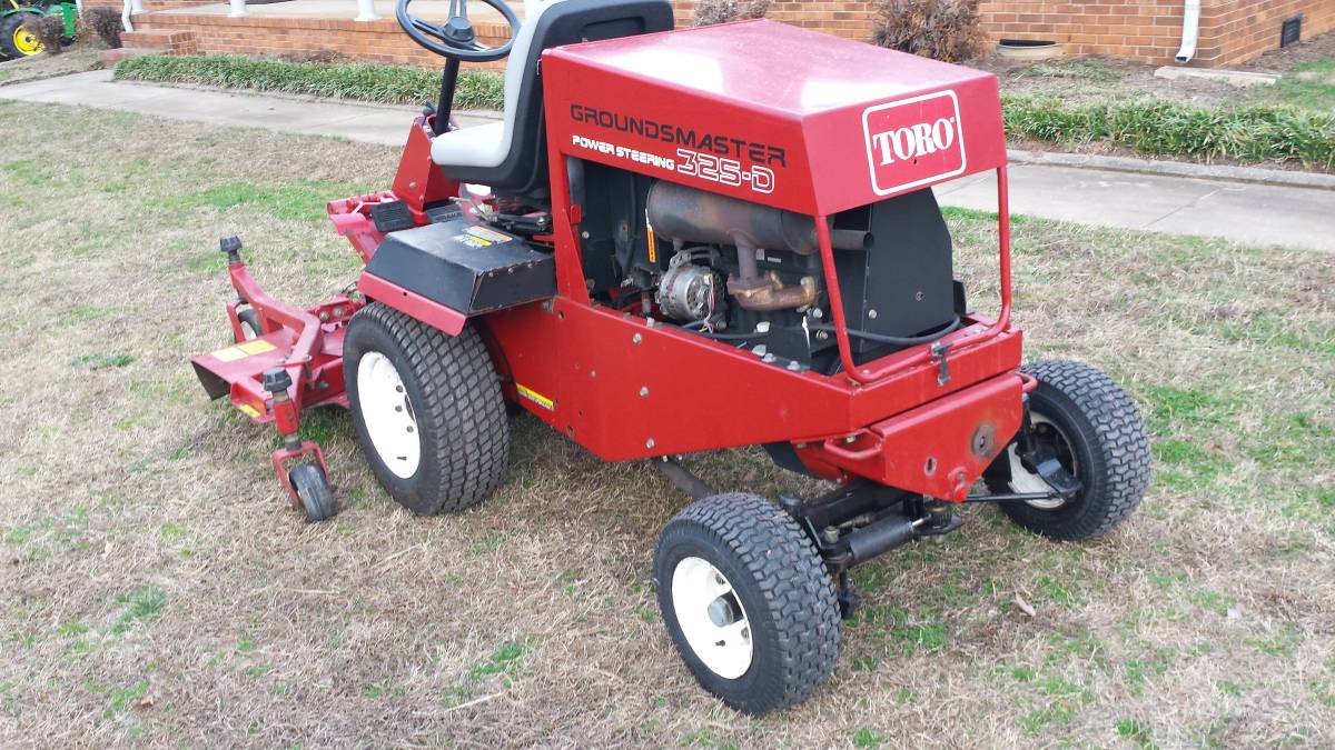

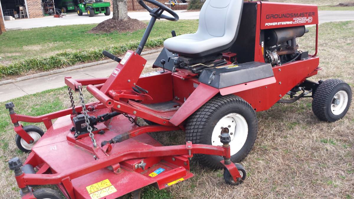

The cub cadet system is different than anything on the market to my knowledge. I currently use a Toro Groundsmaster that has power steering and turns only the back steering wheels. The drive wheels just drive and do not pivot with the rear steer wheels. I get very little tear out in the yard and with the offset deck I can almost turn around 180 degrees and meet the uncut grass like a zero turn. I know that it is an odd booger but meets my needs very well.
Turby's that is one serious mower, front pto and all!
Very nice commercial grade unit, no junk there!:thumbsup:
