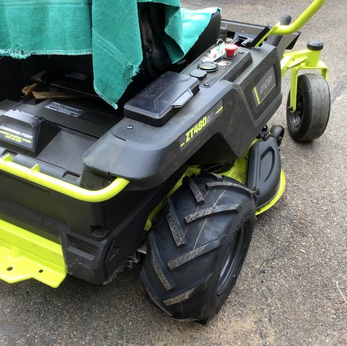

Bought a Ryobi ZT480e last year. Replaced tires with these this year. Can do 1/2 your lawn in one charge.

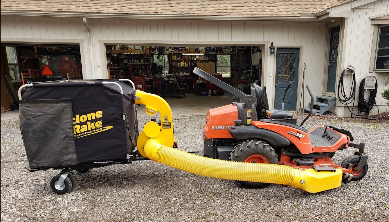

I "converted" my backup zd326 to slope duty by adding Chevron type tires, and filling them with 140lbs total of fluid. It sticks pretty well on slopes now.
I have been really tempted to get a Cyclone like yours for fall leaves. How do you like it?
