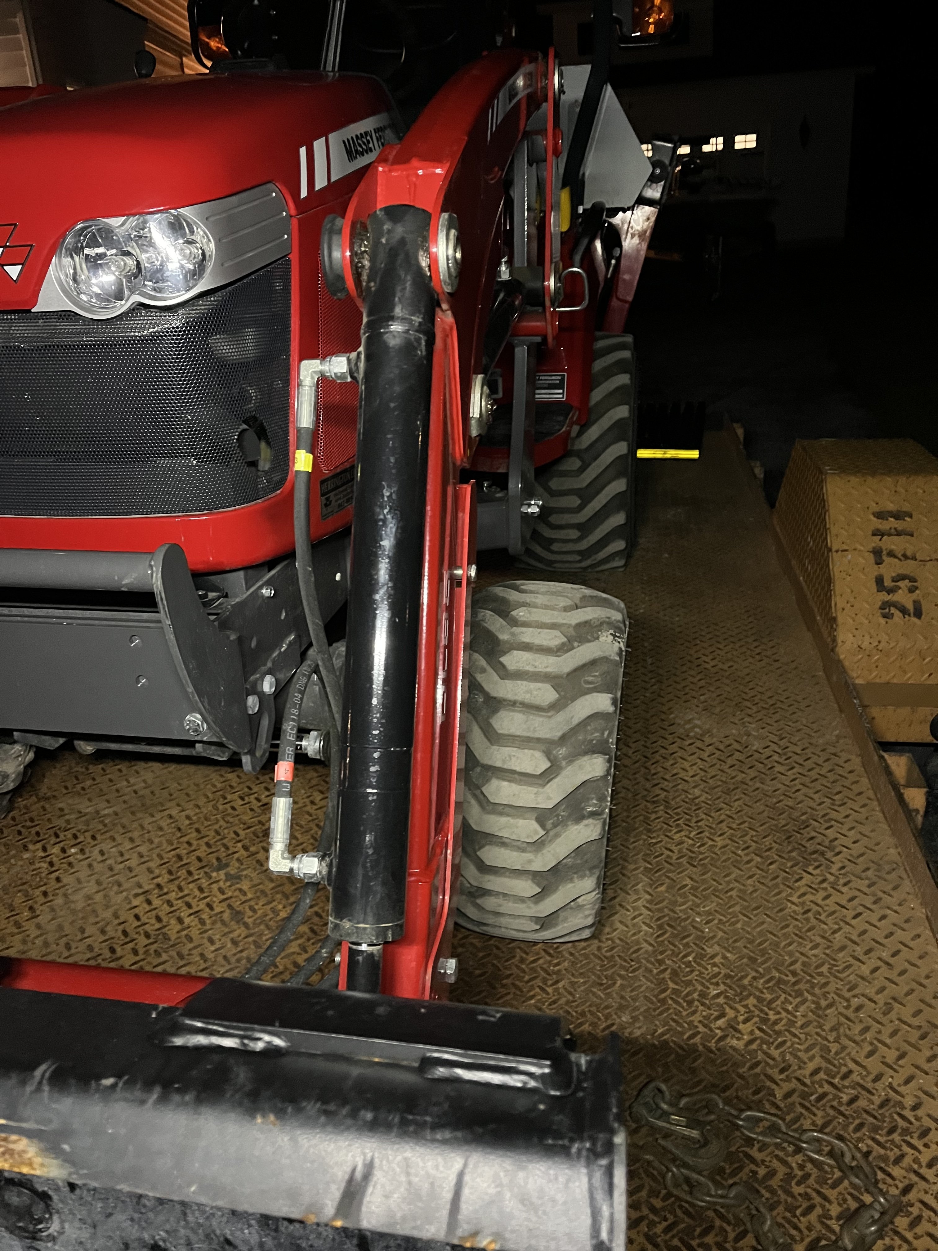

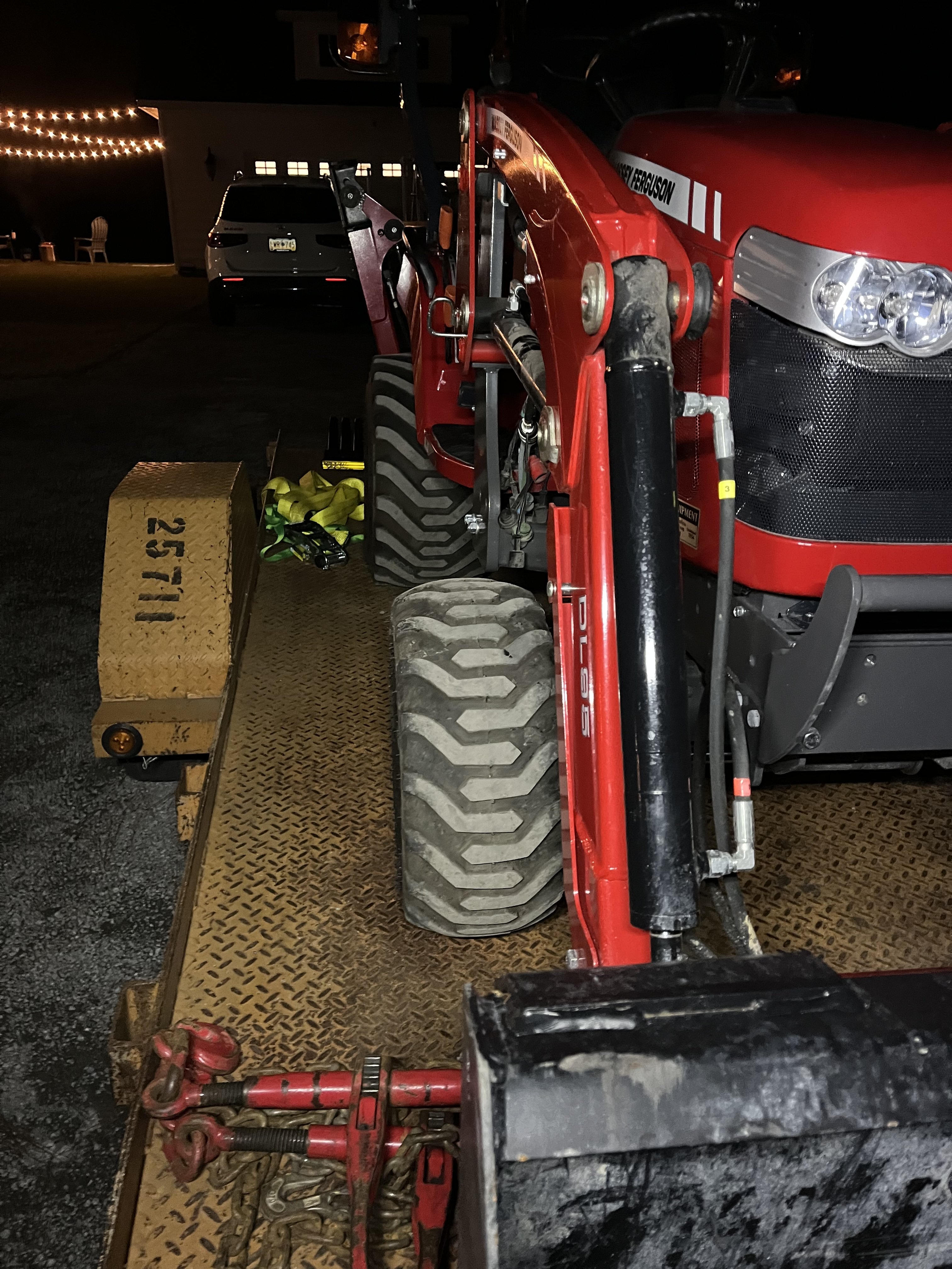

When you get it home, raise the bucket and take pictures from the front so we can see both wheels in relationship to each other. I couldn't discern anything from your pics.

Probably is nothing, it seems most(all?) tractors have some positive camber on the front tires. Pickup the front tires off the ground with the loader, and give them a shake in all directions, see if there's any play at all(should be none), give them a spin, maybe the one wheel did get a bit bent somehow? You probably would've noticed on the test drive. The axles are so short on our tractors that I don't think they bend very often?

Yes, I see what you are seeing and have no idea why. In a perfect world both wheels would be the same - but it may mean nothing or maybe just how it is sitting. We need more info, go ahead and follow the good advice from Indyfan.
Use down pressure on the bucket to lift the front wheels off the ground.
Then support the front axle in a couple of places with the wheels off the ground so that you can then lift the bucket back up leaving the wheels off the ground. There should be a saftey on one of the bucket lift arm cylinders as well - ALWAYS use that safety, or something that does the same function to block the bucket up too.
Never trust hydraulics not to fall. Not all FEL buckets will stay up reliabily. Most do, but failure is immediate. And many will slowly leak down to sneak up on you while you are under there. You do NOT want to depend on the hydraulics to hold anything up while for any length of time while working on it.
Then as Indy says, after blocking things safely you can shake, photo, tighten, and check. Grab a square and see what you find. You may want to swap front wheels side to side and see if that changes things - in fact that's a good idea.

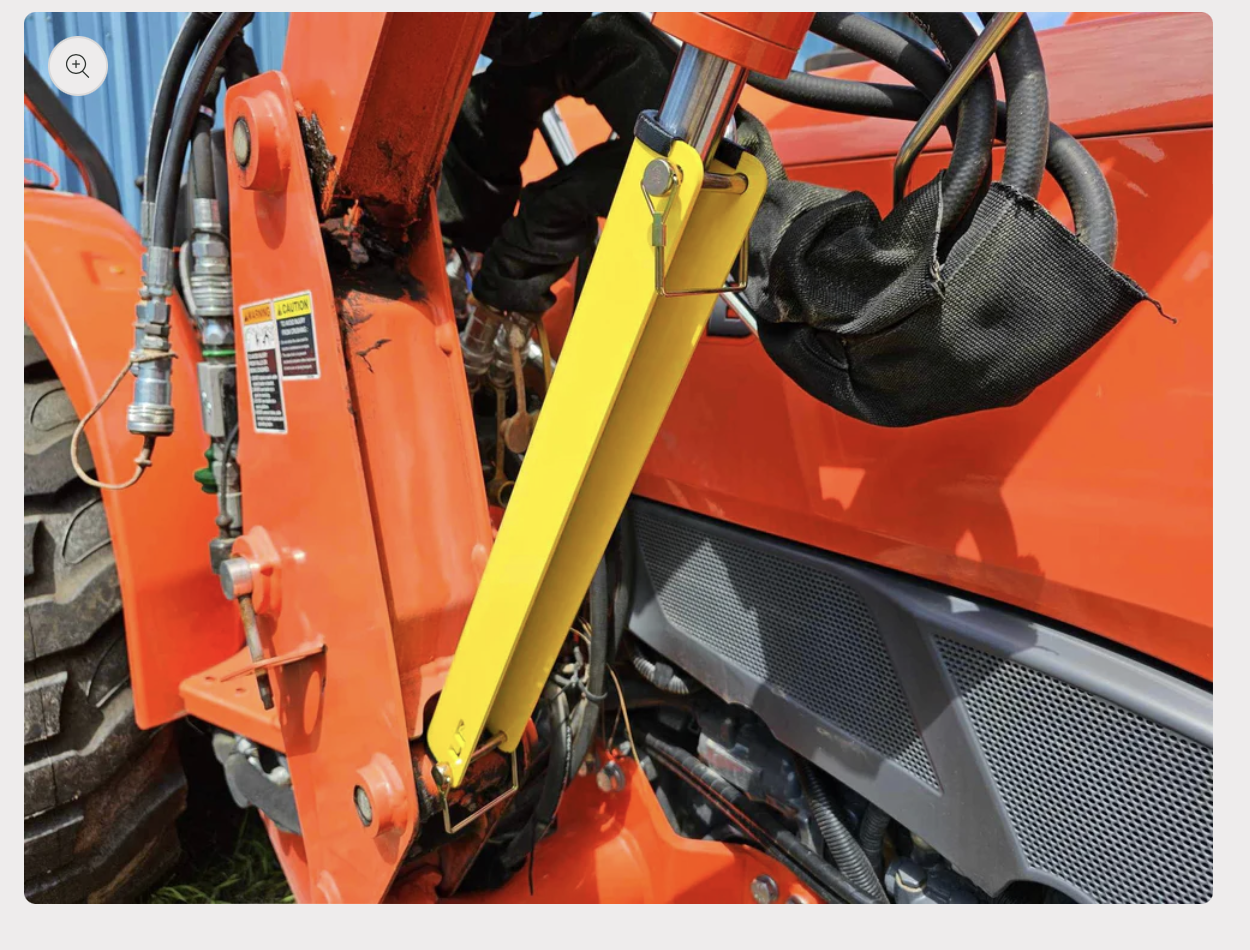

AND you will want a "front end loader lift arm cylinder safety prop" if yours does not already have one built into it as part of the loader. Some do and some don't, but all should.
Here is a photo; frankly the online price seems high but I include it to show you what it is.
You end up using that safety prop more than you think. It makes opening the hood to check and clean engine filters and such so much easier.
It is common to have a prop on only one cylinder. The prop can be a simple piece of angle iron or channel iron cut to length and a couple of straps to hold it to the extended cylinder rod. I'd say to go with something thicker than 1/8" wall iron just to be sure. If lighter, use one on both lift arm cylinders. Even a piece of strurdy lumber would be better than nothing. It does need to be strapped into place against the cylinder rod or risks popping free.
To use, raise loader to about 3/4 full height, insert prop, turn motor off, lightly feather the control to allow the loader to come down slowly until it traps the prop. Then examine what you have with a critical eye. Yes, one end of the prop often rests on the end of the cylinder...that's OK, just make it miss the seal.

So, if I butterfly your pictures, are you saying the left wheel leans in with more camber? Or you talking about toe in?

I dont see the difference. The photos were taken from different positions, angles. Park it on a level surface. Lift the loader out of the way, and look at it directly head on.
Like I've said. MAJOR damage would have to occur to CASTINGS to cause an actual issue.
This isnt the first time this question has been posted, and in each case, it was an illusion. You can't expect them to look the same, while taking a photo from two different angles
