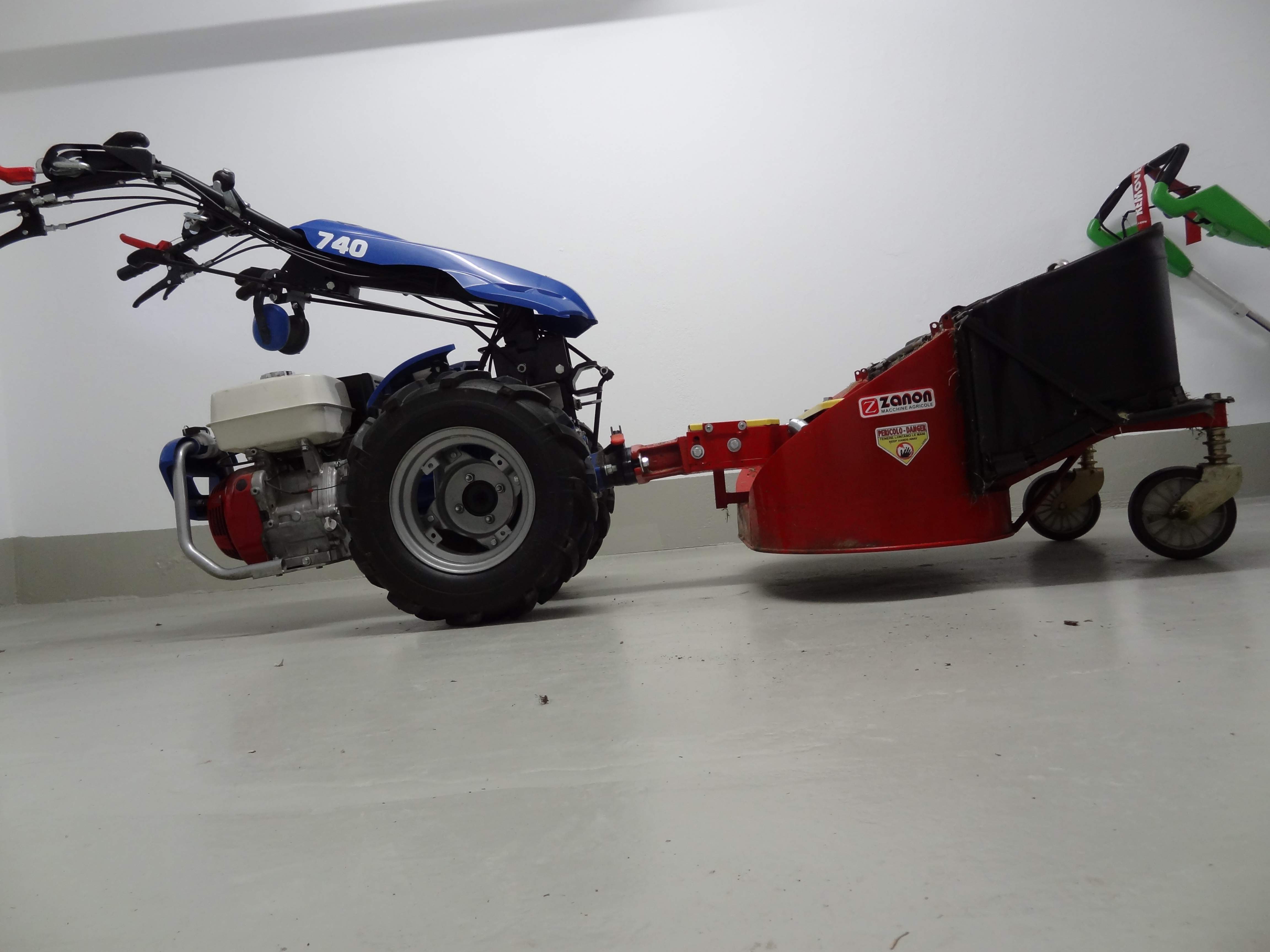

As I do not have much to add to my previous comments this year, I can offer a few photos of the mower in action instead.

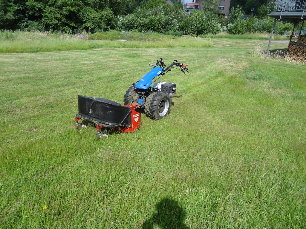

My lawn is around 1,700 square meters, or around 18,000 square feet. Depending of course on the weather and thereby on the growth, I try to mow around once a week during the season. I usually spend 1 1/2 hour or a little less mowing the entire lawn then. I am glad, that the 3 photos above does not show the normal growth in a week, because then you would be right - then I really had a lot to mow ;)
I took the photos in the summer of 2013 after coming home from a 2 1/2-week vacation, in which time the weather at home had been warm and rainy, and the lawn had grown to around 30 cm (1 foot), as mentioned in the first post in this thread. I normally always mow in third gear, but due to the large amount of clippings then, I spent 6 hours mowing in first gear! The mowing of course took longer driving in first gear, but as you rightly indicate, emptying the bag took forever.

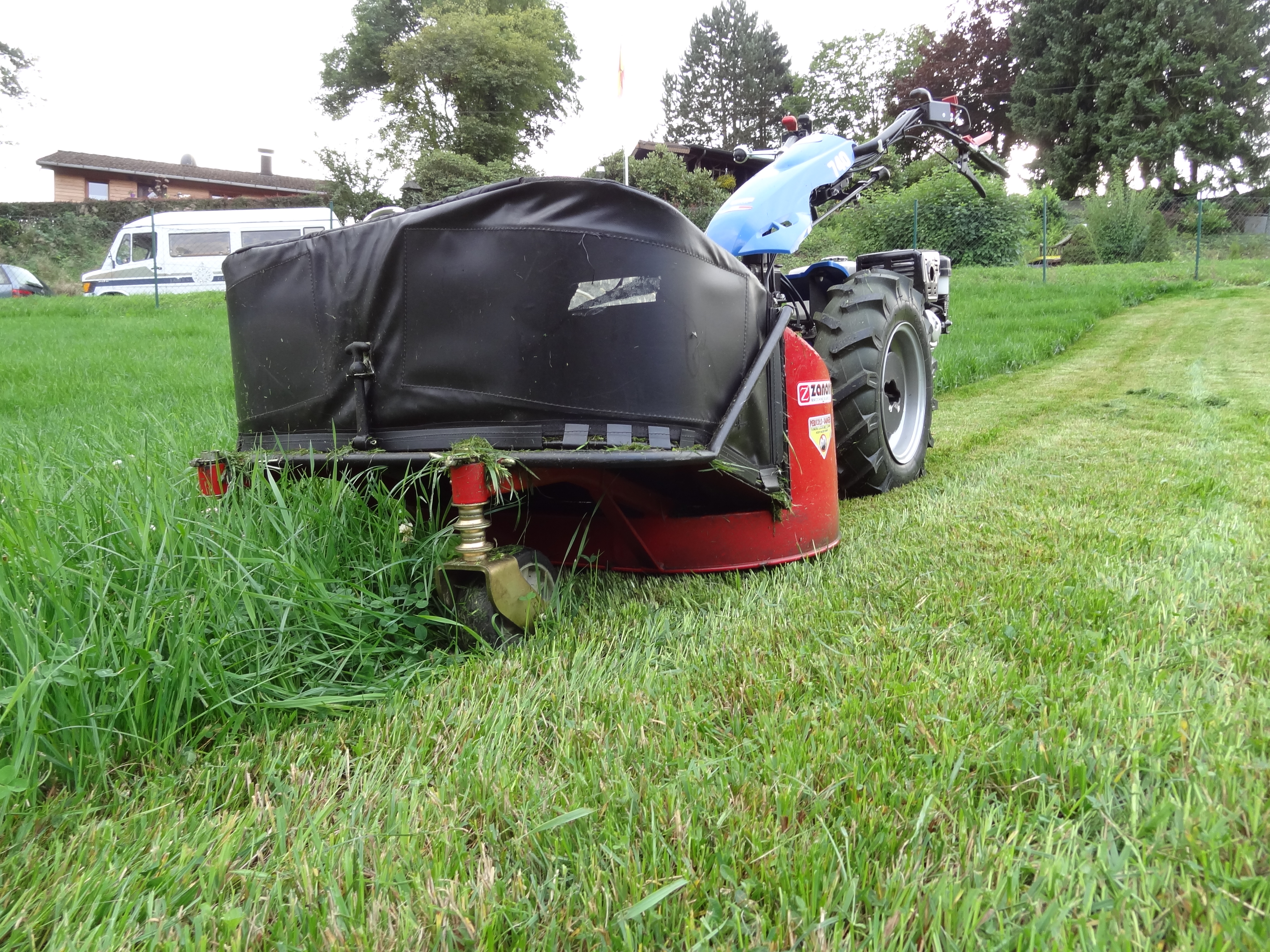

Whether to leave the clippings on the lawn or to collect them depends on several factors: if you mow often, and thereby have a small amount of short clippings, you can easily leave the clippings, and they will dry and disappear into the lawn itself. This is what they often do on golf courses, especially by warm and dry weather. At the same time, you need a mower that will distribute the clippings evenly, preventing lumps of clipping rotting on the lawn. This is not possible with the ZCR, because without the bag, it throws the clippings in front of itself, often in lumps, especially with the amount seen on my photos. That day I think I spent twice as much time emptying the bag, than on actual mowing. When mowing normally around once a week, emptying the bag is not that big a deal, if you can empty it close by.
A lawn tractor - or a 2-wheel tractor - with a hydrostatic transmission, is probably always the best you can get, especially if you have a lot of obstacles. Although I have the impression, that such tractors are often at the top end of the range, and therefore very expensive.
As I mentioned in my first post in this thread, the overall length of a 2-wheel tractor/mower combination, is a disadvantage compared to many other types of more dedicated mowers. That said, with practice, it is not that bad a compromise. What is important I have found, is to find a path around your lawn, where you have to turn - or even worse - change into reverse, as little as possible. I fought my tractor to much in the beginning, but after a while, I found a path where I hardly ever have to go into reverse, and where I turn as little as possible.

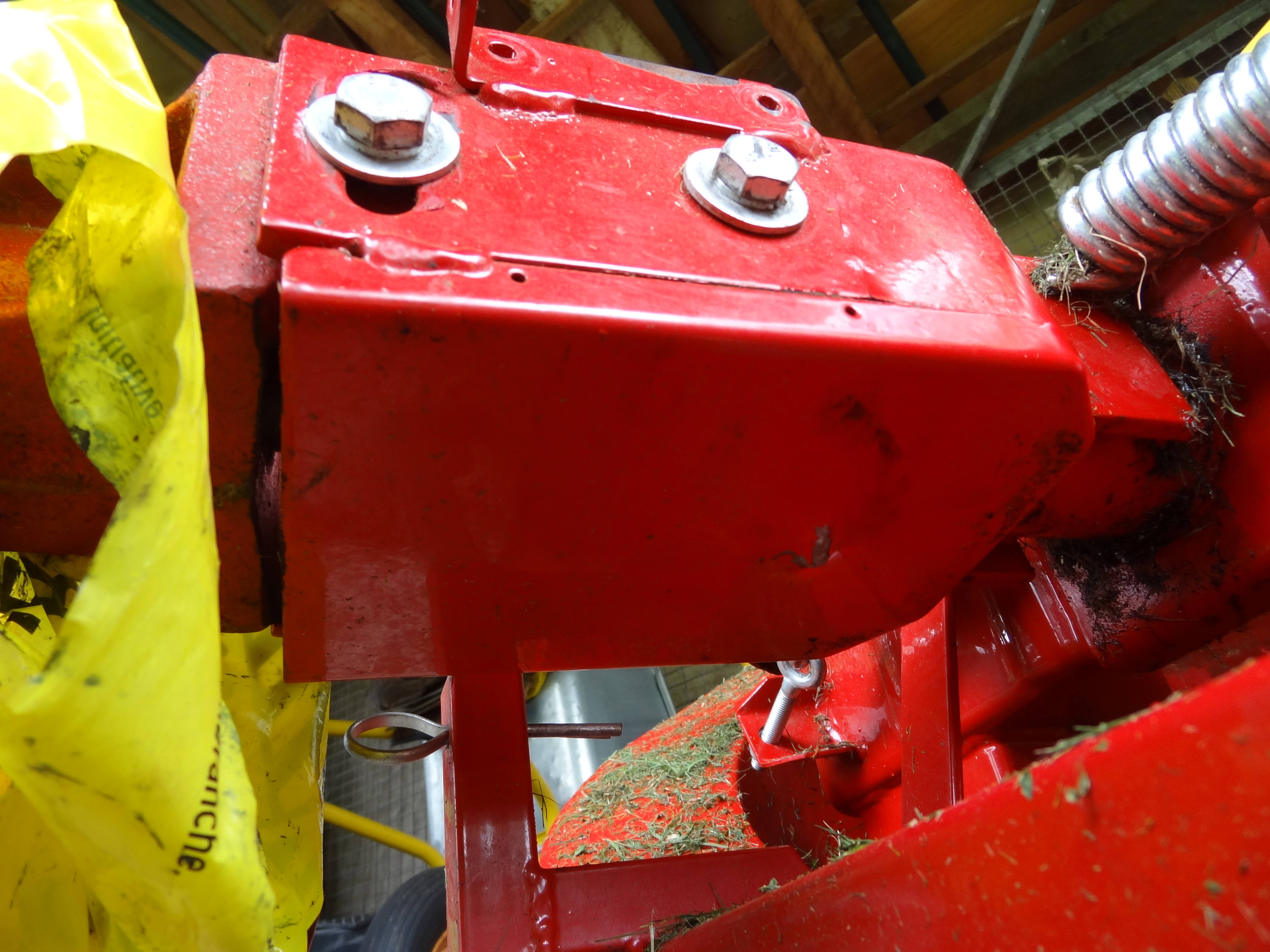

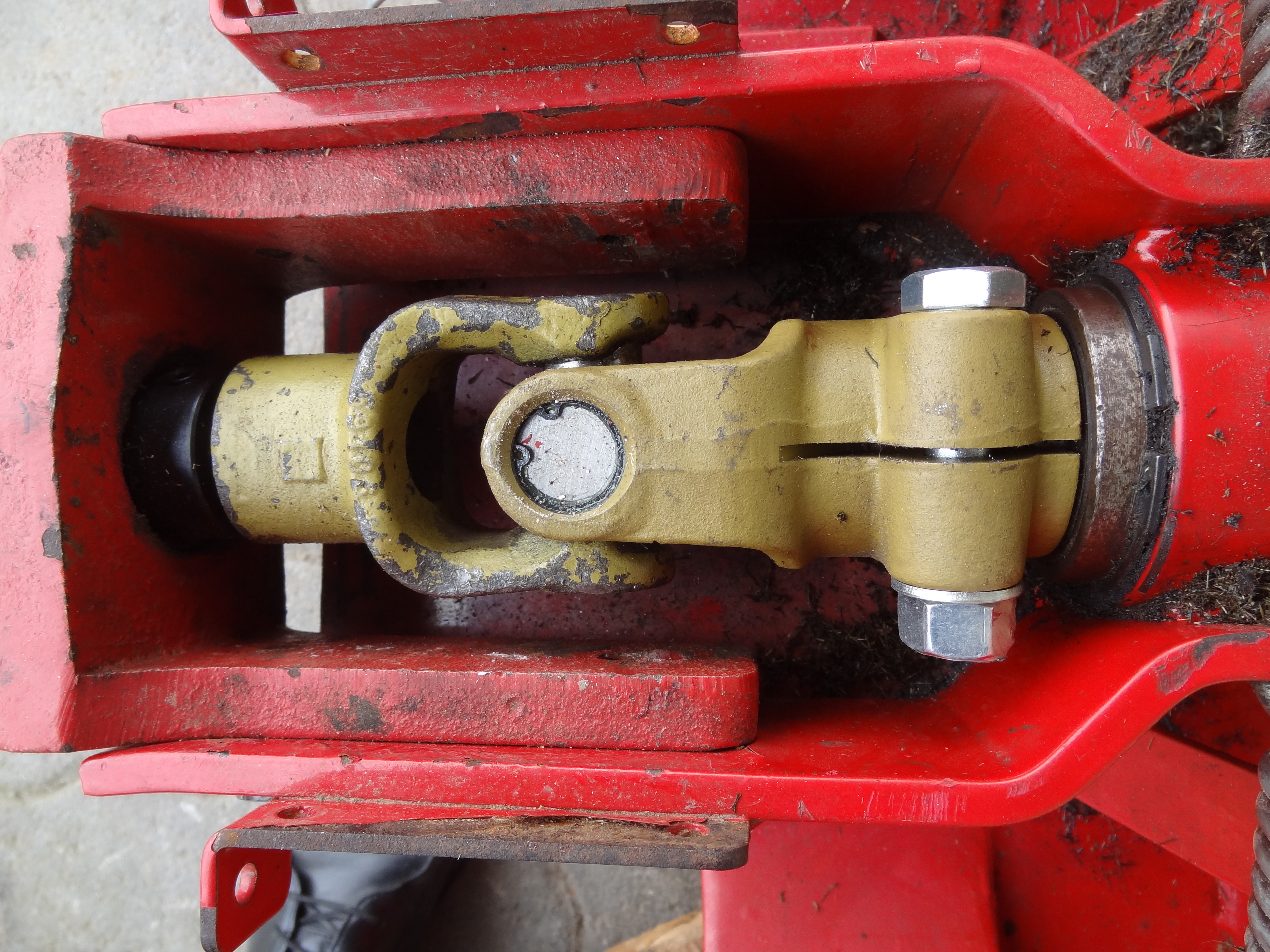

As can be seen on my pictures in post #7 in this thread, there is a universal joint in the drive line through the PTO-flange. This is in order to allow the flange to be adjusted vertically, allowing the deck to run parallel to the ground independent of tractor wheel size and mowing hight. Each part of the universal joint is fitted with a bolt - and these 2 bolts gave me a sudden and big surprise this summer! One day as I was mowing, the tractor stopped very abrupt, with the engine still running and the mower free-wheeling to a stop. As this happened at brisk walking speed in 3rd gear - and without warning - I almost stumbled and fell on top of the tractor. The PowerSafe clutch did a good job protecting the engine from the shock load, as it slipped, allowing the engine to continue to run. I turned the engine off, and began investigating. At first I was afraid that the gearbox of the tractor was the problem, but after removing the yellow cover over the universal joint, the problem was obvious: both bolts had unscrewed themselves, and one of them was now trapped between the universal joint and the bottom of the housing, and thereby making a nice dent (see picture).
I felt lucky that nothing worse had happened, and after having replaced the 2 bolts, I now mow without the yellow cover over the universal joint, allowing me to keep an eye on the bolts at all time. On top of that, I frequently check that the bolts are tight.
As a little bonus, this incident showed me that the PowerSafe clutch is capable of protecting the engine very well, should the PTO or gearbox get jammed. :thumbsup:

At my last update after the 2017 season, I mentioned the problem that I had with the universal joint which is part of the drive line through the PTO-flange. Since this experience, I have left the yellow cover over the universal joint off, allowing me to keep an watchful eye on it at all times. Further more, I often check that the 2 bolts keeping either end of the joint in place, are tight. To connect the incoming and the outgoing shaft to the universal joint, there is a keyed joint at either end of the universal joint. This feature allows the male flange on the coupling to be adjusted up or down, always allowing the deck of the mower to run parallel to the ground, even with varying tractor wheel size and mowing hight.
Last summer then, I noticed that the key on the outgoing shaft was beginning to wear out, as a little bit of slag had developed in the joint, despite my constant effort to keep the fixing bolt tight. I brought the mower to my local BCS dealer, and he recommended to replace not only the worn-out key, but the outgoing half of the universal joint as well. The picture below shows the final result.
To me this looks like a much more professional solution than the original one, as the new outgoing half of the joint has a slit, that allows it to press tight on the entire circumference of the shaft, and not just at the point where the bolt is.
The picture above shows the original half of the universal joint with the bolt pressing on the incoming shaft.
Perhaps something similar can be a useful solution to other owners of Zanon mowers, experiencing similar problems.

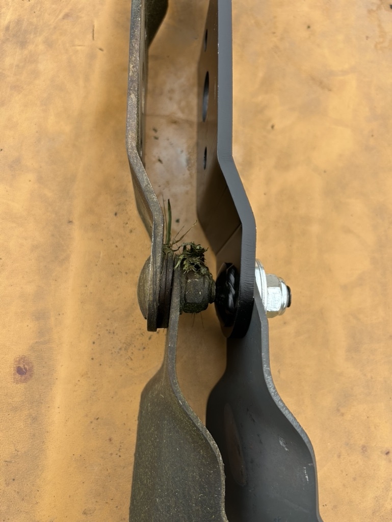

I decided to use this opportunity to replace all 4 knives including their 2 mountings, and save the old parts as spares.
A new knife next to a 9 year old one with close to 250 hours of use.
The Zanon ZCR standing on its side with the new knives and their new mountings in place.

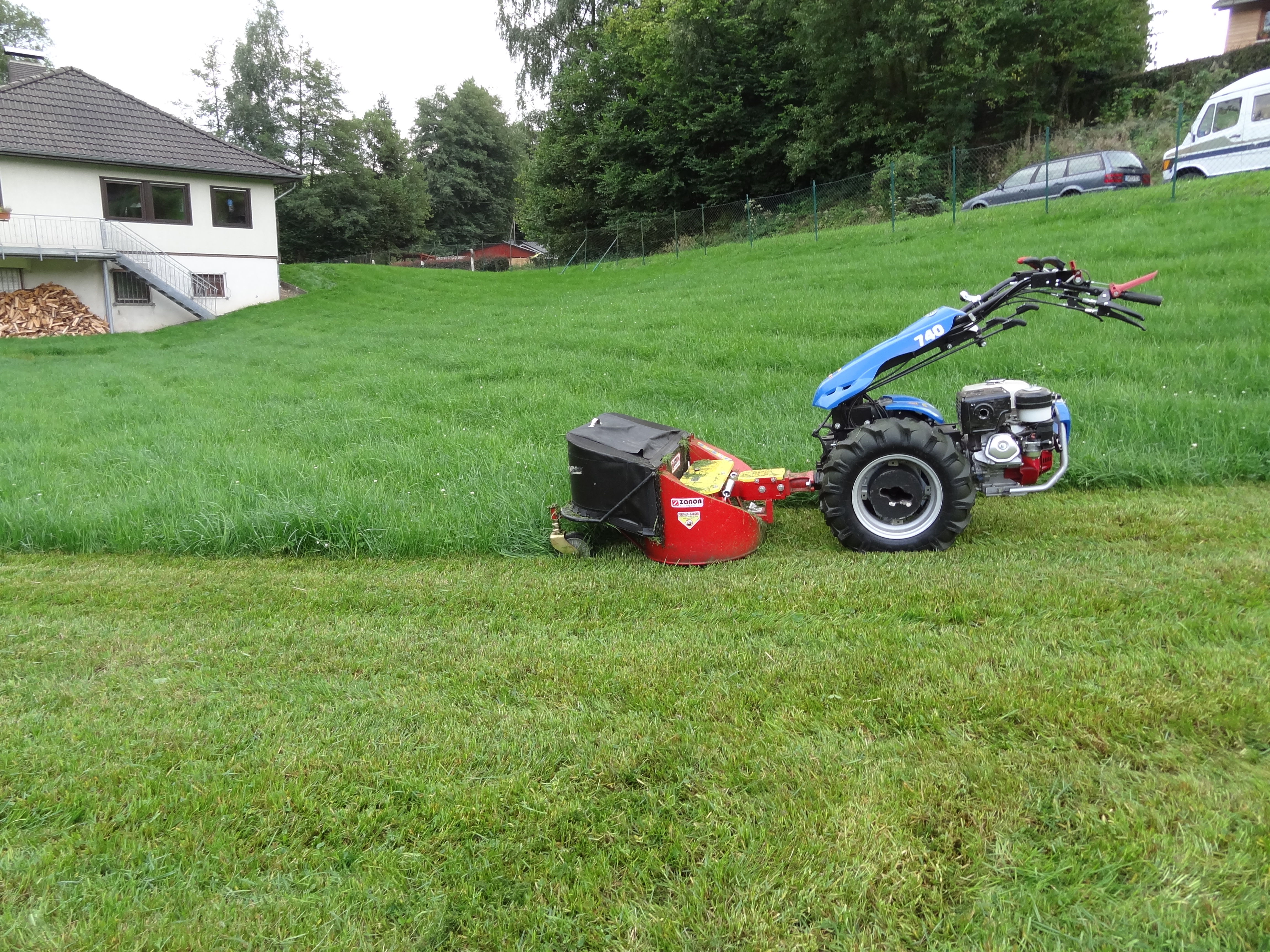

I am aware, that there are very few members - if any at all, who uses this exact mower, but as the basic construction is very similar to other Zanon mowers, I hope an update could be of interest to members having these at least.
This was my 13th season using this mower, and I have put almost 300 working hours on it. It hasn’t worked without problems, but it does a decent job, and allows me to utilize my tractor way more than I otherwise would. As I have mentioned before, my lawn is more of a pasture, and the last 4 years or so, I only mow 4-6 times during the season, to allow the bees and other insects to feast on the clover and other flowers. This means of course, that the grass is tall when I finally mow it, and this probably puts more strain on the mower than it is designed for :cry:

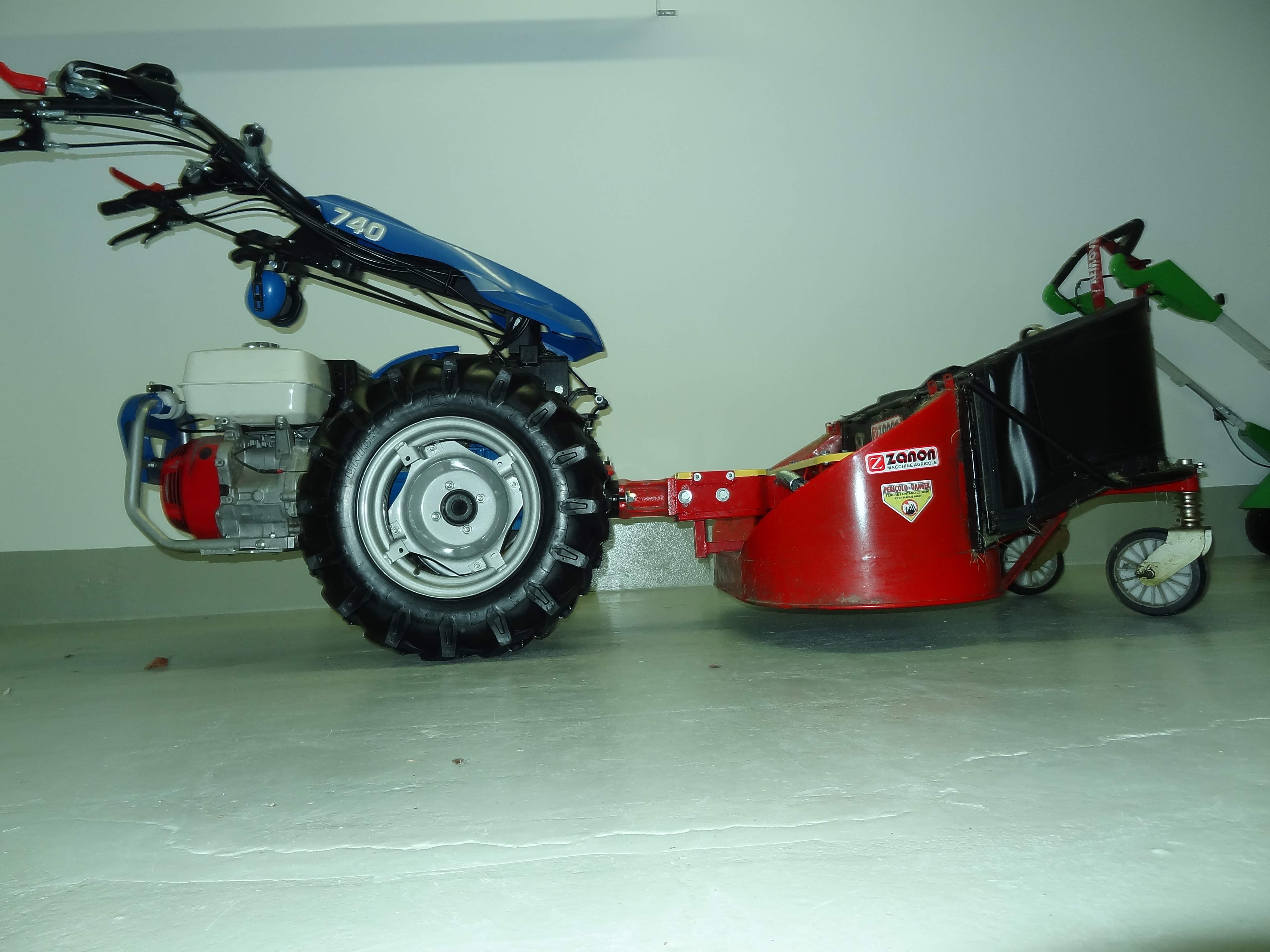

This is how my setup looks, with the Zanon ZCR 800 in front of my BCS 740:

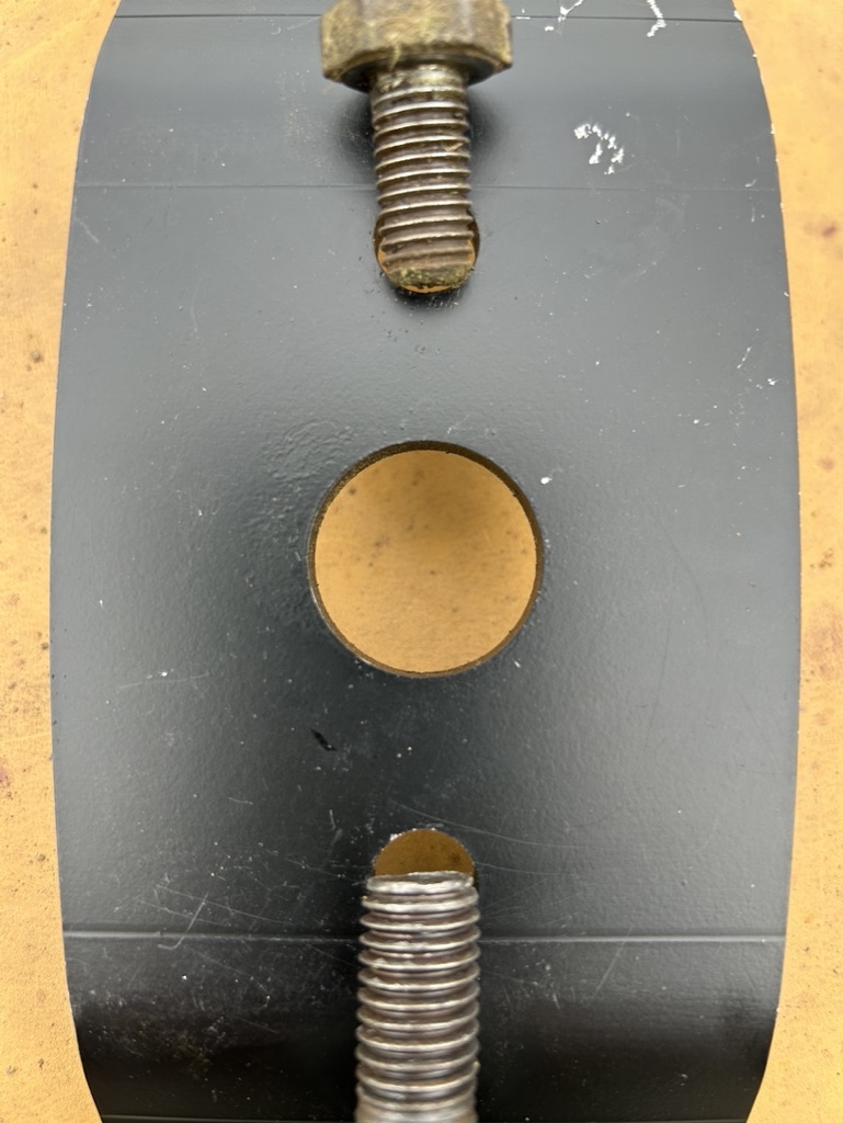

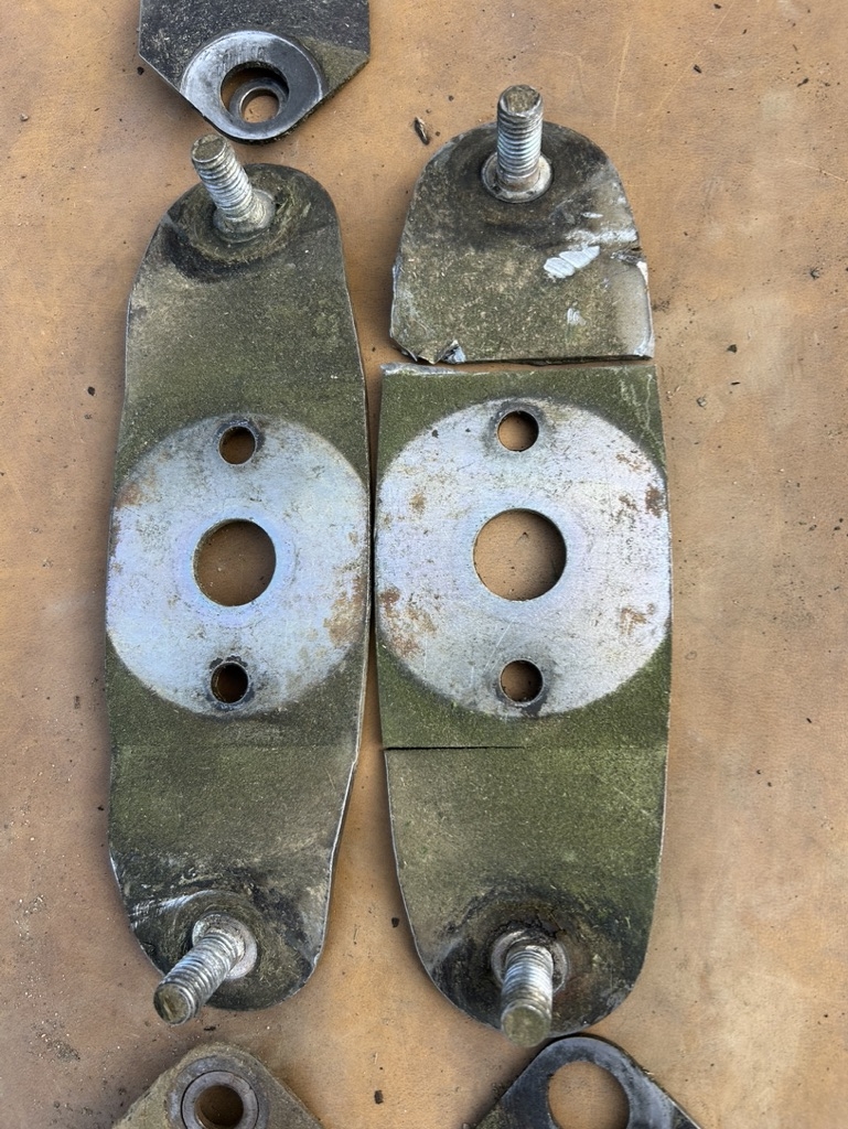

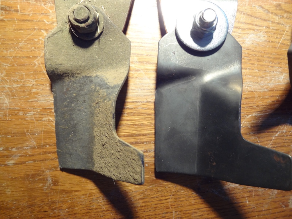

As stated in the previous post, I put new blades and blade holders on 4 years ago, and have used them for around 50 hours. Bad luck struck again in august this summer, as one of the blade holders broke while mowing! That really caught my attention, and this was how the parts looked afterwards:
As I have kept the original blades and blade holders as spares, I could put them on and finish mowing (y)
4 years ago I had to order every little part separately, and fit the blades on the 2 blade holders myself. My Zanon dealer this time told me, that Zanon provide a complete blade holder now, with all the washers, bushings, blades and nuts complete as one unit. That was good news, and so I ordered 2 complete sets.
As I received the parts, I was very pleased to see that the new blade holder was much thicker than the old one. The original blade holder from 2012, and the ones I received 2021, were 4 mm (5/32’’) thick. That is probably adequate if the mower is used as intended, mowing nice lawns pretty often, but in my case, they were not up to the job :cry:
The new blade holders are made of 6 mm (15/64’’) steel, which makes quite a difference:
The blades, new or old, are 3 mm (⅛’’) thick. Note that I have sadly put the 2 washers in the wrong position, as I put all the parts together 4 years ago :cry:
Sadly, there was also a little disappointment, as I tried to fix the blade holders to the spindles. 4 new bolts were in the box, one of which is the lower one in this picture:
Compered to the old bolt at the top, the new one is not just bigger, but it is bigger than the hole in which it is supposed to fit 😖
It still had the old ones of course, and this is how the lawn mower looks with new blades, ready for next year (y)
The price for 2 complete blade holders was 156 Euro ($179.31), plus 25 Euro ($28.74) added for shipping. As homeowner I have to pay 19% sales tax on top of everything, bringing the total price to 225.31 Euro ($258.98).
