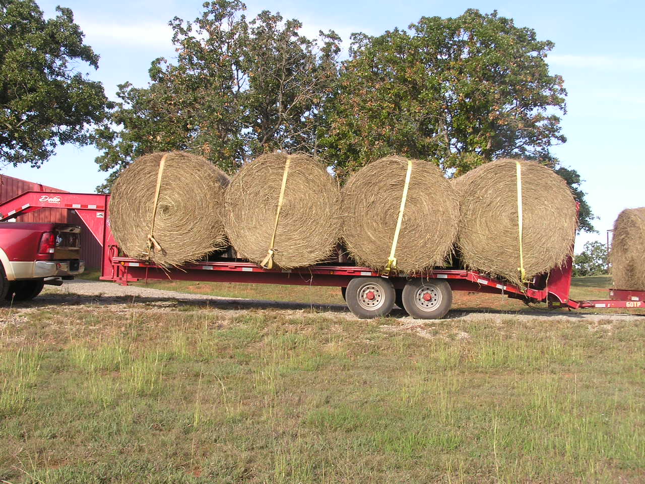

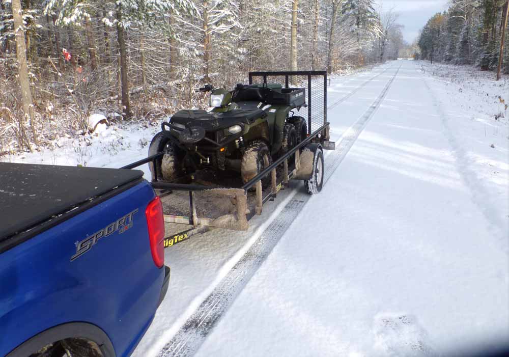

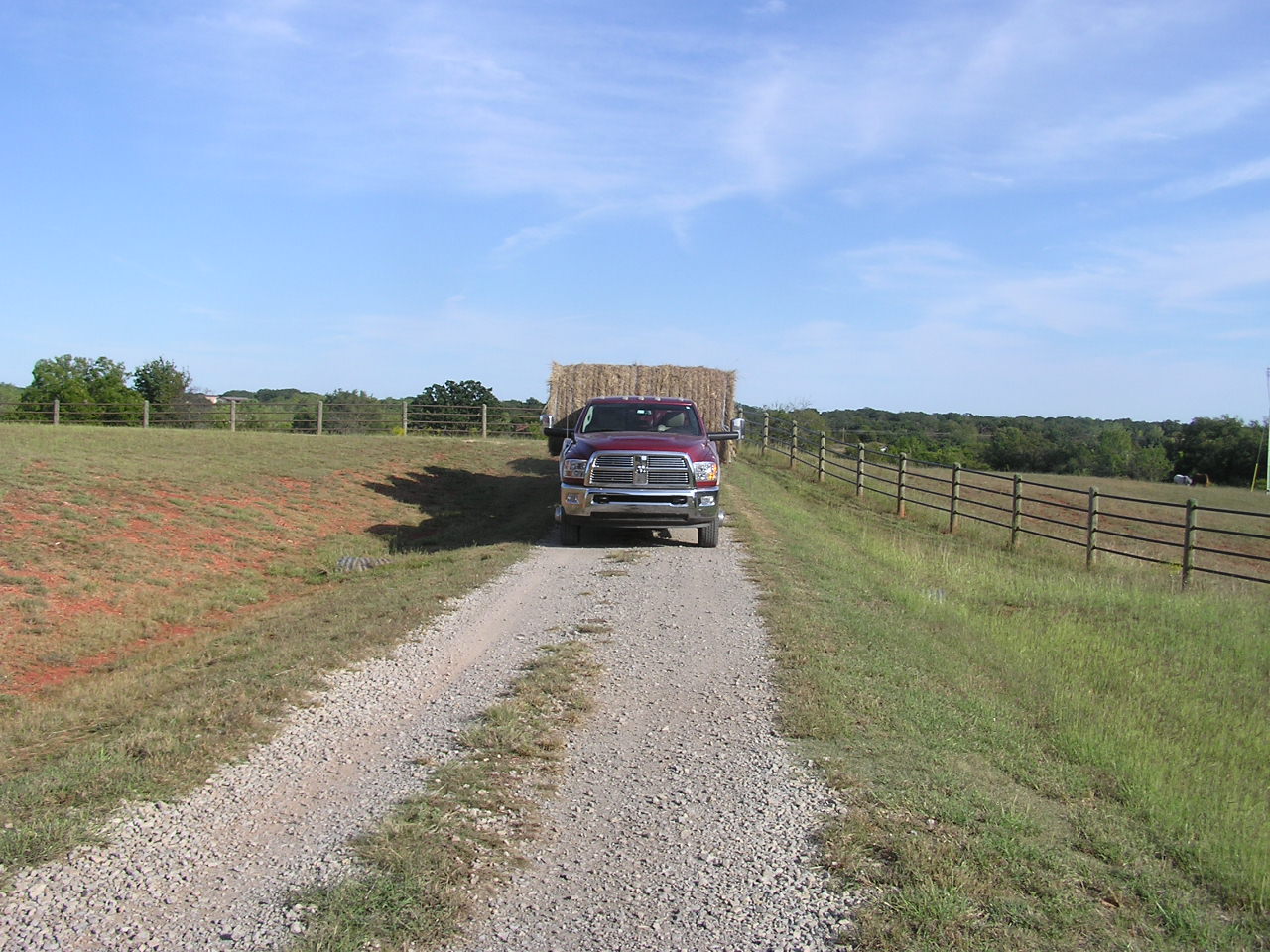

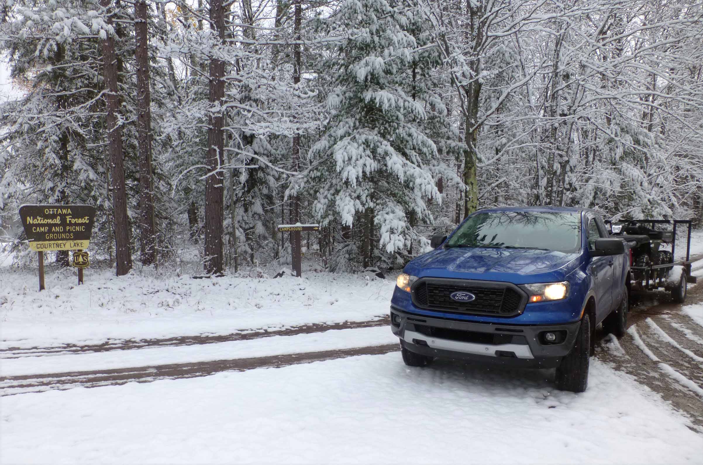

Weekend of towing for us...

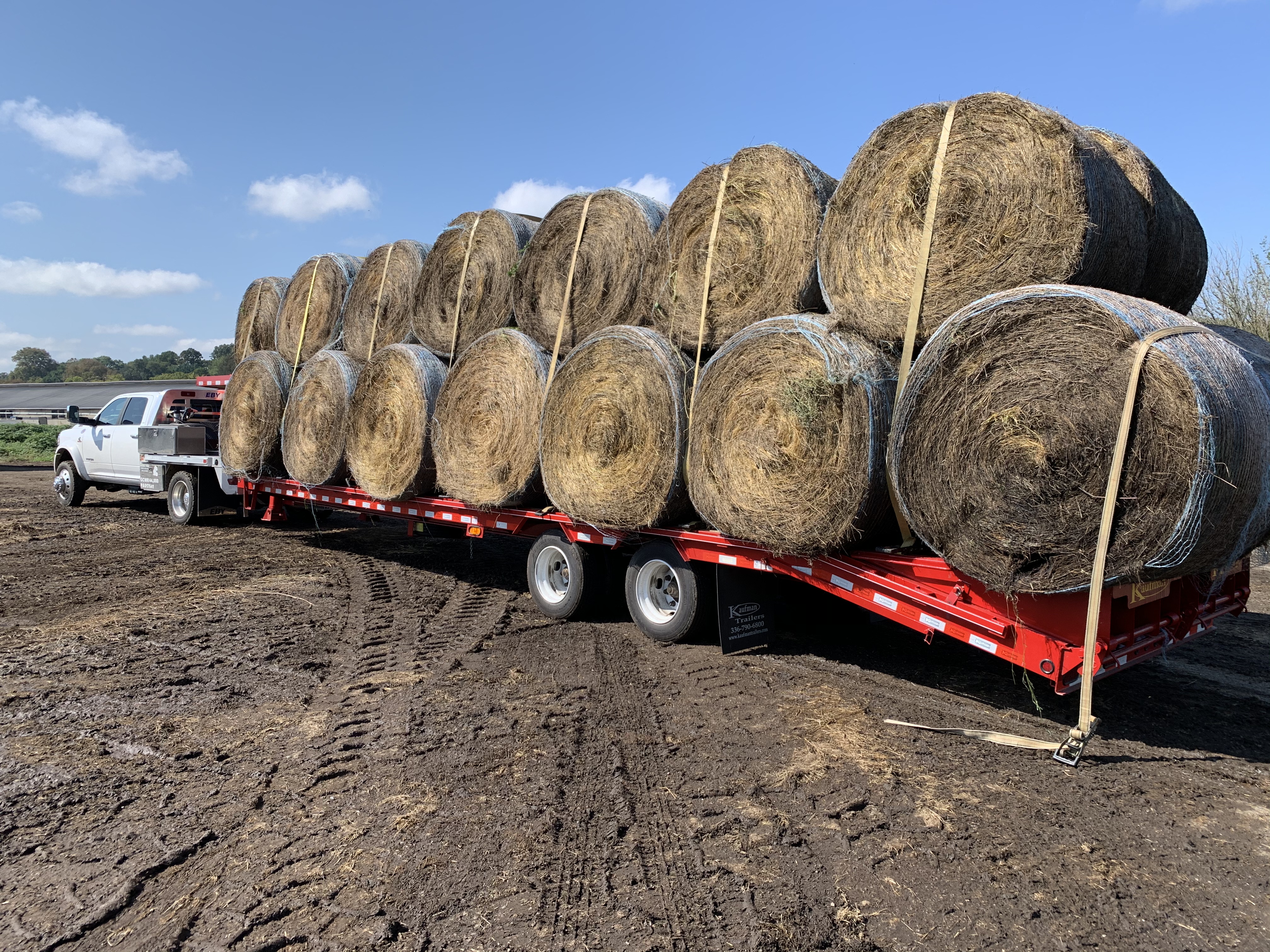

Are there 27 bales, or hmmmmmmmmmm,, I only seem to be able to count 22 bales? :eek:
It was in the process of being unloaded in the picture. Note the straps are off the load.
Actually had 28 bales, but 6 were already unloaded. See scale ticket picture.
Here is 28 bale load.
