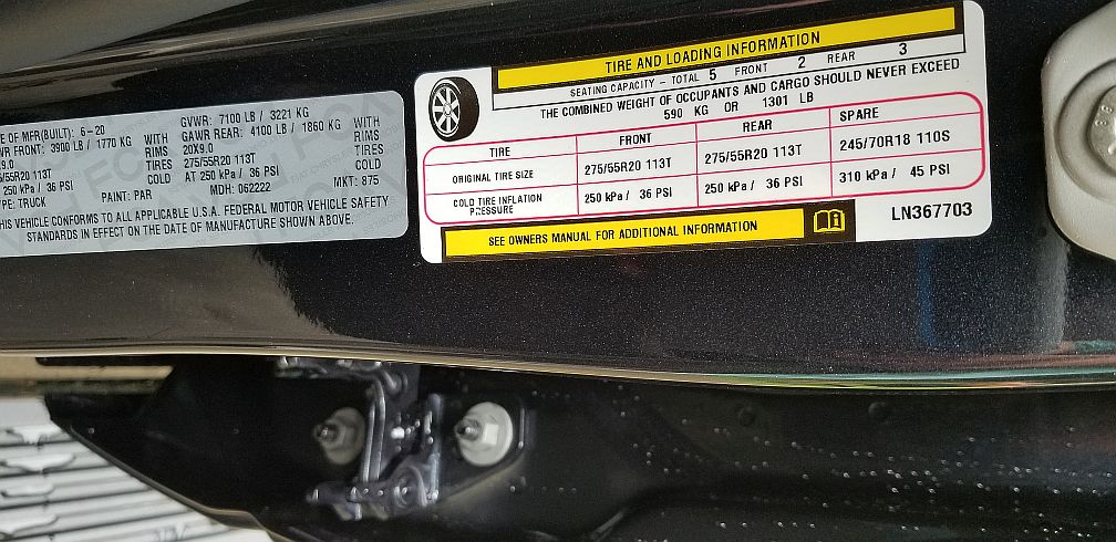

Here's the numbers from the sticker. Says mfg date 6-20, vin lookup said 7-22 but that may have been the first transfer date. I believe curb weight is in the 5000 - 5200 lb. ballpark (crew cab +v8+ 5'7" bed).
GVWR on sticker is 7100 lb.

The other sticker will list the actual payload number.

OK, got the right one.
Looks like 1301 lb. Odd how things are out of sync. 5200 (curb weight) + 1301 (max cargo on sticker) = 6501 lb while GVWR is 7100 lb. Load range 113 tires should be OK for 2500 lb. each, so where does the limitation come from?
   / Your towing rigs and trailers #3,578
Your truck probably weighs closer to 5800 lbs, the options add up and take away from the payload.

seeing this just made me curious so i grabbed a flashlight and went out to check mine, and my numbers all add up. 7200 gvw, 5405 curb, 1795 payload... both the tire sticker and the manufacturer towing / hauling sticker matched up on the max payload amount. Hard to believe that any newer-ish trucks (even from different manufacturers) would vary by that much. Makes me think that they aren't going apples to apples, and that makes me surprised that they don't all use the most advantageous data they can.
