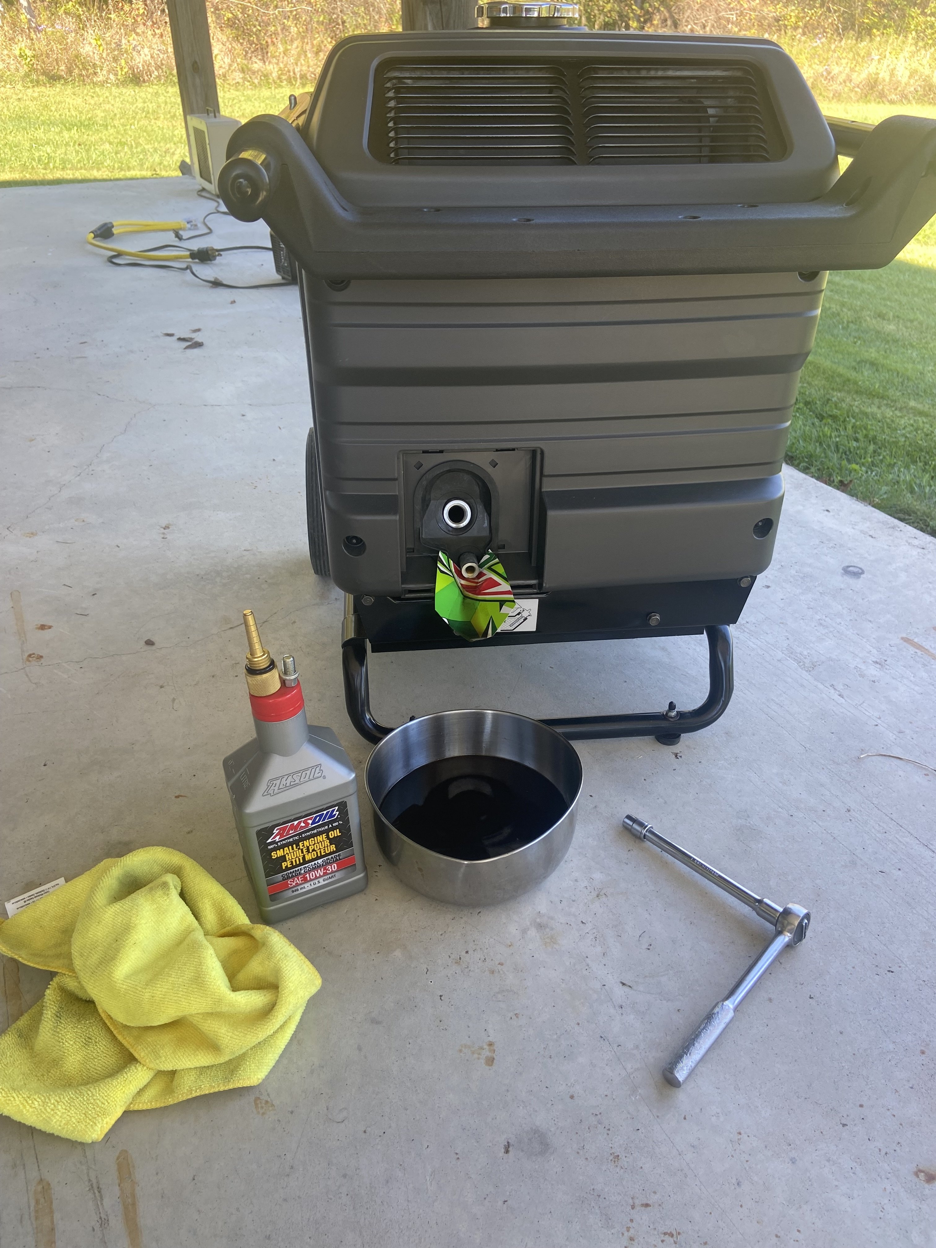

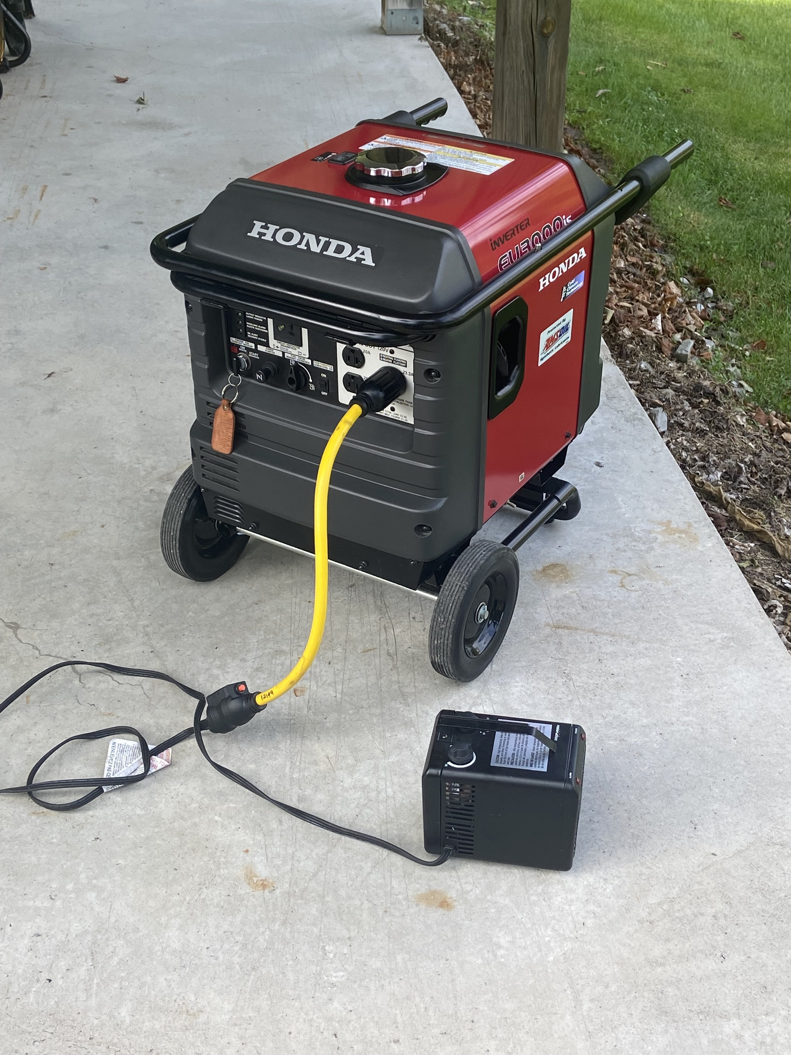

Gave this ā€œnew to meā€ girl a workout…and then an oil change with the addition of a Magnetic dipstick from Goldplug. šŸ˜‰
View attachment 1344832View attachment 1344833
Team Red - is growing the Lineup ! (y)
That 3000 is a nice size - but it's good to have the handle and wheel kit. Buddy 'o mine used to run one @ racetracks - deadlifting was nicer with 2 people.
Goldplug, I'll have to check what they cover (re. mine); thanks for mentioning that.
