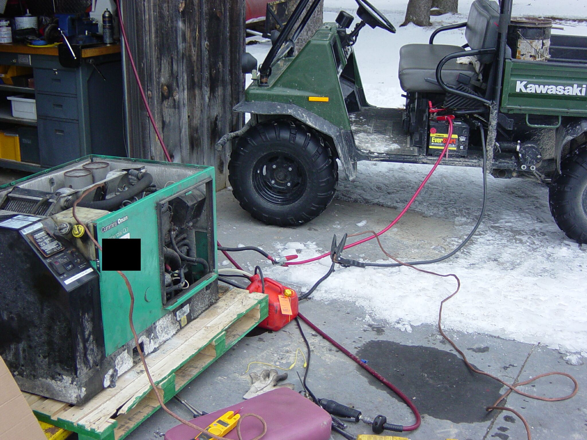

This is what I did earlier this year to troubleshoot a starting issue on a (new to me) generator.
DSC04795b.jpg Primitive I know.
Process of Elimination.
Known Good Mule Battery (Only Walmarts Best!)
No Go!
Took that bare copper wire and went onto the block. Unit started. Then found bad ground connections to block.
Funny, because when I was trying to use a Charger/Starter, the unit was throwing overvoltage codes. It's easy to get confused. Short high quality jumper cables can be very useful. I have a couple only three feet long, that I have used often.
