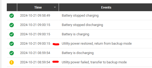

Cranked up the beast today. It gets the weekly exercise runs, but doesn't make power for those. I had a three or four hour outage a couple of months back, but no run under load since then. Flipped the main disconnect this morning to simulate an outage and let it fire up and switch over. Did that in about 20 seconds.
This UPS doesn't know the difference between Utility Power and Generator power though. It just knows AC voltage.
Gave it a work out using a bunch of hot water and running a few loads of laundry.
Ran it about three hours then switched back over to utility.
