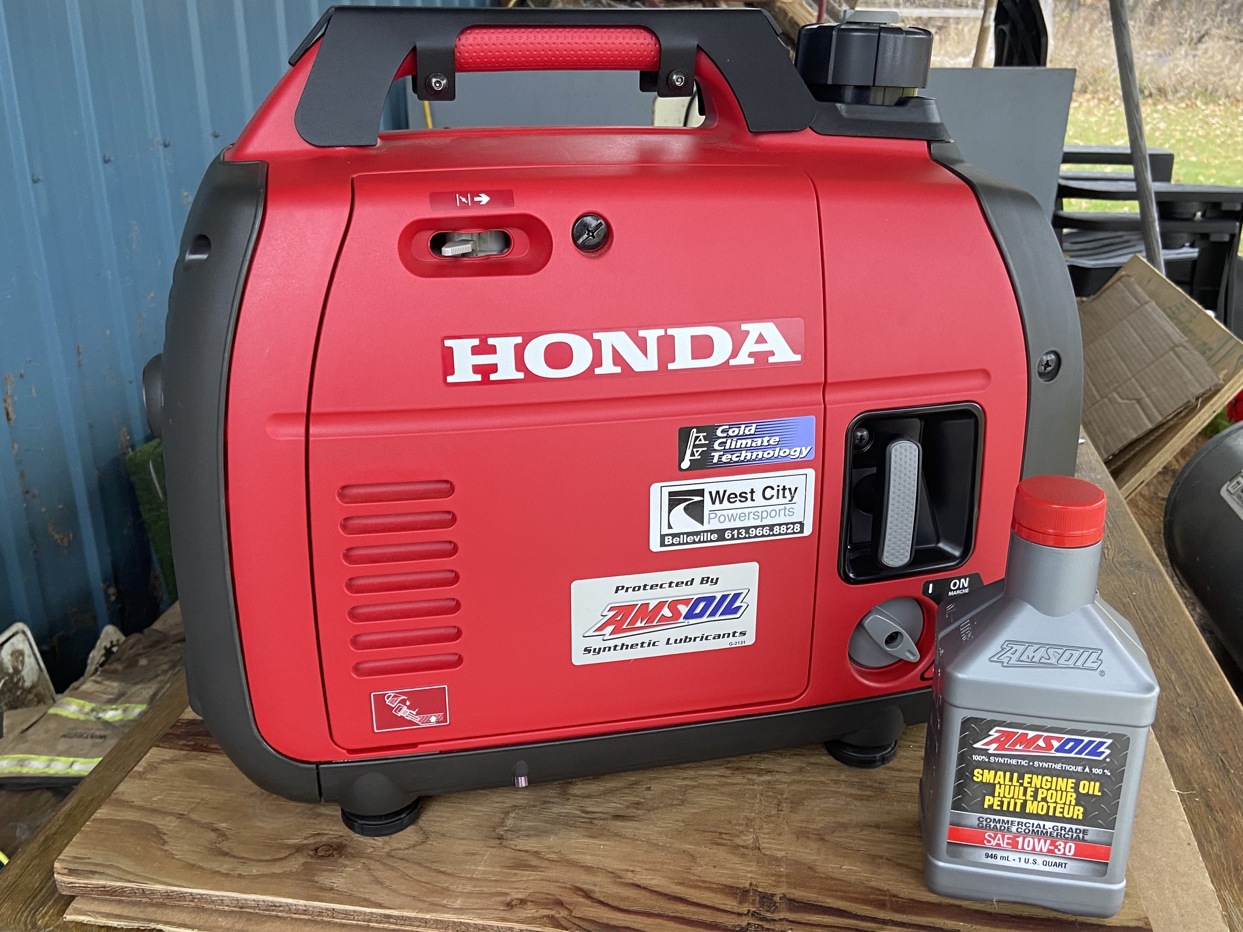

Some exercise…..and then Amsoil out Amsoil in 😉

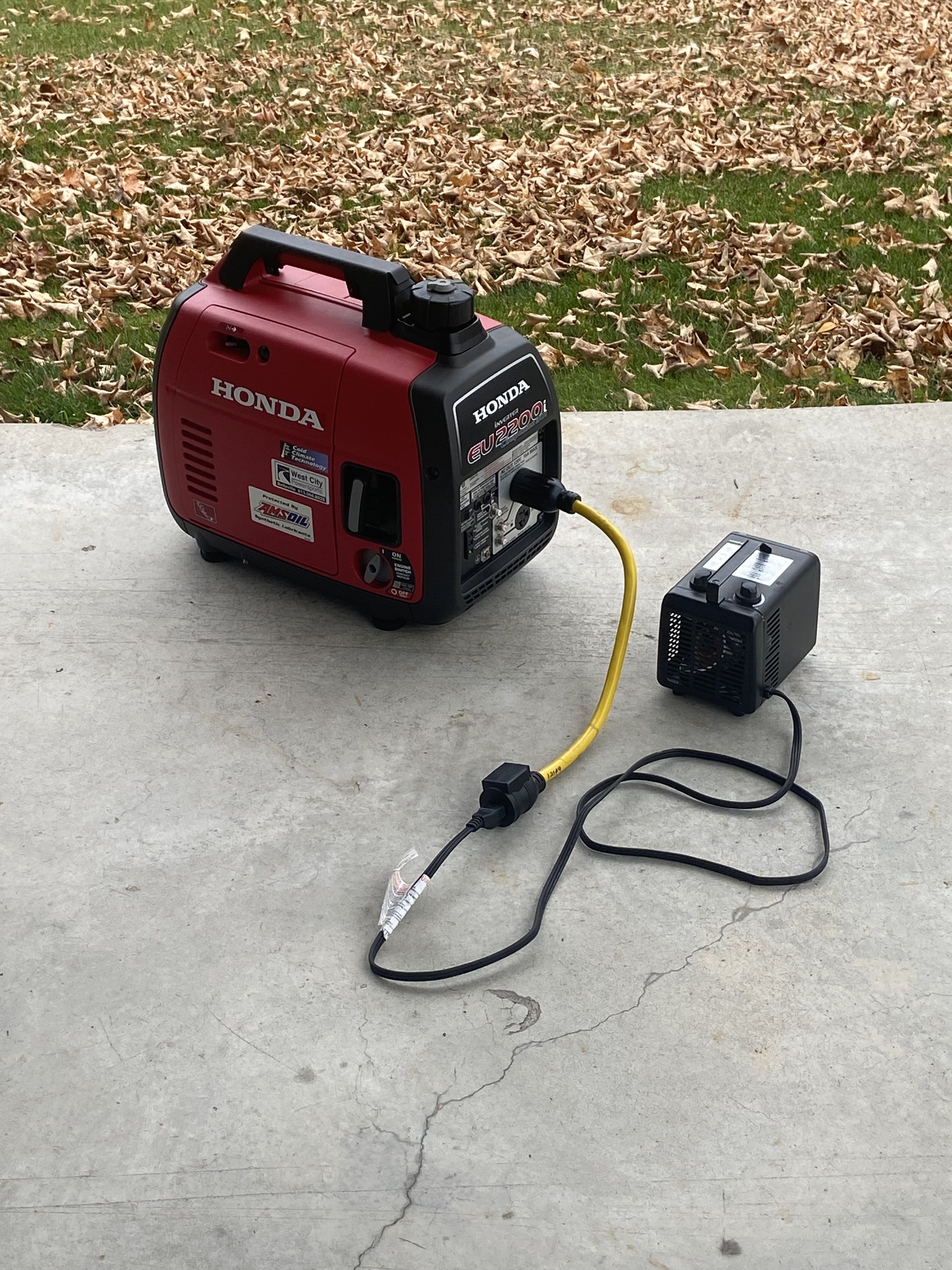

Ran my Predator 3500 inverter yesterday to power my pressure washer. It only sees REAL use once every 24-36 months, so this is about all I can do for it.
   / Your last generator Maintenance Run
#7,087
Me, I find that helps (mentally) sync things, if I use a gen to do Something Else that I was going to do anyway..... 2 Stones, 1 Bird, or something like that.... :cool:

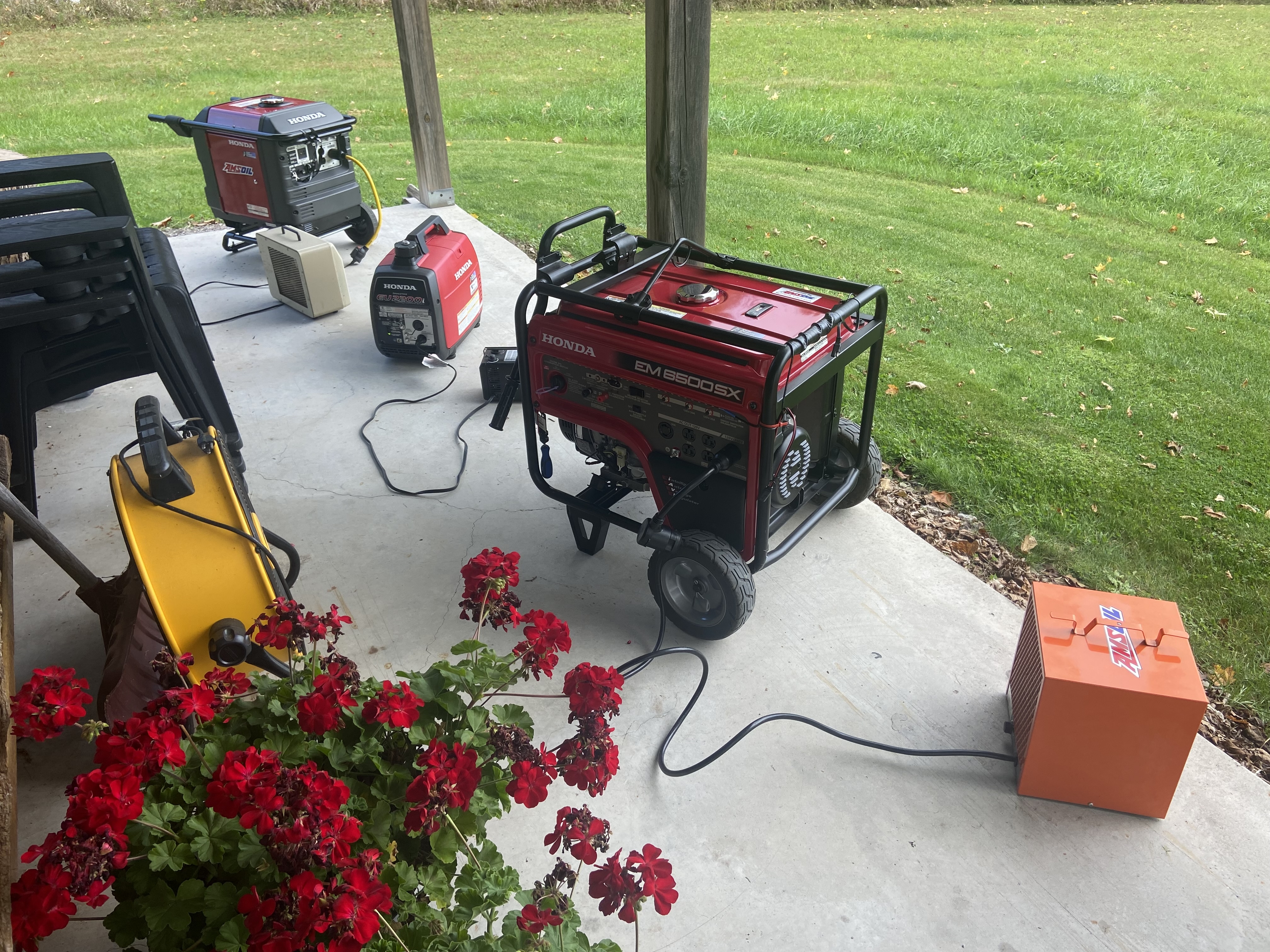

#7,089
Still the 3. Just that it was the baby’s turn for service…😬
I remembered the Family Photo..... the other pic had wondering if the count had grown !
