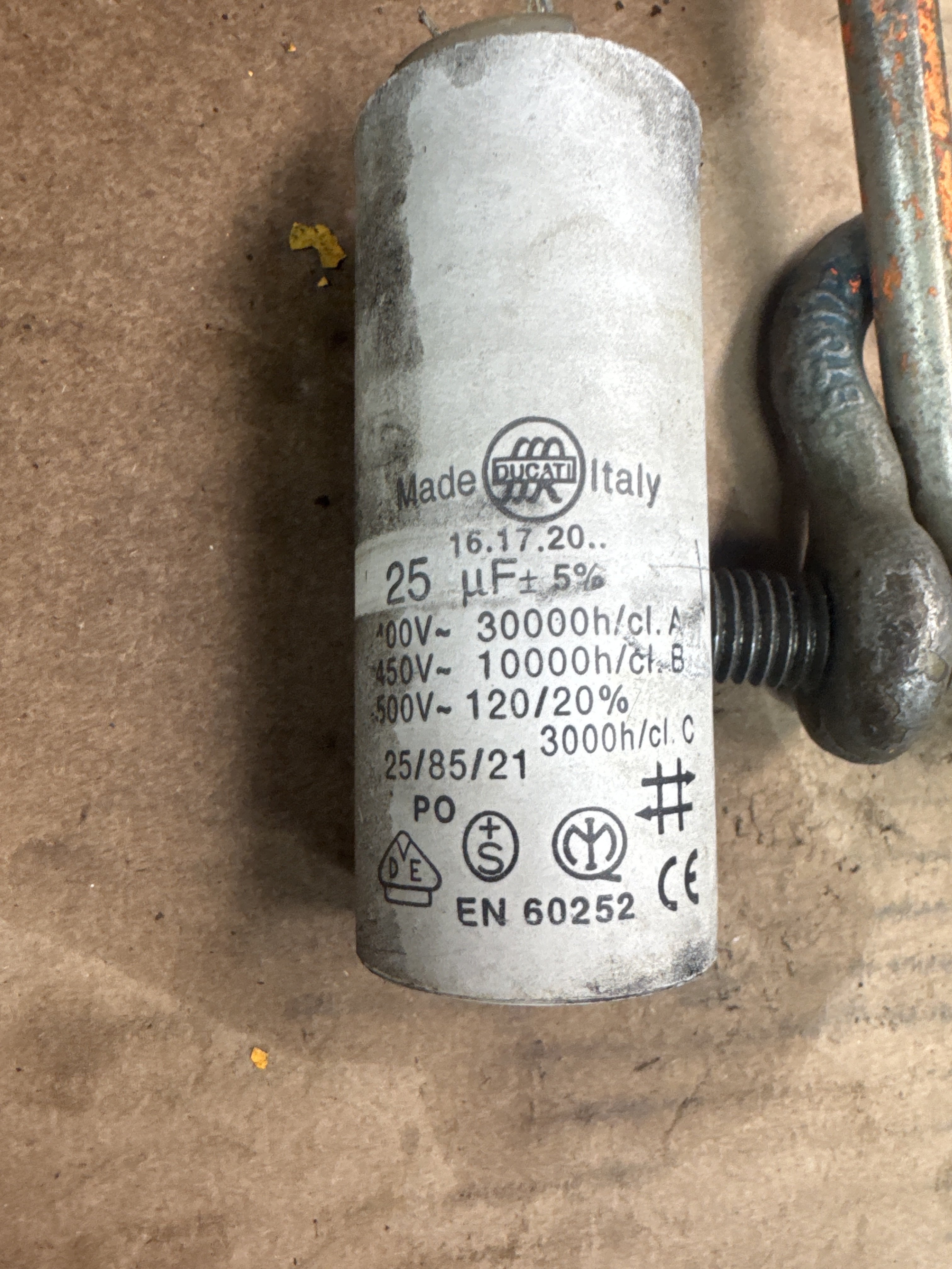

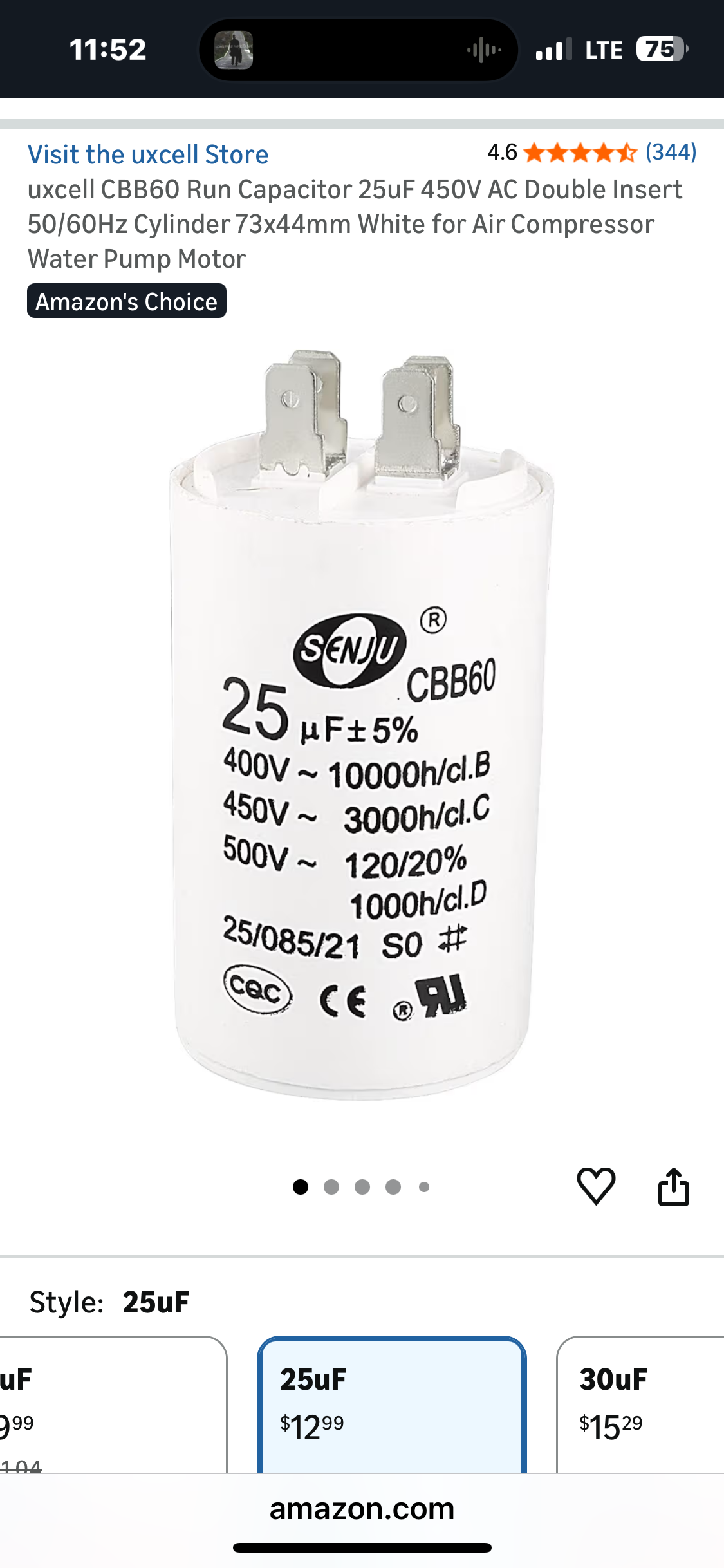

I have a North Star 5500 belt driven generator that suddenly stopped generating power.
The capacitor failed & I don’t understand the specifications printed on it.
I’ve found one that is very similar in specification but not sure if it is compatible.
An explanation of specs would be appreciated.
Thank you

looks the same, does the connector look the same?
25 uF at 500v +/-5% is the important numbers.
The connections are what we can't see in your photo.

90 - I suspect what you are pondering is what looks to be Hour ratings, under different test Classes.
Bigger stuff ^ than the caps I used to work with (down into the detail-weeds @ times), so I don't know those Classes.
No promises, as it is the Holidaze @ moment, but I'll ping a retired buddy of mine, as there is a decent chance he is familiar with those Classes.....
Rgds, D.

Brushless generators use capacitors for voltage regulation. All you need to do is match the uf and voltage class rating….. I’ve even used slightly different uf rated capacitors when exact replacements can’t be found, and they work fine…maybe a volt or 2 more output.
   / Your last generator Maintenance Run #7,894
Connectors are the same.
What does the 25/85/21 versus
25/085/21 mean?

might be same...... know better if I can track official test doc....
(Total guess on conditions..... Relative humidity range, 21C) <<< just guessing.

Those numbers are temperature coefficients
For exmple
What Does 40/70/21 Mean on a Capacitor? | Tolerance of Capacitor​
The minimum and maximum permissible surrounding temperatures are specified on the capacitor as follows: 40/70/21 = minimum permissible temperature: –40°C, maximum permissible temperature: +70°C. 21 is the number of days the capacitor can withstand within specified limits if exposed to 95% relative humidity at -40°C.
I your case, the numbers are the same. Don’t worry about the 0

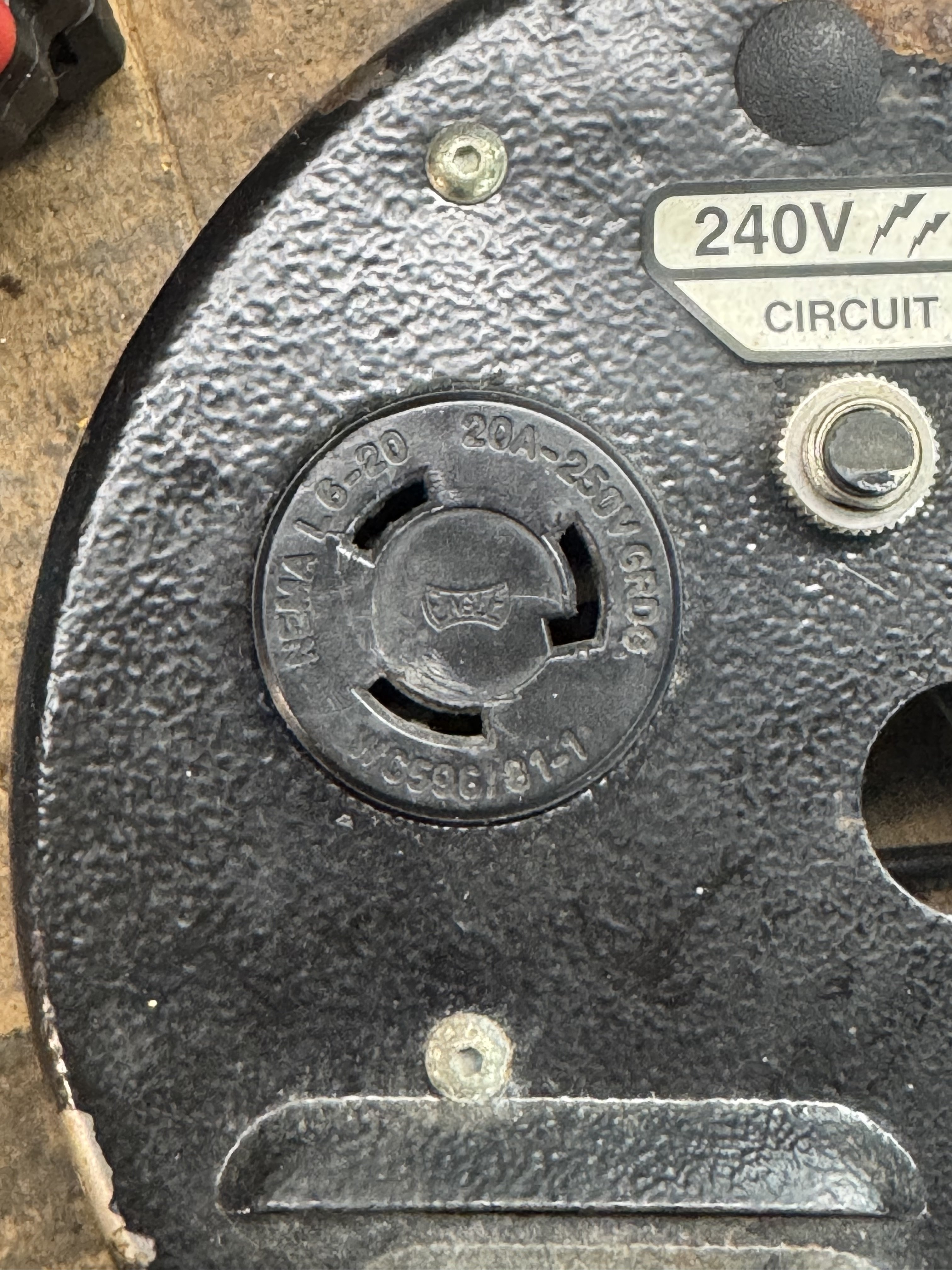

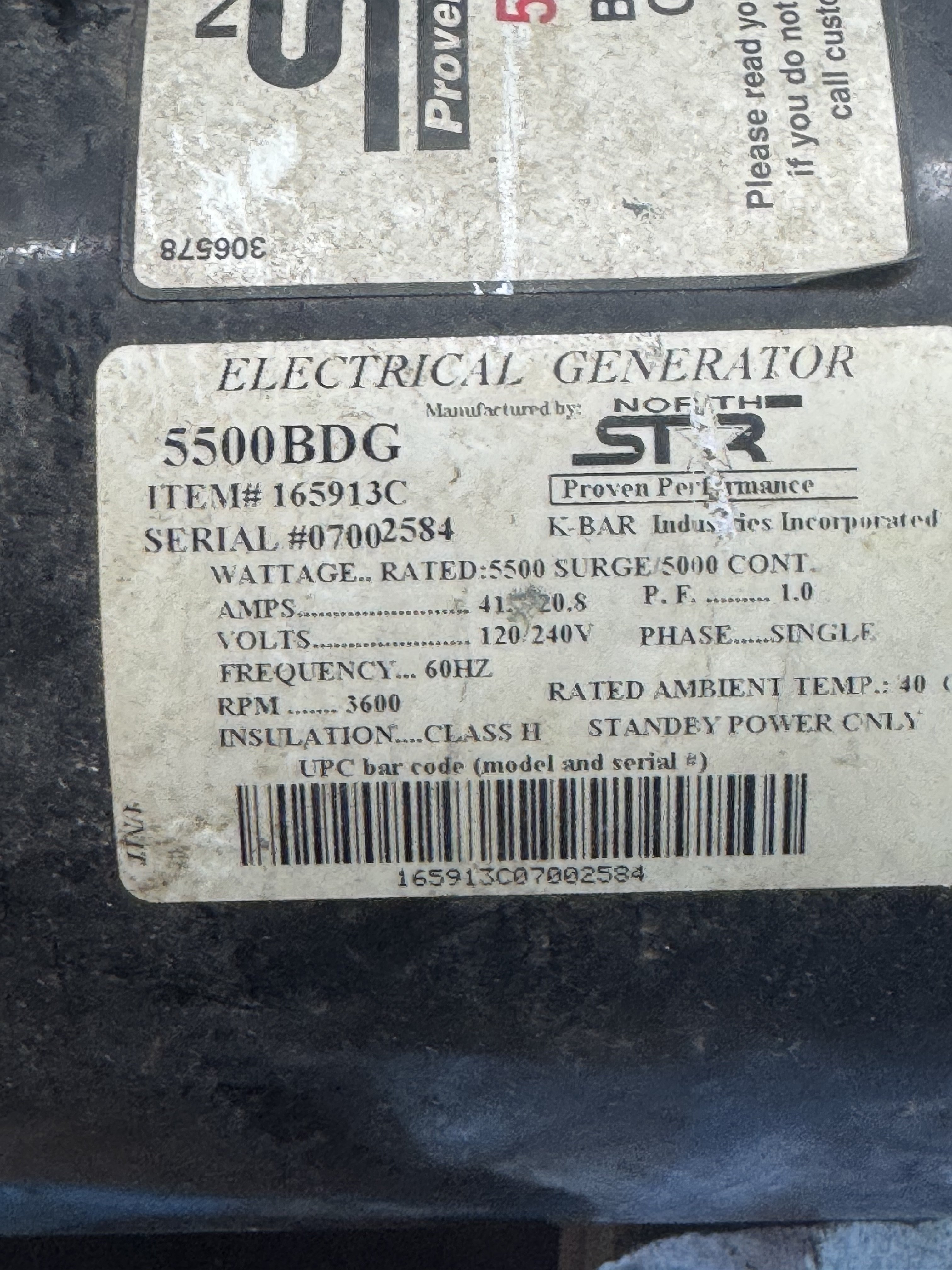

Another question about 5500BDG generator head.
This generator with the bad capacitor has an L16-20 250v three prong outlet, while another similar much newer unit has an L-14-30 250v four prong outlet. I would like to replace the L16-20 with the L14-30 outlet to be compatible with my extensions.
Any issues with this and does the additional wire attach to the existing ground point?
Thanks 90cummins

An L16-20 is a 4 prong 3 phase connector, are you sure about your description?
If you have a 3 prong outlet it would be a single voltage and a ground.
An L14-30 has 4 prongs, 2 hots, a neutral and a ground.
240 across the hots and 120 from either hot to neutral.
Does the generator have a center tapped output winding that would let you connect the L14-30 correctly?

My mistake it’s an L6-20 3 prong outlet.
Photos are of generator in question.
Generator has 2 taps & breakers.
