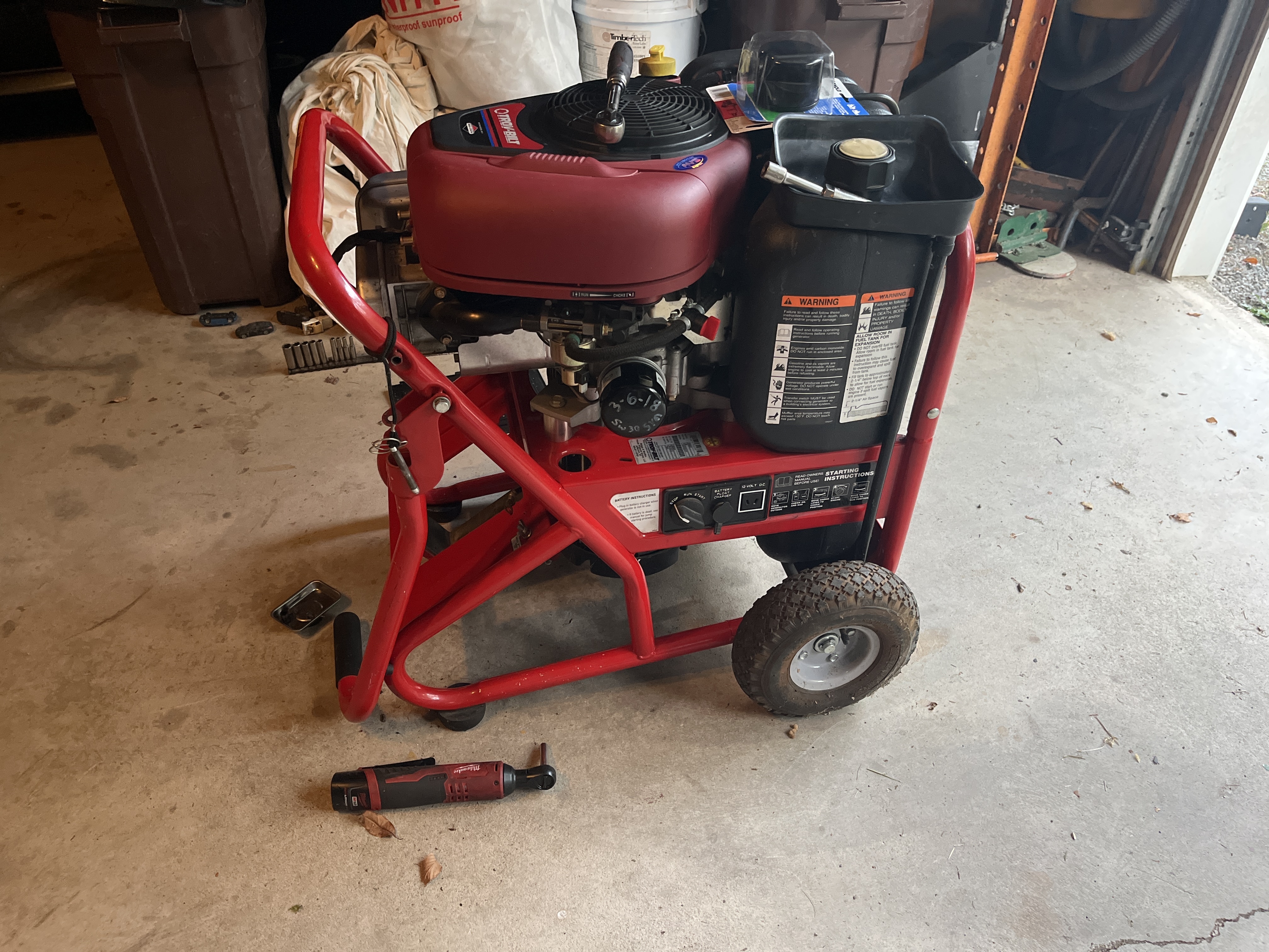

Went up to my mom’s house today and got the 2 generators out of the garage for her. Brought them down to my garage to clean them up, service, and sell them. One is an old McCulloch 3300 watt job, with a flat head Briggs on it. Vintage 70’s.
The other is a Troy Bilt 13kw with an electric start Briggs OHV. Last time they were serviced was 2017. Probably haven’t been run much since. I need to drain whatever gas is left out and put some fresh in to test them. Luckily both have fuel shutoffs and were run until the carb was empty.
Picked up an oil filter and plug for the Troy Bilt from ACE hardware.
View attachment 1169439View attachment 1169440
Started the McCulloch today. 2 pulls. 1st pull choke on, didn’t fire, smelled gas from the muffler. Turned choke off, second pull it sputtered to life. Ran it with a 1500w load for 15 minutes. Then changed the oil with 30w. Checked plug and air filter, all good.
Had about a quart of gas in it and it was sloshing out around the gas cap. Gasket is probably not sealing plus It’s a little bent, so I ordered a new one from eBay.
I've found on the new Briggs gas-caps I've bought, the gasket is a much harder, almost nylon-looking material - to stand up better to high-ethanol, is my hope. Worked on the last one I replaced.
Always nice to see the old stuff (as well as the new stuff), well taken-care of :cool:
Rgds, D.

The gas cap has a fiber type gasket that I think is just past its prime.
It’s a nice old unit. Doesn’t run a skillsaw very well, but it’s good for light duty work. Dad kept it under cover, so it’s still very clean.
The generator part is a heavy flywheel inside that when you pull the starter, it continues to spin for several seconds, and makes it very easy to start.

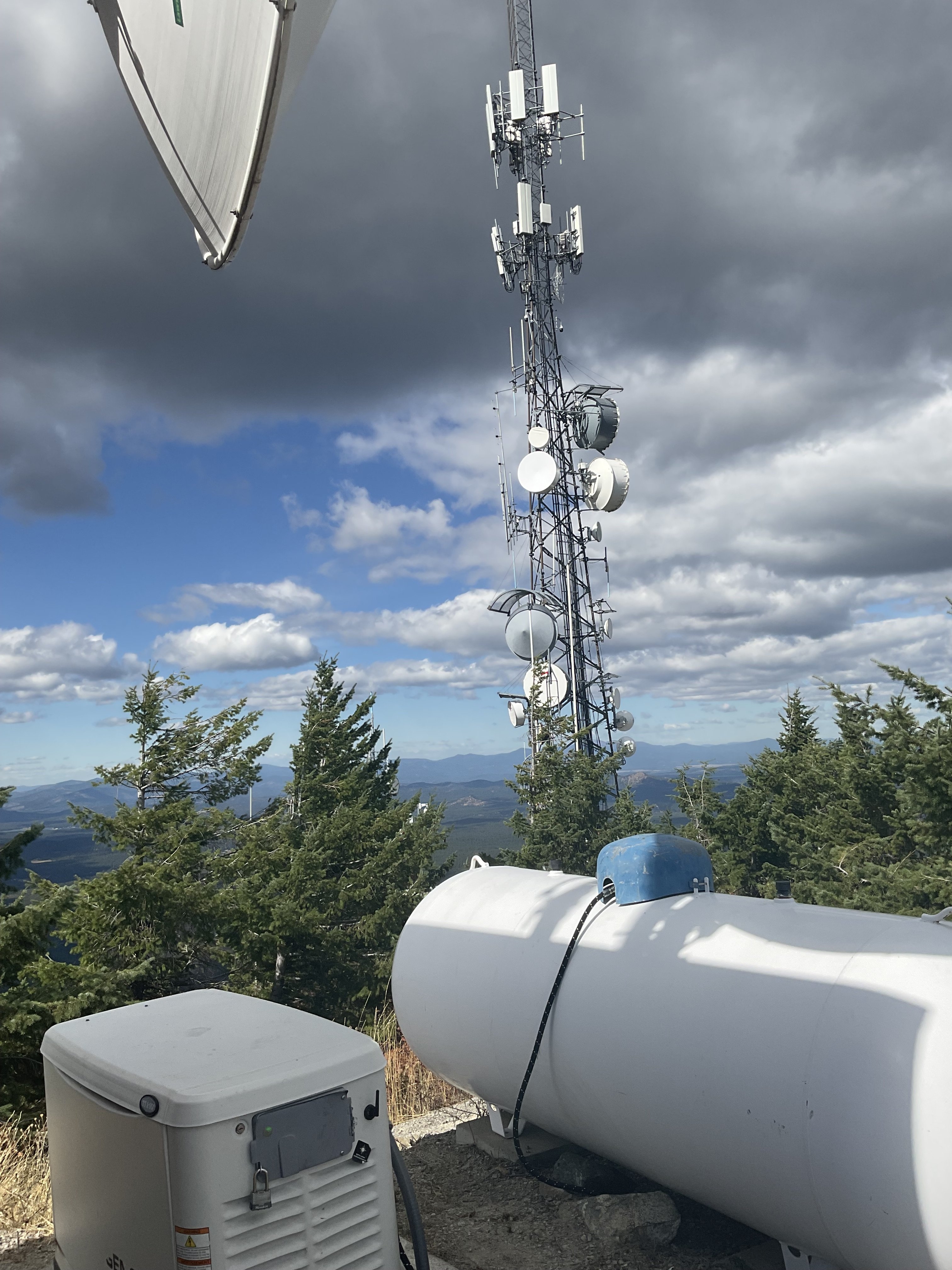

Did a service call friday
Thinking that was your Let's Add Telemetry After You've Already Gone There Already customer..... or was it a different commercial customer ?
I like the view from high-tower sites, thanks for the pic :cool:
Rgds, D.
   / Your last generator Maintenance Run #6,996
That rig should keep you well updated with that much telemetry!
   / Your last generator Maintenance Run #6,997
Yup, im doing 3 other cell sites this week and next week. Those include service also.
Get to try out the newer f150 4x4 system now. I just got slide bed swapped out and they installed shell.
