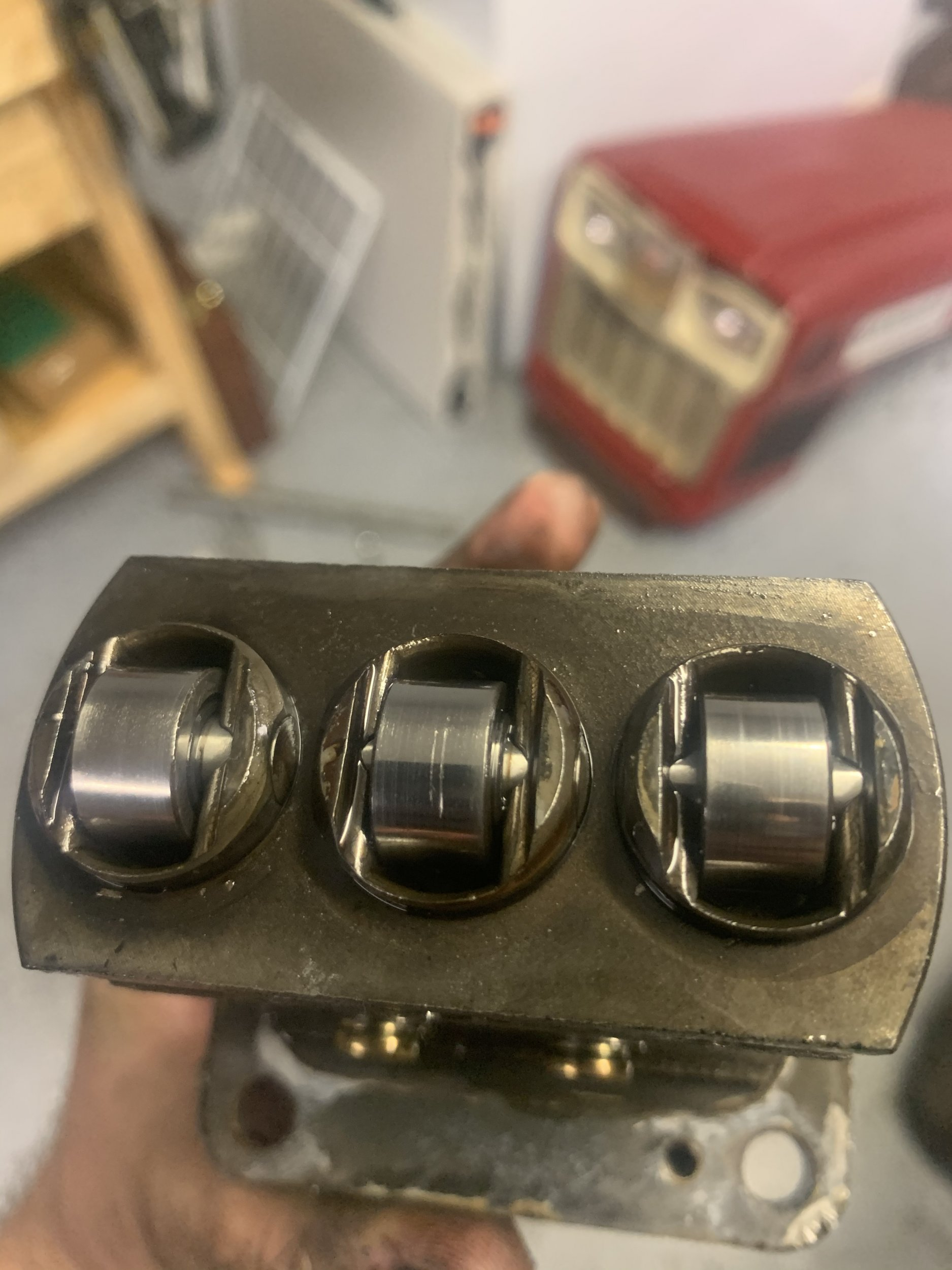

One thing I have some questions on is the injector pump. My original YM226d had a 721550-51700 T86 injector pump. This new tractor came with two injector pumps, one is a 721550-51700 that is completely disassembled and stored in plastic bags, the other is a 3T72SA injector pump and is currently installed in the tractor. From what I have found online, the 721550-51700 looks to be correct, but are these pumps interchangeable? Without knowing any better, my gut reaction is to take the pump out of my old tractor and use it on this one. This seems like the most efficient path forward because I don't have to assemble the new pump and I am fairly confident it's the correct pump for the tractor.
With that said, I pulled the 721550-51700 out of the old tractor and noticed some small scratches. Is this a problem?
Not sure about the scratches being a problem or not.
I do know that the 'same' engine in various Yanmar models use different fuel pumps to achieve higher or lower engine Hp. If you knew the fuel pumps flow rate, of the unknown pump, you could determine if a 1Hp to 3Hp gain could be had.
The 3T72SA fuel pump came off of a YM1510 or a YM1502. The engine piston diameter is just 3mm [1/8in-ish] difference. It could flow very much the same.
Glad you have both machines under one roof.

Thanks Bmaverick!
I did some more digging now knowing the 3t72sa came from the YM1502 or YM1510. It appears that several OEM numbers were used originally but if you were to replace the injection pump today, several of them cross reference to the same IP-375 pump.
Between the Hoye site and Southern Global I am finding IP-375 replaces OEM #’s 721550-51700, 721461-51700, 721454-51700, and 721520-51700. This corresponds to tractor models YM187, 220, 226, 250, 1301, 1401, 1502, 1510, 1601, 1610, 1702, 1800, 1802, 1810, 2000, 2001, 2002, 2010, 2020, 2202, 2220, 2240, 2301, 2310, 2402, 2420, and JD750.
Since the 1502/1510 and the 226 cross reference to the same IP-375, it makes sense why this 3t72sa pump was used and I believe is correct.
