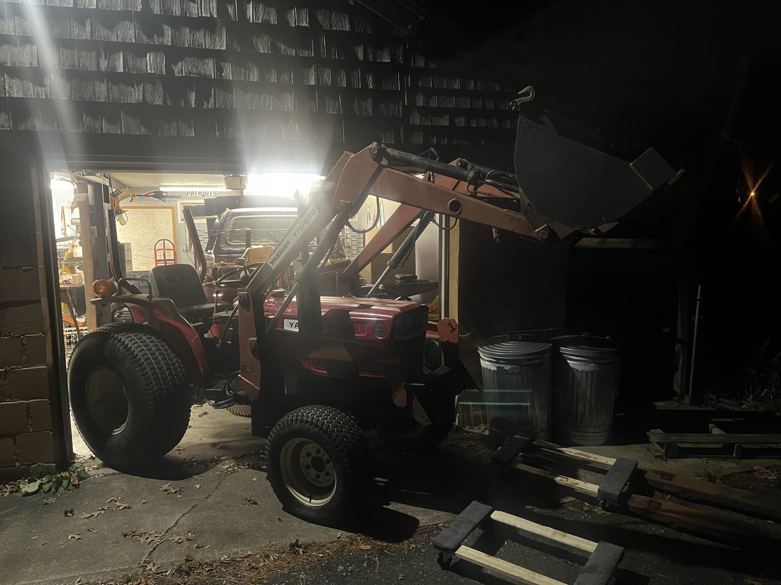

rScotty and Winston are geniuses! Winston nailed it, I was missing the 1/4" plug and rScotty had the theory right - I had high pressure on both sides of the controller.
Sure enough I checked the old tractor and found the 1/4" plug right where Winston's diagram showed it was supposed to be. Swapped it over to the new tractor, fired her up, and within seconds had a functioning FEL. It was getting late and dark so I only played with it for a few minutes but I'm super happy to have reached this point. Can't wait to try and use it sometime this week and see how everything goes. Thank you everyone for the help so far, I couldn't have done this without you!

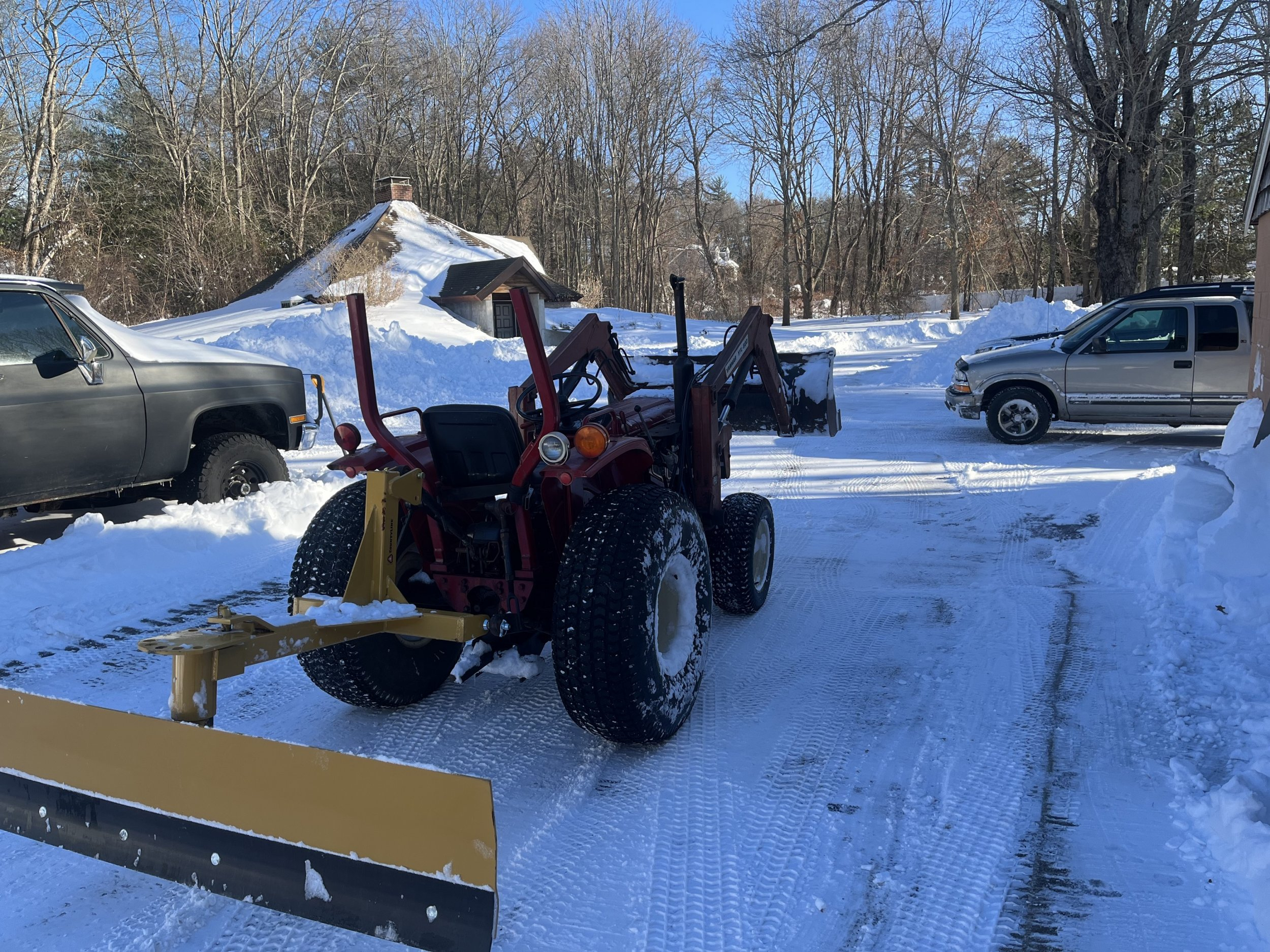

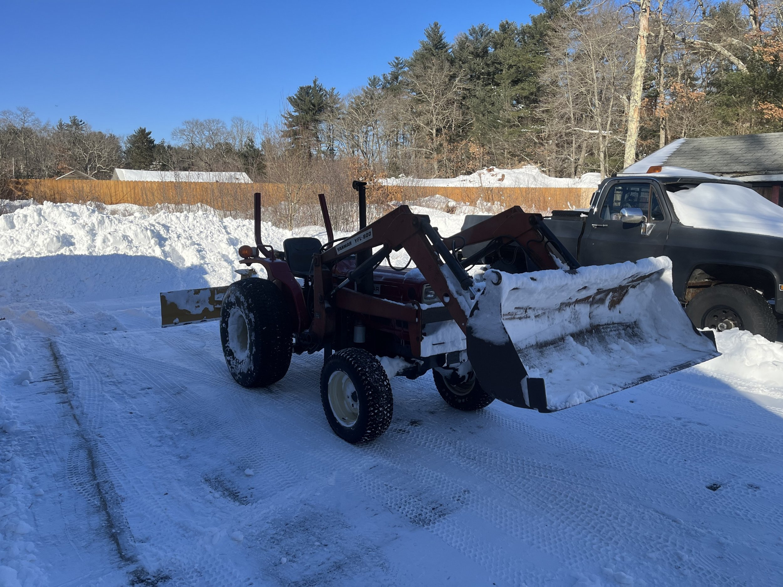

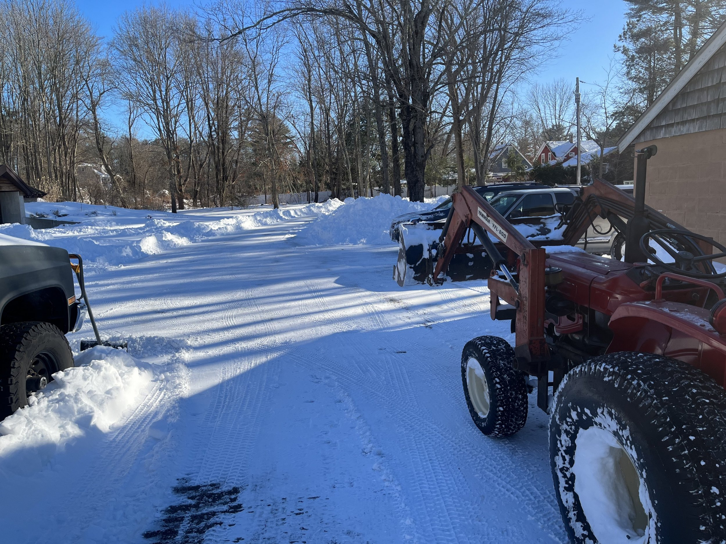

Hey everyone! Been awhile since I checked in. Everything has been running great! Worked the tractor hard this weekend. We had a major storm roll in and got over 2 feet of snow. Took some time figuring out the best methods to clean that amount of snow up with the Yanmar, but got it done! I ended up using the bucket and the blade about 50/50 and enjoyed every minute of it. Check out the post clean up video and some snap shots, as well as a video of the back blade in action from a smaller storm a couple weeks back.
What size King Cutter blade is being used? I have the smallest yellow blade like yours.
If you drove in reverse in a faster PS selection with the blade turned about 15 degrees (1-pin selection) all of that snow would get pushed to the side in no time flat. The downside is, that kink in the neck after 20mins. LOL
Your drive looks to be about the length of mine, but you have a wide turn included.
Great vids. :)

That is a 6' CountyLine blade from Tractor Supply. I will give it a try in reverse next time. I've been running in 2nd gear with the PS in 2nd or 3rd.
AKA King Kutter blade. It's just rebranded for Tractor Supply. ;)
I have the 5FT wide version.. Works really well. The off red/orange one is the 4FT version sold, but my rear wheels would leave imprints.
