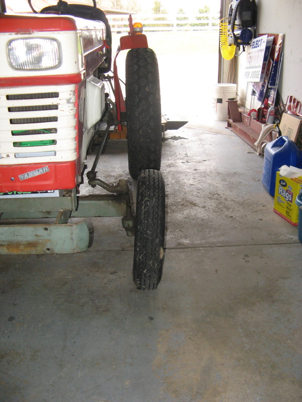

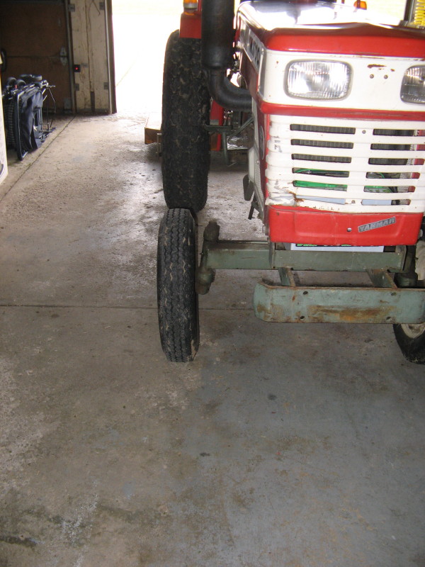

My front tires are leaning out some on my YM1700. Some folks said that was normal on here, but one was leaning more than the other, so I was suspicious still. I've attached pictures from the front where you can see the difference in lean between the 2 tires. I found that (with the tires off the ground) I could wobble the tires in and out in the camber direction (same direction it was leaning.) The front-right(RF) tire the total movement measured at the top of the tire was only 1/16", but the left-front(LF) the movement was 3/8". When I spin that LF tire, it's not as smooth as the RF. Perhaps the castle nut just needs tightened, but I'm thinking the bearings may need replaced. I need to get a 30 mm socket to tighten or take off the castle nut. Thoughts?

Sounds like what has be mentioned in your other thread:cool: pull the castle nuts check the bearings & spindles, if your lucky the spindles or not too badly worn and can get by with replacing the bearings, also look into the hub for any wear marks ,

If you are talking about the wheel bearing castle nut it should not be much more than hand tight. Is your slack in the wheel bearings or spindle bearing and bushing? Yanmar Tractor Parts: FRONT_AXLE_2WD
Winston1 -- Looking at the part diagram from Hoye, I would say the slack is between the horizontal piece of the spindle and the the #12 bearing, but I haven't pulled it off to examine it yet. The seal does not appear to be leaking, and it was packed with grease when I pulled off the hub cap.

The frt bearings are ball bearings, there is no adjustment with castle nut. If the wheels are loose you will have to replace the bearings, your talking maybe $24.00 for all four bearings. I had to do the same thing to my YM2000.

Yep, I didn't look at the drawing close enough, just assumed tapered roller bearings. Castle nut might be pretty tight.

Check the fit of the wheel bearing inside of the hub. These hubs can enlarge over time and will give considerable amount of wobble. If the bearings do not slide into the hubs snugly, then you might want to replace the hubs. Mine had worn and I machined the inside diameter larger and made shim rings to tighten them back up. Buying new hubs is expensive but a much easier remedy than shimming.

An expanded hub sounds likely.
I took off the cotter pin & castle nut and then a washer. Can someone tell me how to get the first bearing out?I've never replaced a wheel bearing before.

This Yanmar Tractor Parts: FRONT HUB 2WD should pull off (maybe tap off) the spindle with the bearings in it. The back bearing has a snap ring behind it. Once you get the hub off you can drive the bearings out of it. They should be an interference fit.
