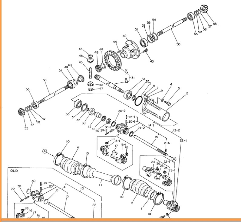

Today the front end of my ym186D had what i would consider a catastrophic failure.
I had it in 4x4 and it made a noise and i think i have something broken in the front end.
I parked her and removed the front driveshaft to find that if i try to move the tractor the front axle will turn about 1/2 turn and then tires will lock and drag.
The input shaft to the front axle seems to be disconnected from the differential.
When i lifted the front end off the ground i could spin as much as i wanted as long as the other wheel was turning the opposite direction, but when you try to turn them the same direction it locks up almost immediately.
I know i need to pull the input shaft and dig deeper but....

The description sounds to me like the "smaller differential gears" are working fine, but the ring and pinion are more likely the problem. You stated the input shaft seems to be disconnected. Yet the whole assembly locks up when it tries to turn. To me that seems like some teeth have broke loose and are jammed up in the ring gear.

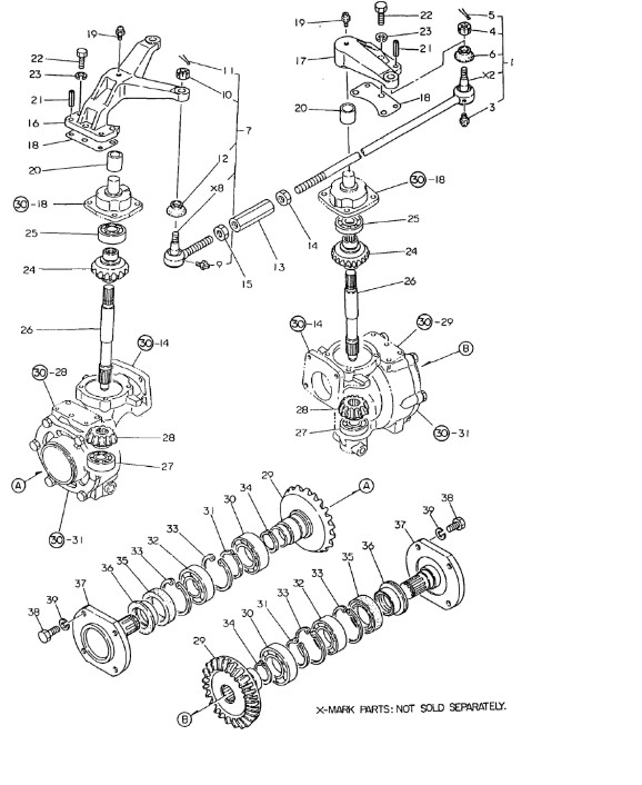

I have attached pics of your YM186D front axle parts.
They may help you in determining the problem.
Sounds to me like Harry in KY may be correct.

Nailed it yes broken pinion and ring
