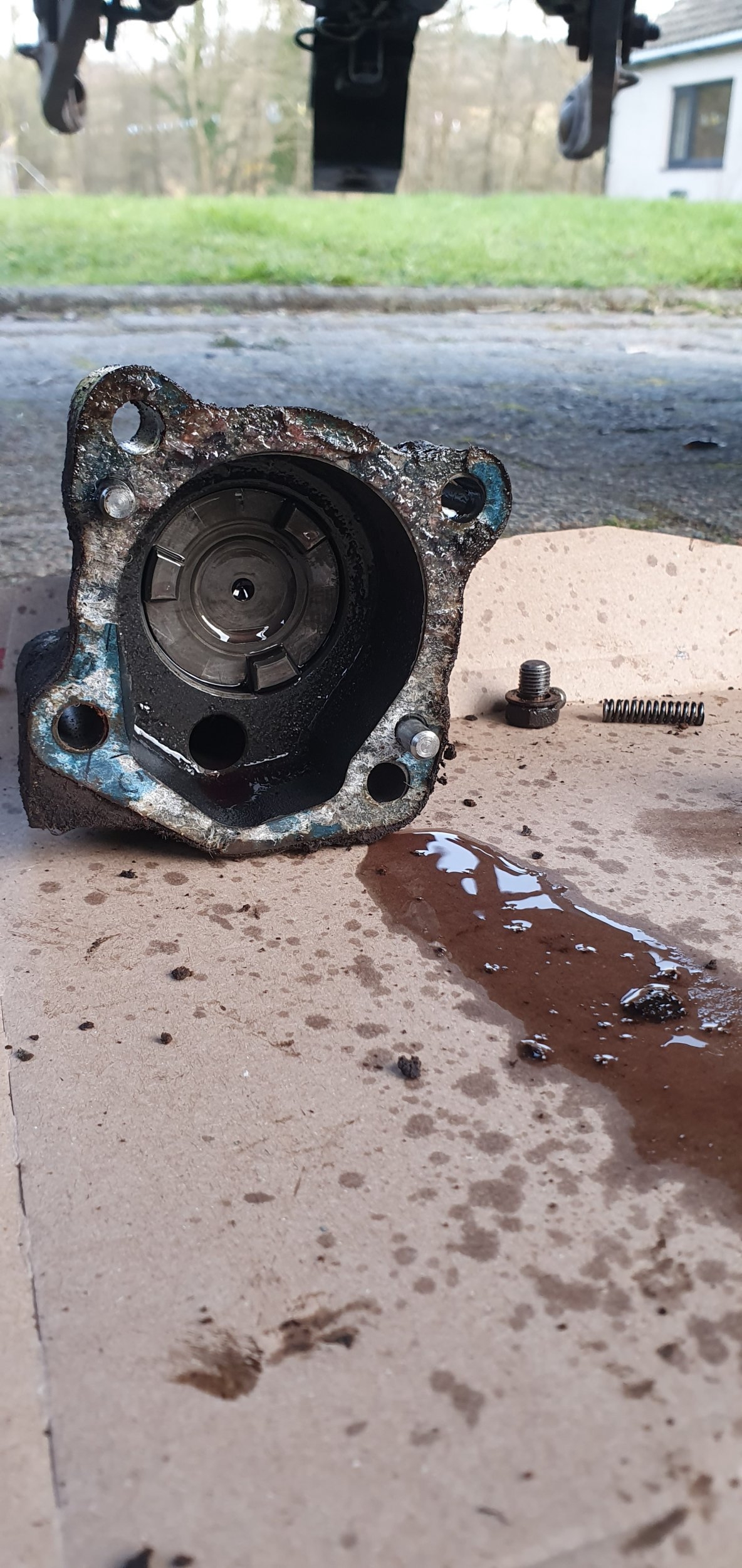

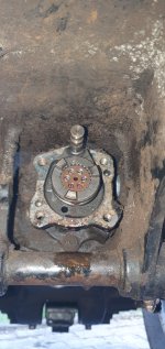

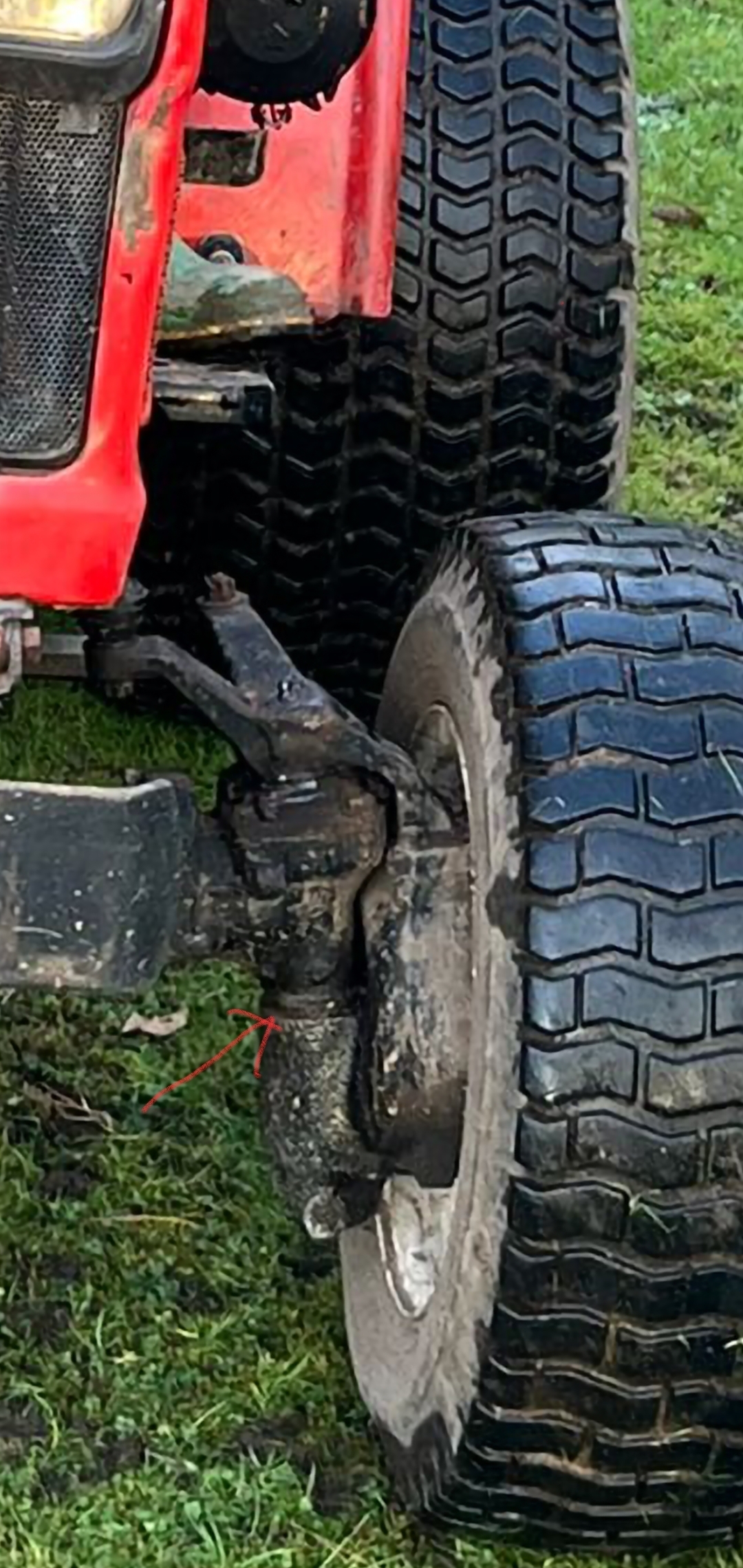

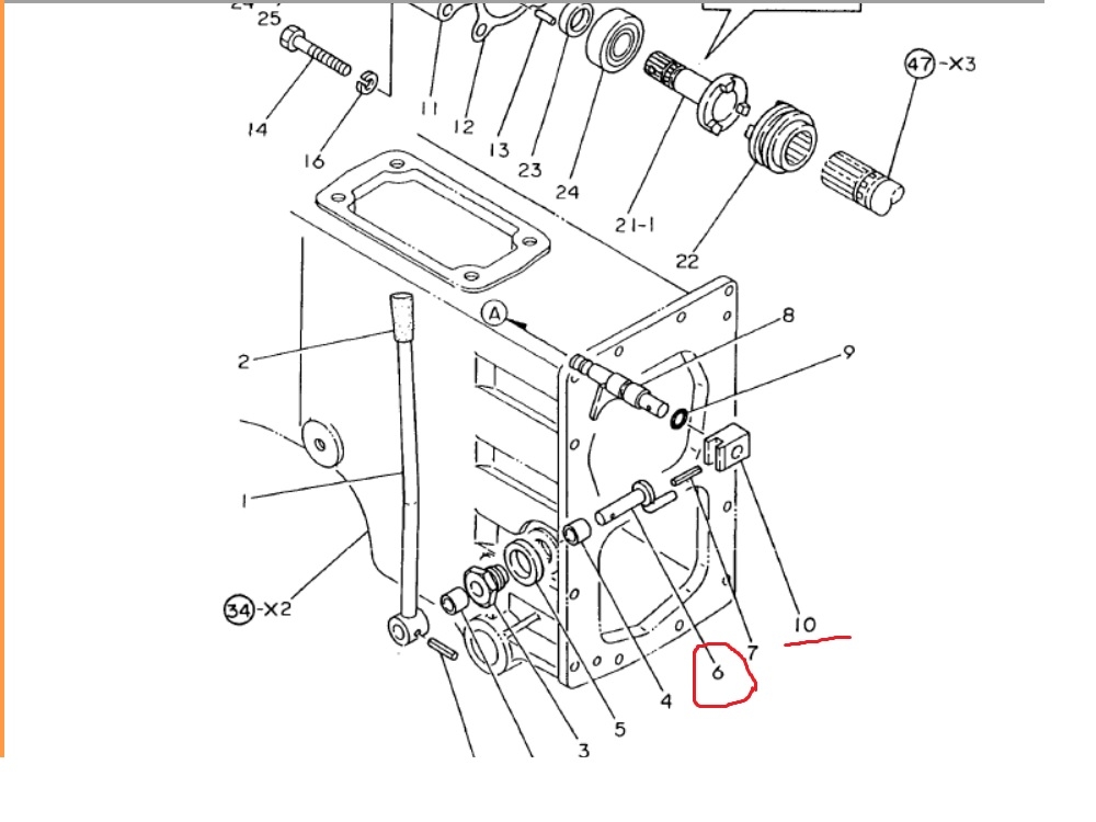

I have been told that the spline couplings are uncommon sizes and hard to source. But getting one fabbed up is looking like my only option currently. I know a guy who could do it but it would mean leaving the tractor with him for months as he takes so long to get round to getting things done.
If i could find the couplings i would have a go at fabricating one myself. But i have no idea how i would match the couplings up which i need.
The original piece broke as it was seized in 4wd and someone has forced the lever to try and select 2wd. It isn't a very strong design

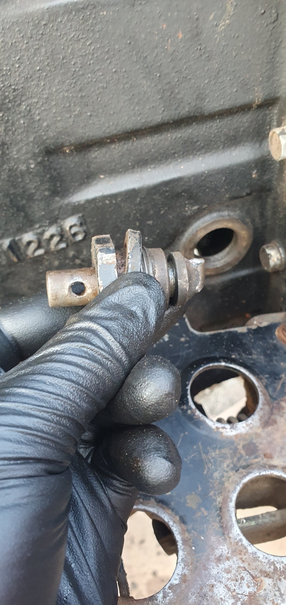

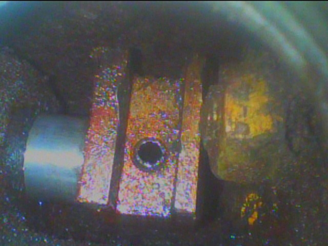

You should be able to measure the diameter of the small rod that broke off and weld a 1 1/2" long piece of hard rod onto it. Then keep gradually making it shorter until if fits perfectly.

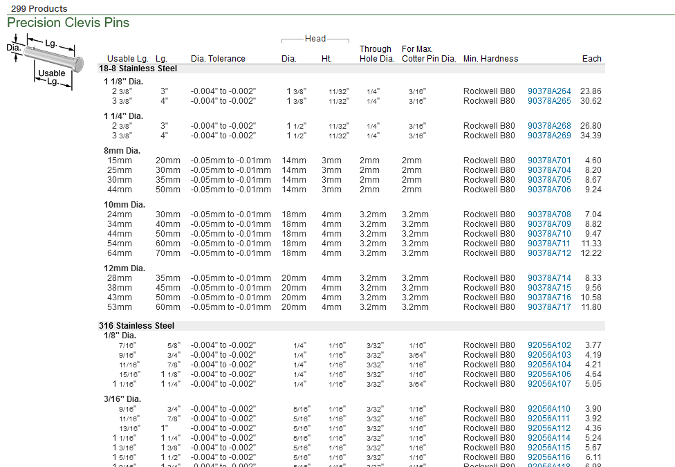

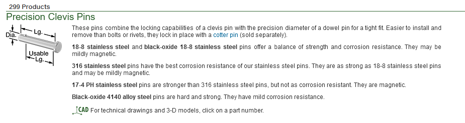

Item-6 sure looks like a clevis pin. If you could take some measurements on what space it fits into, you could order one and then if needed turn it down to size.
Order from McMaster-Carr their customized pins like it or something close enough.
McMaster-Carr
These standard types are at a great price too,
Yes, it is exactly like a clevis pin. But it has a short length of hardened rod welded to the end that extends over into the slot on the shift block.
It was the rod that broke off.
/ My YM186d #28
I do not know the size of these parts.

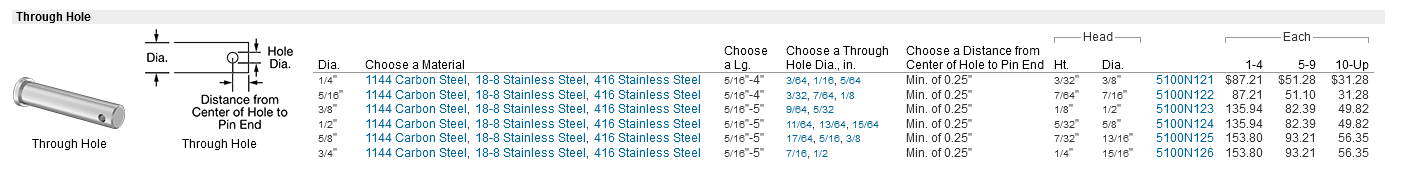

With the clevis pins, some have a threaded base at the bottom. A person can then screw on a rod to the base. From there you would have a working part for your machine. McMaster-Carr has parts like that in the links too. Maybe some options to try.
/ My YM186d #29
I've noticed the broken shaft stub and the one noted as #6 in the pic don't really match up with the trip pin facing 2 different directions.
I would keep trying at Hoye, though suppliers in Europe may be cheaper. There are a variety of splines on driveshafts, and yes, there are some that are more common in Japan than elsewhere, but they aren't unobtainable, at least in my experience. I would start with the number of splines, diameter, and work from there. Once you have the ends, the drive shaft is pretty straightforward. Again, I suspect that you have more than a few quasi local fabricators that could do the work. I've been impressed at some of the work coming out of Yorkshire and Cumbrian fabricators.

J&R replied this morning with only "we cant help you"
Ive messaged a heap of drive shaft and prop shaft manufacturing places and tried Hoye tractors again, the place which has replaced them just said i need to contact Hoye.

That looks a great site post above i will have to check it out.
For a bit of an update. after all the places i emailed i think 2 of them replied to say they couldnt do it.
But i found a guy on facebook selling a ym186 engine and parts. i messaged him saying i would buy everything off him but he was extremely hard to deal with. in the end he said he would just sell me the front axle with the driveshaft but then he became very awkward so i never managed to buy them from him. i left it a few weeks and messaged him on my girlfriends facebook profile and it wasnt easy and took a while but the front axle and drive shaft have shipped and i should be receiving them on Tuesday!
Also i was gardening around where i left the tractor when i first bought it and i found what looked like it could be the snapped off part of the shaft which engages and disengages the 4wd! I cleaned it up and while i had the welder out i put some tacks on it, refitted it to the tractor and my machine is now selecting 4wd and 2wd easily! I can see the end of the output shaft turning when in 4wd and not turning when in 2wd. So when this shaft turns up next week, so long as it is in decent condition it should just be a case of fitting it and then my machine will be sorted.
I will get some pics when the parts turn up. Fingers crossed ive got this issue sorted! If in the future anyone ever gets a batch of shafts made up i would still likely order one as a spare just incase.
