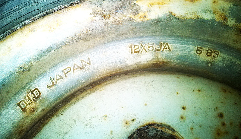

I have been reading about the supposed date stamped into a wheel for many years, but have never read of anyone actually seeing it.
And finally here's one in the wild. :)
This is a front wheel on the YM186D. All the wheels show 5-83.
   / Yanmar Serial Numbers #13
All of my U.S. Yanmars have a similar date stamp on the wheel, but I take it with a grain of salt when trying to guess year of production. My opinion about the reconditioned tractors is that guessing the production date via the wheel stamp is like throwing darts in the dark.
