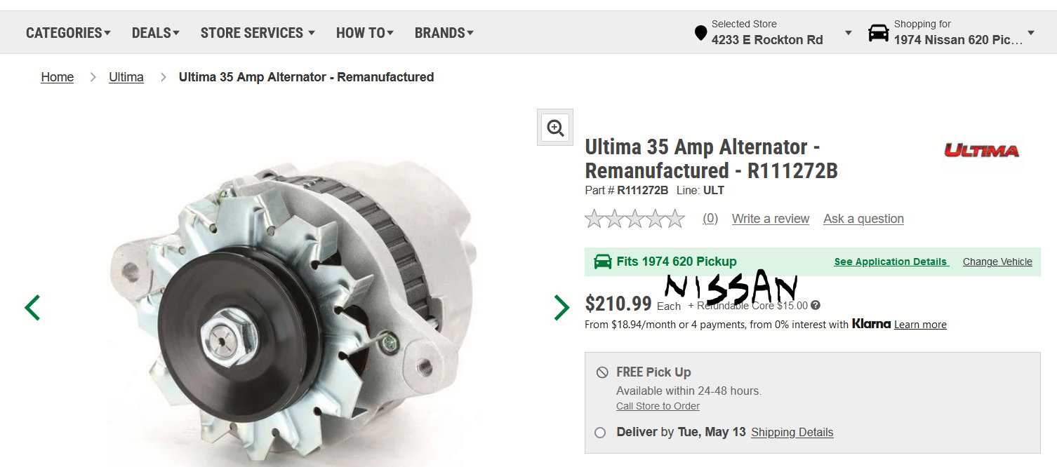

Dang tariffs are B-A-D. 3-years ago $59, now $210 !!! :mad:
If we knew what vehicles this fit on, I would go to a salvage yard for a good one. (y)

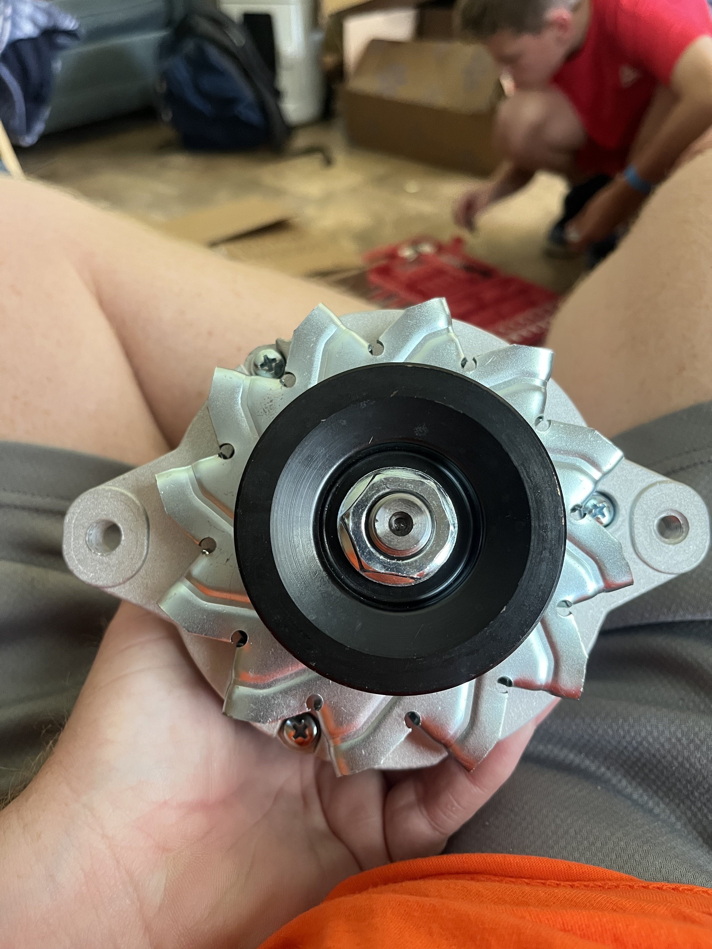

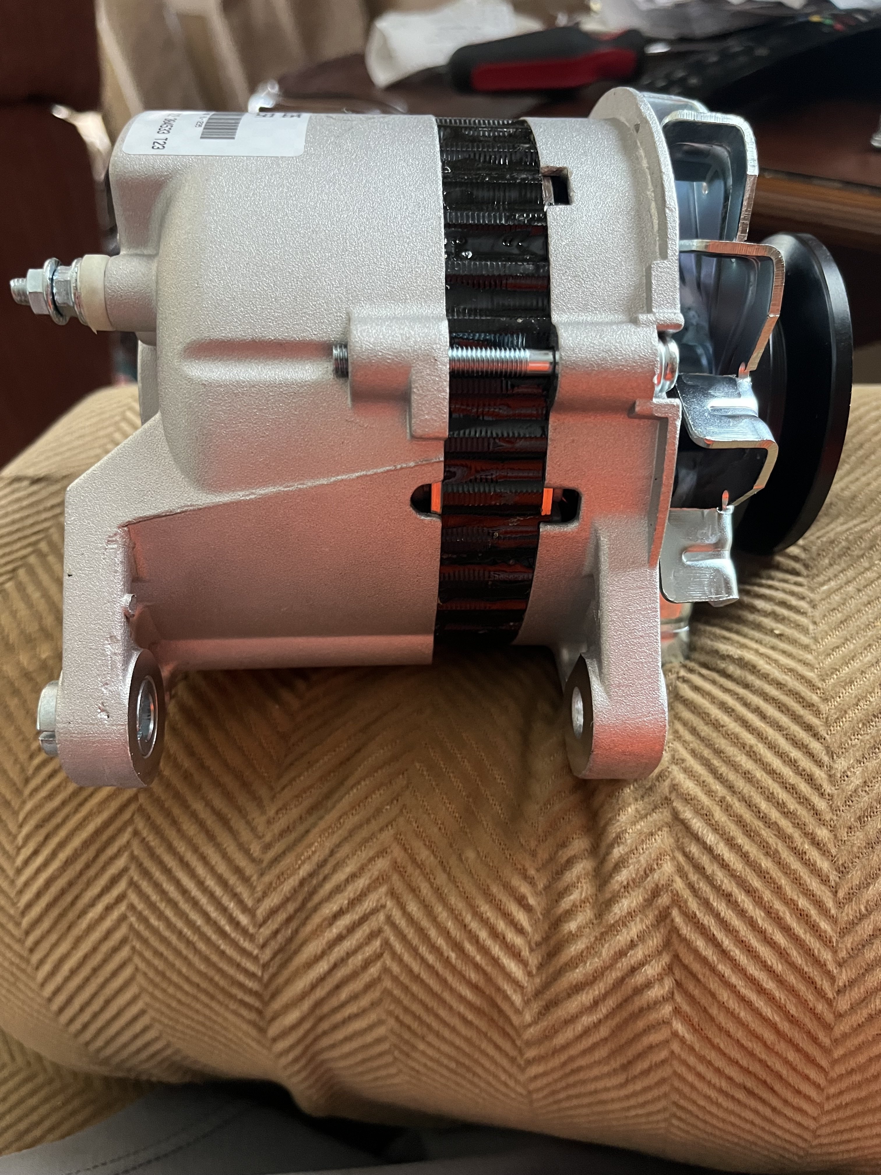

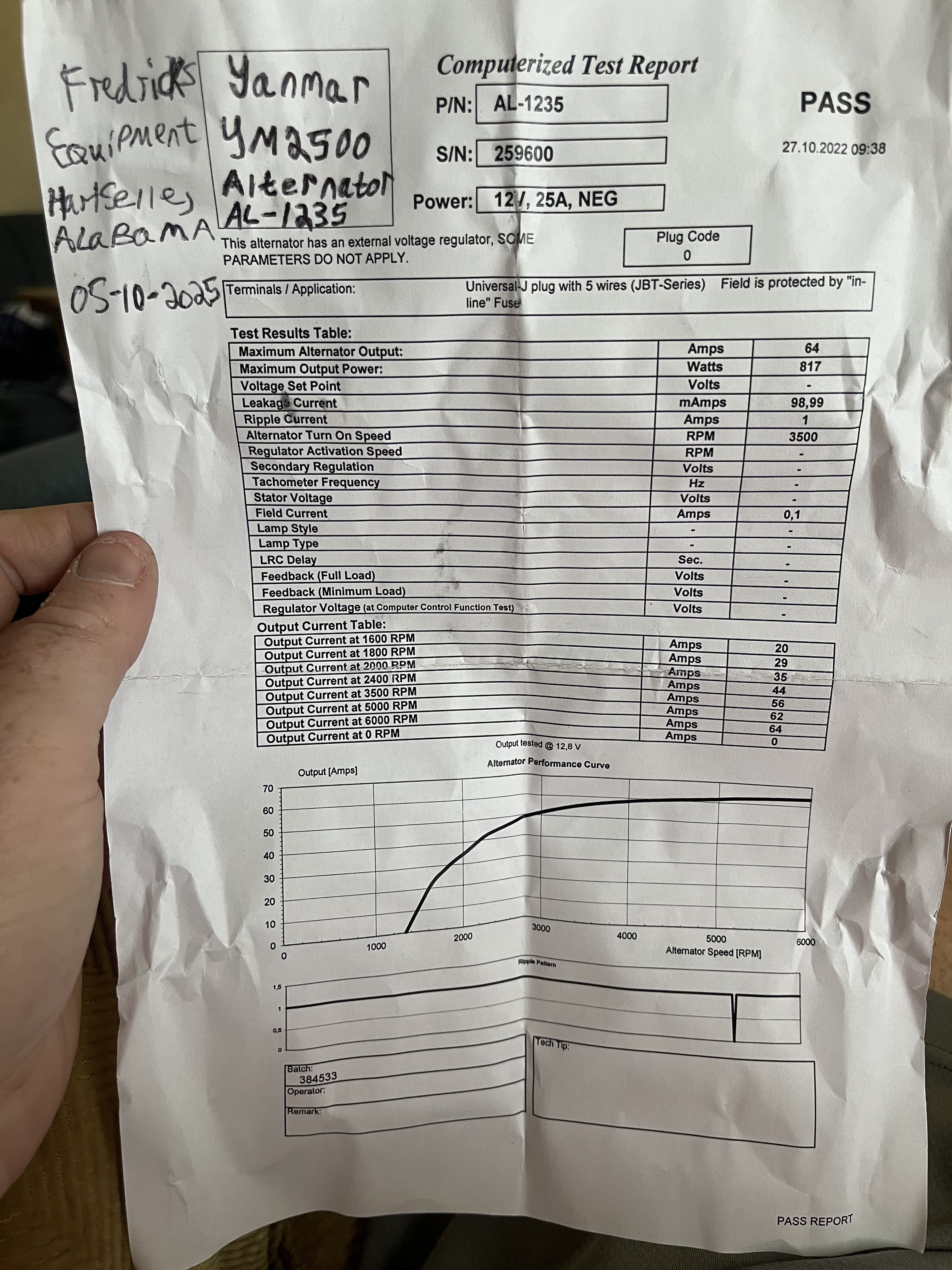

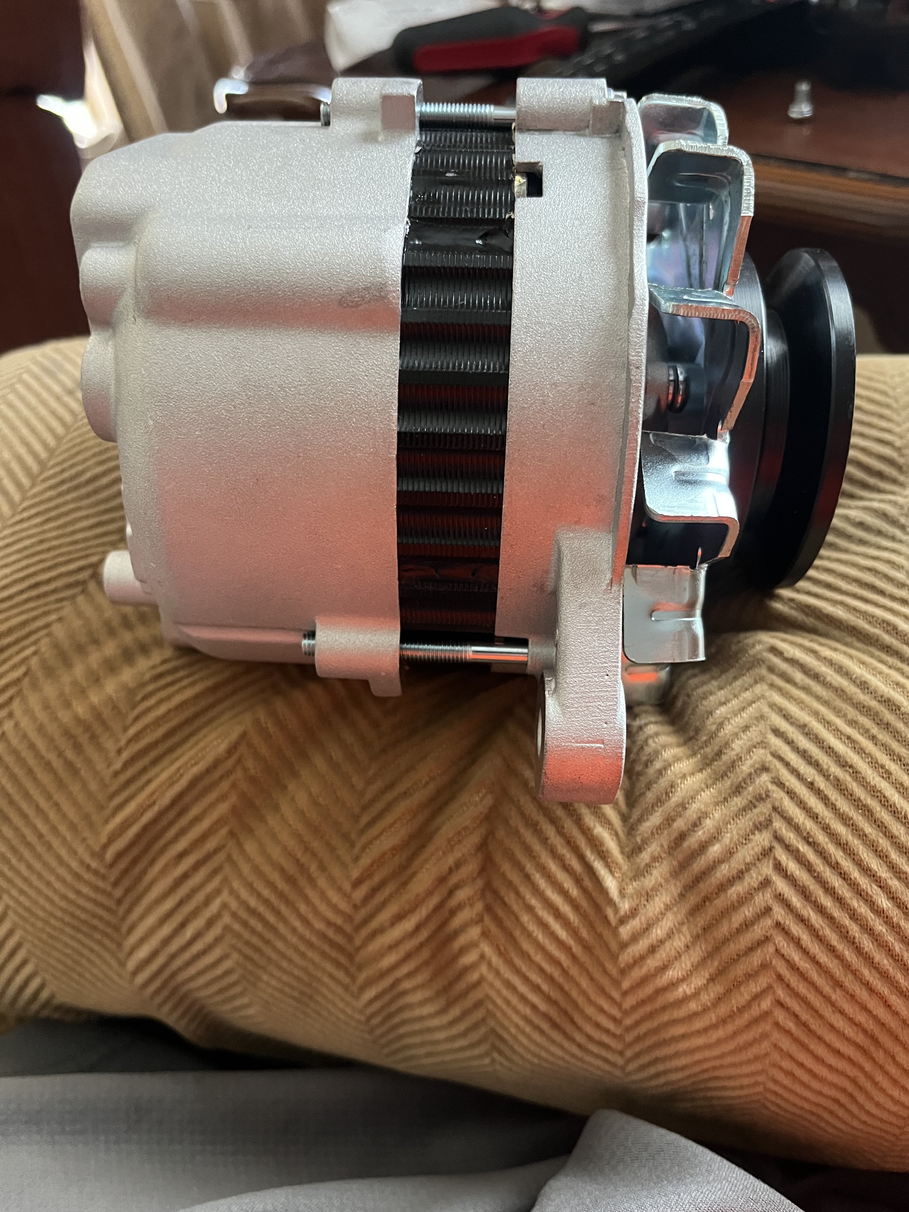

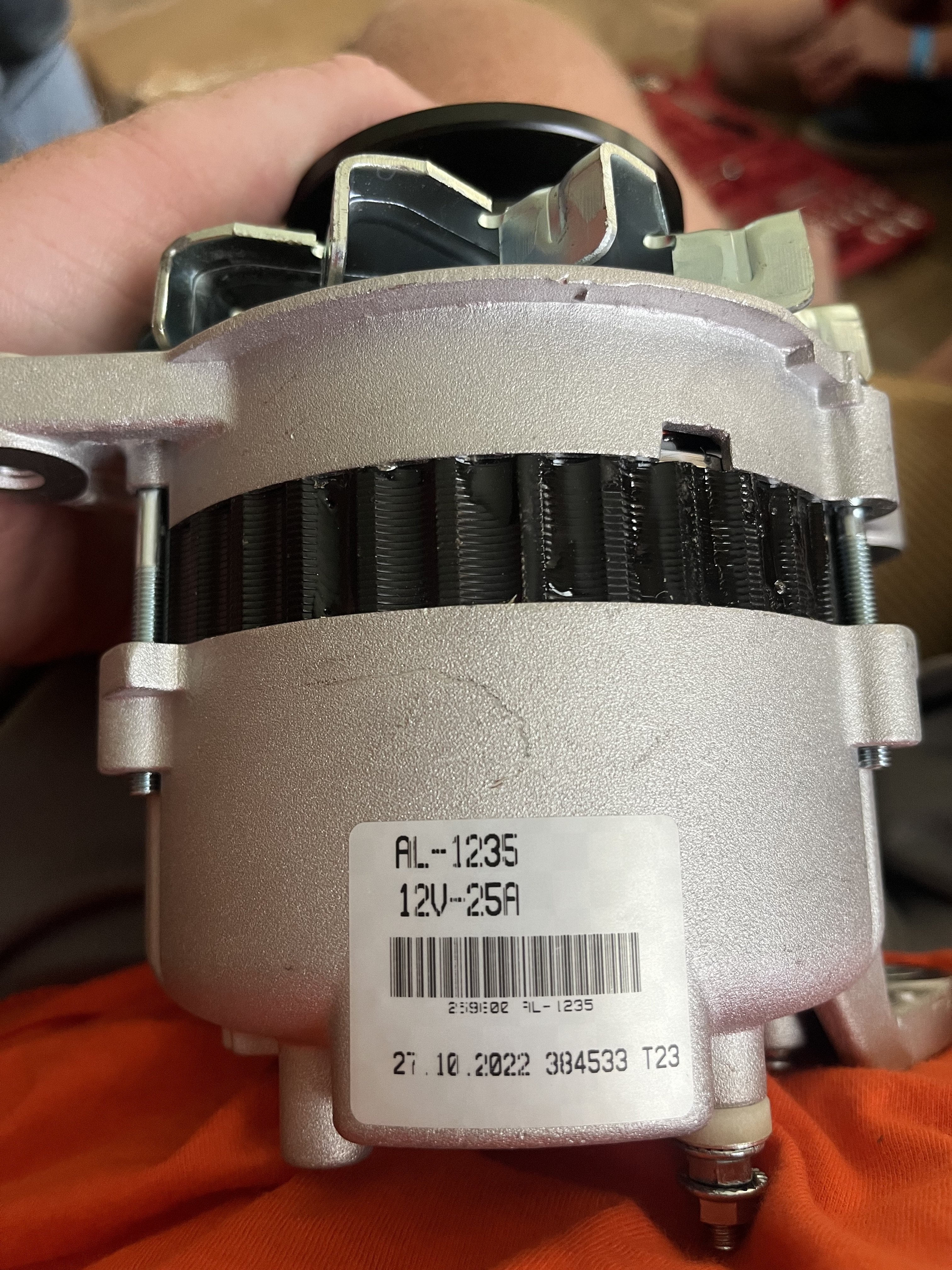

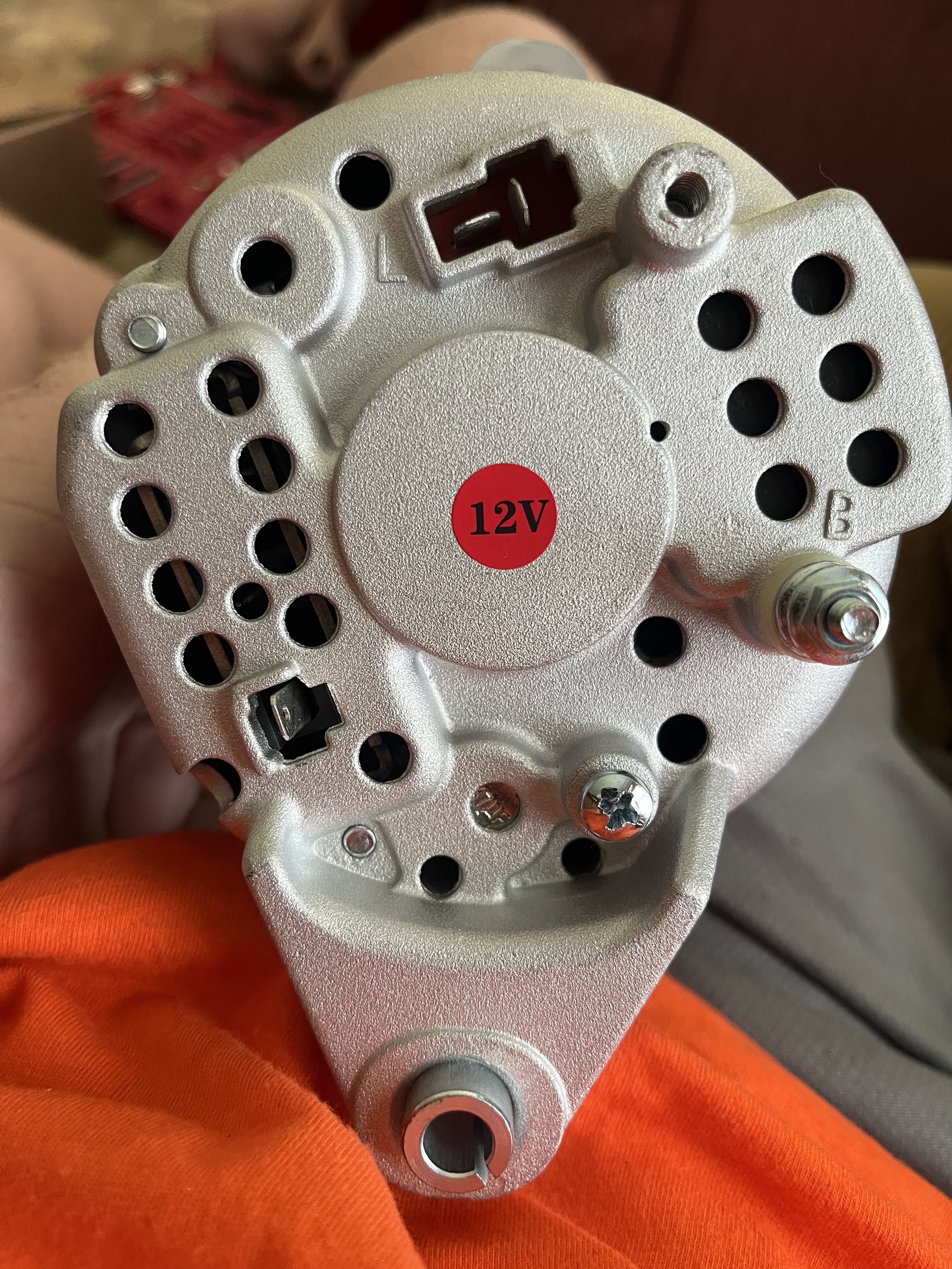

Here are pictures of the AL-1235 Alternator from Fredricks Equipment in Hartselle, Alabama. Their phone number is (256) 751-3555. www.FredricksEquipment.com
It fits the YM2500, YM2610, and many other models. It’s a 25 Amp alternator.

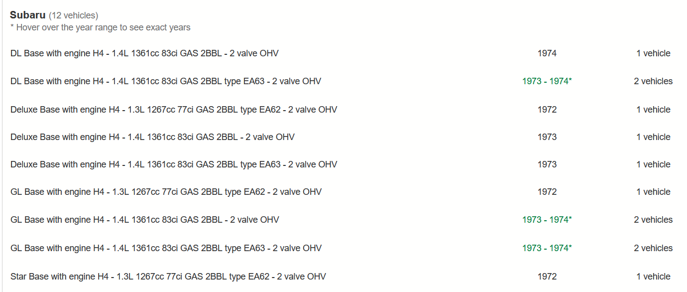

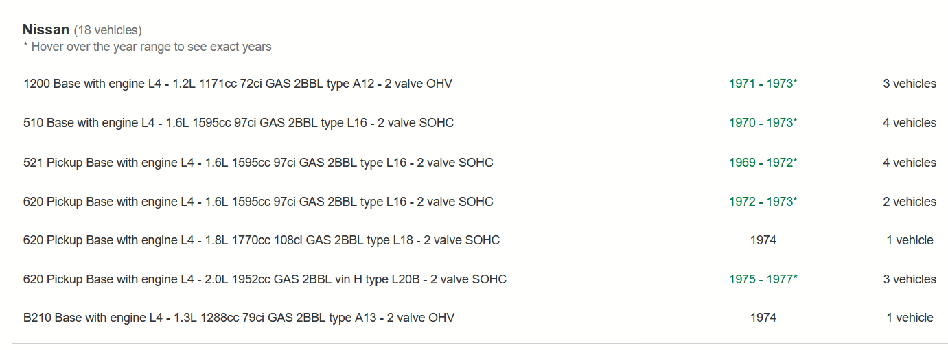

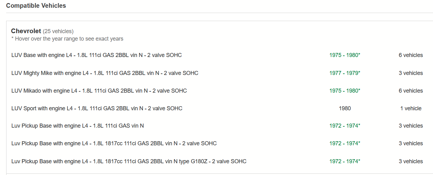

When I replaced the alternator on the YM2000 YM240, the alternator used on 72-73 Datsun was the perfect match. $29 in 2004.:) And the modern solid-state equivalent for its mechanical voltage regulator wasn't expensive, maybe $12.
Datsun went to something else a couple of years later but this alternator/regulator combination was very widely used in the 70's so every Autozone etc had them.
Note you want the 25 amp 'Datsun' alternator for 'no Air Conditioner'. The AC version (35 amps?) is much fatter and you would need a different adjustment strap.
Mine was the 35A unit and it fits perfectly. What strap is needed? :unsure:
   / YM2500 or YM2610 Alternator #20
When I researched that long ago, the AC version alternator for 73 Datsun was larger diameter. I read somewhere that this wouldn't fit so I measured where it would go, and concluded it could be solid against the block and the existing adjustment strap still wouldn't reach out far enough.
It sounds like today's alternator has 35 amps in what used to be a 25 amp shell.
But unless you are night plowing or moving snow, I don't see a need for more amps. Especially with the LED bulbs used now. The original 15 amps is sufficient to just maintain the battery for starting - for daylight work.
