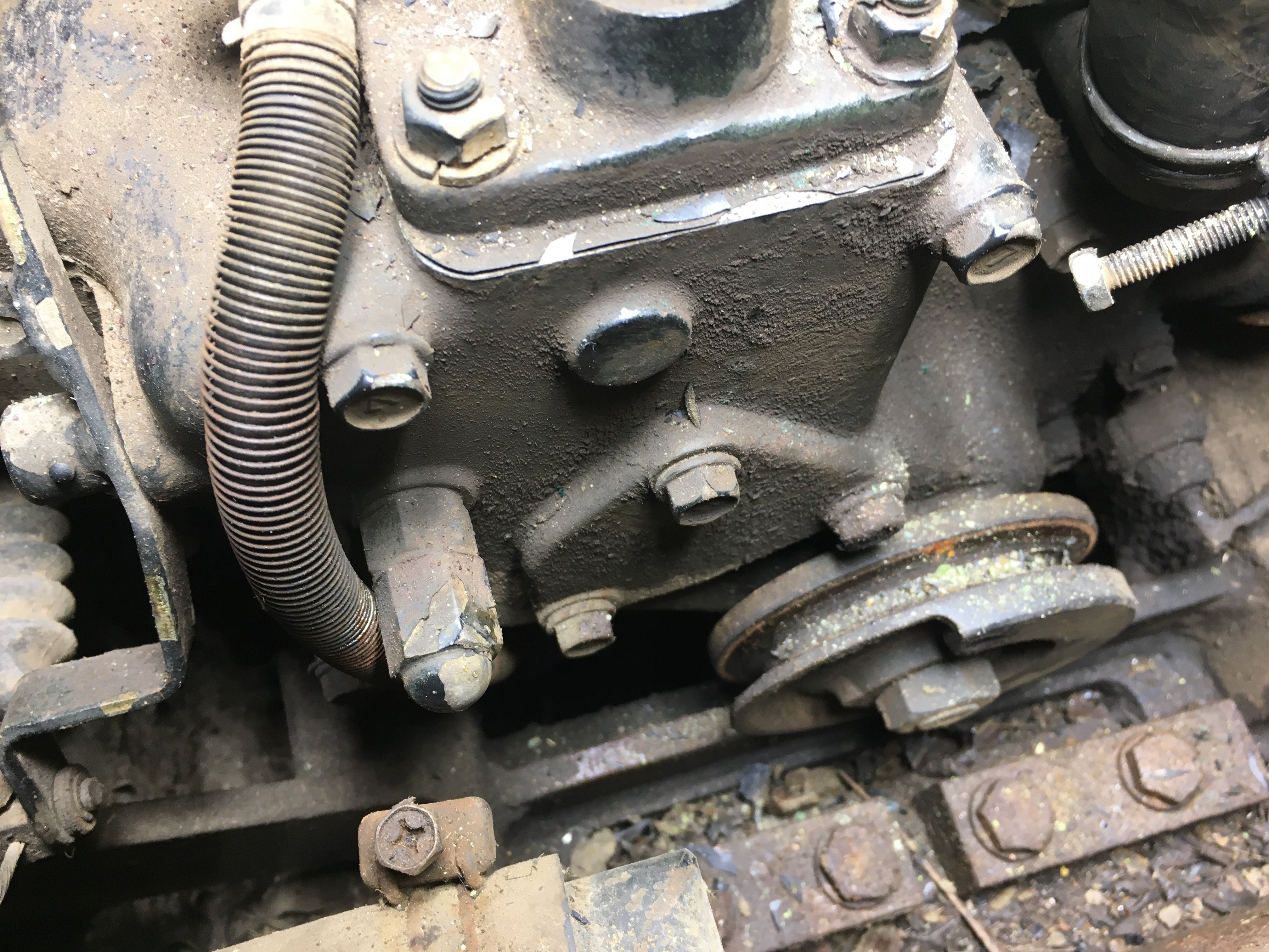

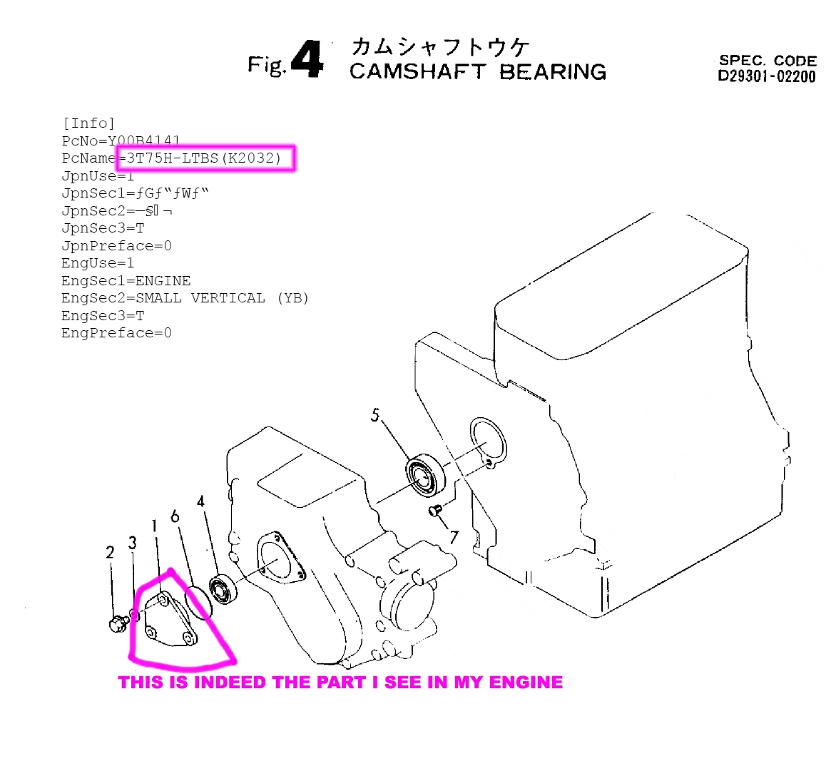

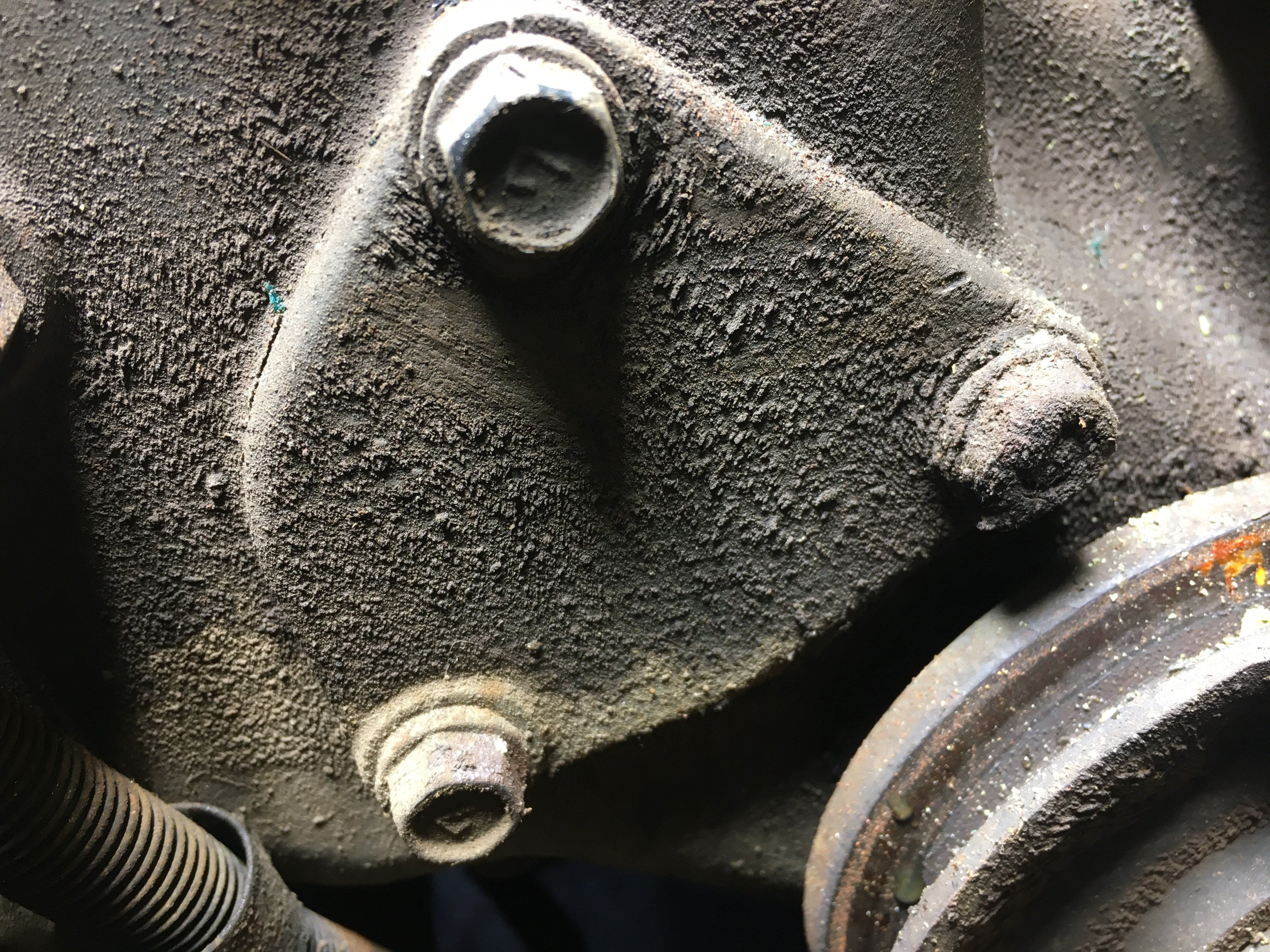

Update per Jan 21, 2025 in the morning (in The Netherlands).
I noticed a particular piece on the side of the gear housing that is different on a 3T75H-LTBS, 3T75HA, 3T75HA-F, 3T75HA-F, 3T72HA-N.
In the 3T75H-LTBS service manual a simple "triangular" plate is shown, which is exactly what I see in my engine.
All other engines seem to be different in this regard.
You know what is "funny"? I see now that even the part number for the waterpump in the 3T75H-LTBS service manual was correct all along, 121000-42100.
So the confusion started when looking engine numbers at the parts suppliers websites (eg Fab Heavy Parts).
As long as I would have followed EXACTLY the part number mentioned in the 3T75H-LTBS service manual, which is 121000-42100, I would have ordered the correct water pump, even though Fab Heavy Parts (and most other suppliers) mistakingly DO NOT LIST this as a 3T75H-LTBS water pump.
Long story short (until proven wrong :) ):
My YB20 DOES have the standard 3T75H-LTBS engine, just as it is supposed to have.
The 3T75H-LTBS service manual shows exactly the same "triangular" camshaft/gear housing plate that I can see in my engine.
The 3T75H-LTBS service manual shows exactly the correct part number for my water pump, which is 121000-42100.
I should NOT have looked at the engine numbers mentioned by Fab Heavy Parts, and I should just have ordered the water pump with part number 121000-42100. :)

Update per January 30, 2025. Good news.
Yesterday I received the water pump 121000-42100. This time Fab Heavy Parts shipped it using Fedex which took 10 days, whereas the previous (wrong) water pump from Fab Heavy Parts was shipped using UPS which only took 4 days.
Anyway, I received it yesterday and immediately installed it. It fitted perfectly and the engine was up and running in no time. So my tracked Yanmar YB20 "fork lift" with snow plow is back in business.
Fun fact: the box containing this new water pump 121000-42100 was labeled 3T72HL.
So for reasons unclear to me, Fab Heavy Parts (and as far as I know all other suppliers) make the mistake of not listing engine 3T75H-LTBS on the list of engines on which this new water pump 121000-42100 will fit. If you follow their recommendations for 3T75H-LTBS you will get water pump 129327-42100 / 12900142005 / 12800142100 which DID NOT fit on my 3T75H-LTBS engine.
So if I have to order other parts in future, I will pay extra attention and compare the parts for 3T72HL with the parts for 3T75H-LTBS, to make sure I get parts that fit my 3T75H-LTBS engine, regardless of the supplier's engine lists.
Anyway, all's well that ends well. Thanks again to everybody helping me with valuable suggestions.
