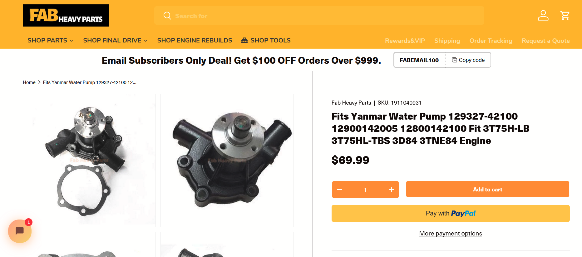

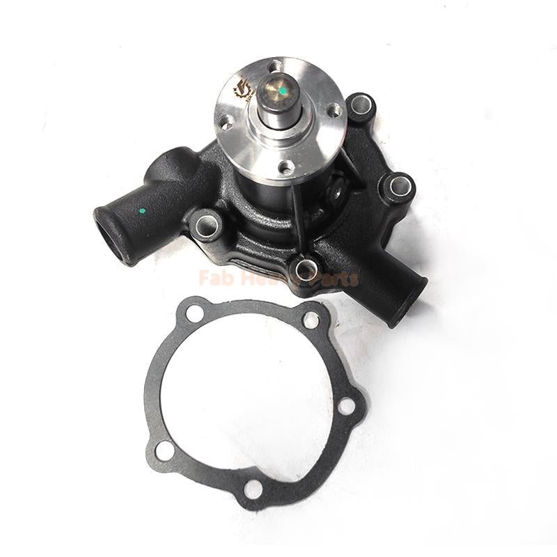

Well I ordered the one from FAB HEAVY. But now that I received it and tried to install it, I found out it is definitely the wrong model. Almost all mounting holes are positioned differently. It is basicallay a slightly bigger pump. Also the axle (if that's the correct English word) is longer than the original.
So that is a big disappointment... :)
I will see if I can order it elsewhere and now that I have dismounted my original, I will try to compare it before ordering.
[EDIT: (jan 20, 2025) I updated the attached illustration because I now believe I was mistakingly mentioning the wrong engine code in it ]
Sorry for the part mix up, though sadly, not uncommon with older machines.
Now that you have the pump off, can you see any markings, for example part numbers on the pump?
Around here, I would suggest taking the old pump to a marine parts shop that might have Yanmar parts and seeing if the technical person can match it.

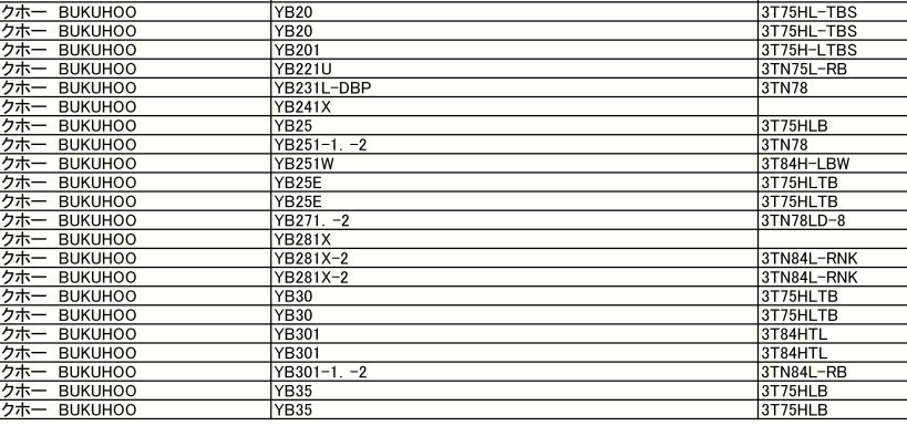

I looked at the old pump. The only identification I can see is "AISIN". After Googling I found this is a Japanese part manufacturer.
But I think I found the correct pump:
So now I am wondering which engine I have.

Similar pumps can be found on the FAB Heavy Parts site (and also on Aliexpress).
In general the search term Yanmar 121000-42100 seems to yield correct results.
In the Yanmar documentation for the 3T75H-LTBS the water pump assy seems to have the code D21521-42100, so the 42100 is probably a code for water pumps and D21521 seems to be related to the 3T75H-LTBS engine.
Anyway, I am beginning to think that my engine is NOT the 3T75H-LTBS but one of the abovementioned list. 3T75HA-S seems to be the closest to 3T75H-LBTS, so who knows..... :)
[ IMPORTANT EDIT Jan 21, 2025: Actually the 3T75H-LTBS service manual DOES mention the correct water pump: 121000-42100.
I was mistakingly talking about D21521-42100 which is some kind of code for the entire parts page, or something like that.
Anyway 121000-42100 is the correct water pump for the 3T75H-LTBS, even though water pump suppliers do not list the 3T75H-LTBS in the list of engine codes for this water pump! ]
I think I will order again from FAB Heavy Parts, since they were very quick last time. I ordered on Saturday and I received it in the Netherlands on wednesday.
I will also see if I can return the wrong model.
Keep you posted.

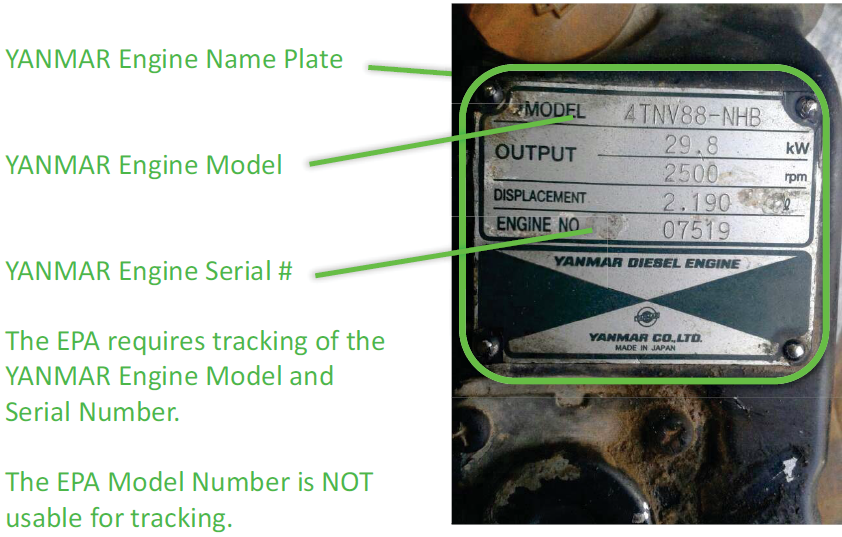

I wonder if your machine's original engine was replaced.
Near the starter should be the engine ID plate.
The 3T75HA-S could be a true mountable replacement engine.

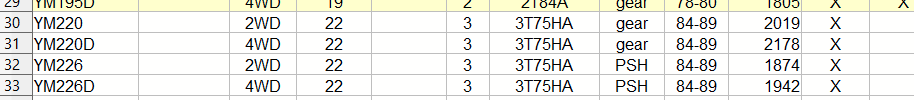

In the Yanmar YM tractor series,
YM250 UK and EU model. 3T75HA
In the Yanmar Gray Market tractors,
YM1810 3T75H
Several of the Yanmar YB excavators use a 3T75H----

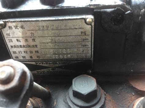

Depending on when the engine was made in what era,
Some engines have the ID near the top, like this 3T75HL

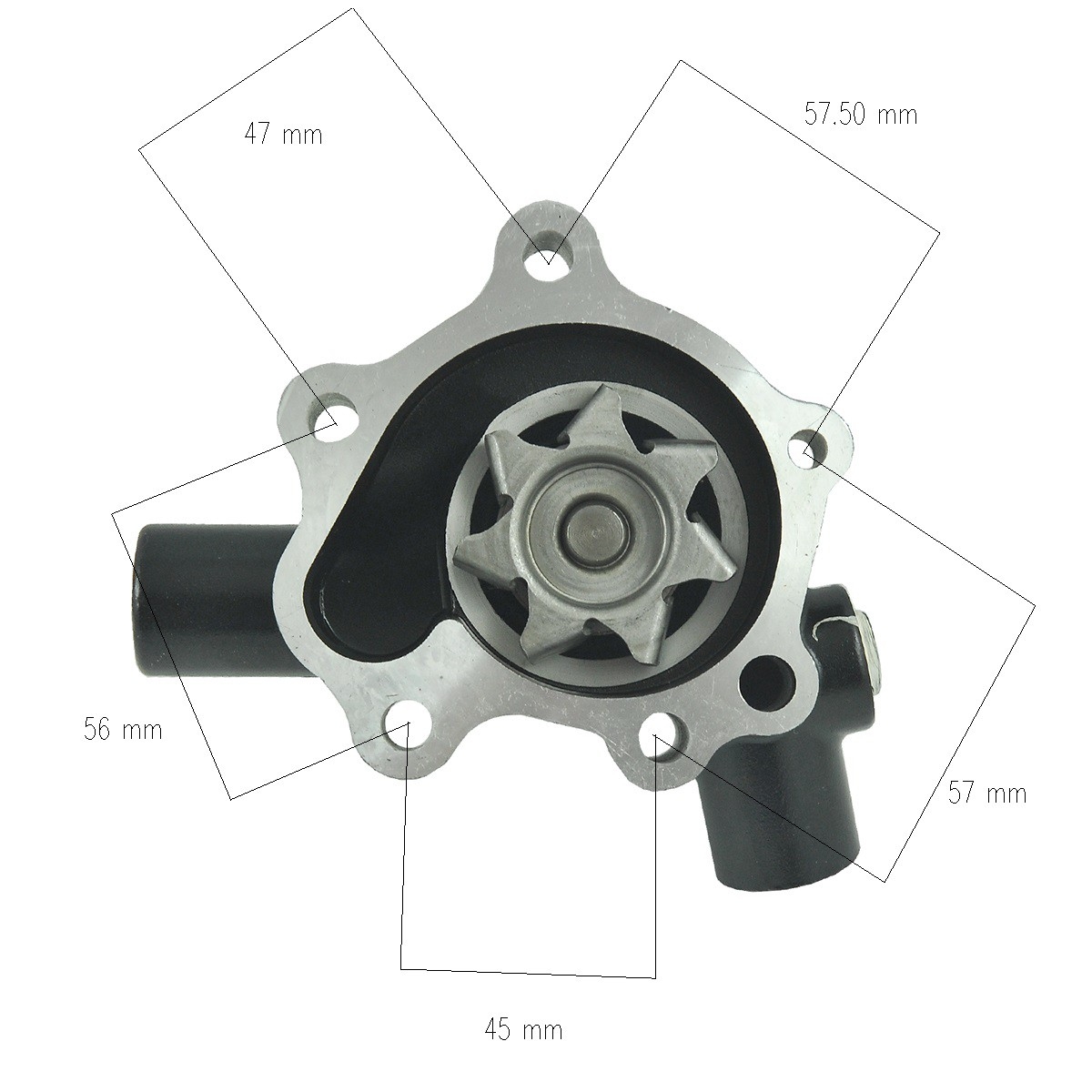

I found yet another site with the pump (I think) I need. This site also mentions all dimensions (photo 2 which I also attached to this reply) plus some useful info about typical causes of failure of this pump and a list of engines in which this pump is used, like (amongst many others) 3T72HL and 3T75HA-S. So it looks like my YB20 does not have the standard 3T75H-LTBS engine. Maybe the original engine was replaced by a previous owner, who knows...
The dimensions are almost the same as the ones I quickly measured. It's just that I took the photo from the other side, so the order of the measured dimensions is the other way around.
