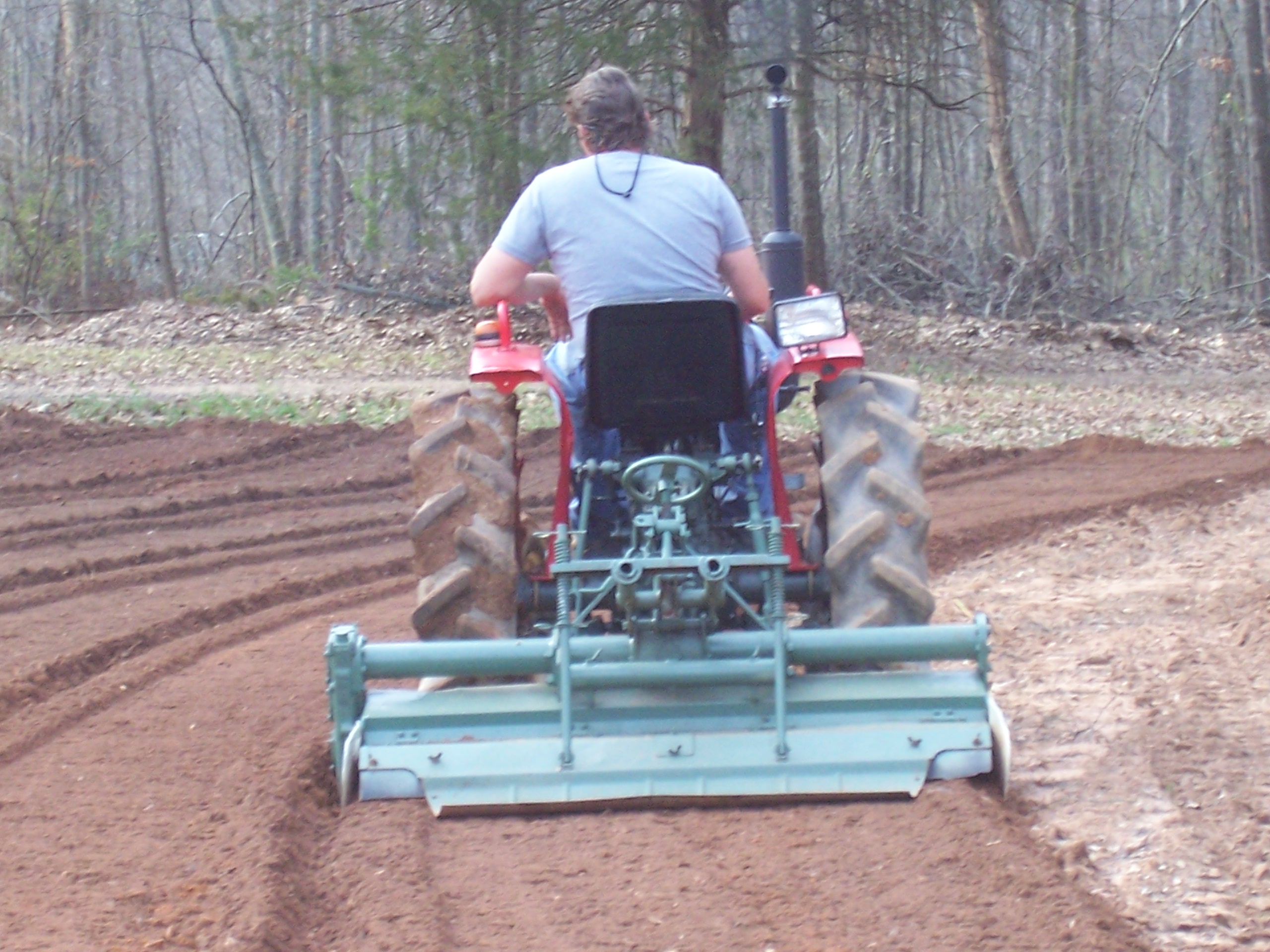

I agree with California and that sounds like a asking price. You can go down on the price but it's kind of hard to go up. Just have to keep looking and watching. I was lucky and found a 1400 at Fredricks. 675.00$ with new tines. It worked great just didn't have the leveling wheels which I was assured I probably didn't need them with my 2000 and was true.

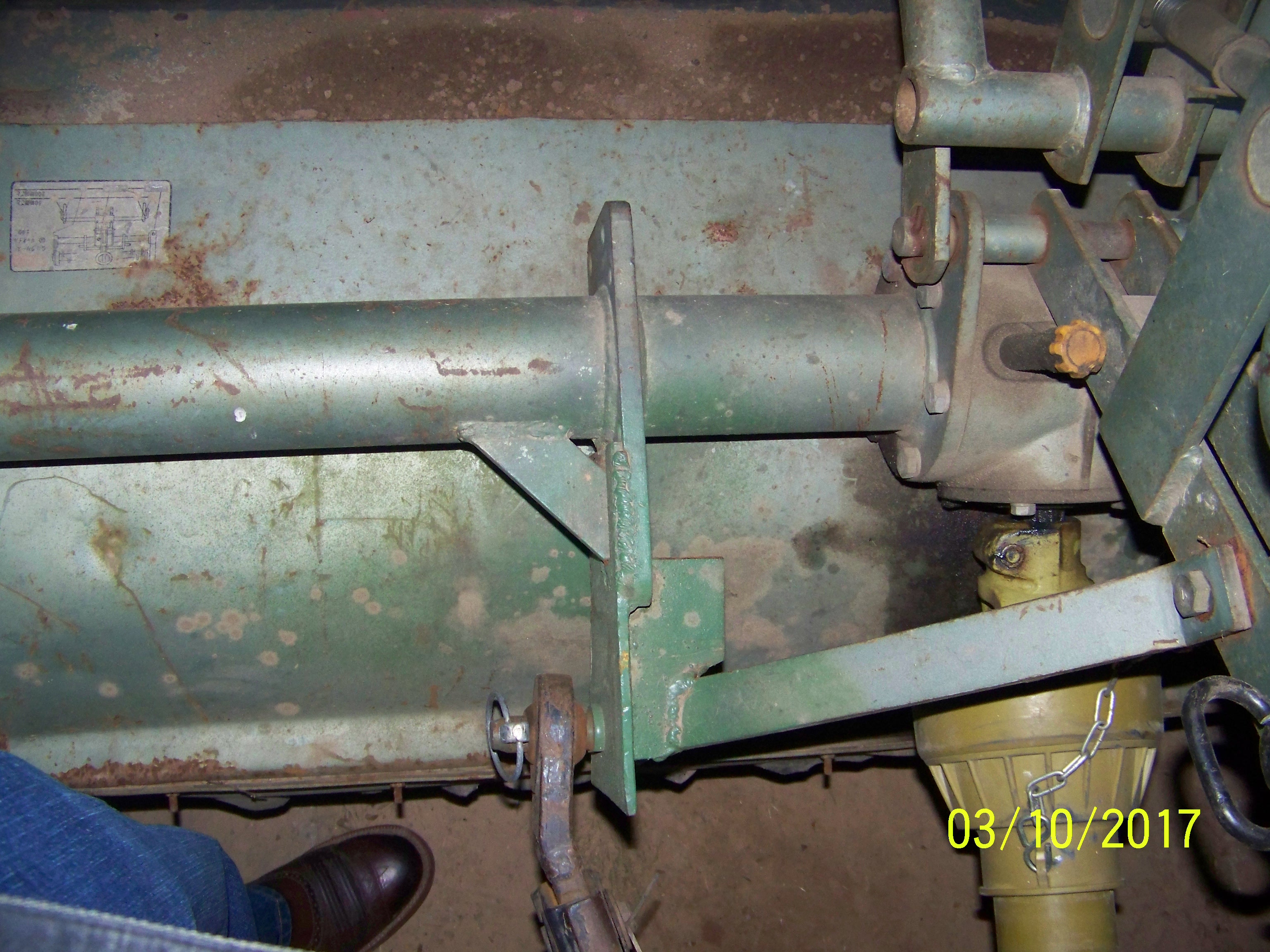

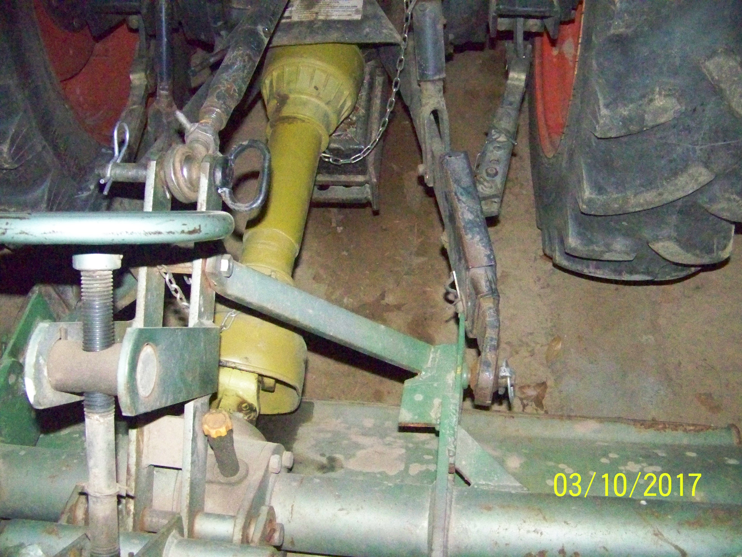

If I didn't have a tiller I would sure be there looking at it. I moved my three point pins forward enabling normal 3 point usage but didn't have to cut anything off the main drive tube.

Nicely done Winston. Those pictures will make a nice reference for many others on here.

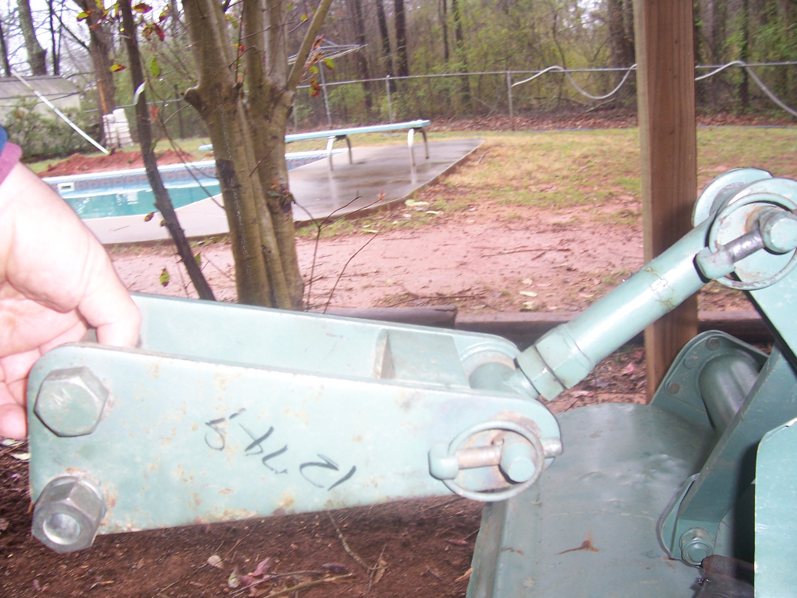

Found the other pic.s of the Top view and the setup of the Yanmar Org. mount. Simple and would be a lot easier to fabricate. The shape of it really doesn't matter all your after it to do is have a movement of out then up when lifting the tiller. I'm taking it that is what was needed for winstons to work on a Kubota considering the Orange wheels?

Yes I remember this topic and those pictures before. Also a good reference.
