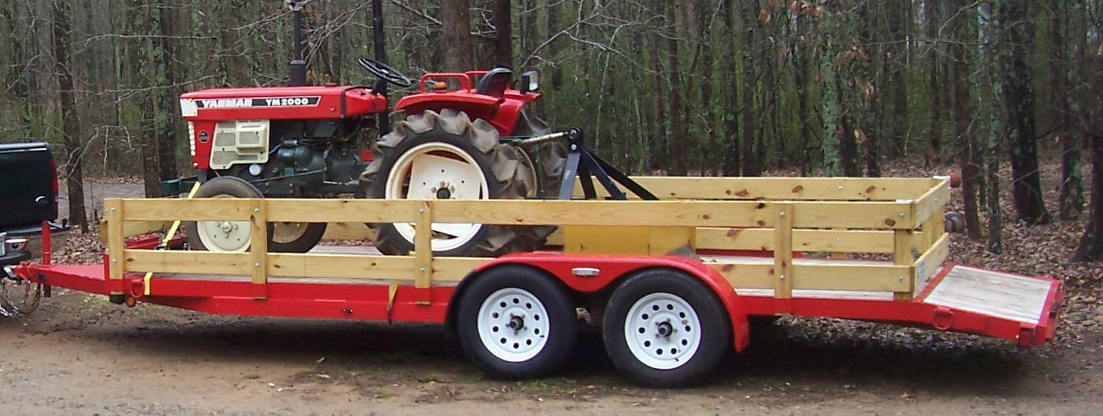

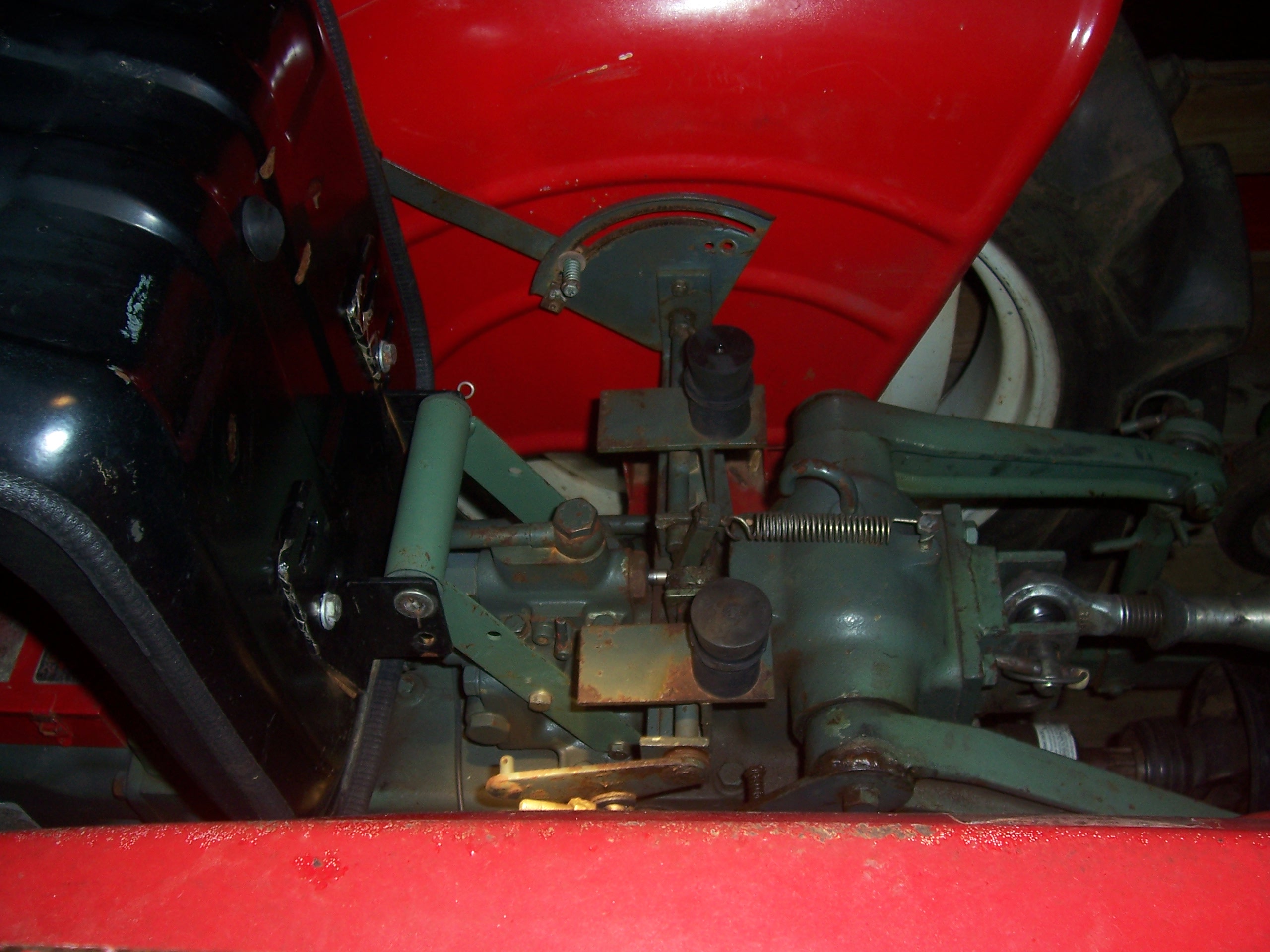

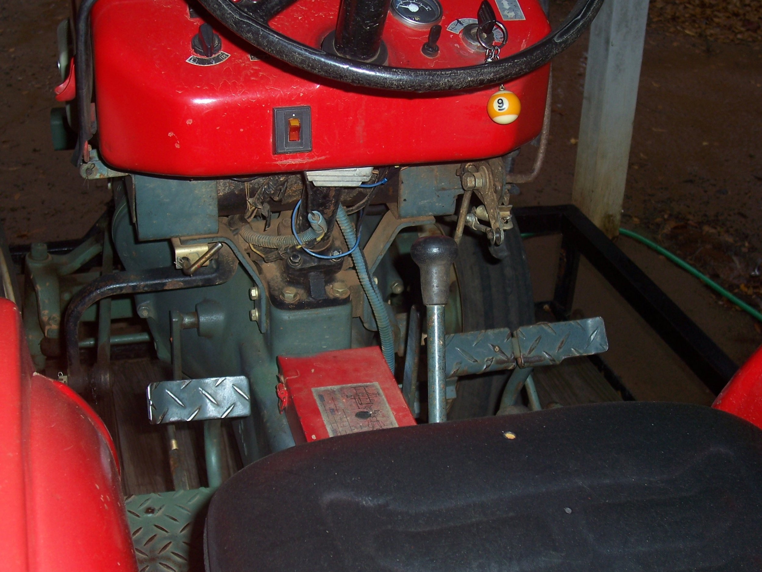

UTDA dealer in 2008 Org. I removed the Model decals since the R. side the exhaust faded it out. I was able to remove and keep the Org. YM2000 decal L.side all intact! Clemsonfor seen that one. In Really good shape!!:cool:
Fredricks is what I used to touch it up. Red was really good for the small light spots. White is Dull compared to Org.. Head lights frame shows that! Grn. seemed Dark but not really noticeable but was in Excellent condition and didn't use much. My guess is it might be the brand that they actually use to refurb the tractors.
When I bought it and today! Everthings still in working order and how I vented the cap.

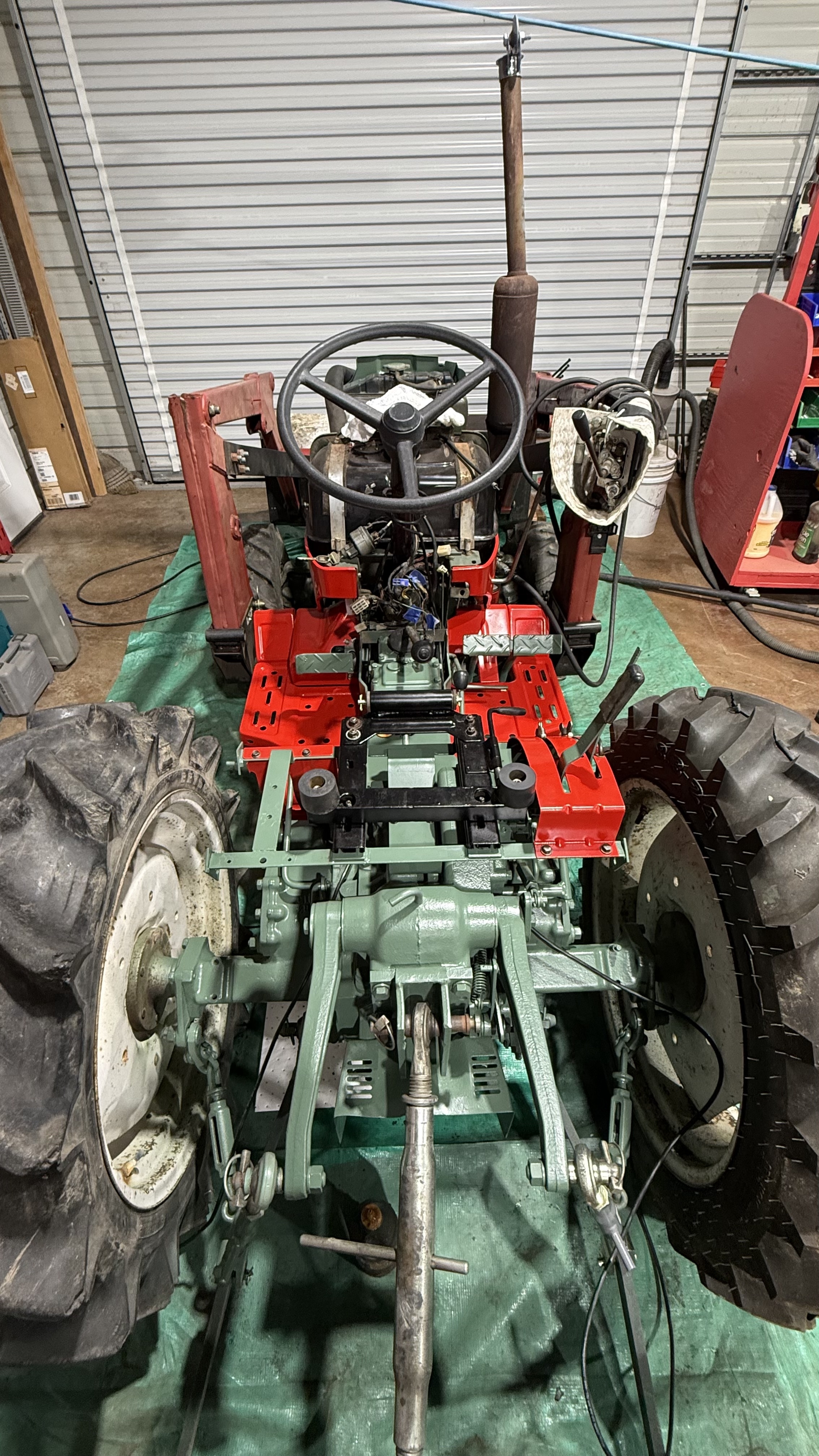

/ Yanmar red paint code #46

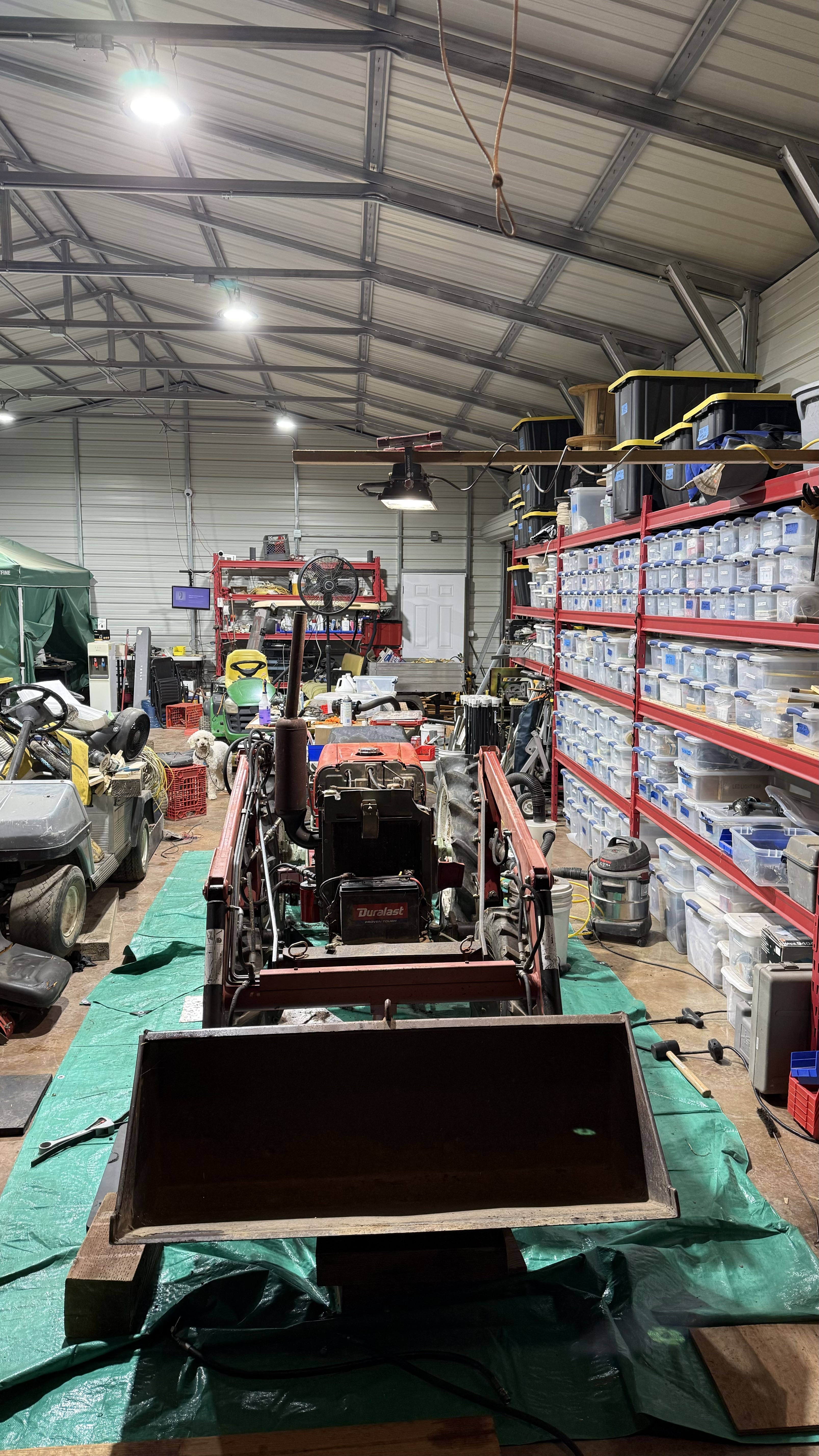

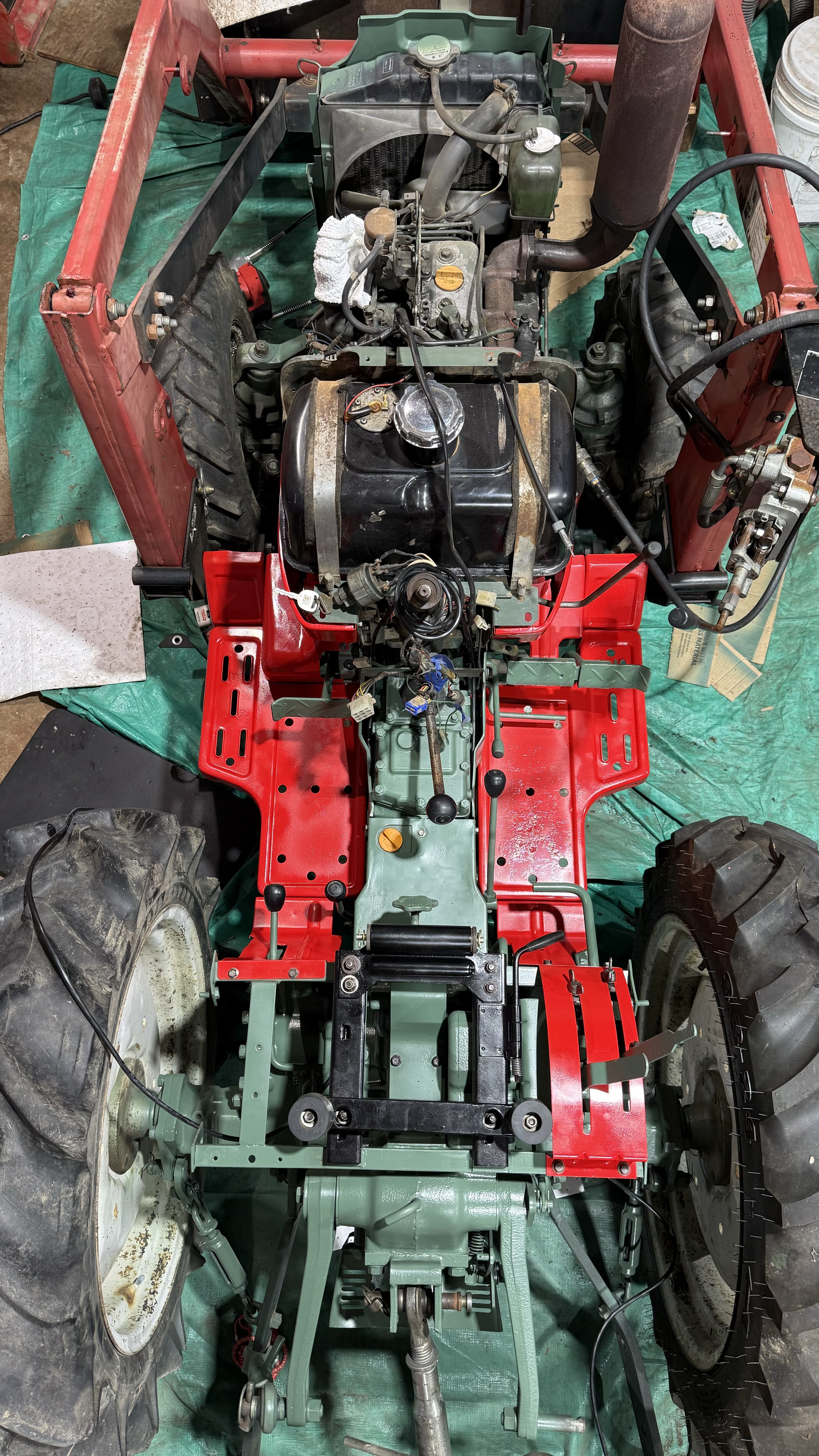

Here are some updates.
This is using the Gloss Apple Red334024 and the Spruce Green
It's looking really nice overall. The Apple Red is a tad brighter than the Fredricks red paint, yet comparing your images to the Yanmar US domestic YM machines, it aligns really well.
Is the Spruce Green also the Rustoleum too? Or another brand and reference number?

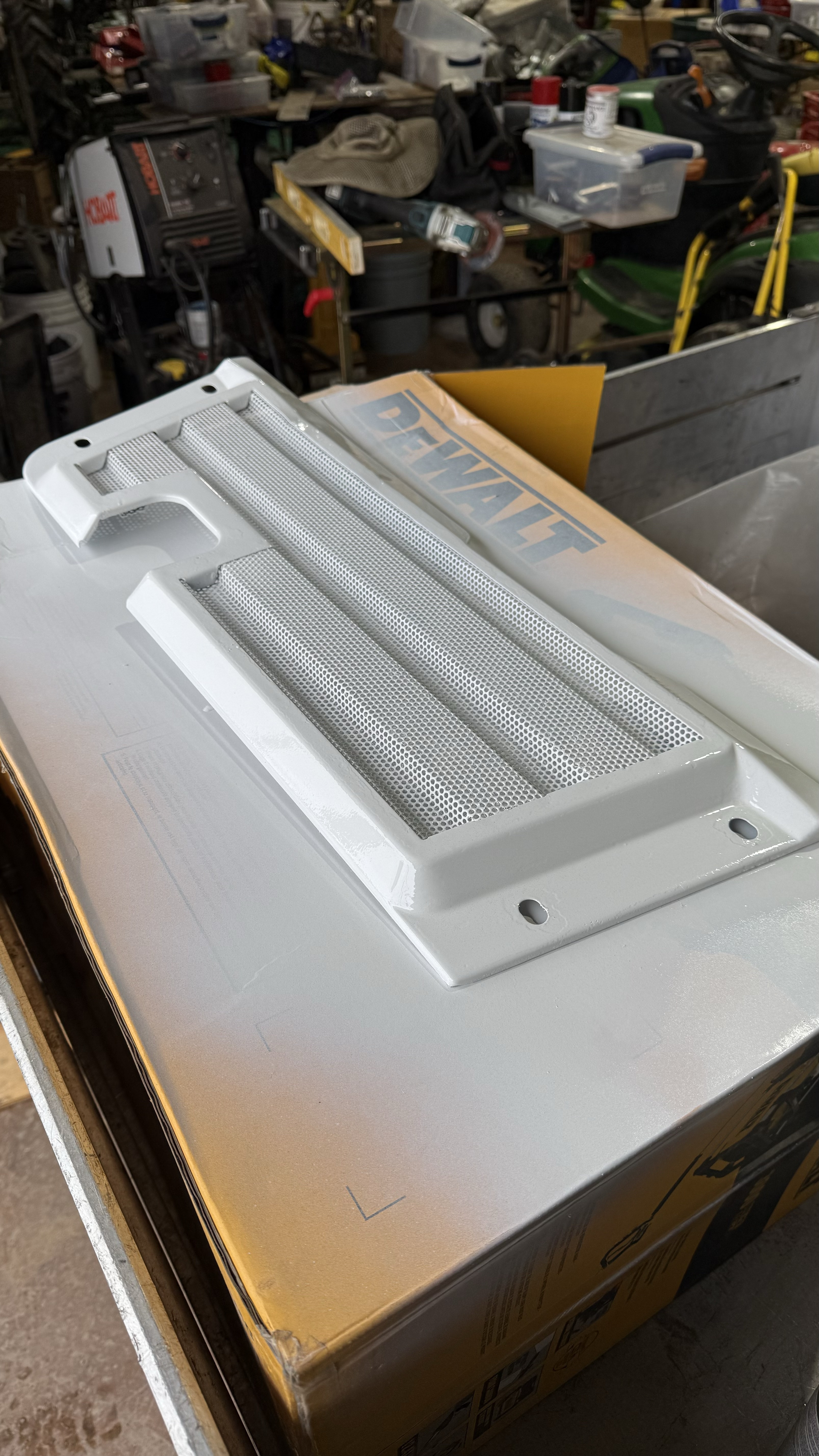

Yes, I could not find a Link for the Green. Attached are the Cans I used. For the white and black and spend a bit more on the enamel. I know the White is more white than the slight cream color, but I'm good with that.
Here is one of the side Panels and the 'Console' portion of the body

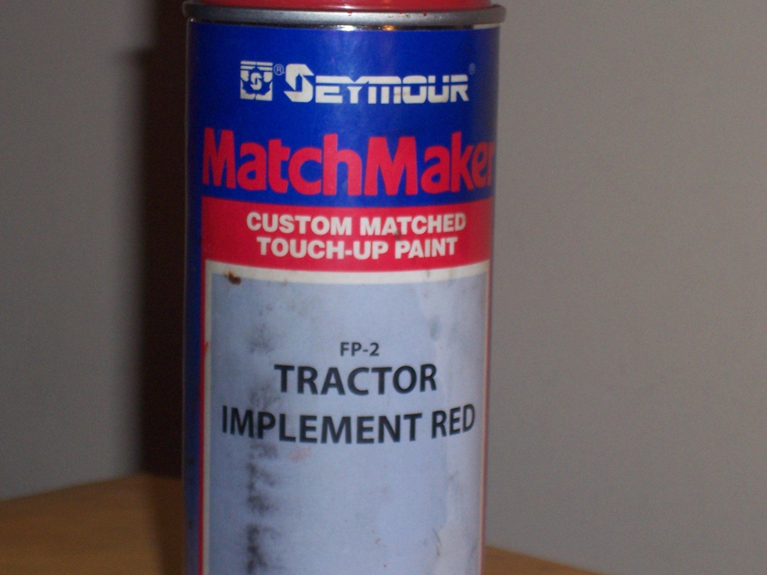

Fredricks calls the Grn. Spruce also and that looks correct for a Refurbished tractor that was from them. The Implement red can came from them. Prev. reply! They have it in Gallons or Spray Can. I'm showing Spruce Grn, Red, White, Gloss Blk and Light gray primer. My YM2000 is Org. paint. I just had to touch up a couple fender spots of Red. My Grn. is all Org.. Multi color printing pressman for decades so I've mixed and matched few colors. I would check out the availabilty from them. The cans showing of Rust oleum is a common brand for my area. Hm.Depot . T. Supply Etc.. my wheels are Org.Yanmar white also. The side covers white is Wally world in a can.
