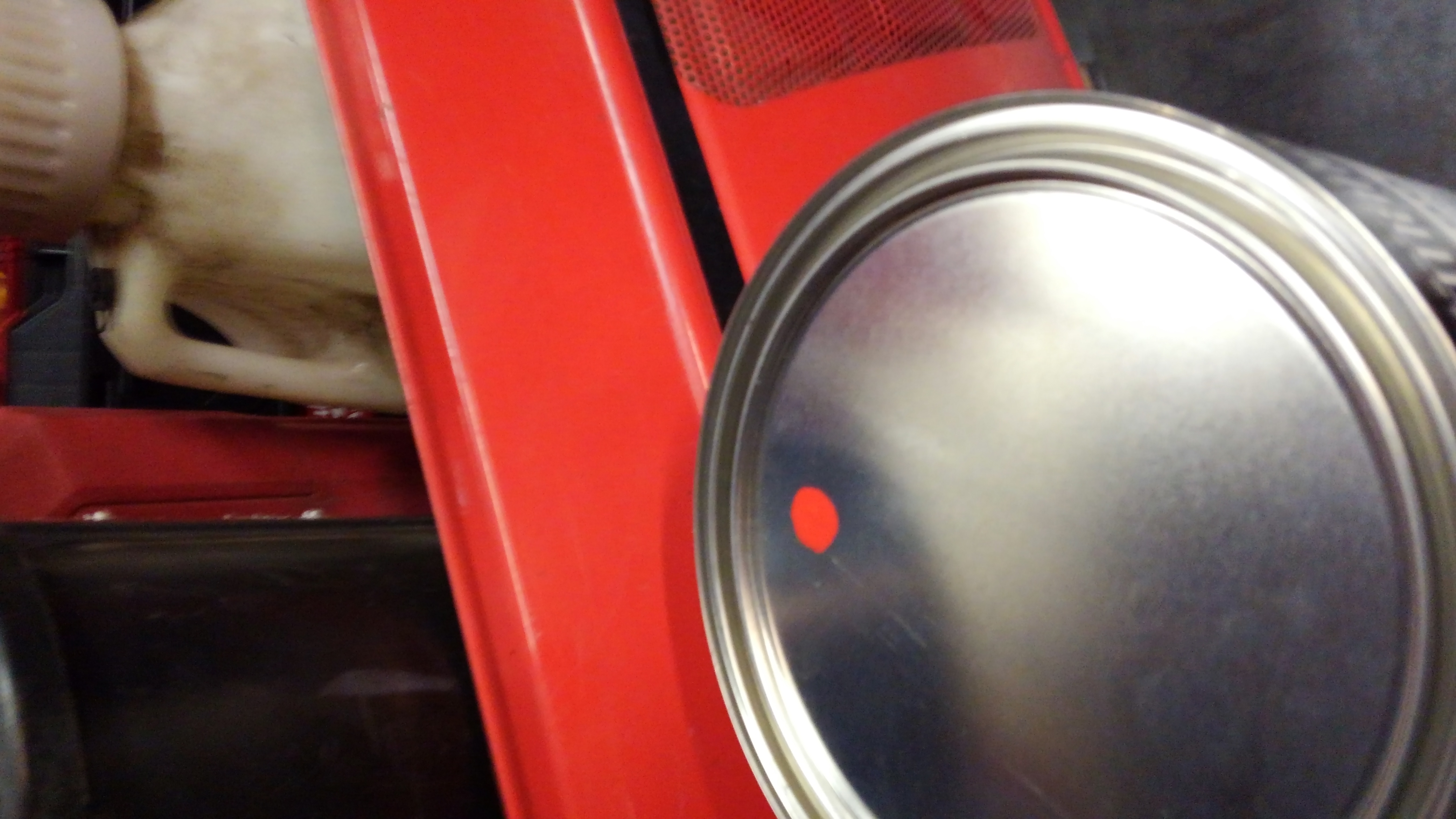

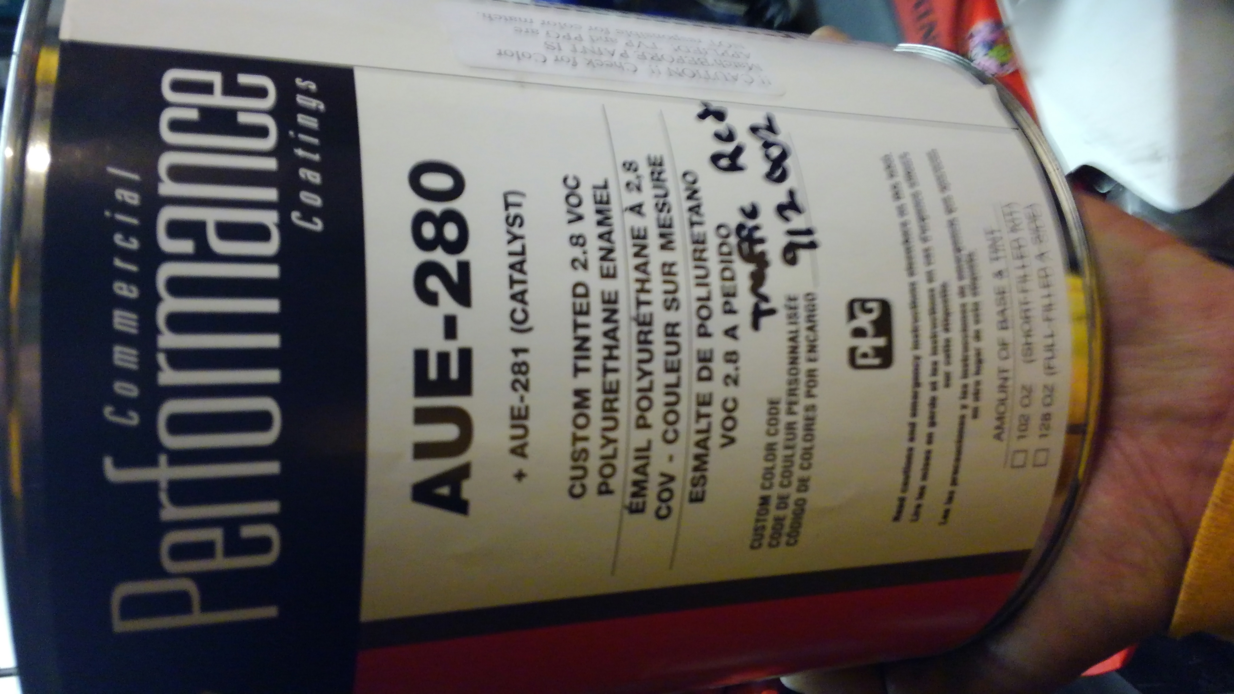

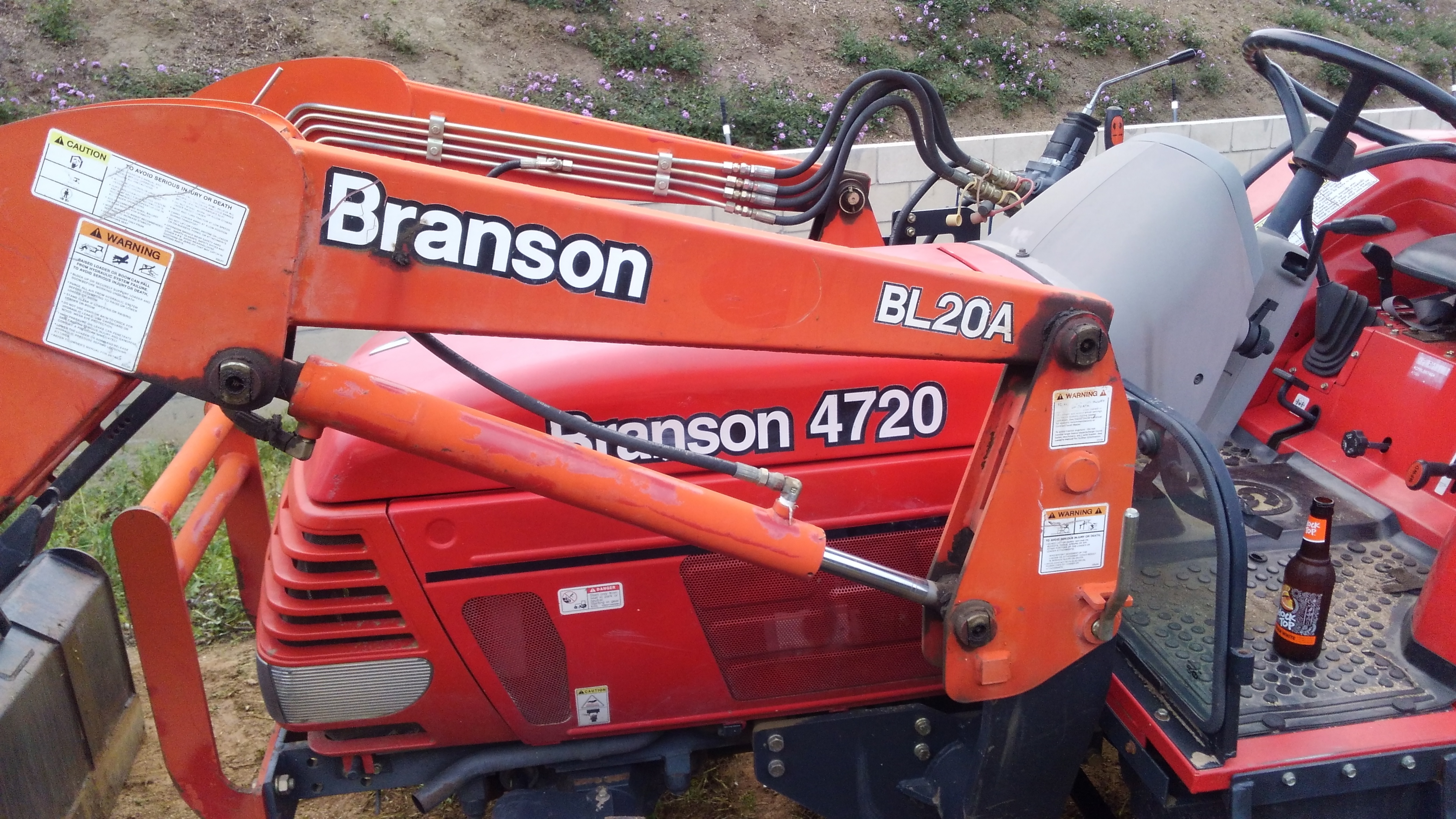

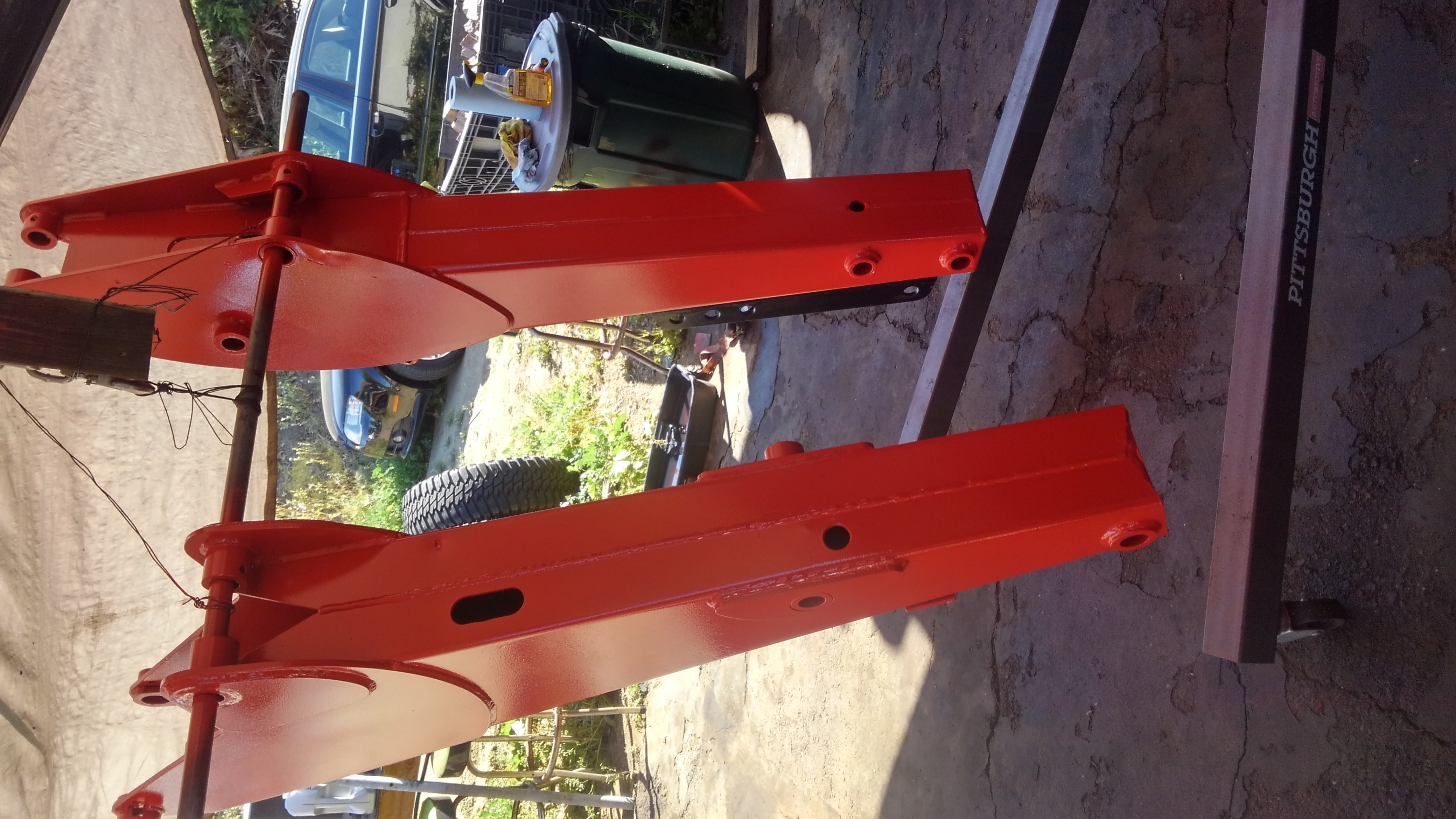

Well, the powdercoating on my 2005 4720 is flat toast and looks awful. So after failing to come up with any official paint code, I took the pan from under my seat (had it removed to replace my rockshaft piston seal) and took it in to match up. The color they came up with is "Traffic Red 912 002", or RAL 3020 (RAL Color Chart | www.RALcolor.com).
This color would be closest and looks spot on, Ill update hopefully by the end of the weekend with the results. Could have had a custom formula made according to the machine, but it was $330/gallon, where as closest match was $230/gallon.

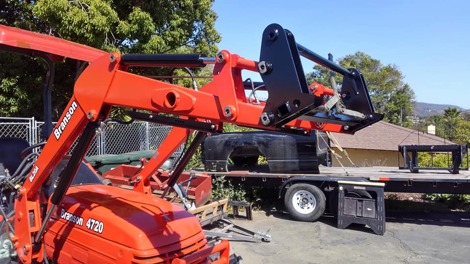

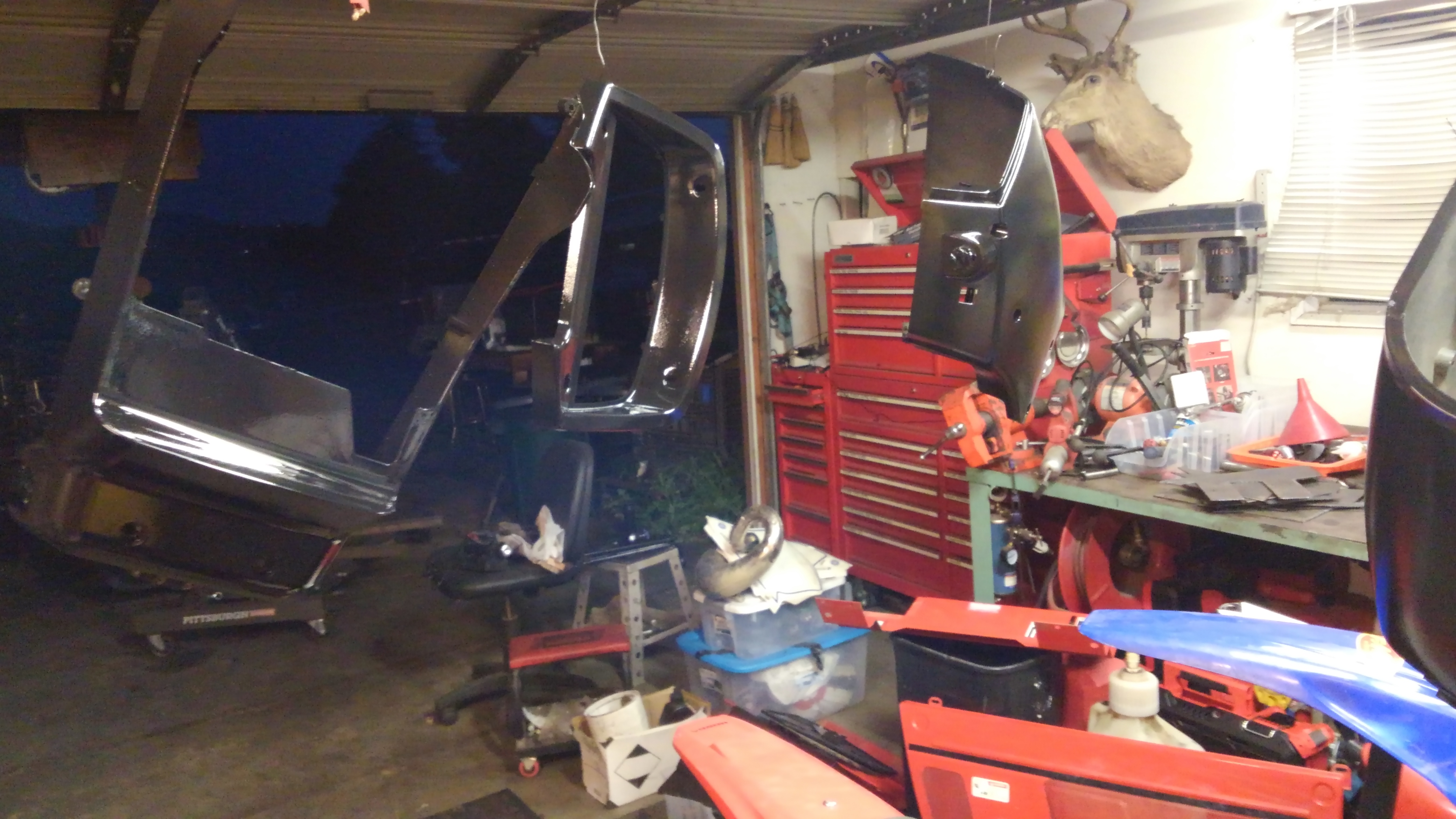

Started this evening with painting the plastics all gloss black, they were horribly faded. Used plastic adhesion promotor and some Majic paint for that. Will start prepping fenders and hood tomorrow. The loader and backhoe are gonna be a pain, not sure how I am going to hoist it quite yet. Not looking forward to it.
Ill let you guys know how it comes out! (still need to find a matching grey for a little touch up on the rear axle, rest of the tractor looks great still.)

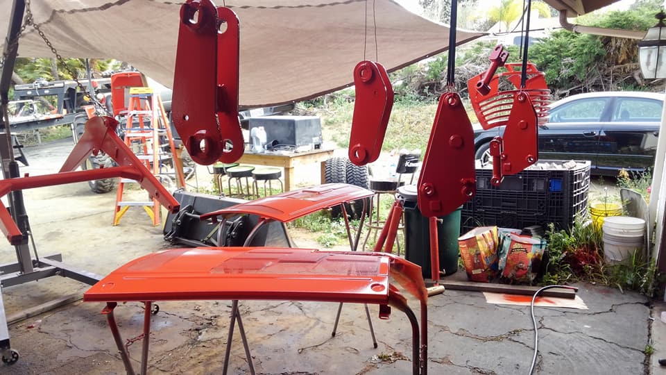

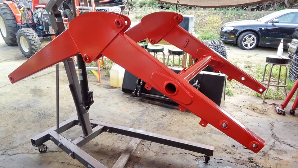

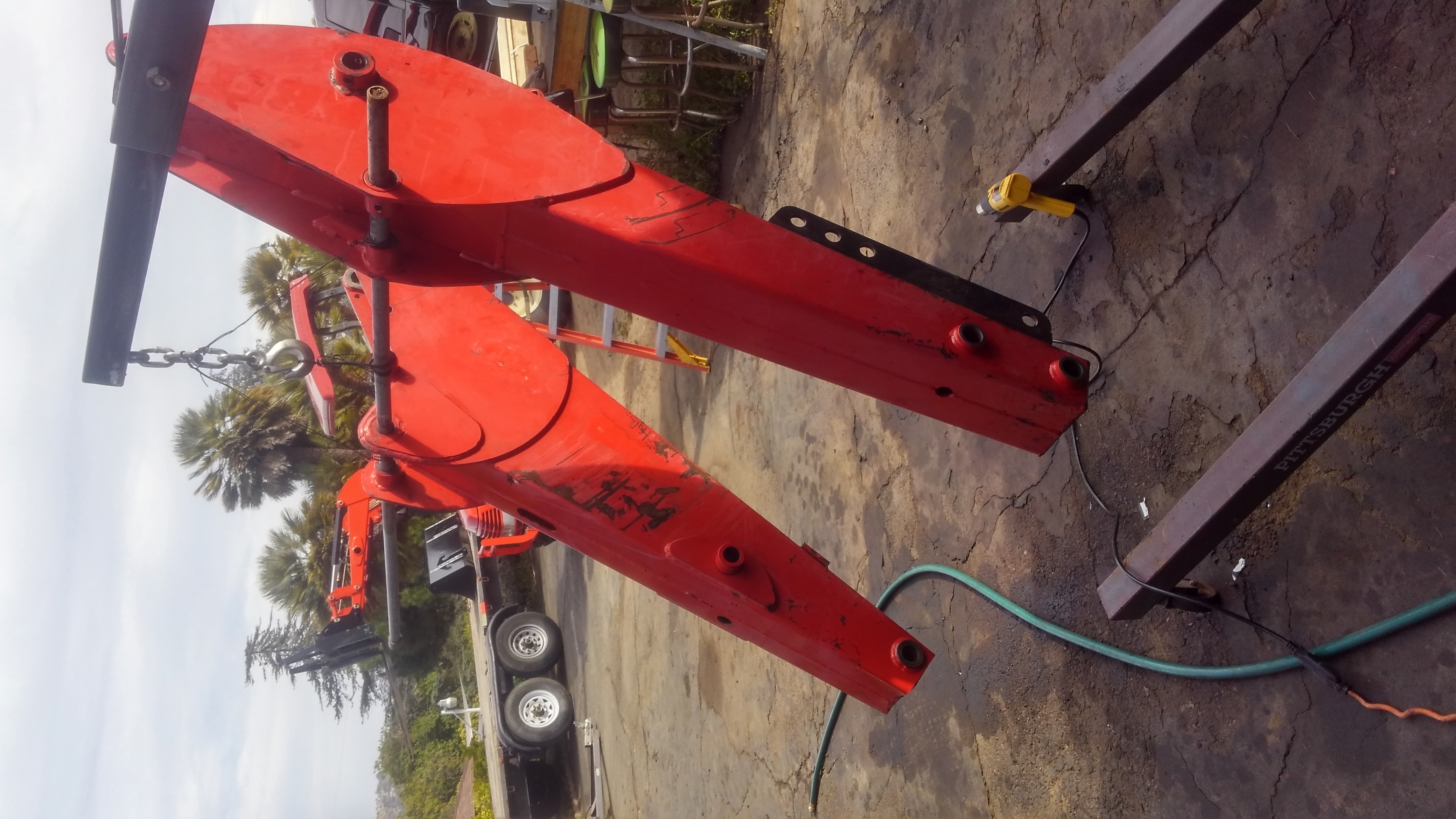

Ive got a lot of the tractor done. Prepping the rams and bucket for black paint for tomorrow. Then Ill start tearing apart the backhoe.... SO MUCH GREASE!

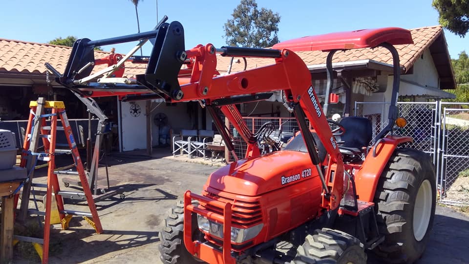

Getting closer to being done, backhoe is next on the list

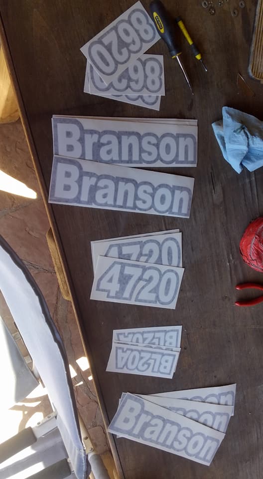

Stickers came in from a friend:

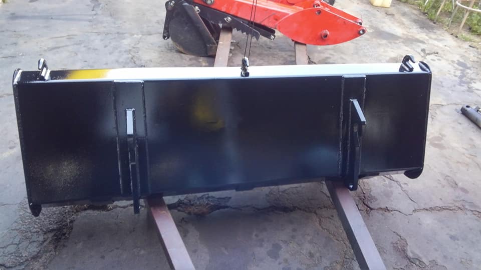

Black cylinders look SO MUCH BETTER. Nice to break up the red:

Shes looking good :drink:

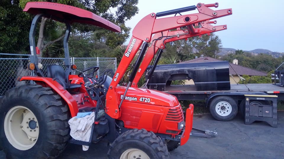

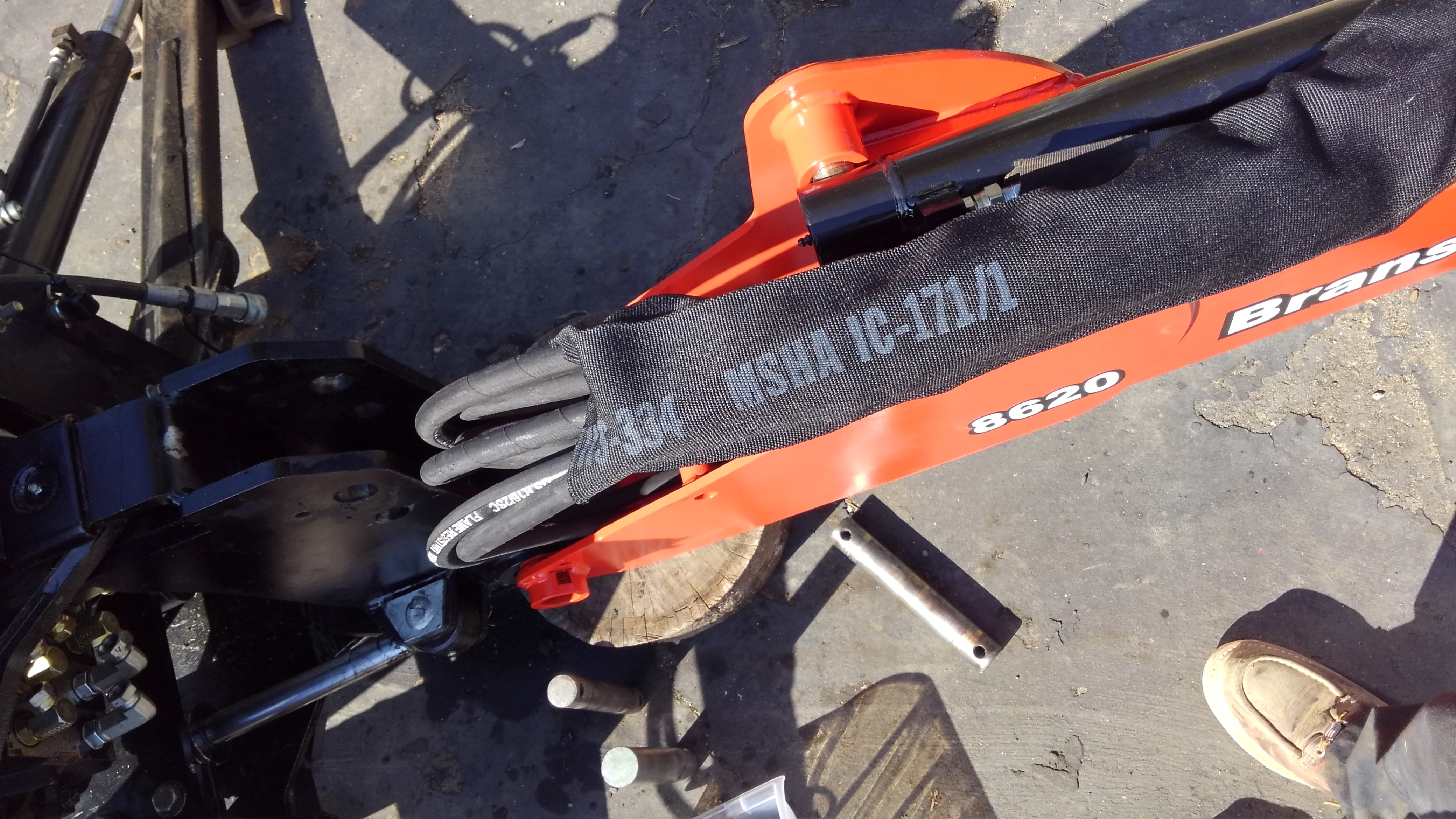

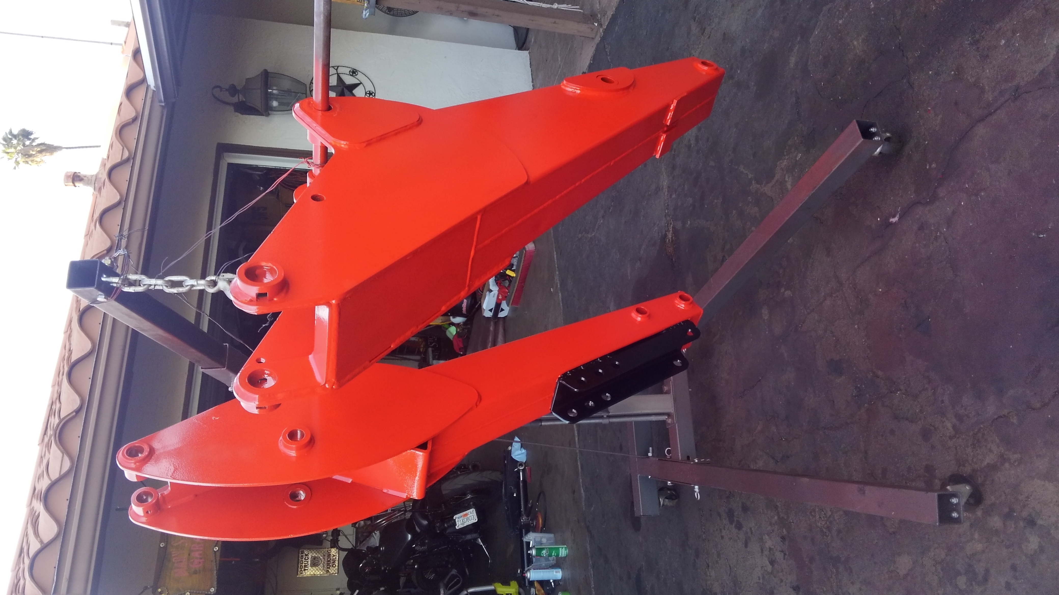

Some more progress. Tore the backhoe down so I will begin that today. She is getting there.
/ Painting my 4720 (have paint code) #9
Looks new again! :thumbsup:

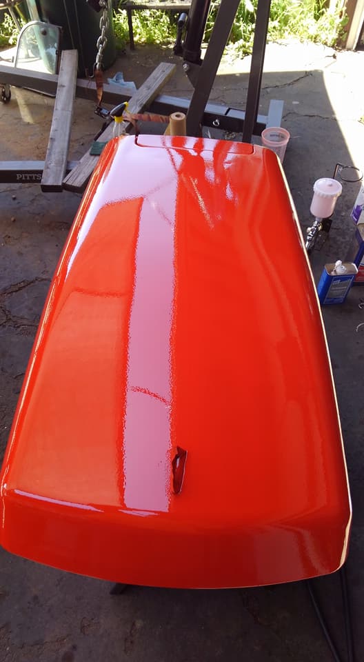

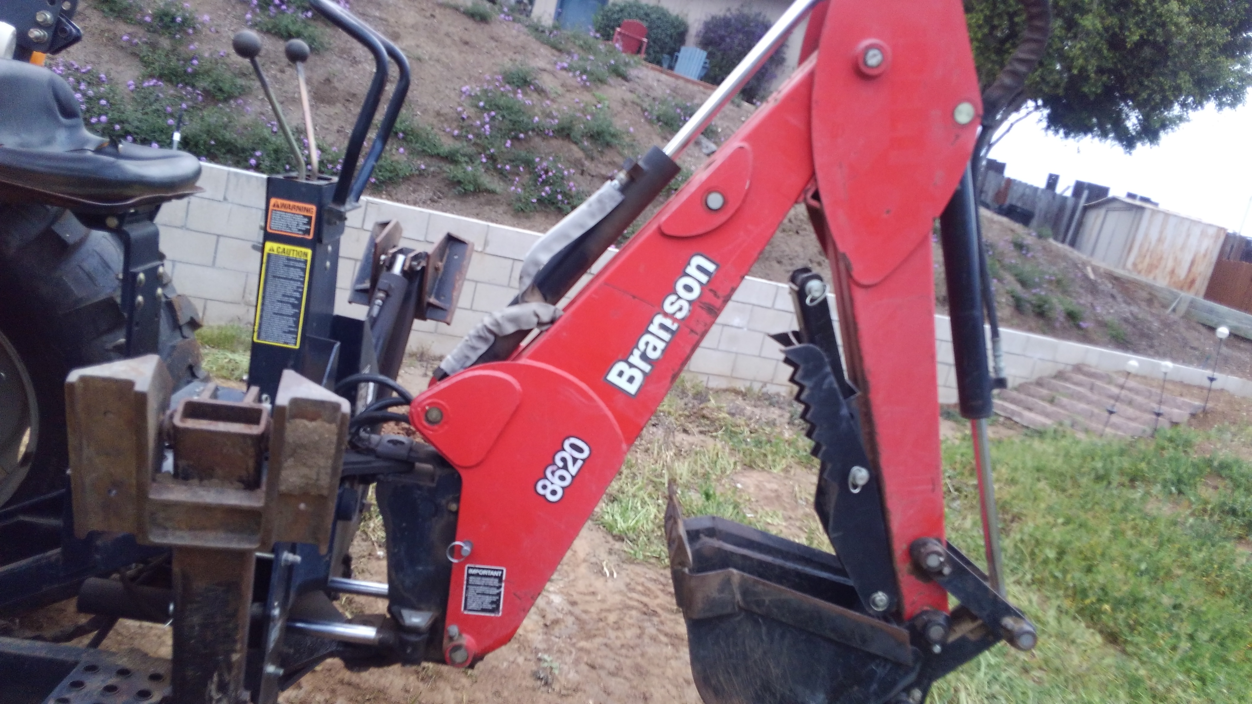

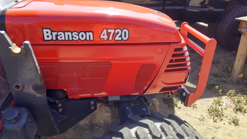

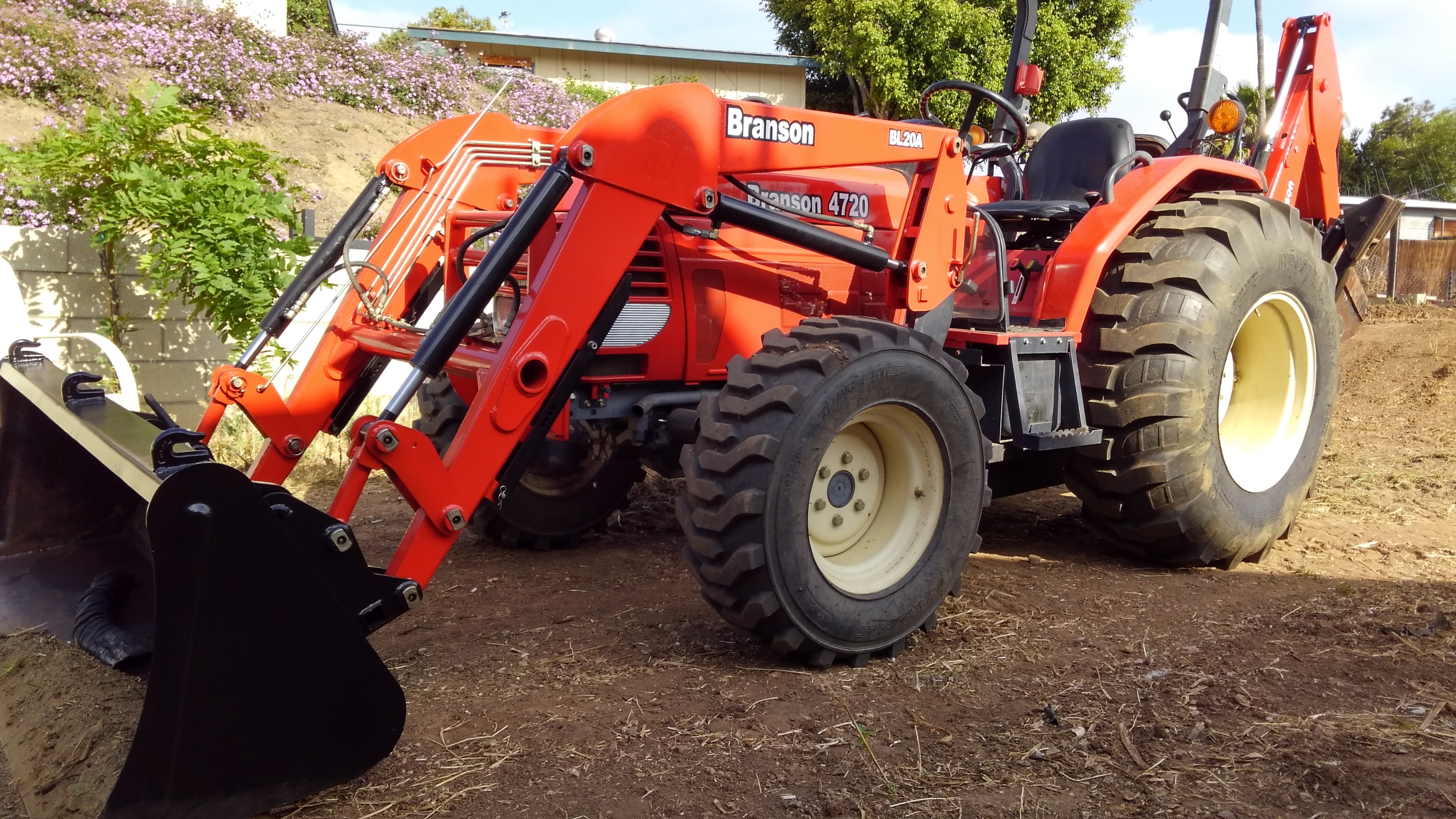

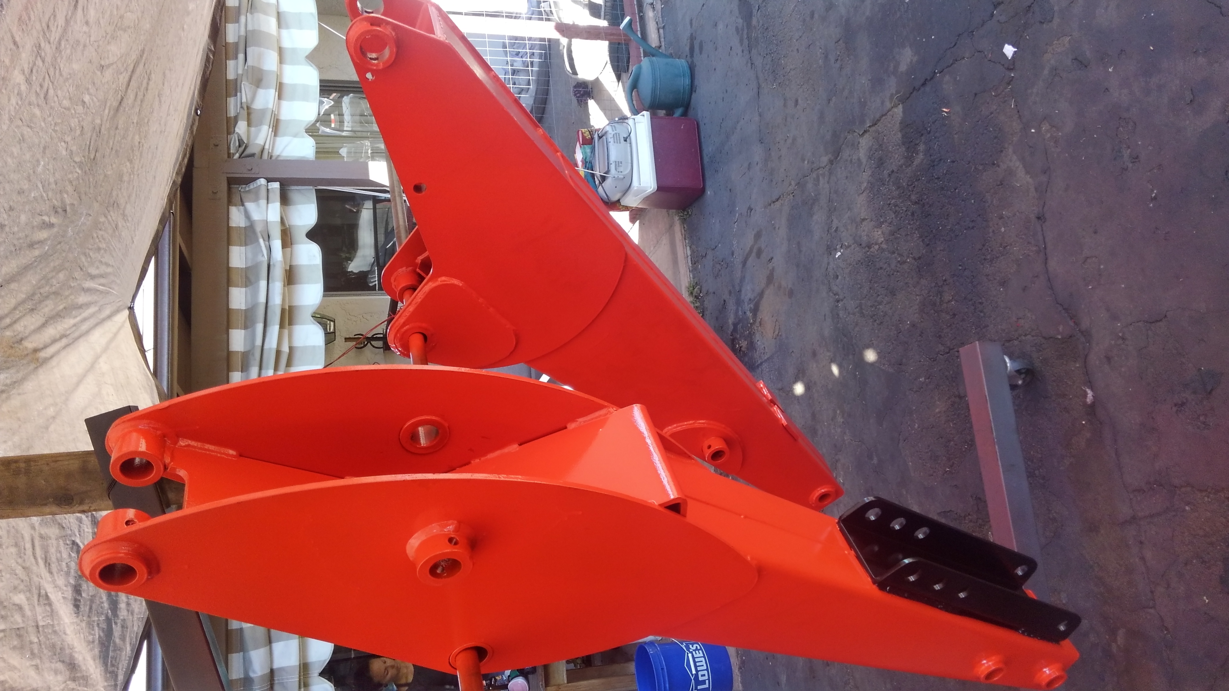

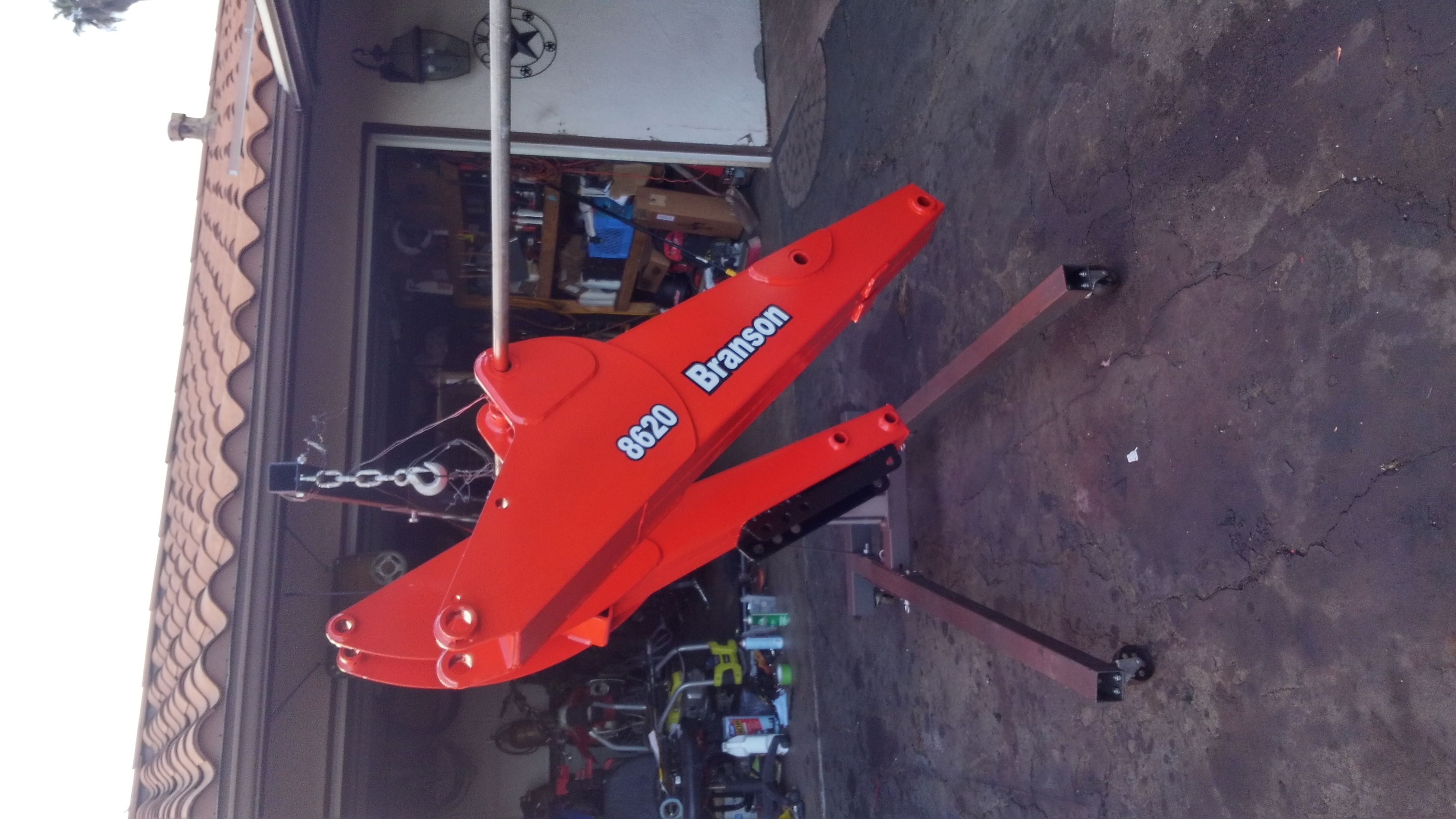

Sorry fellas, I was in a hurry to head out of town when I finished this all up and I didn't even post pictures of the backhoe and finished product.
So here it is all done:

Fabulous job!
What did you use to all clean the grease off with?
Used a lot of foamy degreaser in conjunction with my pressure washer using hot water. Then rags and brake cleaner. Then after it got sanded down and wiped off right before paint, I had some final cleaner/degreaser the paint shop gave me to do the final wipe with. Then 3-4 coats of paint. Should hold up I am guessing.
