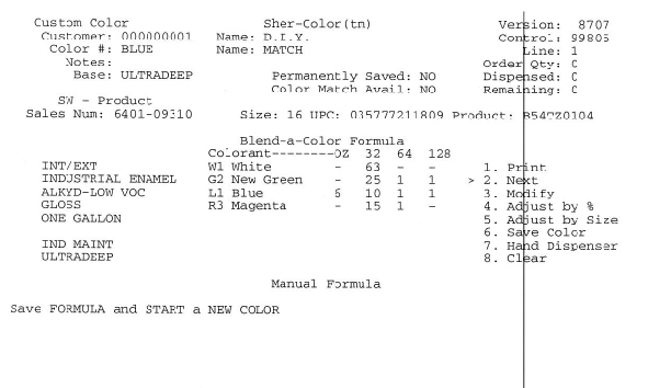

Got a can of LS blue from my dealer and took it to sherwin williams and they made me a gallon of industrial enamel.
Very good match on tractor , after it dried I could not tell where I touched up. Very tough paint, almost as good as
2 part epoxy. Can be sprayed, rolled or brushed. The gallon is pretty expensive but should last a long time.
I have attached the paint code if anyone is interested.
