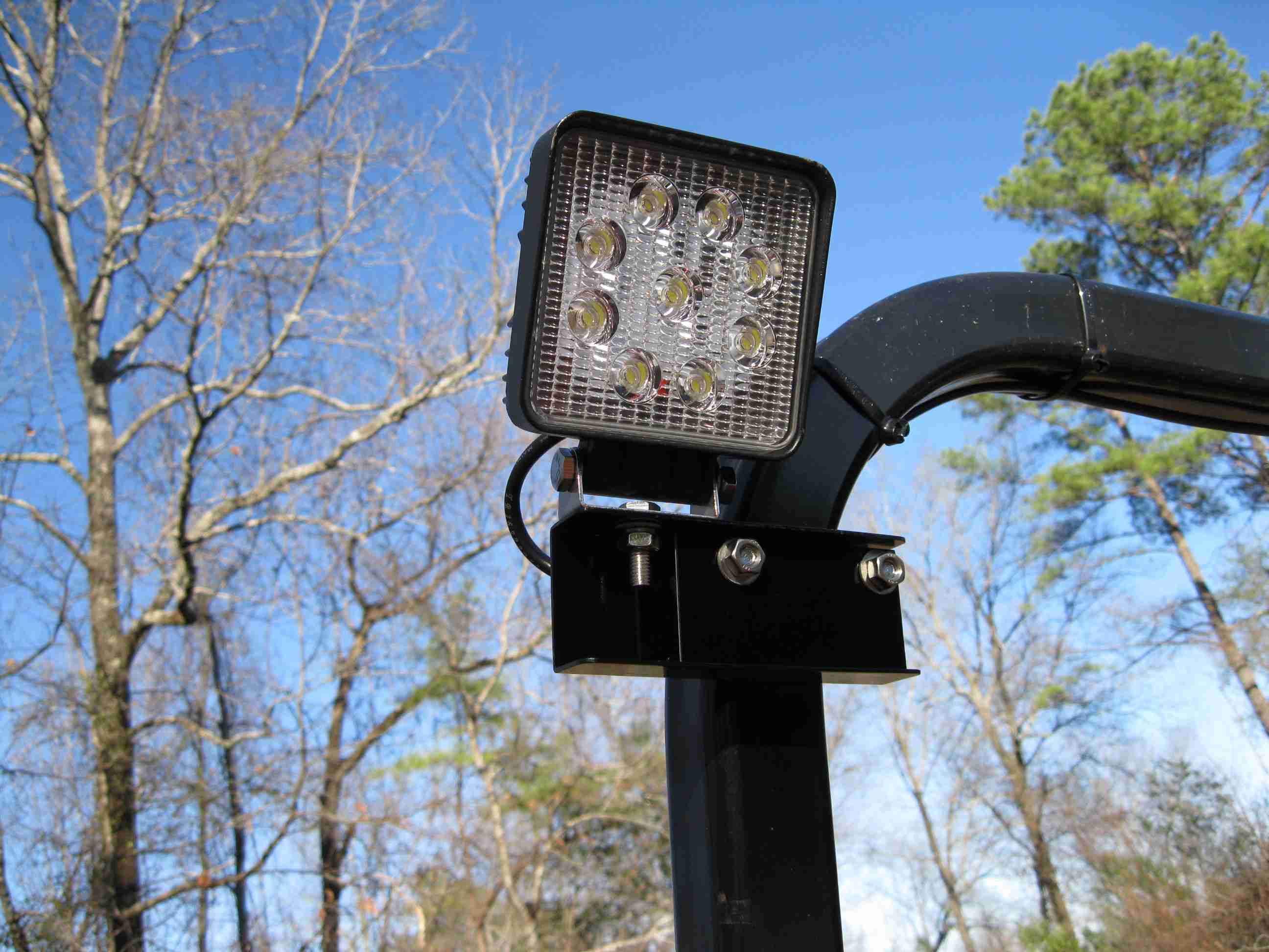

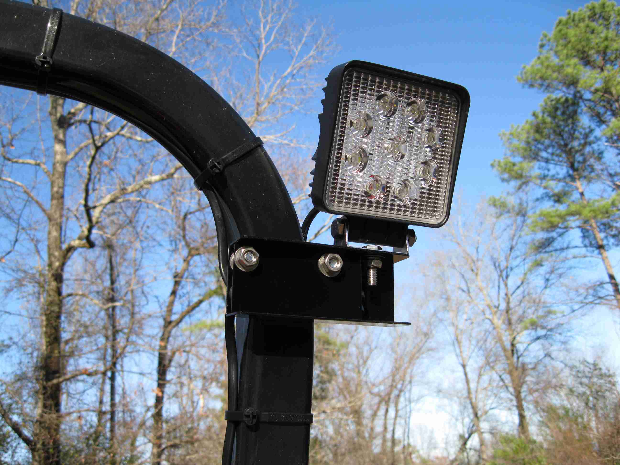

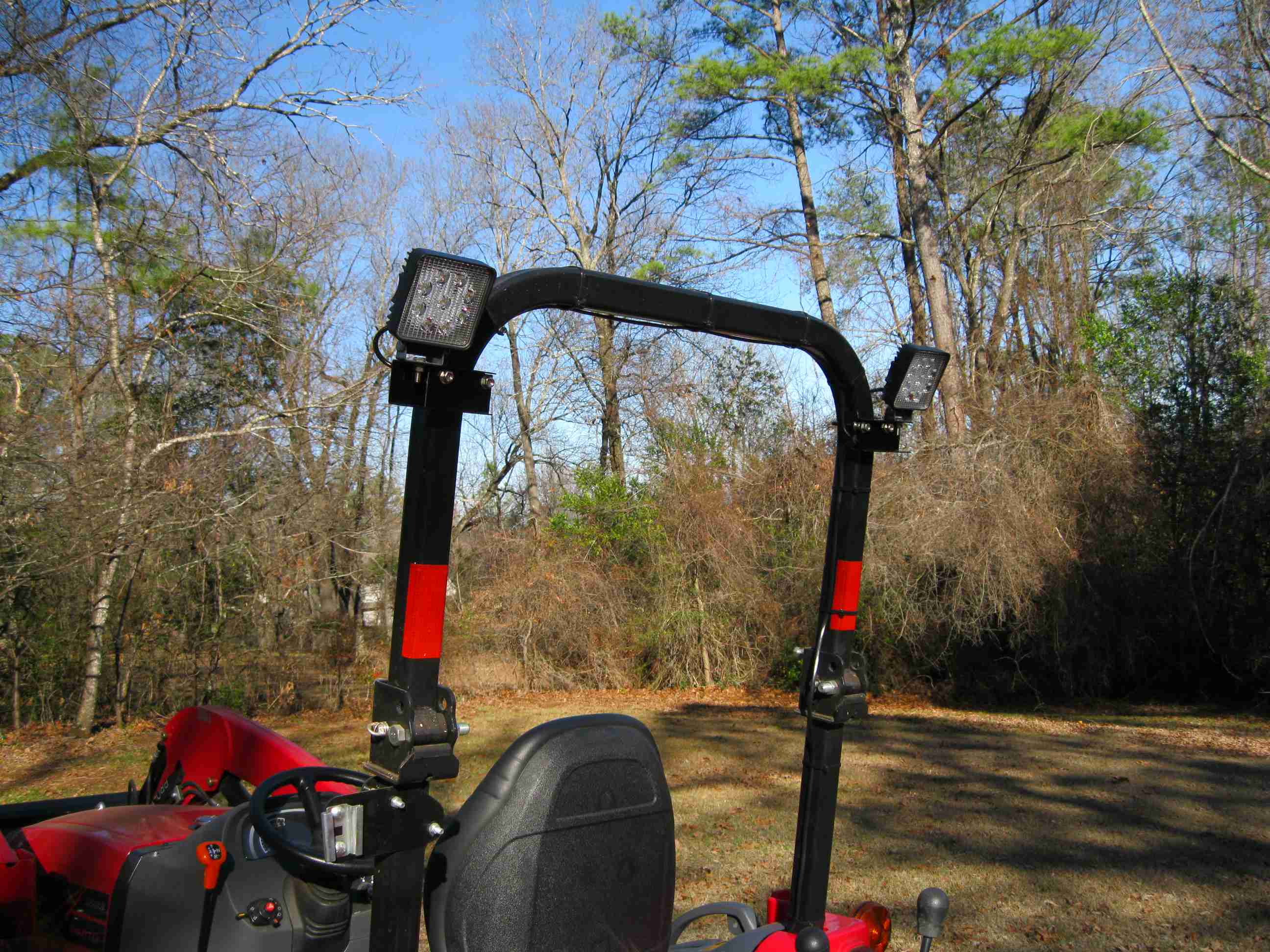

My 1533 is almost a year old and I have been wanting to add some work lights to it. I decided to mount them on the roll bar (ROPS) but didn't want to drill it or weld to it for fear of being accused of weakening it. The certification tag on it makes me want to just leave it alone.
I found some 4 inch square, 27 watt LED lights that appeared to be just right. They mount with a single 10mm diameter bolt.

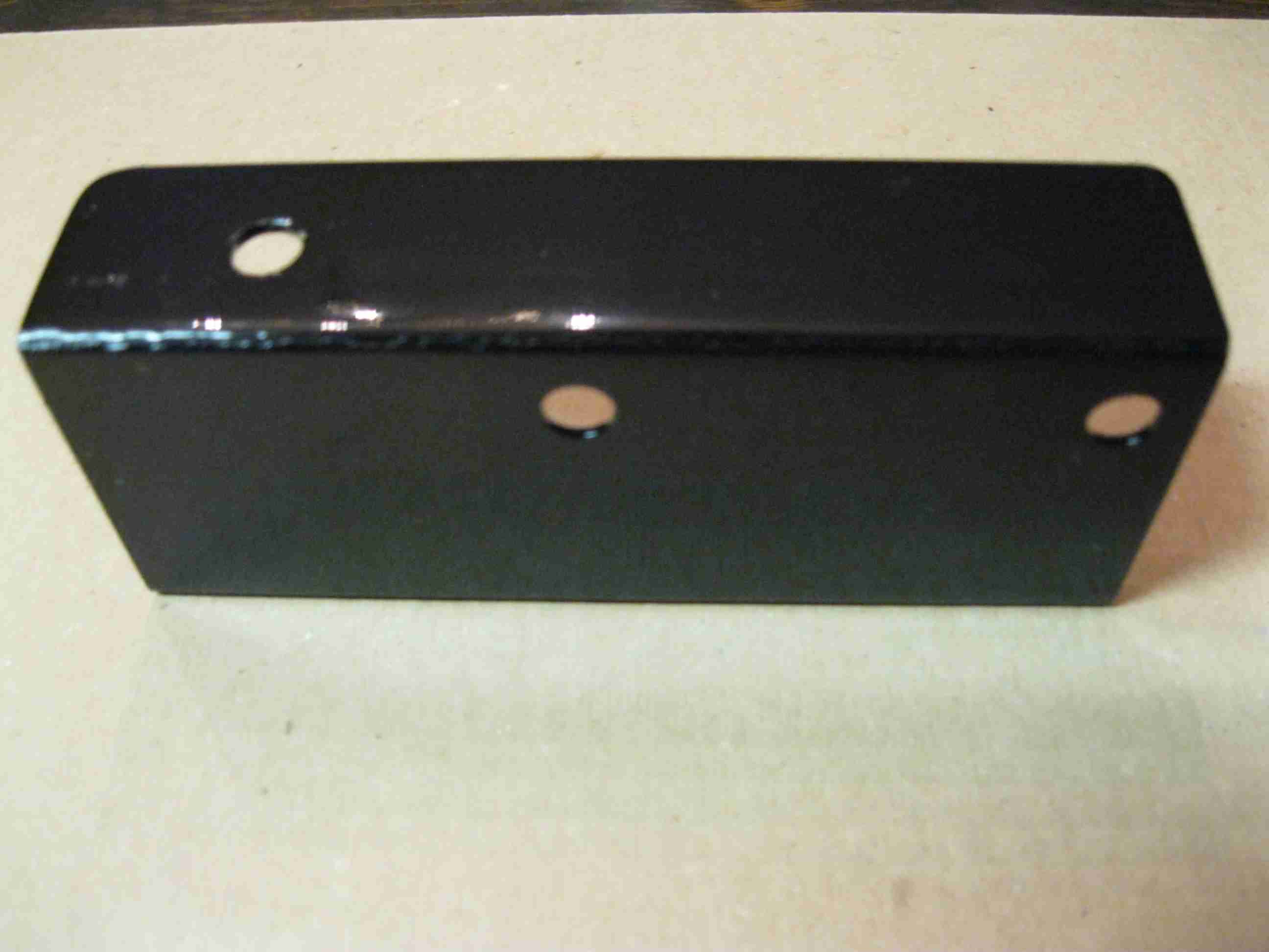

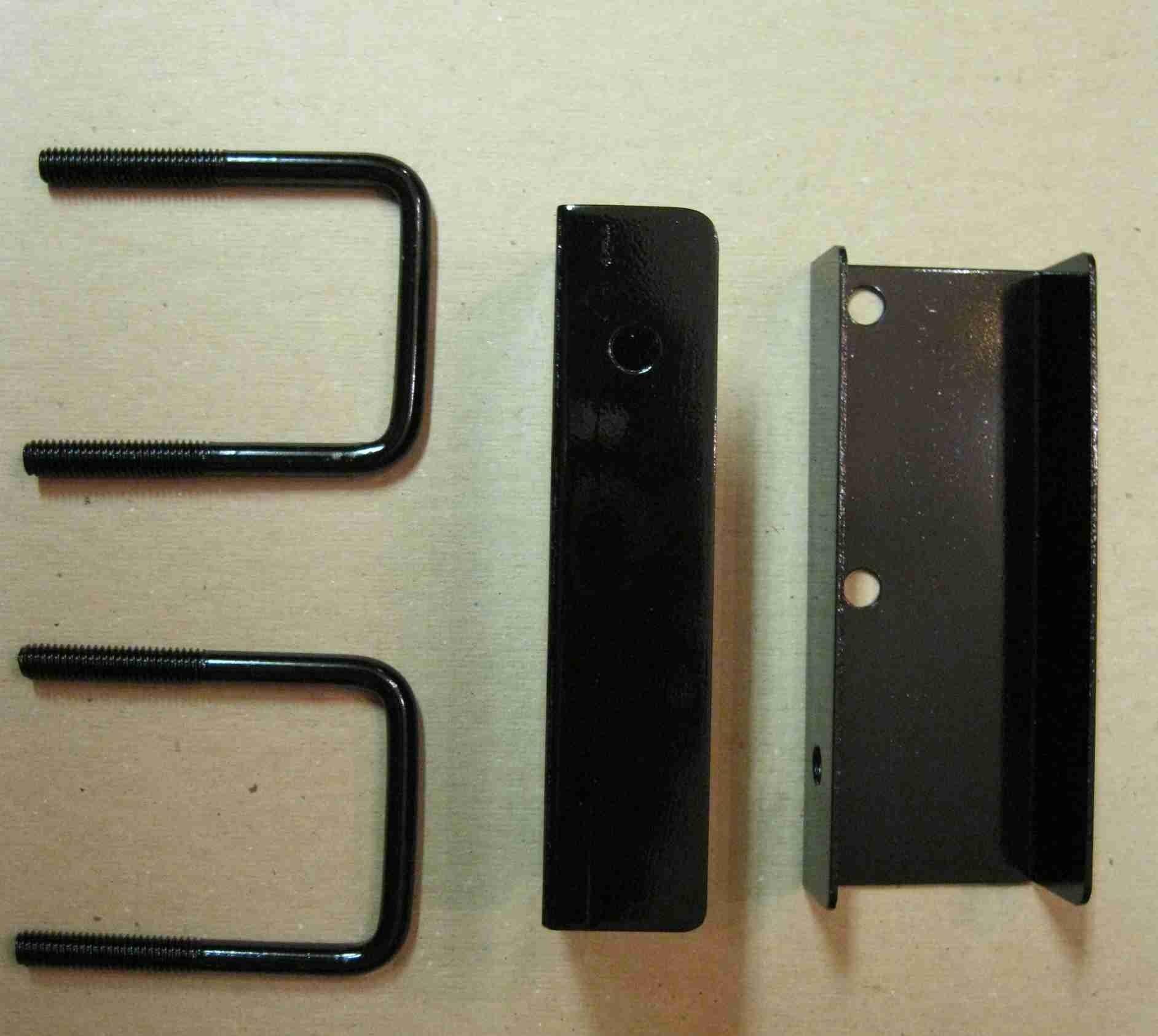

I had some 0.060" aluminum sheet and decided to make the brackets from that material by forming a 2" by 1-1/8" channel. I used two "square" u-bolts to attach the channel pieces to the ROPS. By mounting the lights on the outside of the ROPS, they are not only out of the way when operating the backhoe, they can be swiveled to face forward or backward by loosening the mounting bolt on the lights.
After trying unsuccessfully to get a wiring diagram from the dealer so I could locate a convenient power source, I decided to run power from the battery. I had some 12 gauge, 2 conductor cable which worked well. Mahindra seems to color code the split-loom conduits in the wiring harness and it was easy enough to follow the yellow-marked conduit through the engine compartment. In a few places, I was able to slip my cable through the same cable ties that hold the conduit in place. Otherwise, I used cable ties to secure the new cable. However, once I got beyond the firewall, things got interesting. I managed to get the cable in place but it was a bit tedious because quite a few ties were needed to keep the new cable out of harm's way.
The positive (red) conductor in the cable connects to the battery through a 15 amp ATO fuse in an inline fuse holder.

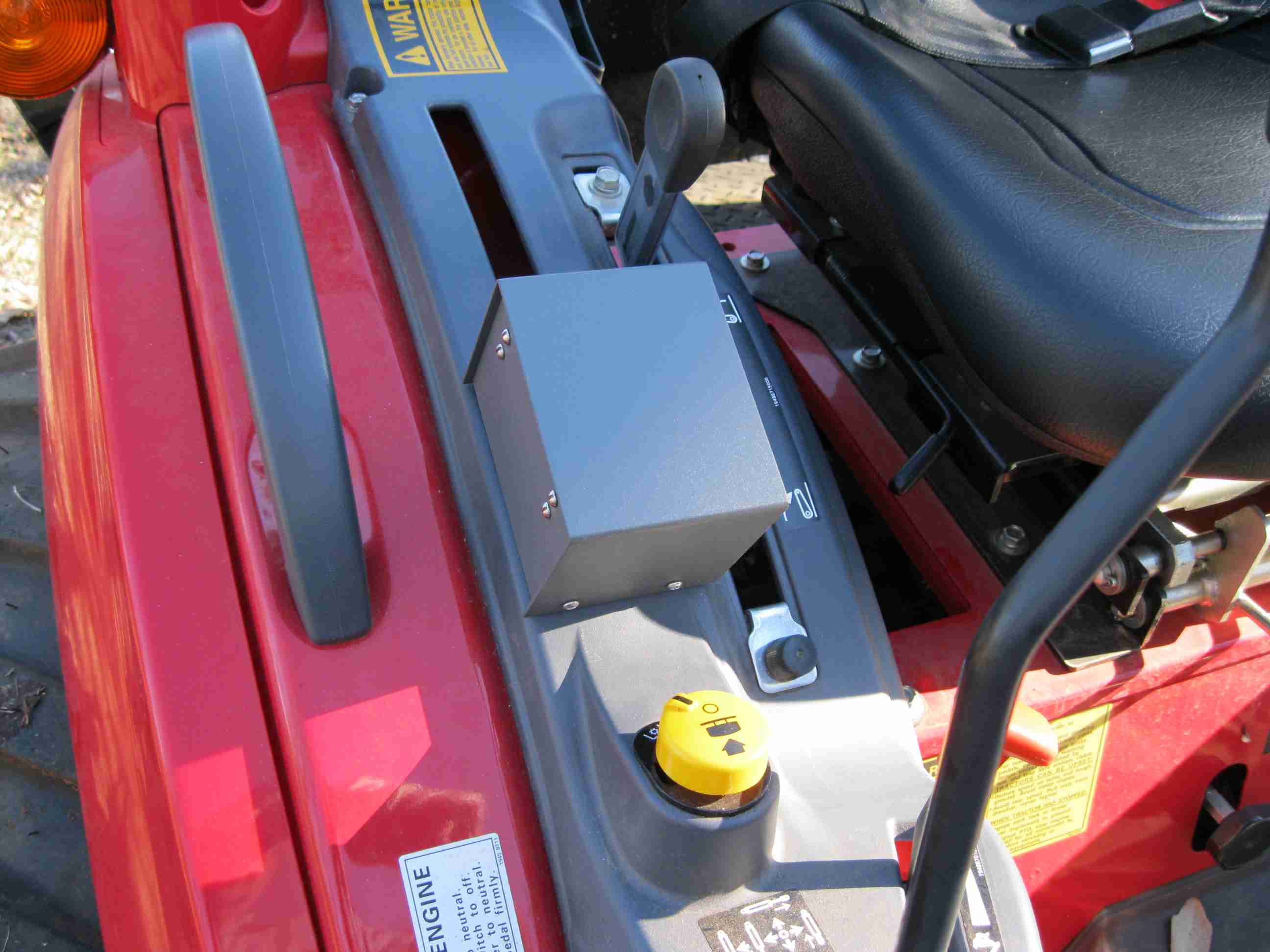

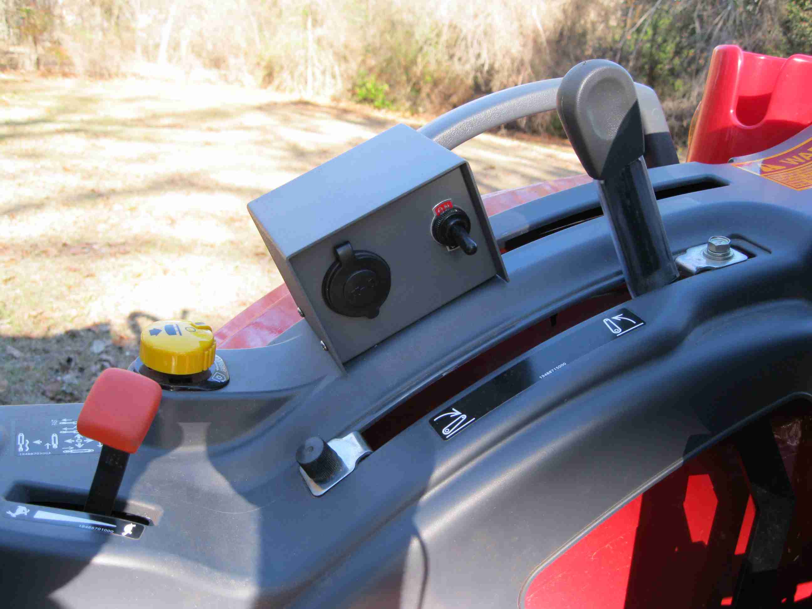

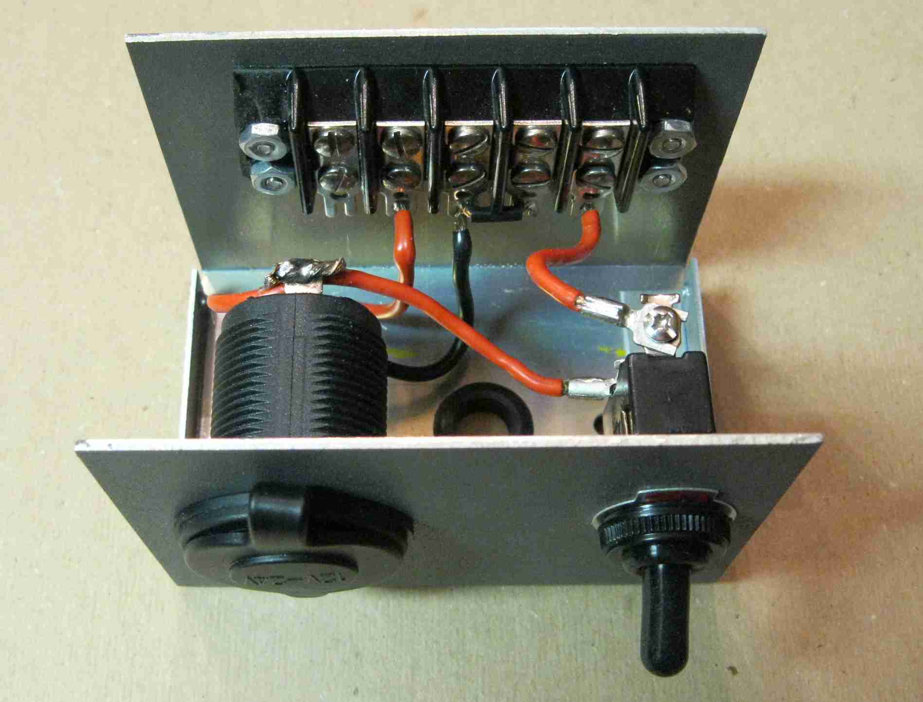

OK, the wire is in place and the brackets are made. Now, what about a switch? I decided to add a small metal box to the front portion of the right fender. My tractor doesn't have a control lever in the outer slot of the right fender. So, I decided to utilize that empty slot by clamping the box to the fender using a couple of machine screws, some nuts and 2 small pieces of aluminum on the underside of the slot. That way, the box can easily be removed for repair or if it is no longer needed. I made the metal box from the same 0.060 aluminum. It houses the switch and, as a bonus, a cigarette lighter socket. It is 2-3/4" wide, 4 inches long and 3 inches high. I chose the width to match the most prominent portion of the gray plastic that runs on either side of the slot. Mounting the switch and socket in the removable box means no holes to drill. Tractor can easily be returned to "stock" condition in the future.
After running the two conductor cable and seeing how much trouble it was, I came to the conclusion that the second wire shouldn't be wasted on a mere ground. After all, it could be used to power a horn or front-mounted lights or who knows what later on. Finding a ground near the right fender looked easy - There were two empty "threaded" holes (actually, nuts welded to the underside) in the large steel plate that the seat mounts on. However, Mahindra had very carefully isolated that large plate from the chassis and those seemingly useful holes were useless. The bolts used to mount the plate were connected to the chassis and provided a good spot to attach a ground wire. Well, after I replaced one of the original 30mm long bolts with a 40mm bolt and added a nut to the extra threads on the longer bolt.

The photos show the individual parts along with the internal wiring of the switch/socket box. Instead of making your own brackets and box from scratch, you could use 2" aluminum channel and an aluminum Mini-box of a suitable size. Something smaller than 2" channel should work just fine provided it is made from thicker material - Say, 1/8" or more. You could even make the box from a couple of pieces of channel. I tried to make the brackets just strong enough to hold the lights yet weak enough to 'give' in case they came in contact with anything so that certified ROPS wouldn't be damaged.
