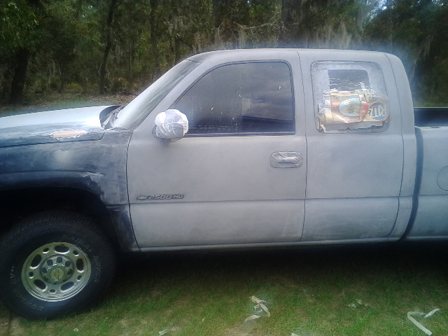

Couple shots I took about mid way through priming. I ended up taking decals off rather then taping them off.
BTW the ugly bondo at rear fender area will be covered with a piece plastic trim.
