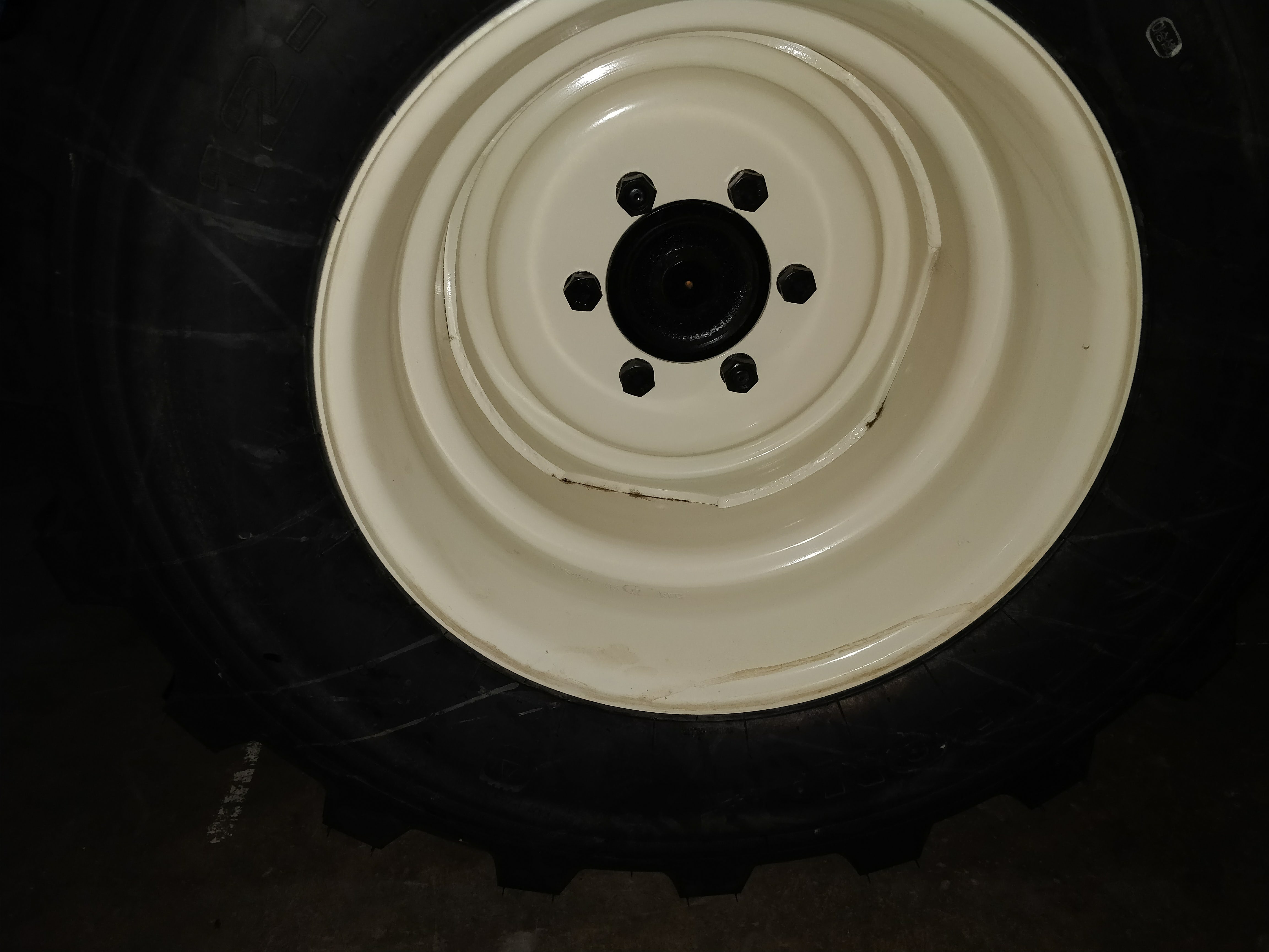

yeah that's a ethanol/methanol product. Just easier to get your hands on. Its what I used
My ground is fairly soft, when not frozen. The backhoe provides great ballast and if taken off, the 6' box blade will be on it. Would you still recommend tire ballast?
I think it depends on your uses of your tractor. My backhoe also provided that ballast but when I was out using the back blade with my bucket off, loader frame still on and my homemade plow on the front of my 75lbs forklift frame. Once the back blade hit the ground I had no extra weight for traction. wasn't like the back-blade gave that much more traction anyways.

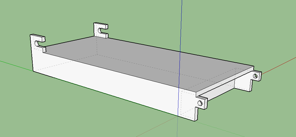

If you are already wanting to build a ballast box/tool carrier, I think the size you are thinking would be good. The backhoe sits out further then a ballast box would so the tractor holds the weight different.
This summer I'm going to be using a box blade to level out quite a bit of my "inside" yard and once the box blade is on the ground... there wont be the extra weight on the tractor. And after using the tractor with the loaded tires now for a couple weeks, I can definitely feel the difference with just the 400lbs in the wheels. But I think I might need a bit more when dragging/scrapping the dirt with the box blade, wheel weights would be a nice addition but I haven't seen them for our size tractors... so I might build a weight that connect to the BH connections. I wont know if it will be needed until I start moving the dirt this spring. The issue would be hooking it up and taking it off, would need some sort of jack built in.
This is just a mock-up, I didn't measure anything.

Would it be possible to make a small plate with a vertical piece of round bar stock to go into the draw bar mount? That could hold some stacked plate weights. Seems like that would be close in enough there would still be clearance for a box blade. Could be a way to have easily added/removed weight low on rear axle?
Can't really draw well, but something like this:
