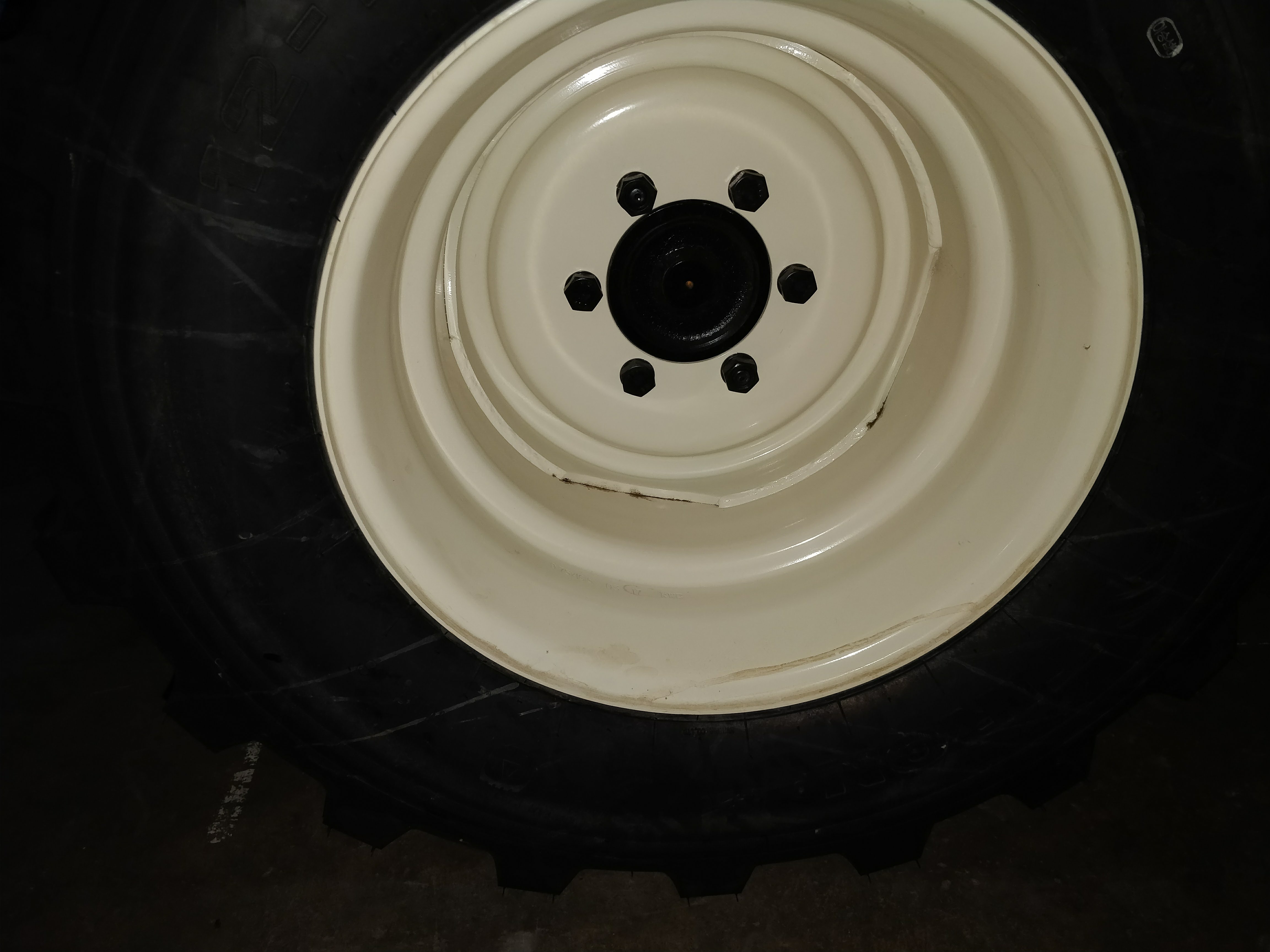

This is really good info Jeff but In this case, the wheels on our little XJ tractors have welded centers and they seem like they are right in the middle of the rim. I don't think you can turn these around, or can you? I didn't find anything in the manual on it

Maybe referring to wheels like ours that have a fixed center as being welded, rather than those that have an adjustable center?
sorry that post is lacking the details again... the center is welded off center to the back of the rim rather then centered in the rim as i thought it was in me previous post about changing the tires around... They are most certainly welded!
Does that make any since?
