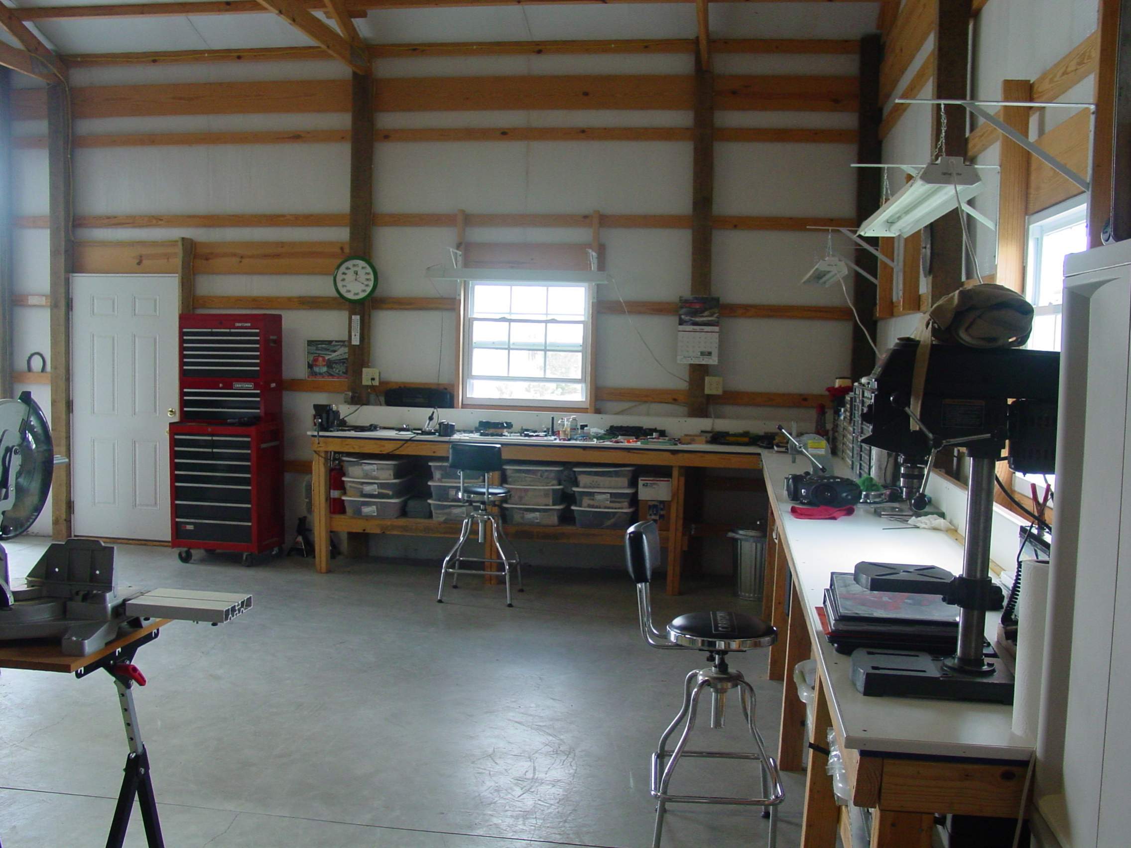

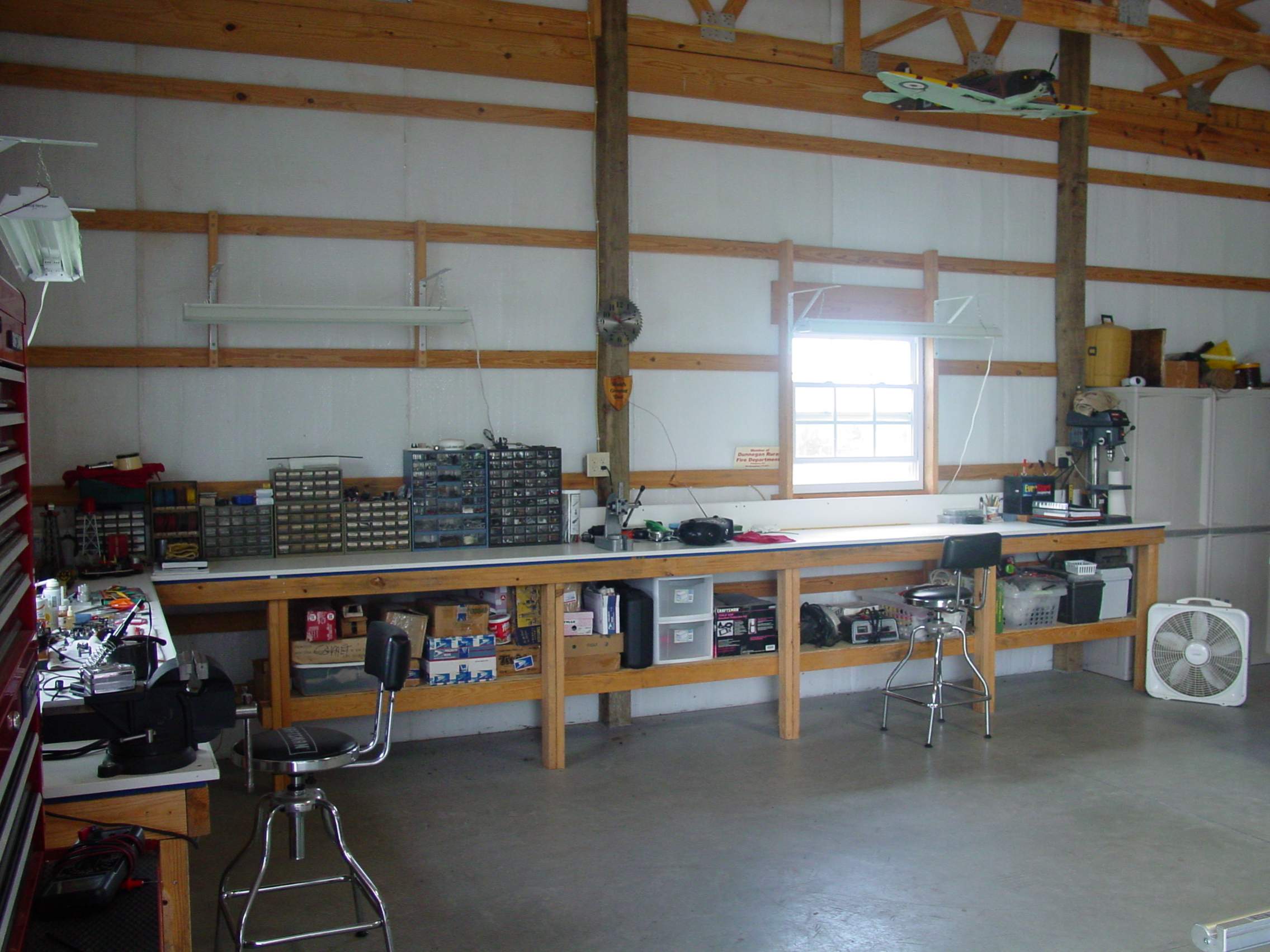

This is the workbench I built for my shop. It is 38" high, 24" deep and is L shaped. The longest side is 18' and the other is 12' for a total bench space of 30'. I used 3/4" sheets of formica for the surfaces which allows for easy cleaning of spills etc.

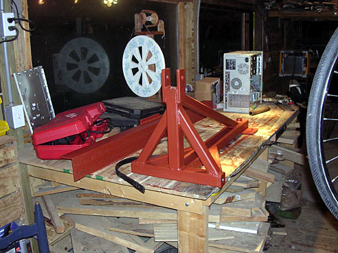

I posted pixs in wrong thread, here are my work benches.
