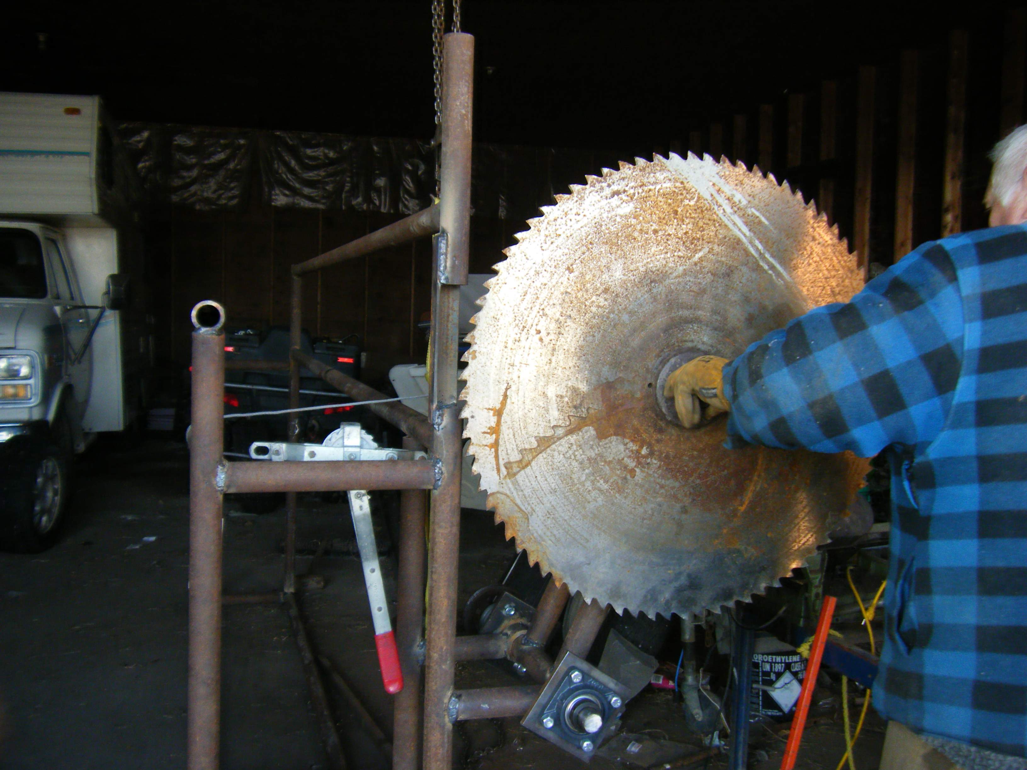

I started a wood processor build a couple of months ago thought I would share some pictures of the build

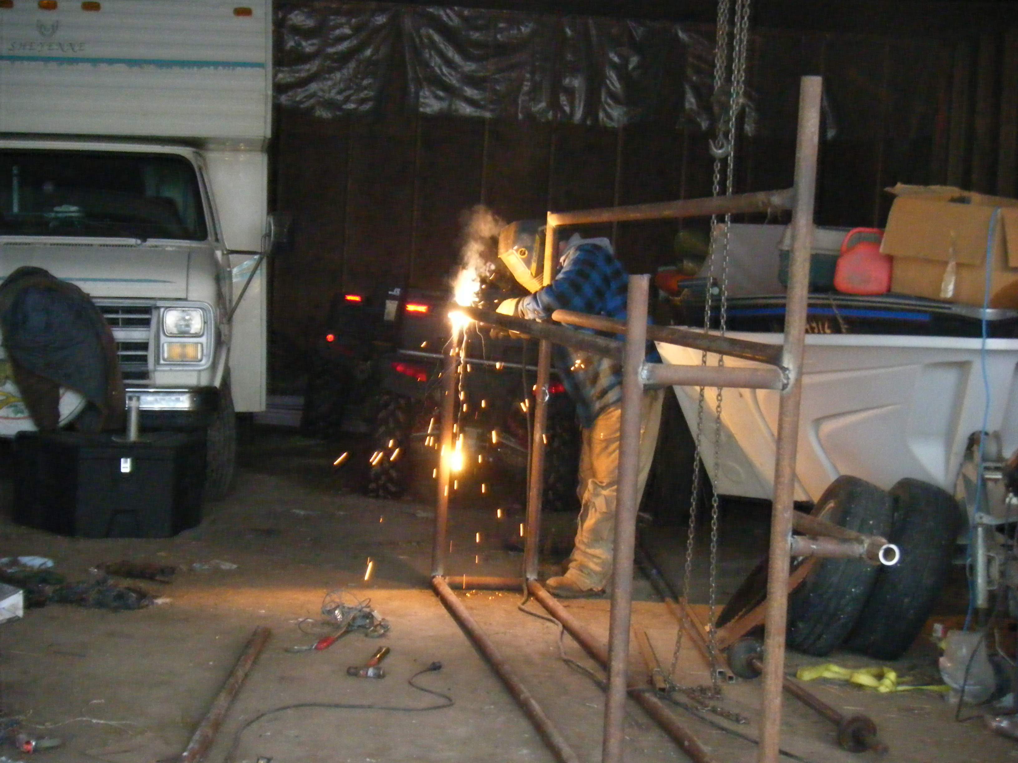

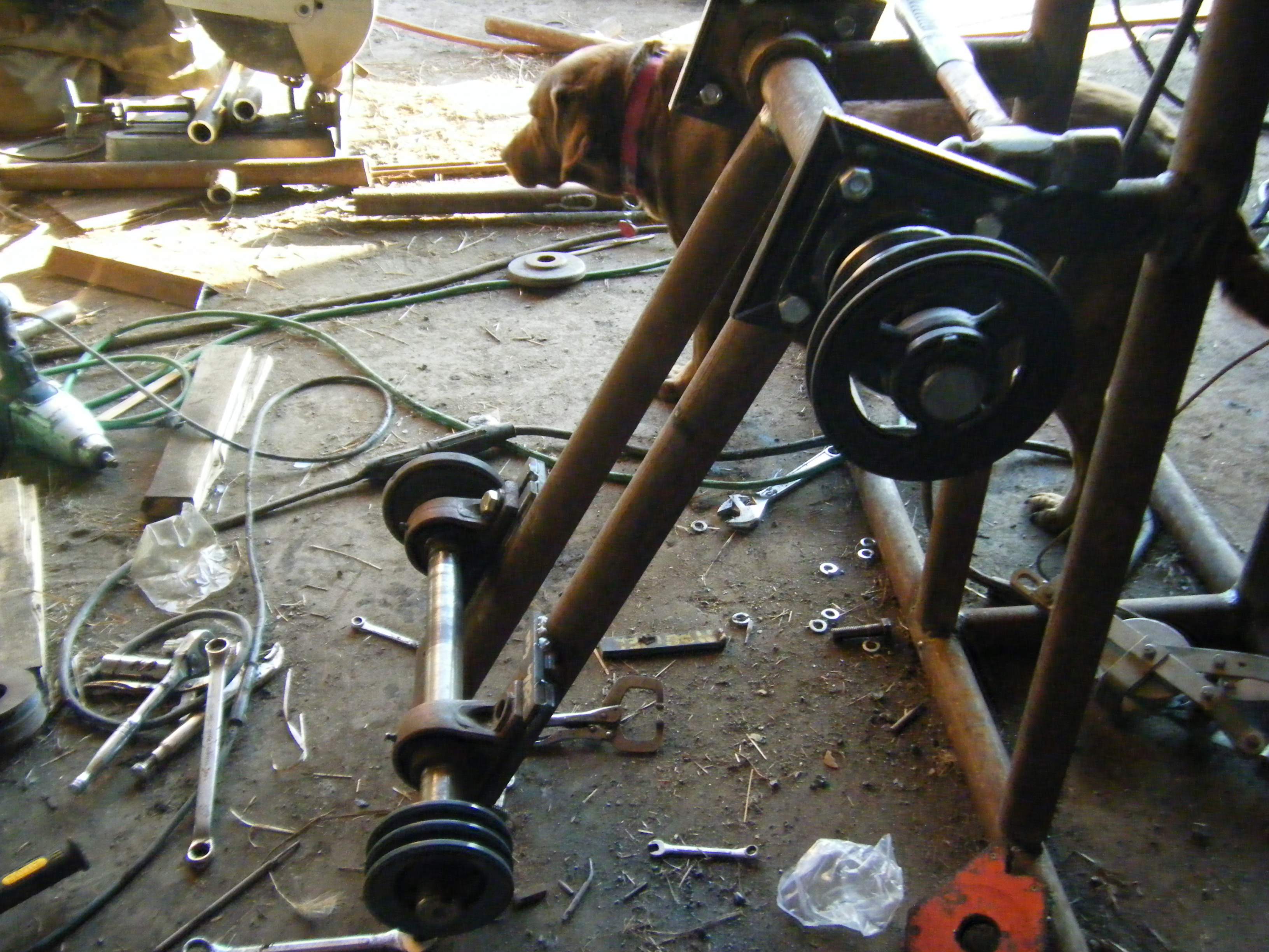

I used pipe as this is what I had on hand, I used a 33" blade I found for a reasonable price and made it on a hydraulic pivot . the drive runs through the pivot shaft so it does not affect belt tension 026.jpg024.jpg

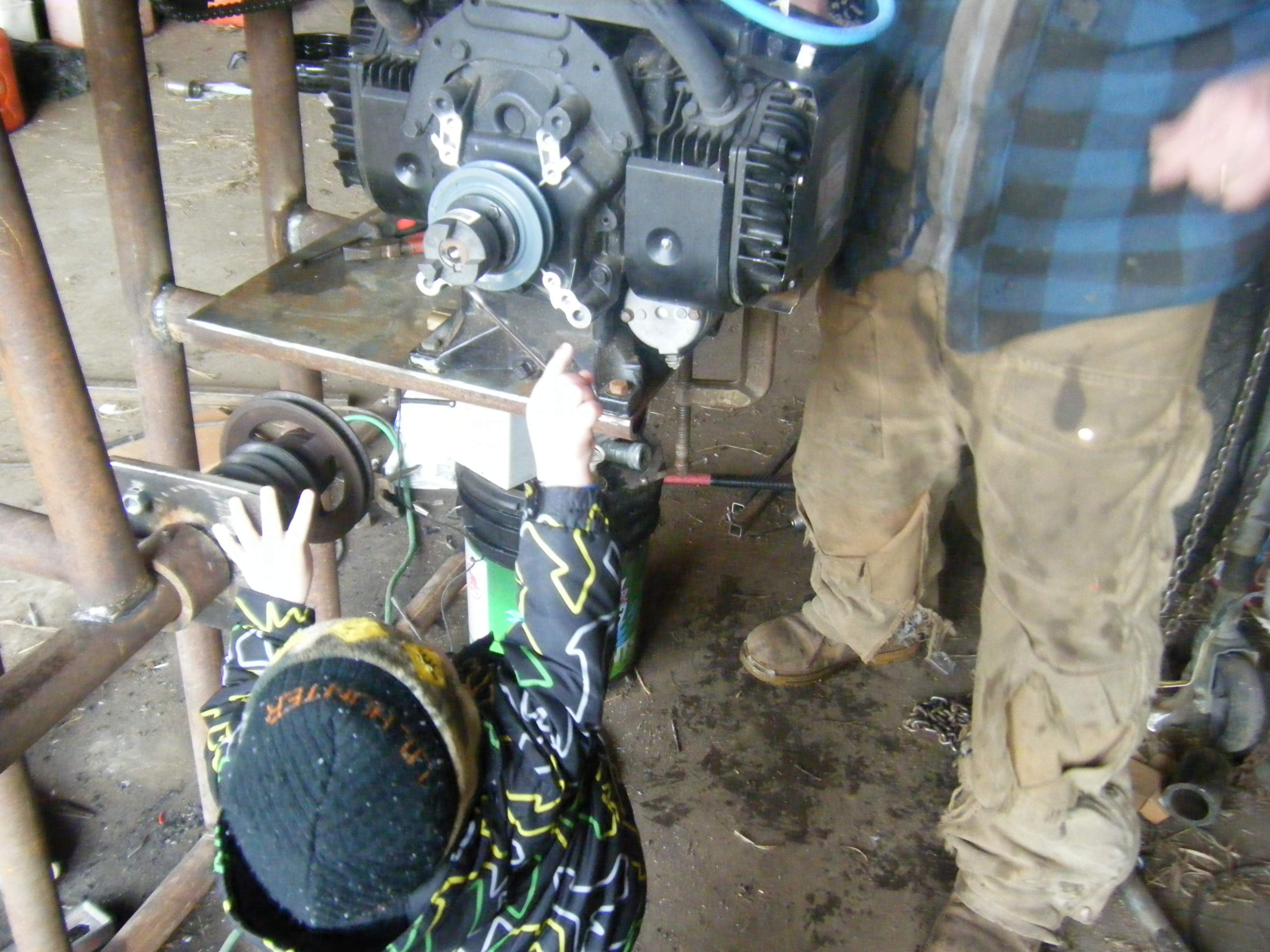

Yes we have trees and lots of them,damage motor (5).jpgThis is the motor I will be using,it is a 18 hp briggs that I purchased on ebay. Special thanks to the UPS boys for smashing it all up .talked to the guy I bought it from he sent me another one which traveled by tracking it almost 3000 miles all over the US from redding ca to Kentucky and was lost completely by FedEx people. Filed a complaint with ebay and got my money back and got to keep the damaged first motor. straightened all the dents and rewired it and got it working ok.

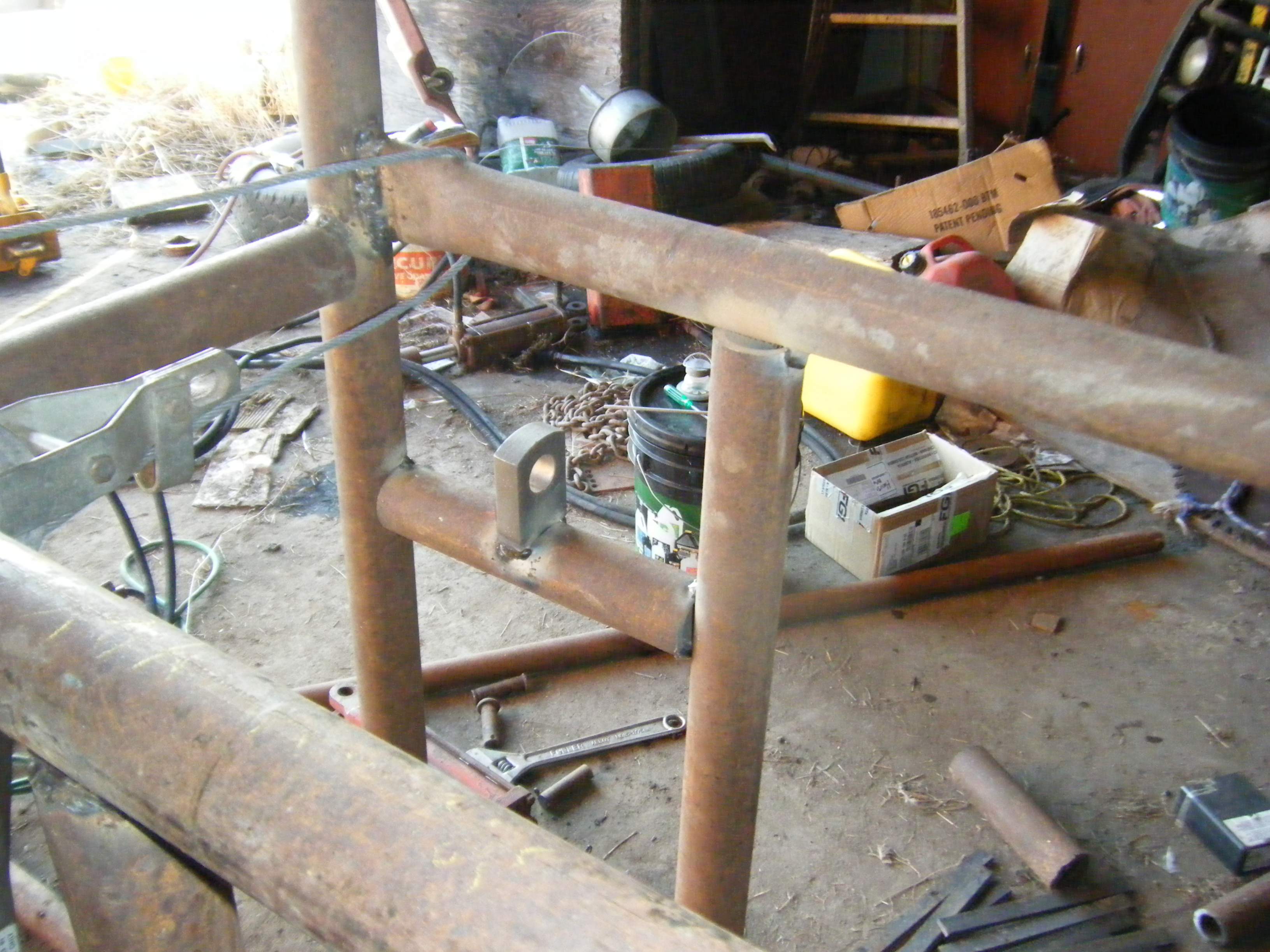

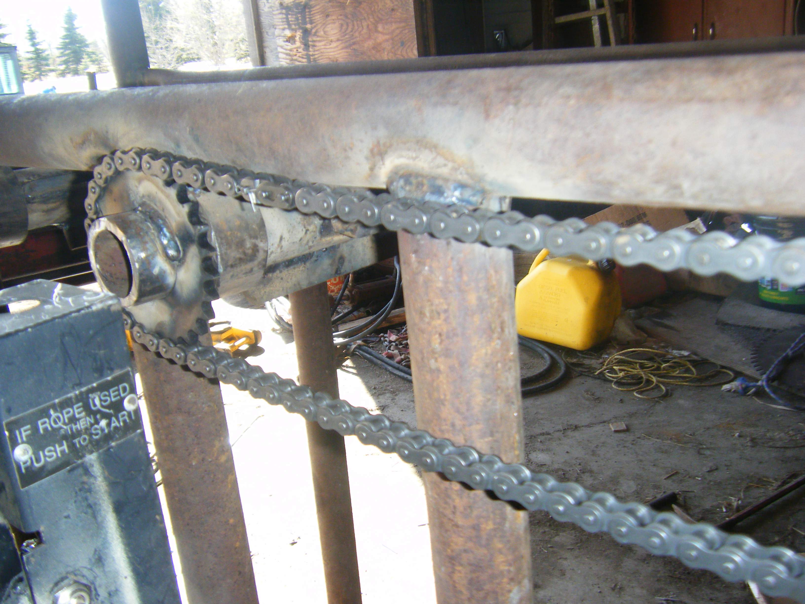

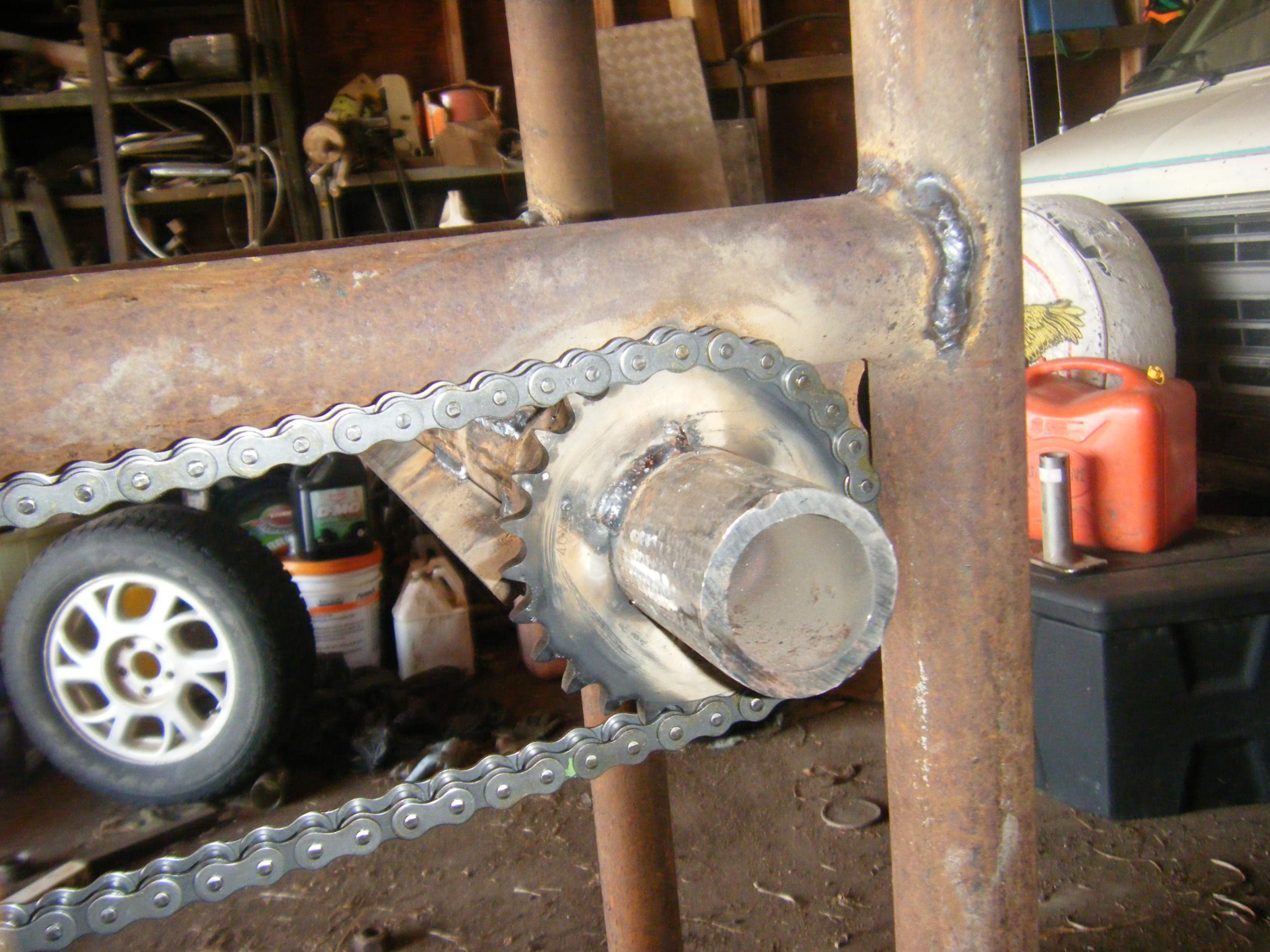

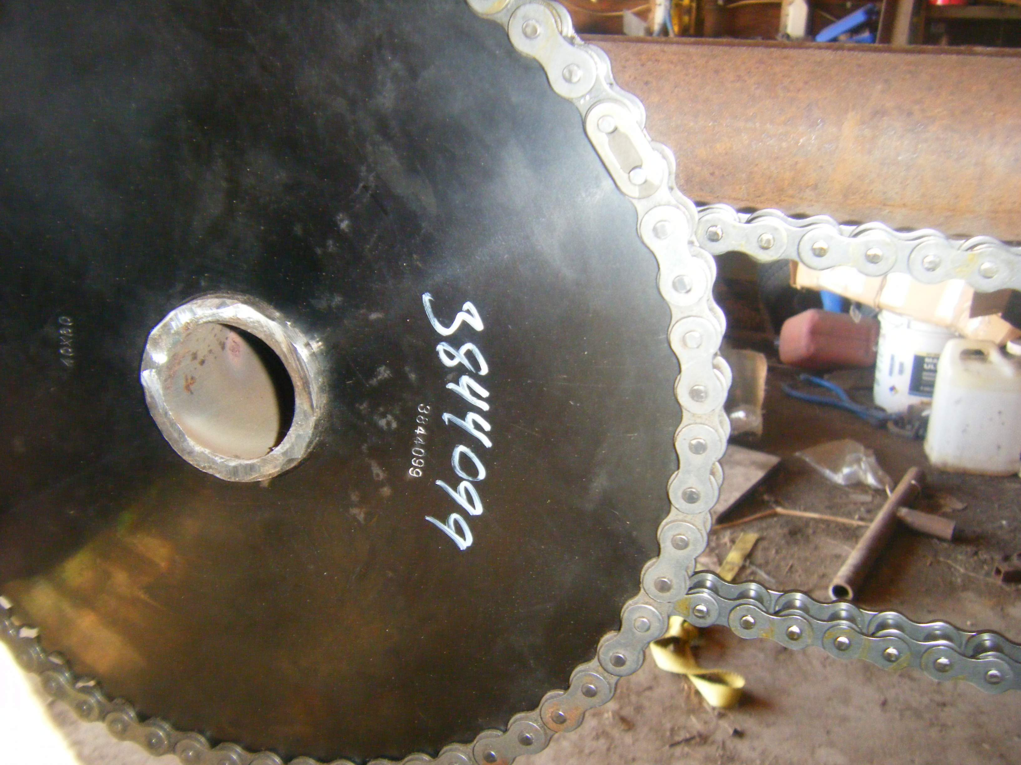

For my log feed I used a simple roller design, pipe inside of pipe with paddles welded on and chain driven. as this moves at a very slow speed and I put grease zerks on I think they will last a long time. I considered using pillow bearings but they were costly and a lot more work, maybe the wrong choice but time will tell.I am using a hydraulic orbit motor to drive this.easter with the boys 027.jpgeaster with the boys 028.jpgeaster with the boys 029.jpgeaster with the boys 030.jpg

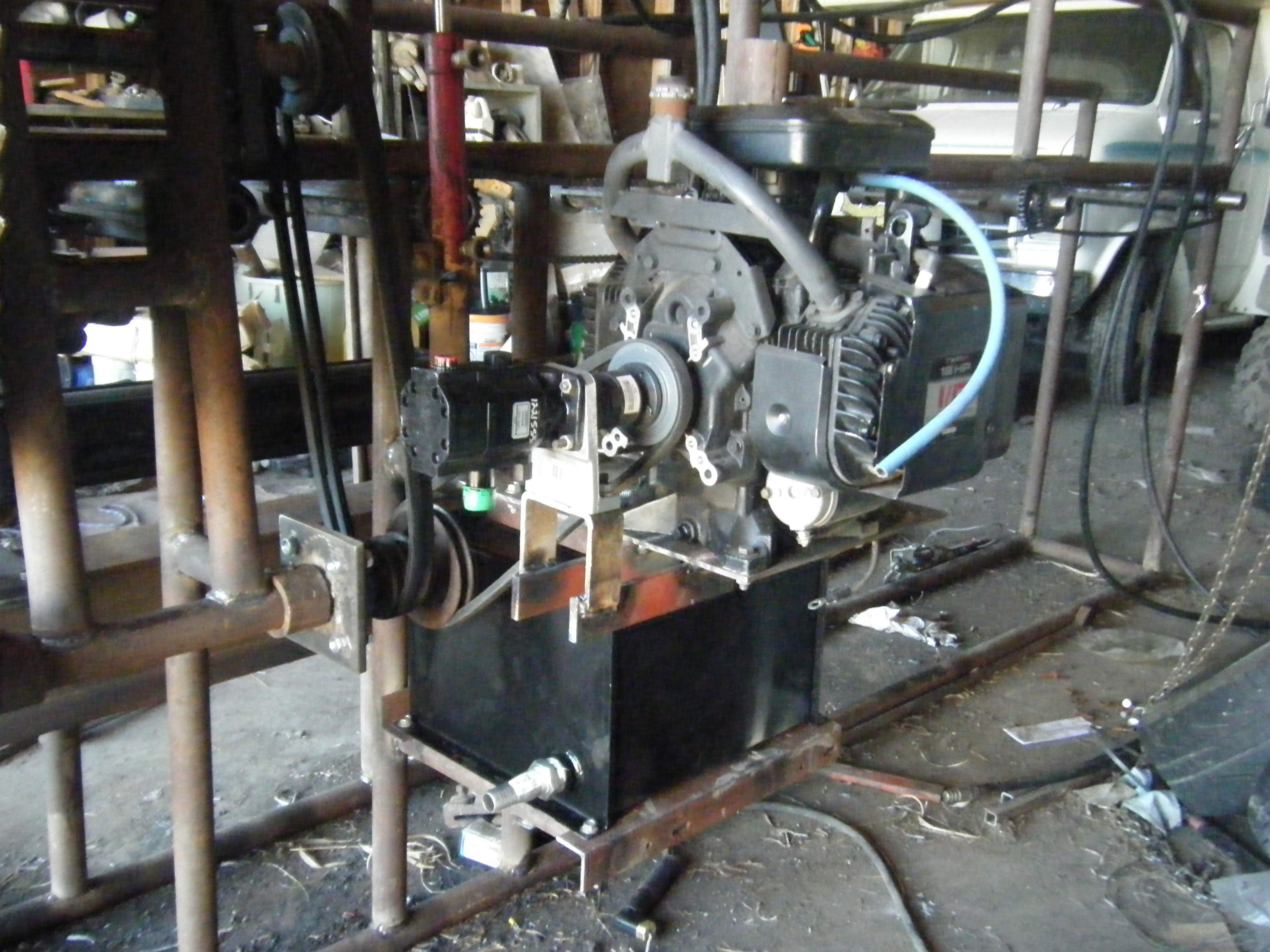

I am using a direct drive reduced by pulleys for the saw blade, I have all kinds of pipe so I used it for most of the build , motor mounts,tanks etc, this was supposed to be a low cost machine however the dollars keep moving out at a high rate, wife is starting to give me the look.easter with the boys 024.jpgeaster with the boys 017 (2).jpgI have a helper with me he keeps me going, lots of good advice

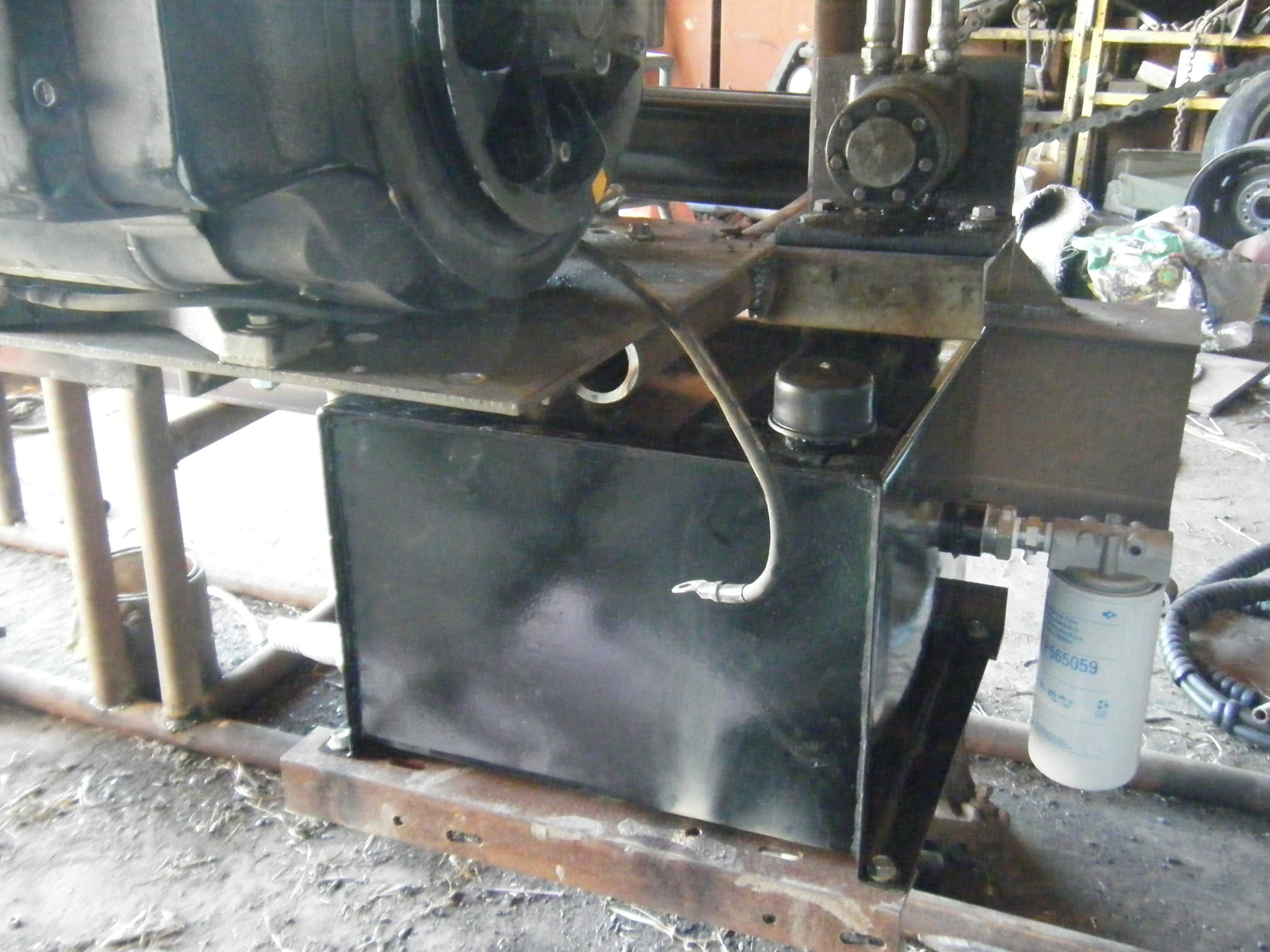

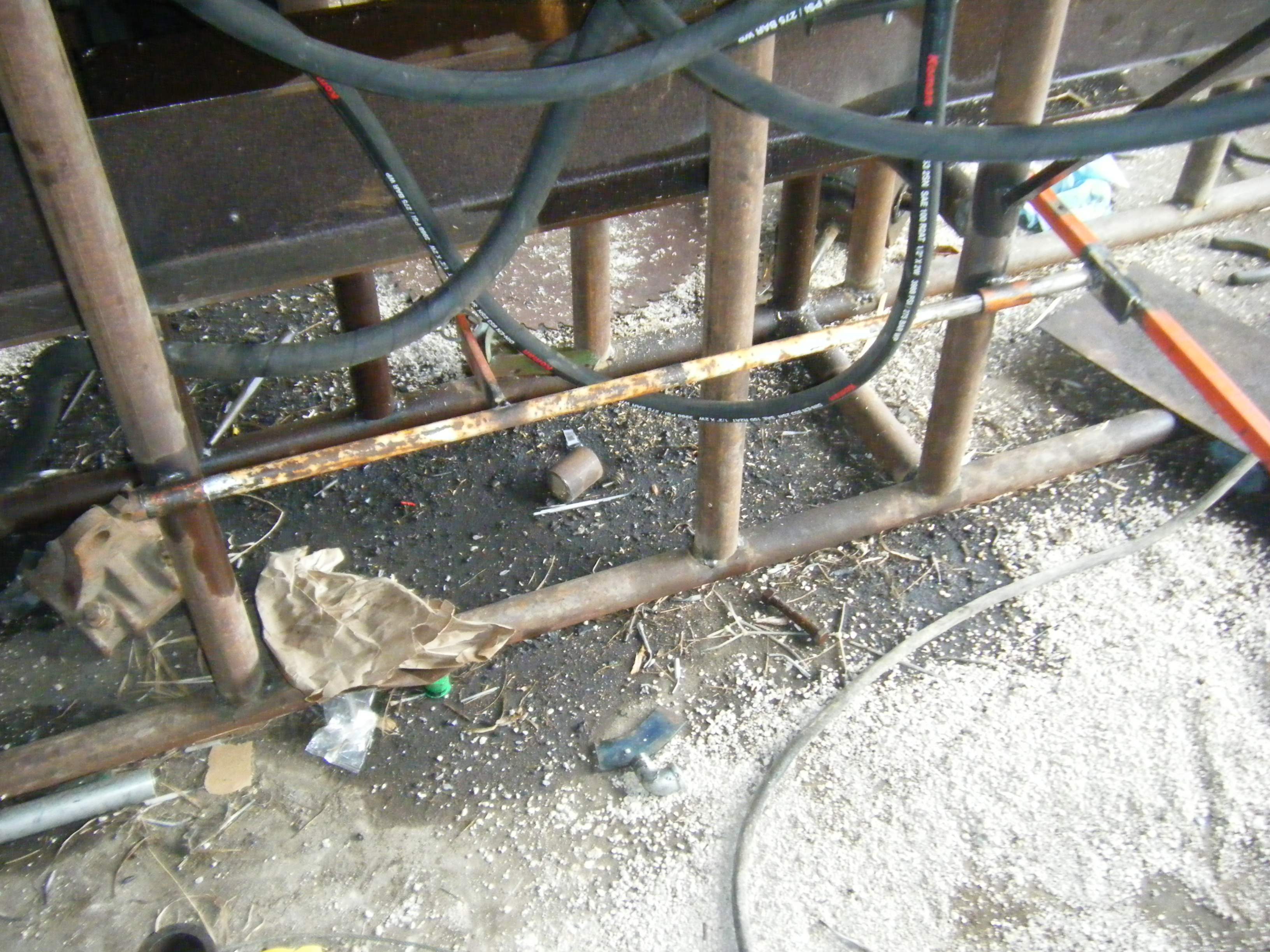

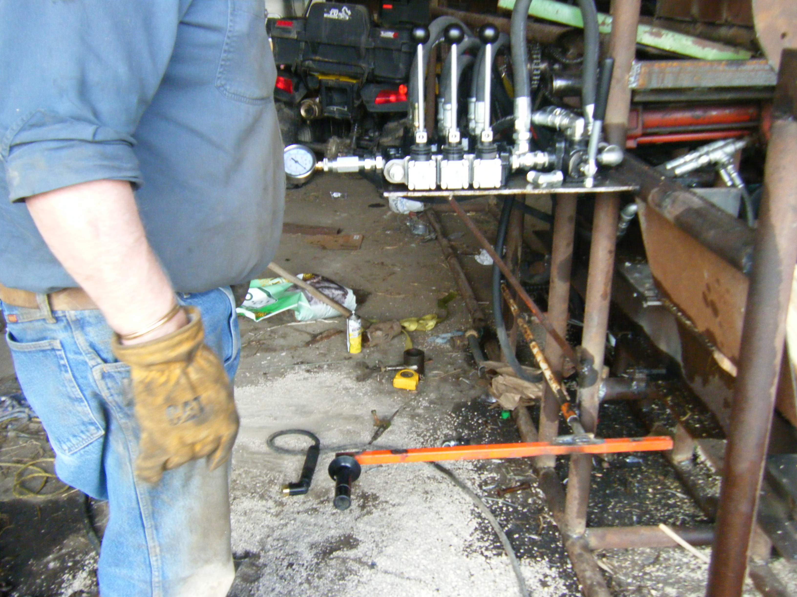

Got the motor mounted fine, Last week I picked up all the hydraulic components, pump, reservoir ,splitter ram and valves, that took care of a few dollars. I had a couple of cylinders laying around from leftover farm equipment. started to mount these . I purchased a triple valve body 25 gpm flow and a single valve with a kick off for the splitter. to put these together I had to purchase a power beyond valve for the triple something new to me .dave  and charlie 024.jpgdave  and charlie 025.jpgdave  and charlie 026.jpg

Got the motor mounted fine, Last week I picked up all the hydraulic components, pump, reservoir ,splitter ram and valves, that took care of a few dollars. I had a couple of cylinders laying around from leftover farm equipment. started to mount these . I purchased a triple valve body 25 gpm flow and a single valve with a kick off for the splitter. to put these together I had to purchase a power beyond valve for the triple something new to me .<img src="http://www.tractorbynet.com/forums/attachment.php?attachmentid=422935"/><img src="http://www.tractorbynet.com/forums/attachment.php?attachmentid=422936"/><img src="http://www.tractorbynet.com/forums/attachment.php?attachmentid=422937"/>
I used the same tank on my processor. Its way to small, the hydraulics over heat very quickly. I'm using a 15 HP with 28/7 GPM pump.
I'm also concerned about how your powering your saw. If your going with a hydraulic motor, I don't think your engine is big enough and your tank is far too small. Regardless of tank size, you'll need a cooler. If its direct drive, I'm not sure how you're mounting it given the pics so far and I think you'll run into a power issue when the hydraulics are active.
/ wood processor build
#13
It will be direct drive with a belt just building the clutch belt tightener for it today, You may be right about the reservoir time will tell I guess , it is 10 gallons. the reservoir I had on my splitter I could split for hours and the oil never overheated and it was a lot smaller but again we will see. Hooked up my hydraulics, disaster had the hyd rep from princess auto tell me how to plumb it , He miss informed me and I blew my hydraulic motor apart, I talked to a gentleman on the Hydraulic forum told me what was wrong and I went back to princess auto and told the guy, he said he made a mistake and replaced the motor free of charge. Got the hyd working okay now to get the blade movingdave  and charlie 024.jpg

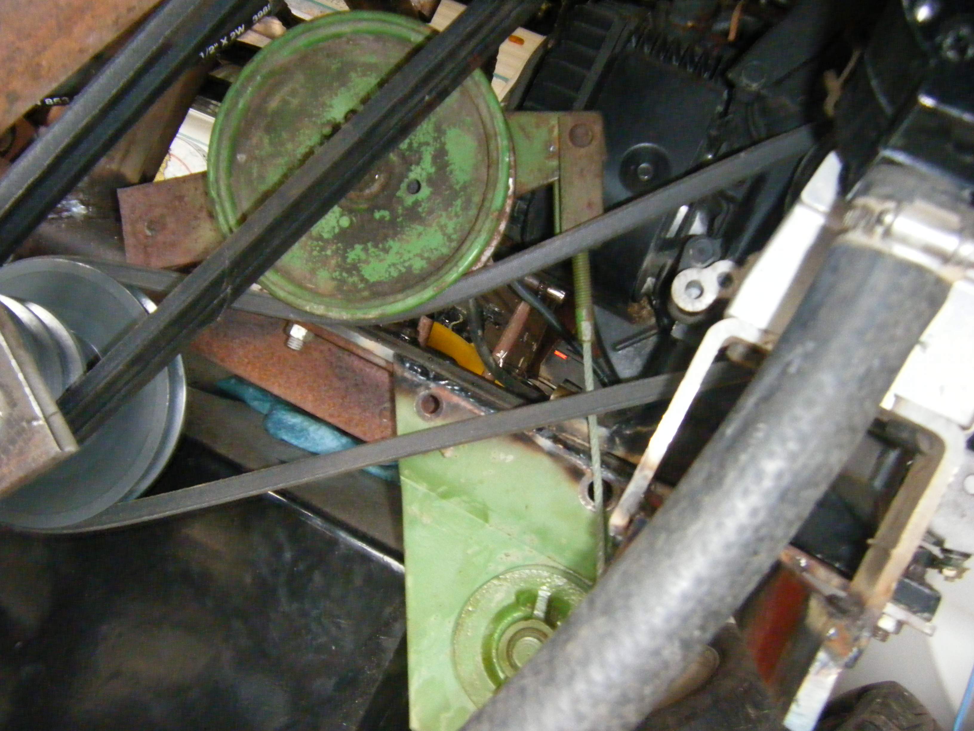

#14

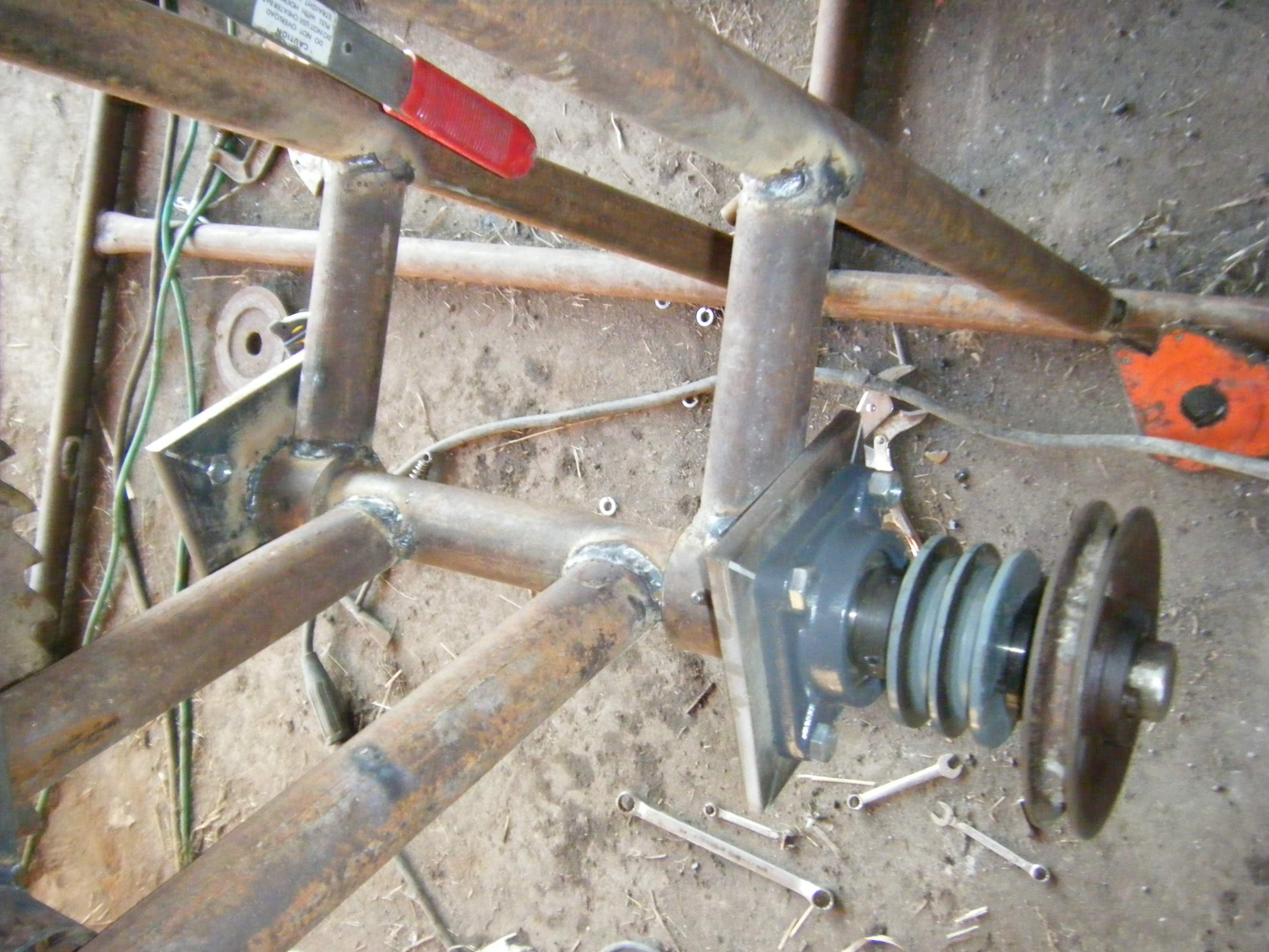

got the clutch tightener on, appears to be working, just have not figured out how037.jpg to keep it on yet but I am working on it035.jpg036.jpg It is a simple belt tightener with a cable to a lever. would like to have something to hold it on but easy to release if I have to
