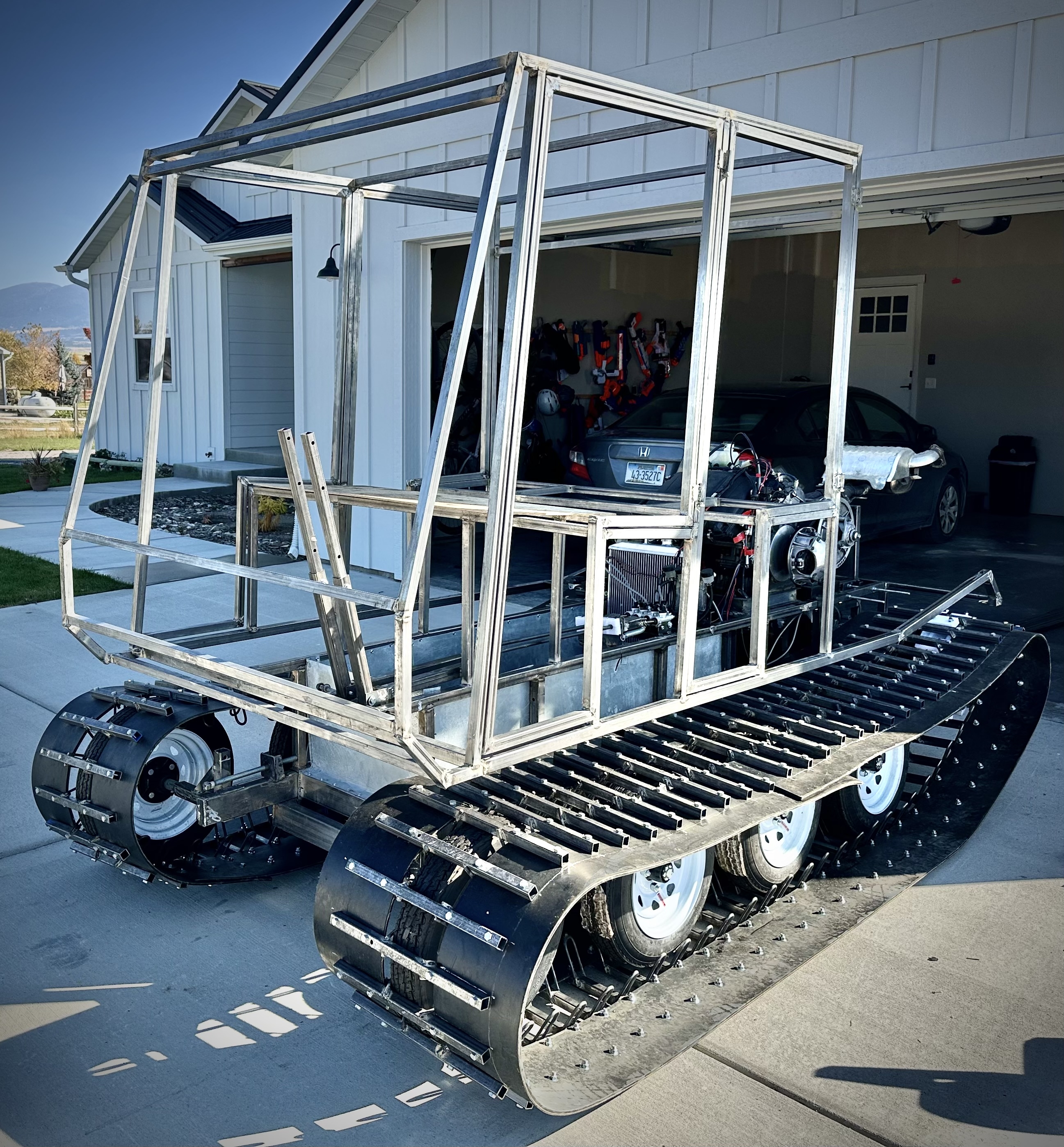

Finished hydraulic six way blade. Tilt function to improve Nordic skiing surfaces to flat.
Six way snowcat blade.

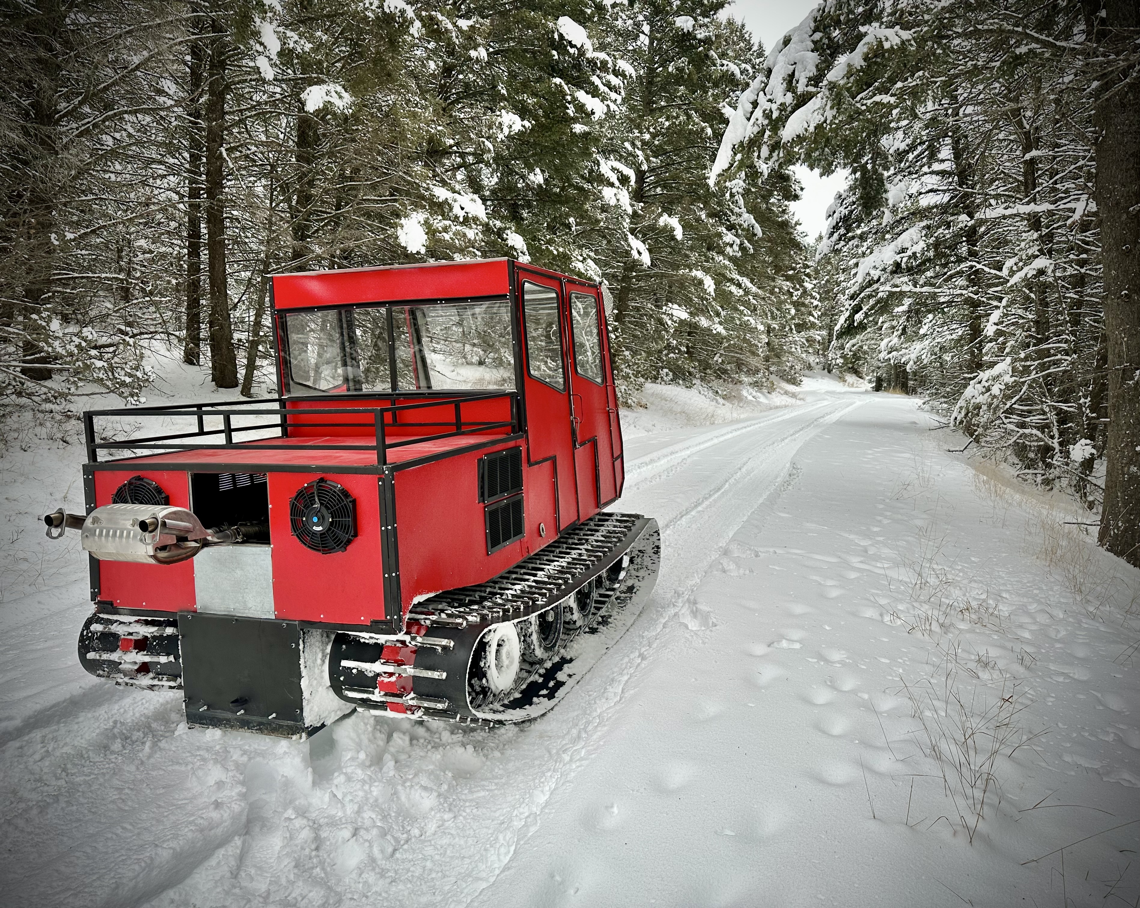

/ DIY Snowcat build
#28
What? no defroster for the windshield?
Richard
Radiator now diverted to cab for heat. Has a diesel heater, too. But this was start and go before snow melted;)

#29
Slow to non-existent winter, but recently had success grooming for Nordic skiing. Built a six way hydraulic blade and groomer this fall.

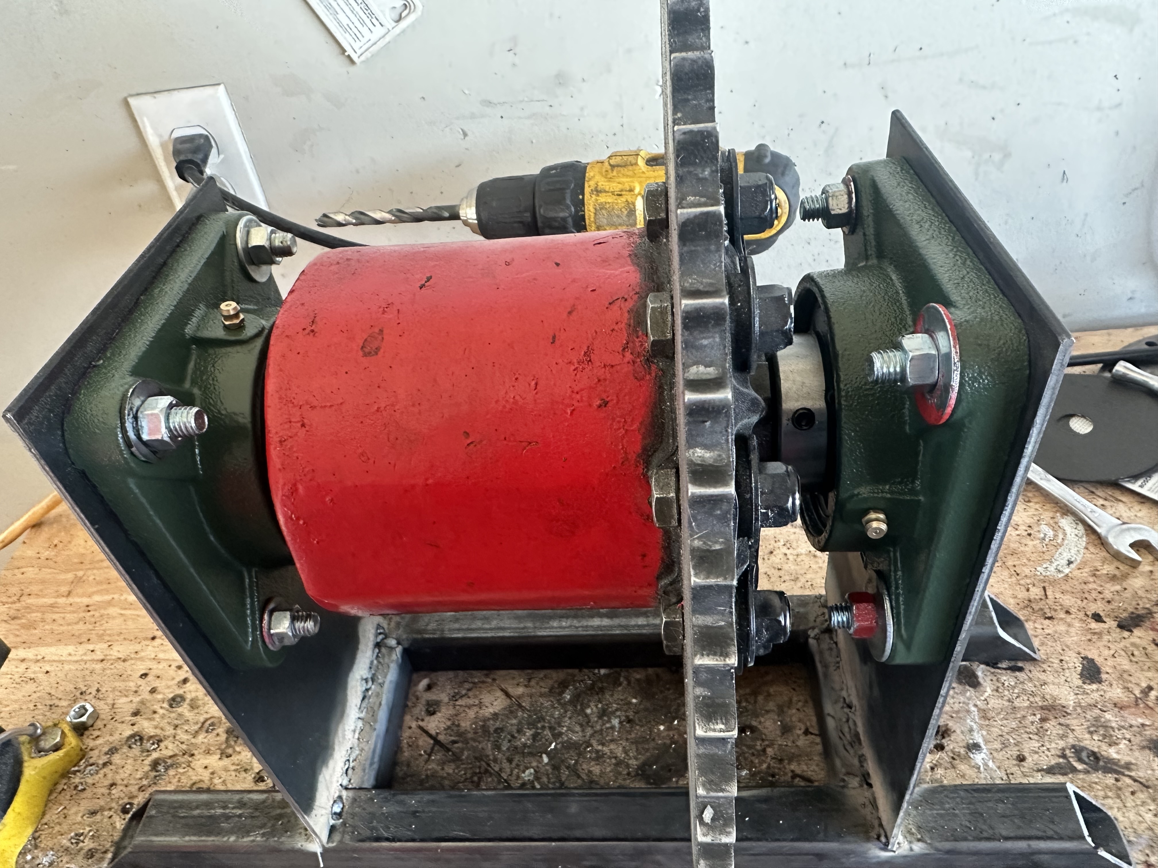

/ DIY Snowcat build #30
Did you just weld essentially a cover over an axle carrier with spider gears in it to make the dif for this? Could it really be that easy? Is it filled with oil or grease or anything?
/ DIY Snowcat build
#31
Chevy diff from 1 ton vehicle. Used sprocket as ring gear. Made a cover for the spider gears out of steel. Filled with grease. Done.
Google "chain drive differential" for other examples.
Works reasonably well but not as good as purpose built planetary diff from a real snowcat like Thiokol, etc. When you brake one side, the other side spins at double speed which makes for lower torque transfer and kinda jerky steering. But for a "budget" snowcat build it works well enough.

It’s certainly odd to have an engine revving at 6-7k and only moving 6-10mph….
