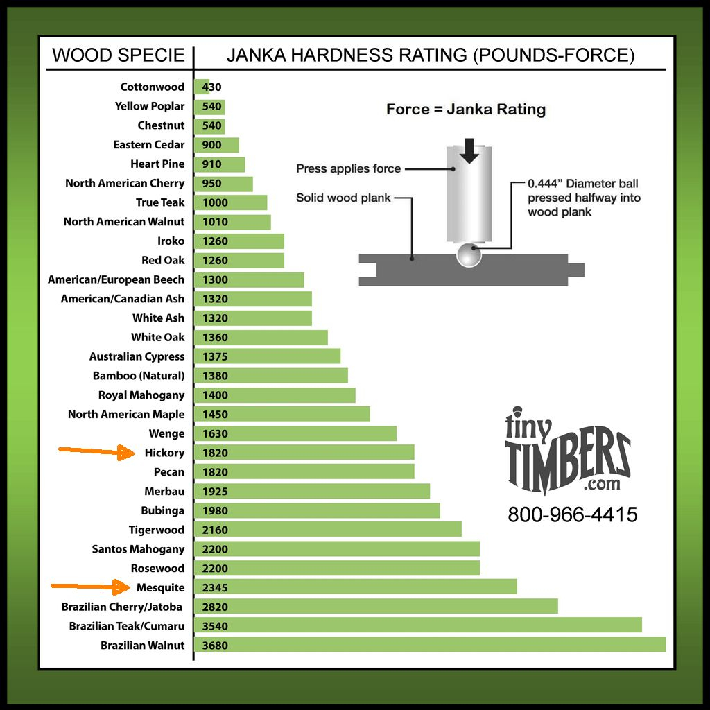

I’ve got a woodland mills 6”. I chip mostly mesquite with a new Holland 33hp. Most of the stuff I do is 4” or less and it does great. It’s got a smaller flywheel than the rest but the only time it let me down was as my clutch was going out in the tractor, I just had to chip smaller brush. The customer support is outstanding. As with any PTO implement, especially a wood chipper make sure you your clutch is good
